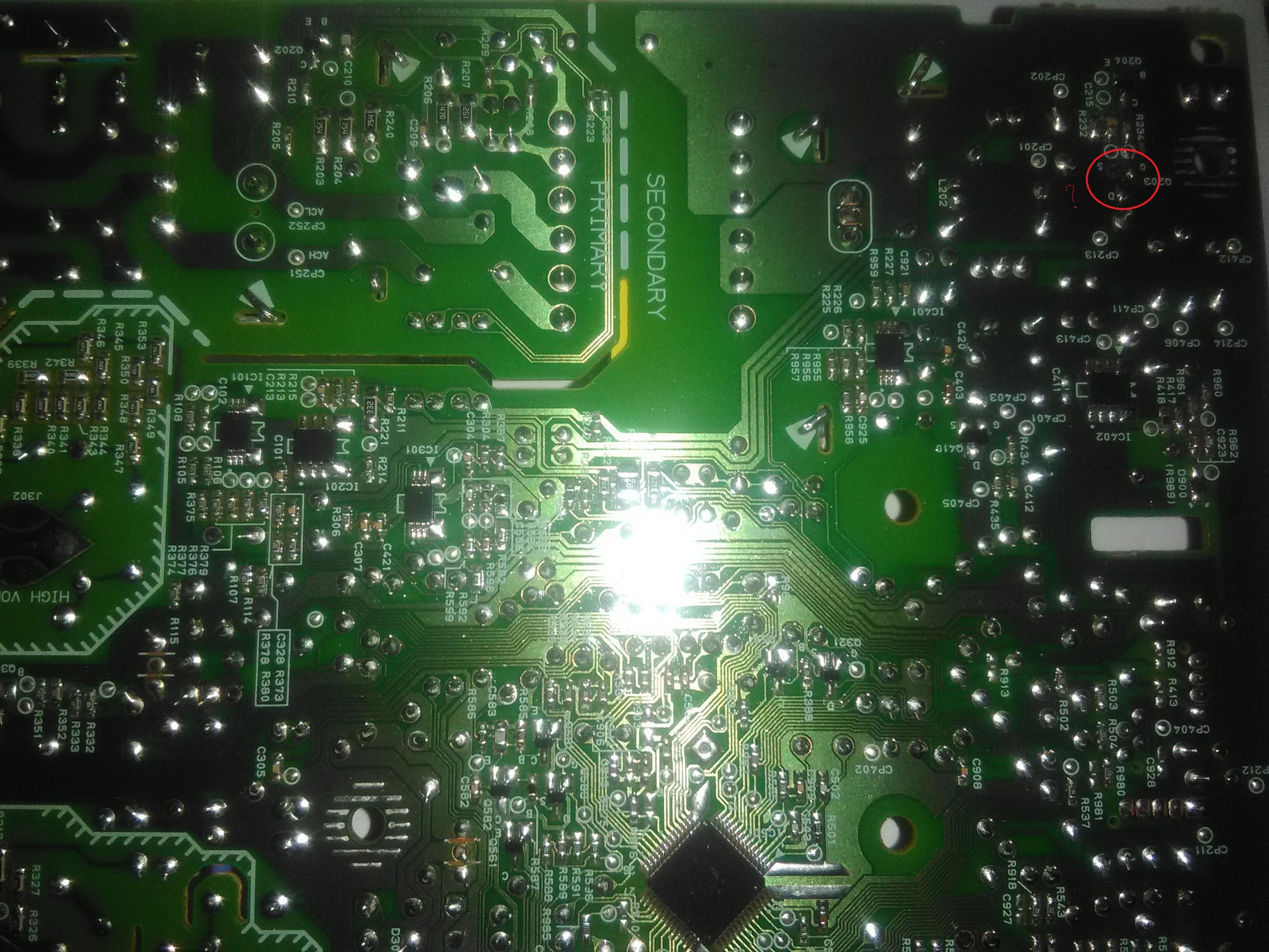

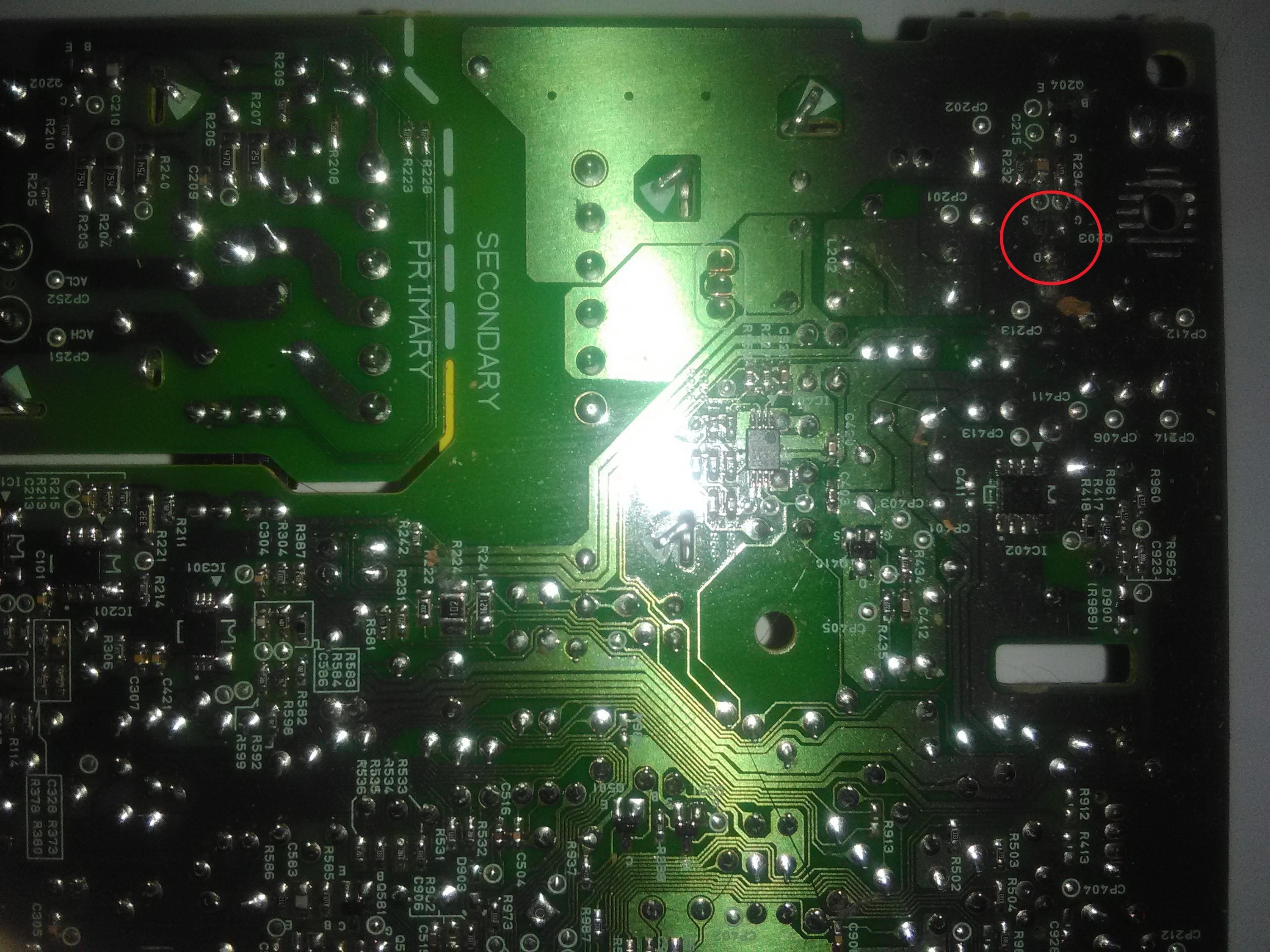

    Canon mf3010 w'ont turn on
    HELP ME IDENTIFY THE EQUIVALENT OF THE SMD MOSFET Q203 ON A CANON MF3010 POWER SUPPLY
    • 20898
    Re: Canon mf3010 w'ont turn on
    Superman wouldn`t be able to see the marking on that. Post a better picture of it so the top marking can be seen clearly

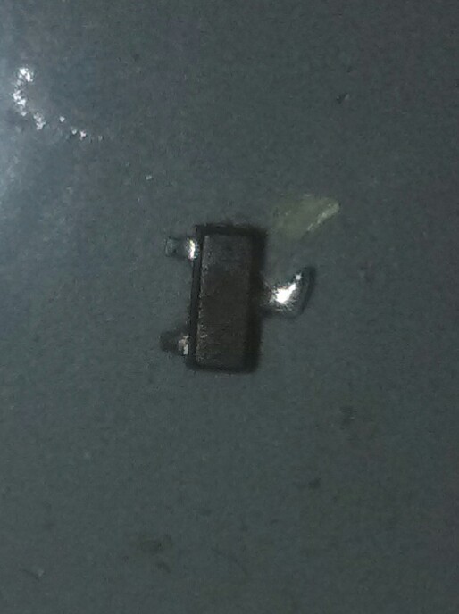

      smd mosfet marking TR2U
        Help me identify the equivalent of the smd mosfet q203 on a canon mf3010 power supply
        • aboumohamed
          • Dec 2018
          • 258
          • algeria
          I have identified the q203 :marquage "TR2U" or "WY"
          rsr025p03
          mosfet p-ch -30v -2.5a
          but i would like to know the cause of this failure. Thanks to all
