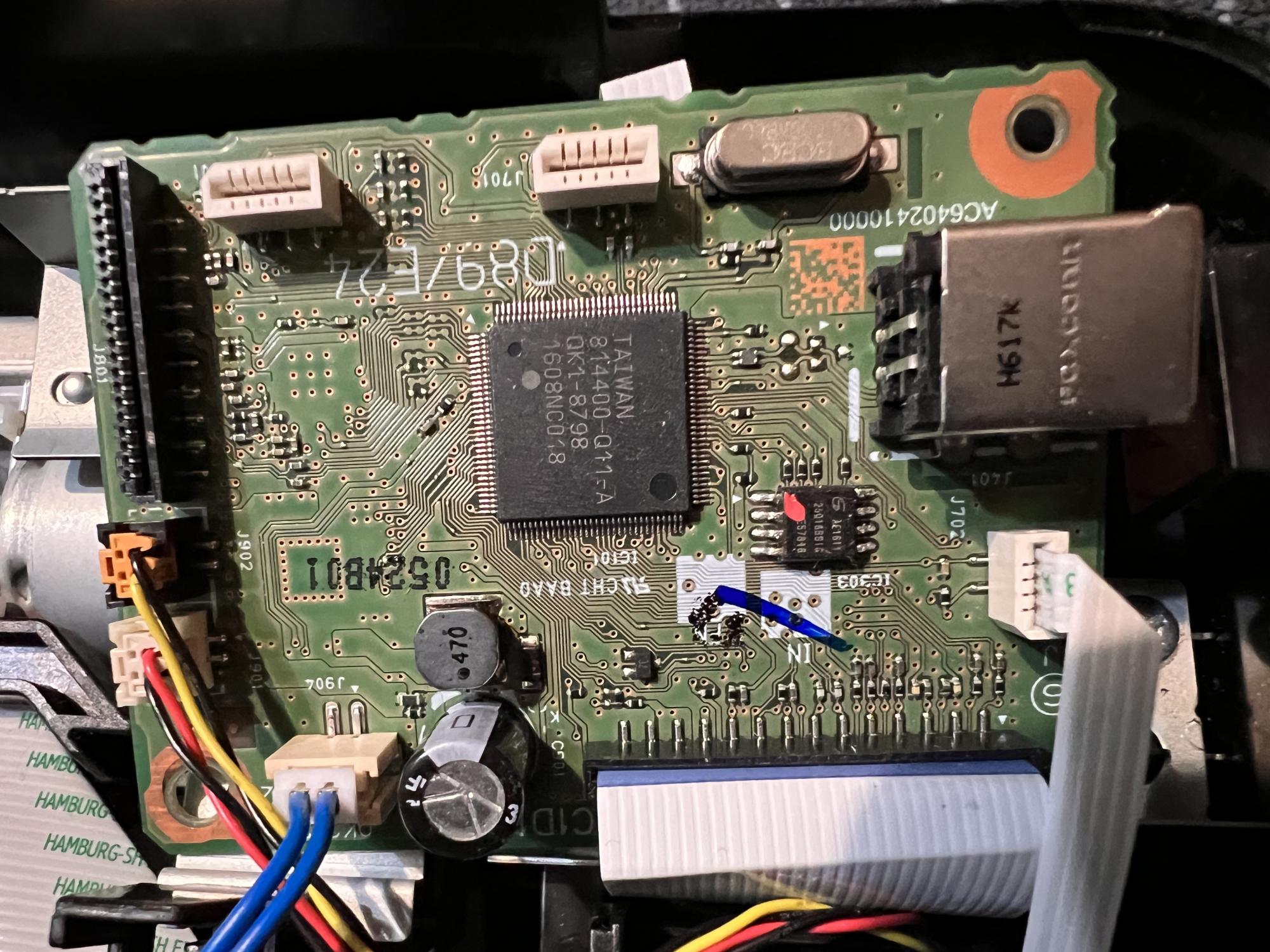

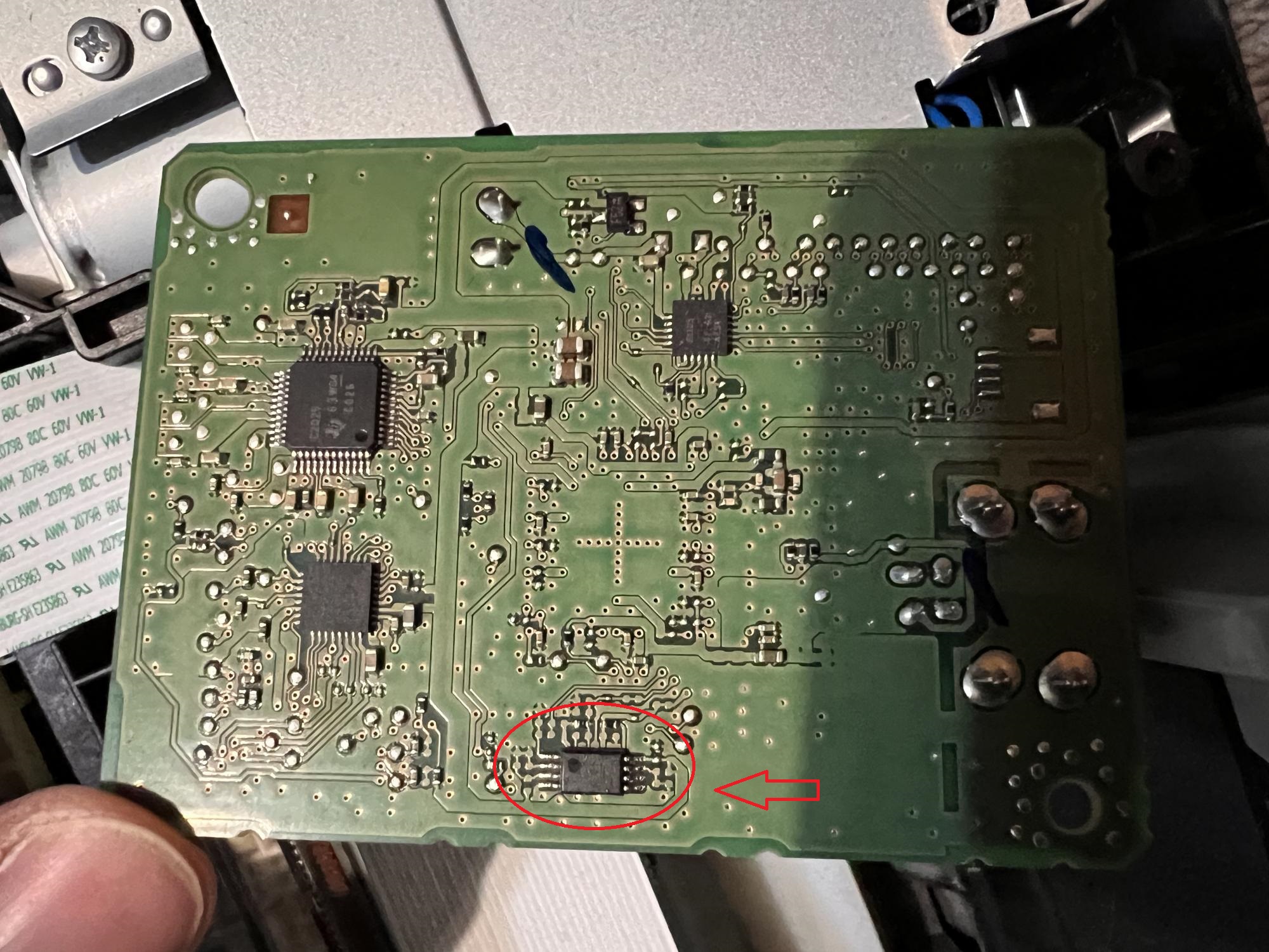

          Hi everyone,
          I was trying to figure out how to repair my Canon 2550s from error 5B00 and I came here after many attempts. I'm now trying to rewrite the eeprom containing printer's info, but the fact is that I can't find eeprom 24c08 as someone suggested… on my board I can see only eeprom 25q16. Now I'm wondering, why there is no 24c08 even if the model is the same? Rewriting just 25q16 eeprom will solve the problem? If so, does someone have the dump file for 25qq16 eeprom?
          I attach photos of the printer's board… maybe someone could help me on find eeprom 24c08…

            Re: Canon Pixma MG2550S dump BIOS
            ...see the attached picture, this one is the memory if I still remember well!
              Thank you for the reply, shybear. I was thinking the same, but on that IC is written “ 4g08 54653”. Do you think the dump file will work anyway (if that IC is actually a eeprom chip)? I also need to find a way to program it since the package is smaller compared to the one of the 25q16 chip.

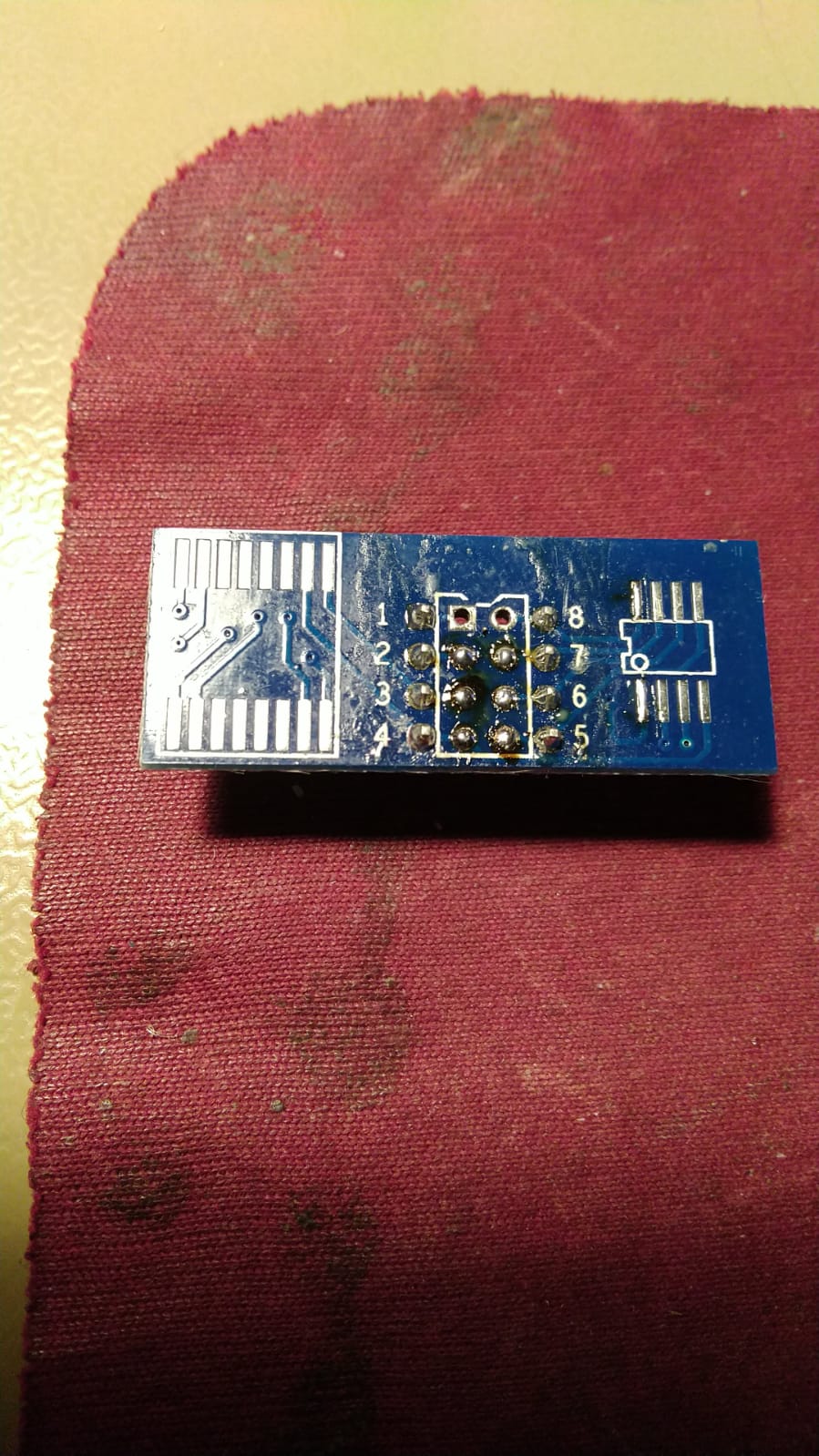

                If you quickly seach for 4g08 you'll find its an eeprom!
                If you doesn't have the right adapter socket you should have an adapter (that usually is inside programmer kit) where chip have to be soldered (see picture).
