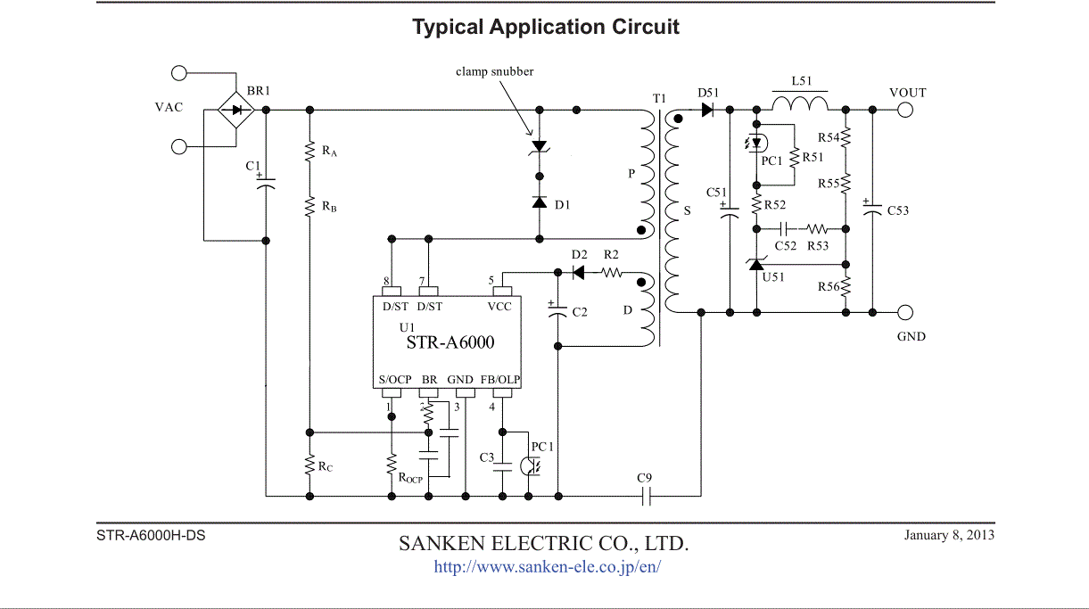

      Well this 2.5V standby issue has nothing to do with the supervisor chip or the PWM/PFC chip, because i removed both of them (on the other PSU) and isolated the standby circuit from everything else, and it's still 2.5V
      i checked all of the resistors, and they are all within tolerance, but i can't fully test the SMD caps because they have no values printed on them, but they are not shorted.
      i see that they used a zener diode in the snubber. It's not shorted but maybe it's faulty in some way?
      i altered the primary side of the schematic to match the standby that's in this PSU.

        Re: Zalman ZM500-GV stops after 40s and 5VSB drops to 2.5V
        The standby chip is good.
        And it appears that all of the primary standby components are good also.
        The TL431 tests good
        I see that the TL431 needs 2.5V in order for it to turn on - could that be related to why there is only 2.5V standby?
        There is a thyristor and a zener, in series, connected between the standby rail and the cathode of the TL431.
        What is is the function of that additional circuitry?
        Should it be latching?
          Fixed
          It was either a leaky zener, or possibly a thyristor, in the OVP in the standby feedback (the zeners both still tested correct voltage)
          Looks like the 2.5V standby is what happens when the opto is continuously turned on by the latched thyristor
