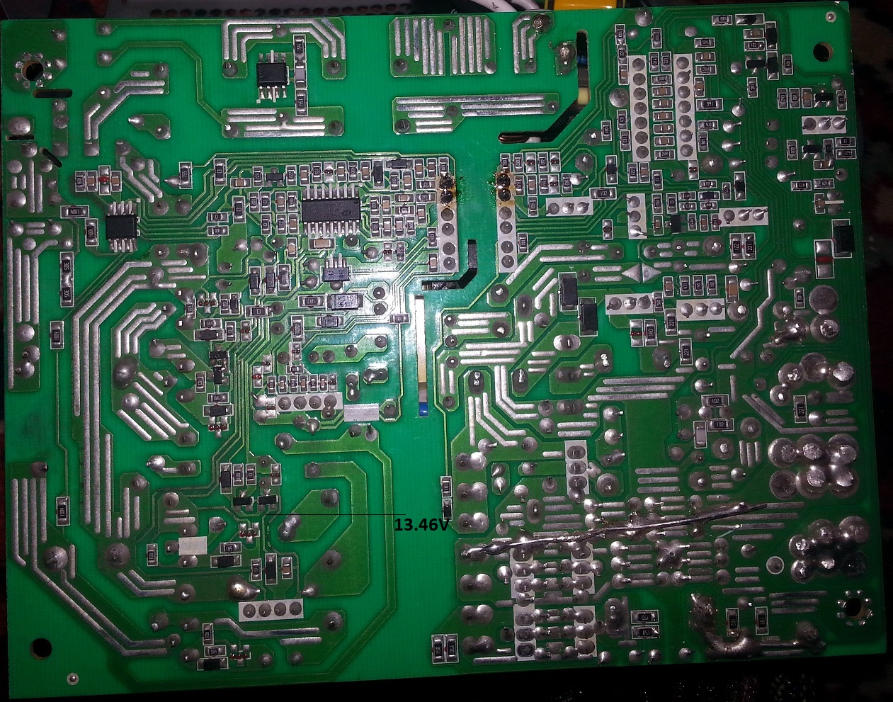

                            Re: Zalman ZM500-GV stops after 40s and 5VSB drops to 2.5V
                            4V is now back on the PWM-OUT pin, when i restated the PSU today.
                            There is no voltage on the gate of the heatsink-mounted MOSFETs
                            And i have the following voltages present on the CM6800 typical application circuit (see first photo)
                            From there the 13.46V goes to a reverse-biased SMD diode that's parallel with a SMD capacitor (see second photo), and that goes to the small gate driver transformer that has 3pins connected together, one isolated pin, and two pins connected together
                            which is different to the one here:
                            https://smpspowersupply.com/atx-powe...html#gatedrive
                            Not sure what to do now
                            Any suggestions?

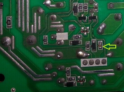

                              i meant 4V is back on PWM voltage feedback input - pin 6
                              So all of that appears to be good
                              The only two paths that i can see for "PWM_DC" that's coming from the junction of those two transistor emitters is via that T4 fast switching diode; but, to me, it appears to be the wrong way around, so that "PWM-DC" can't pass through it to reach the gate driver transformer, which is connected to the other side of the diode.
                              Or maybe it's supposed to pass through the SMD capacitor that is in parallel with the diode?
                              Is that diode that's in parallel with a capacitor there to allow for pulsed DC?
                              I checked the voltage at the other side of the diode, and there is nothing there
                                in theory that circuit will generate a very short pulse through the capacitor each time the transistors flip
                                if it strains the cap it will slowly fail - is it a substantial looking cap like a film one?
                                also if one of the transisters slowly gets weak it wont work well
                                  no - it's a tiny SMD capacitor
                                  the way that i see it, the main transformer's MOSFETs won't work at all if they don't have voltage on their gates, and it seems that that is what's happening here
