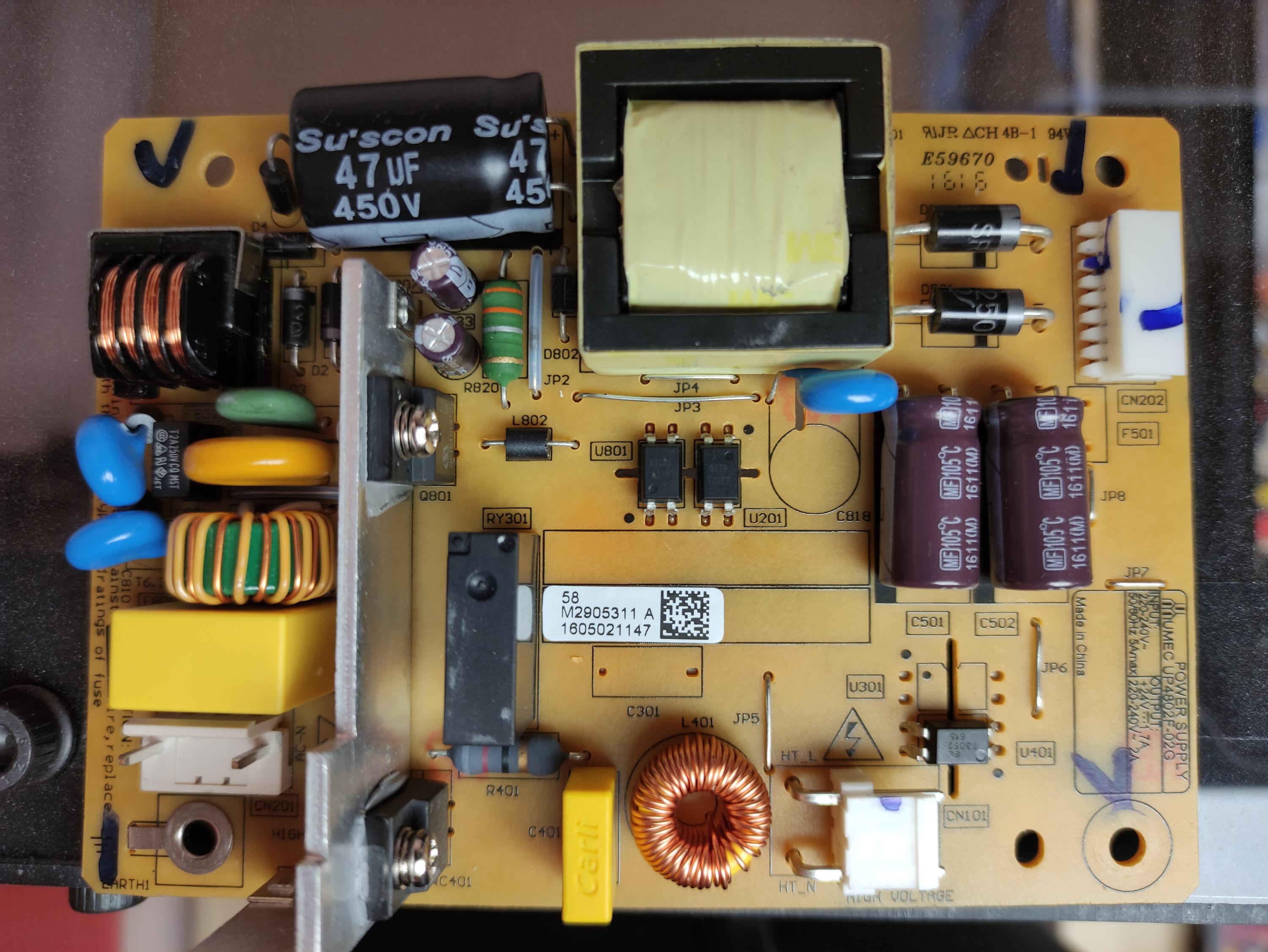

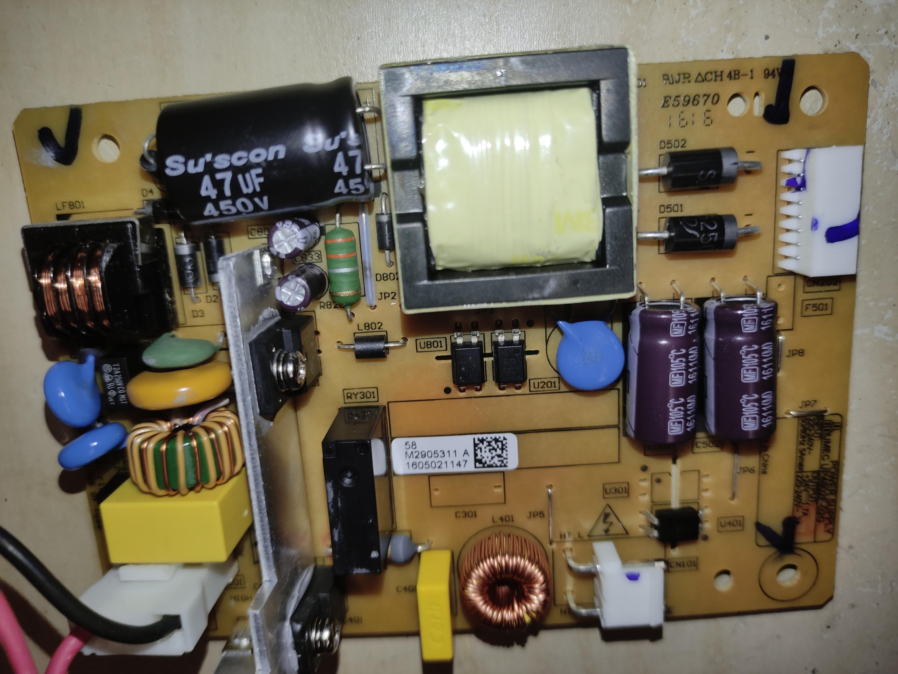

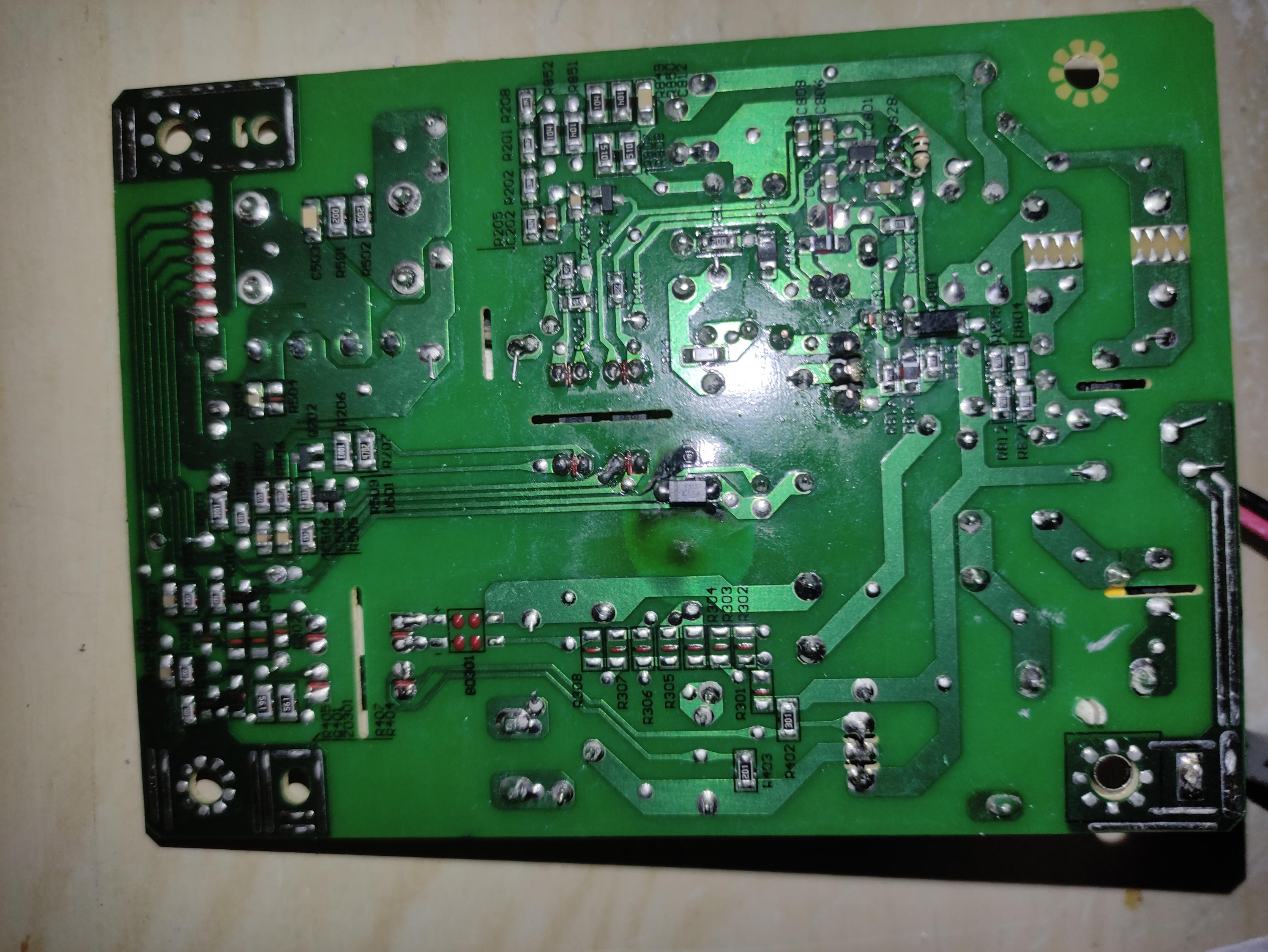

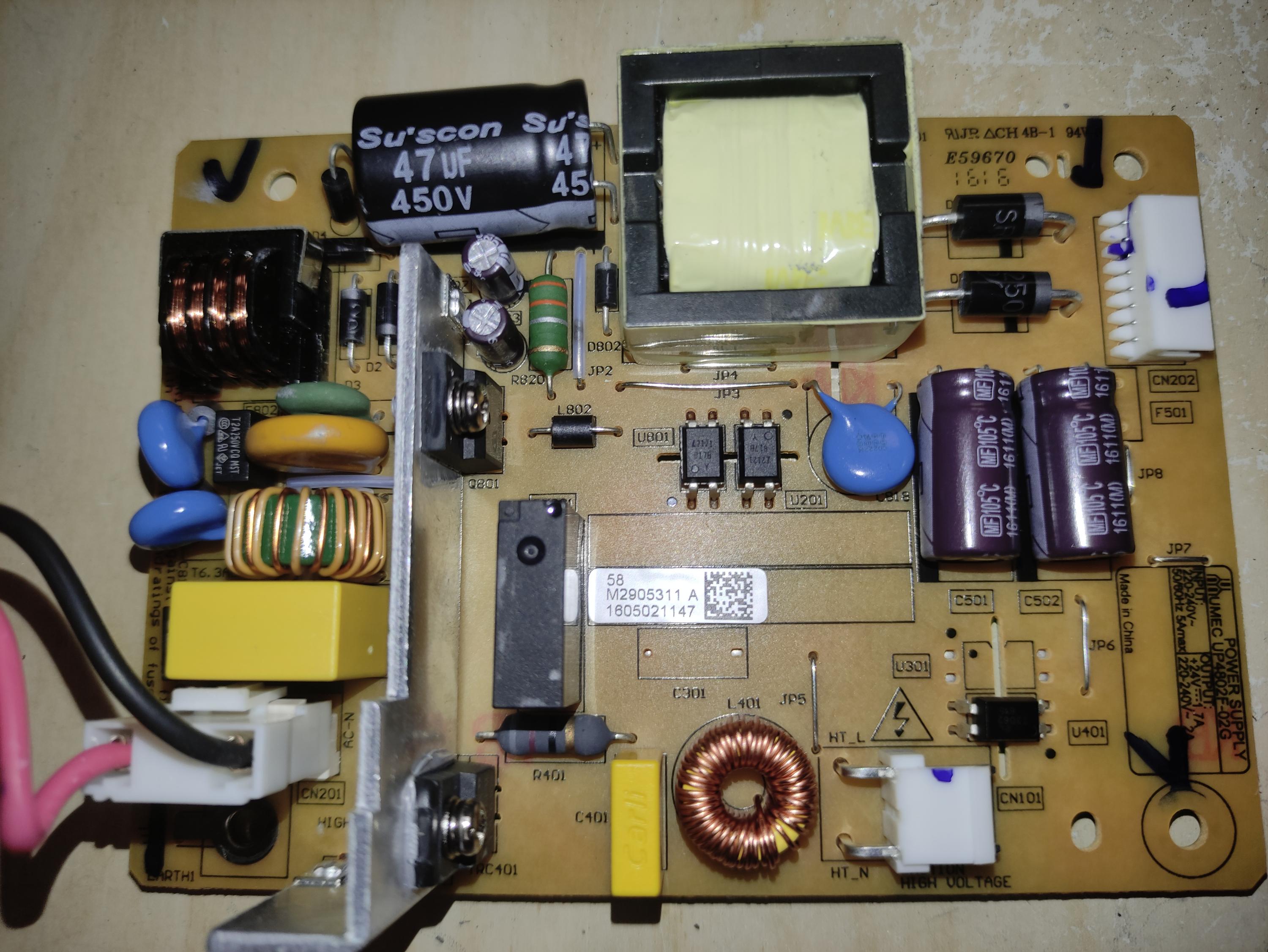

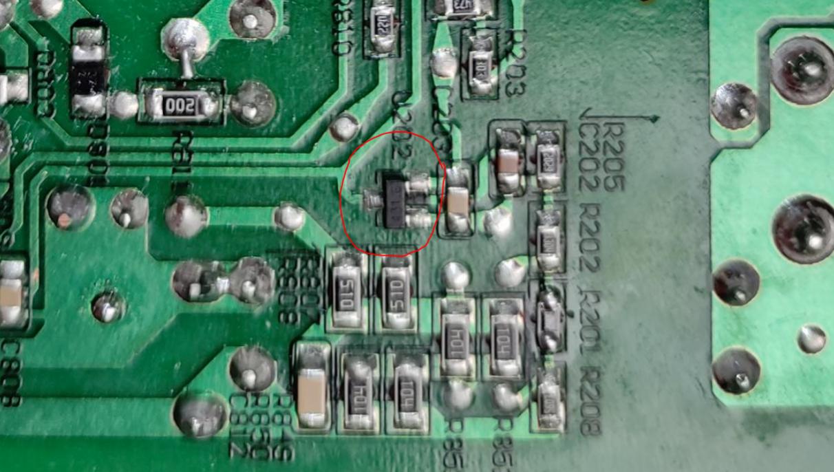

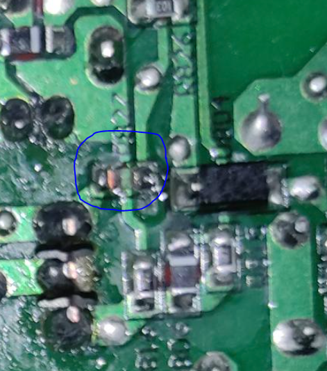

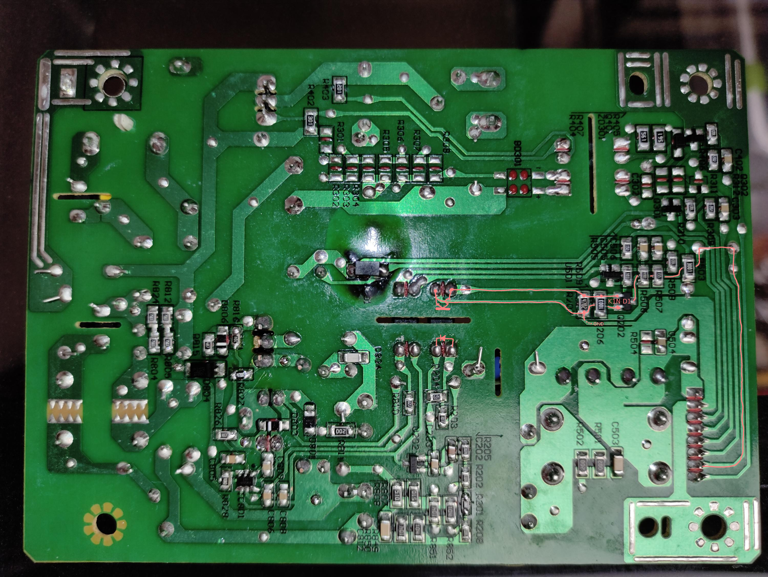

    I'm trying to repair a 24V PSU from a Ricoh SP 150w printer.
    So far I found and replaced:
    - a burnt 33Ohms 1W resistor (R820 - top side next to main cap)
    - a shorted mosfet (Q801 - top side on heatsink)
    - 2 shorted optocouplers (U801, U201 - top side)

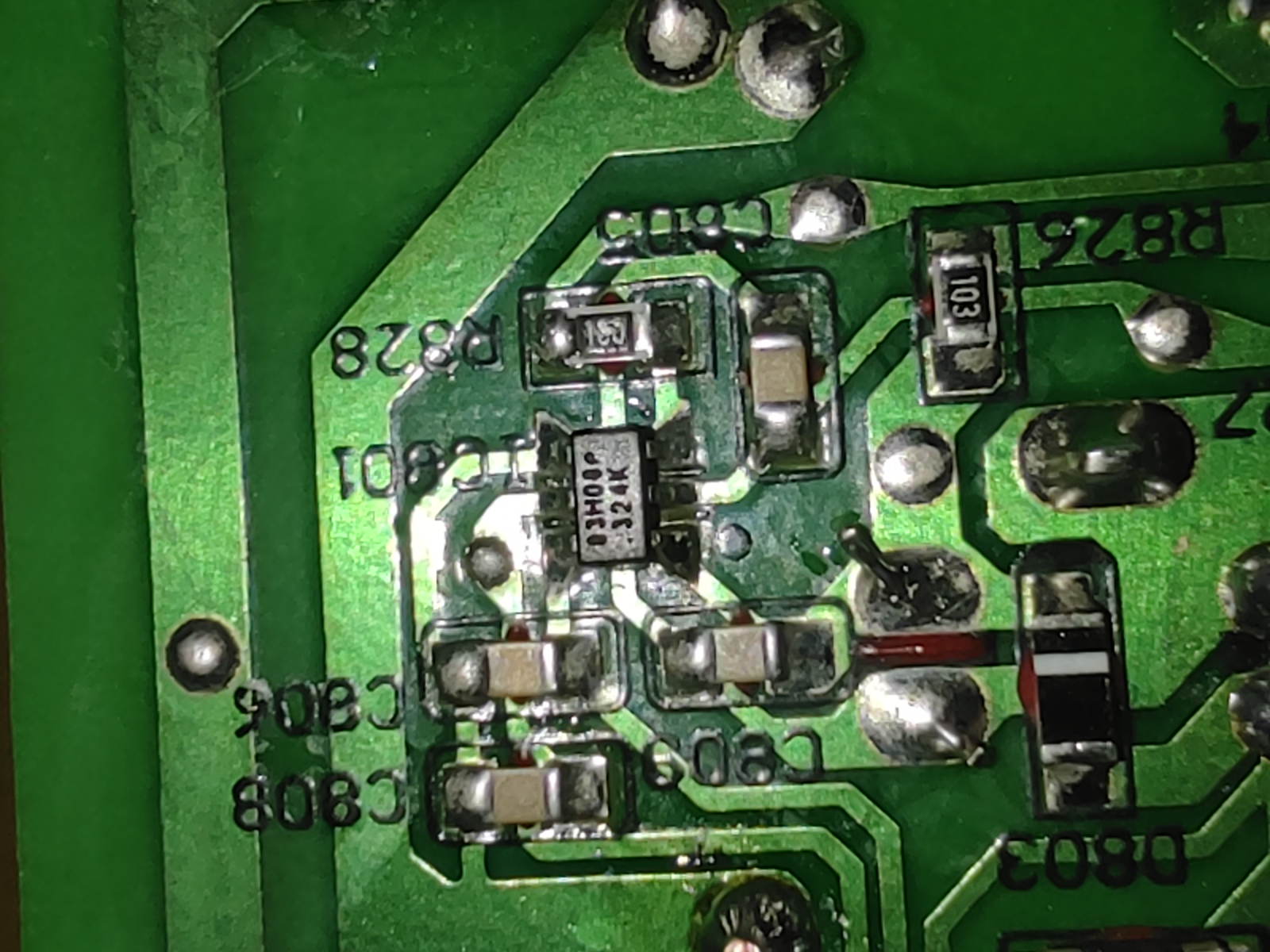

    - a burnt/chipped? (didn't read any resistance) SMD resistor (R828 - back side next to the PWM IC)
    - the PWM controller (IC801 - back side)
    There is no output voltage at all.
    I do get a stable voltage at the main capacitor (320V) but I think the PFC is not working.
    The PWM IC was marked 83H08P which is supposedly an OB2283 PWM controller (possibly a copy of the original?). VCC at this IC reads 6.3V which I think is not enough to get it started (needs 12-28V).
    The board looks quite different than the standard schematic from the datasheet. I don't really know how it is supposed to receive that voltage.
    I tested a lot of SMD components at the back (resistors, diodes, caps,...) which were ok so I don't see what else I can try from here.
    Any ideas?
    Thank you ,
    Hervé

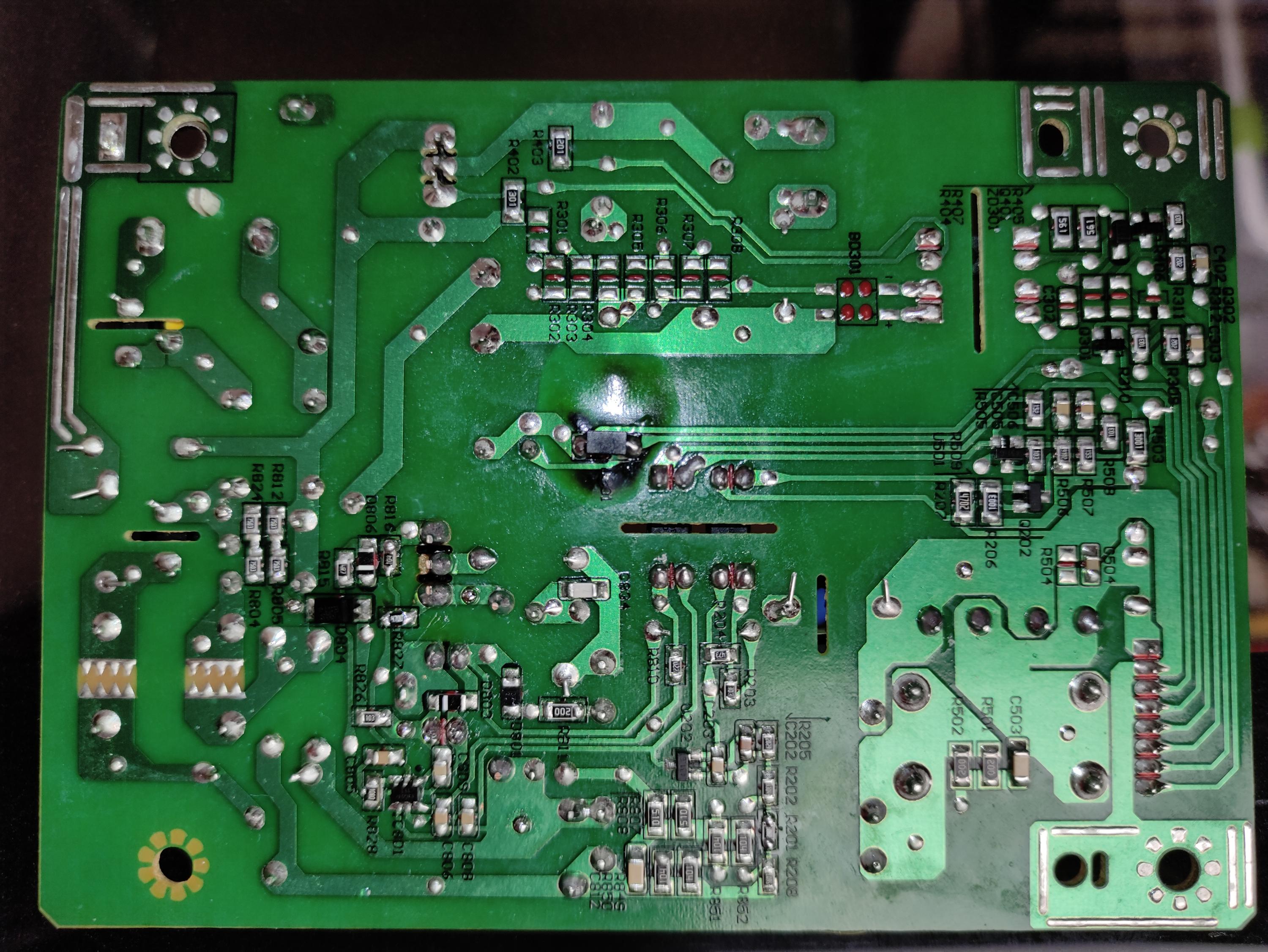

    PS: As you can see I damaged the back with the hot air station (too hot) trying to remove the diode... Because of this the board may be compromized a bit, but the traces are still intact, so maybe I can still learn something from it.
    PS2: Here is a link to a russian forum with much better images than I can produce. Especially the last post.
    Last edited by herved; 11-02-2022, 06:11 PM. Reason: Adding better images and description

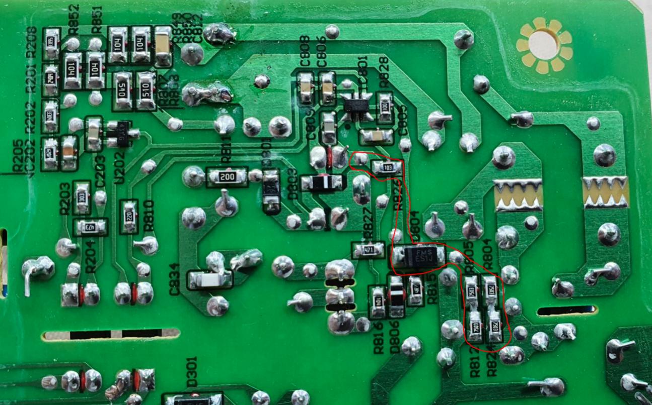

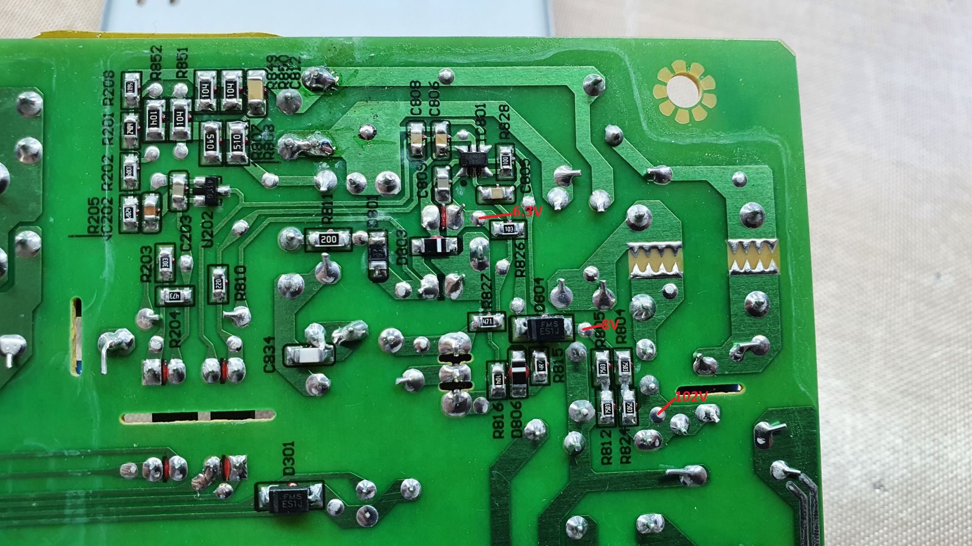

    You don't have resistor R827.
    • herved
      • Oct 2015
      • 21
      • Belgium
      Re: Ricoh SP 150w PSU repair
      Ah , sorry that image - 1665789398015 (1).jpg - is a bit outdated.
      I replaced R827, it is now there, see 1667434197.jpg.
      It is a 470 Ohm resistor.
      • lotas
        • Jan 2016
        • 4784
        • Russia

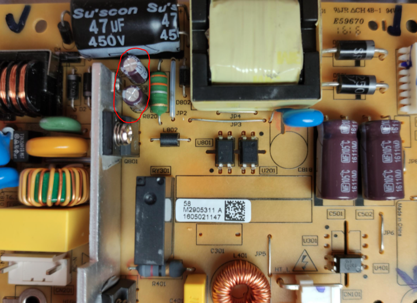

        Check these resistors, the resistance has not changed in them. And where did you get the idea that PFC is present in this circuit?
        • lotas
          • Jan 2016
          • 4784
          • Russia
          Check these capacitors for ESR.
            Here are in-circuit measurements:
            - R826 = 10K (looks ok)
            - D804 = 0.52 Vdrop and blocking in the other dir (looks ok)
            - R804-805-824-812 = all read ~0.70-0.75M (looks ok)
            I also checked carefully this path earlier.
            Here are the voltages when the board is powered on to 230V.
            Isn't it what a PWM controller is an SMPS does? Like we have here?
            I'm a noob please correct me if I'm wrong

              C807 (markings 2,2 uF, 50V) => 2,371 uF | ESR=1,52 Ohms
              C833 (markings 10 uF, 50V) => 10,22 uF | ESR= 0,49 Ohms
              C803 main cap (markings 47 uF, 450V) => 43,01 uF | ESR= 0,63 Ohms
                • Jul 2011
                • 6069
                The 2.2uf cap might be bad I like to see low value uf cap lower than 1.0 but this is just me

                  Ok I replaced both caps, I still get ~6.3V on VCC of that PWM chip.
                  But I do get some output voltages in fact:
                  - 3,4V on "+24VS"
                  - 2.7V on "AC test" which seems to be "pulsing" to a higher voltage (+24V?) every 2 seconds or so
                  I wonder what that "AC test" means.
                  Is this a switch to turn it on by shorting it to ground or similar? Like on an ATX PSU?
                  I can't really understand the board/schematic.
                  It goes to a transistor marked (K1N D1) which is connected to one of the optocoupler (emitter-collector).
                  Any ideas?
                  I'll try to put it back in the printer but I doubt it will make a difference.

                              SUCCESS !!! The PSU and printer are now working!
                              I read several people who had to chop off (or lift) pin 5 after getting a replacement OB2283 PWM controller chip.
                              Which I eventually did in a desperate attempt, after testing literally EVERYTHING on this board.
                              And... it works now.
                              I don't know if there is any impact doing so though... Anyone knows?
                              I guess it is not exactly the same chip as the one that was there originally.
                              I had ordered it on aliexpress here https://www.aliexpress.com/item/33045121475.html
                              It is advertised as "OB2283MP OB2283 SOT23-6 Chipset".
                              I spent a lot of time and it may be just a 100€ printer, but I learned a LOT about electronics and SMPS while attempting to fix this. I even sorted properly by stash of electronic parts. This is great!
