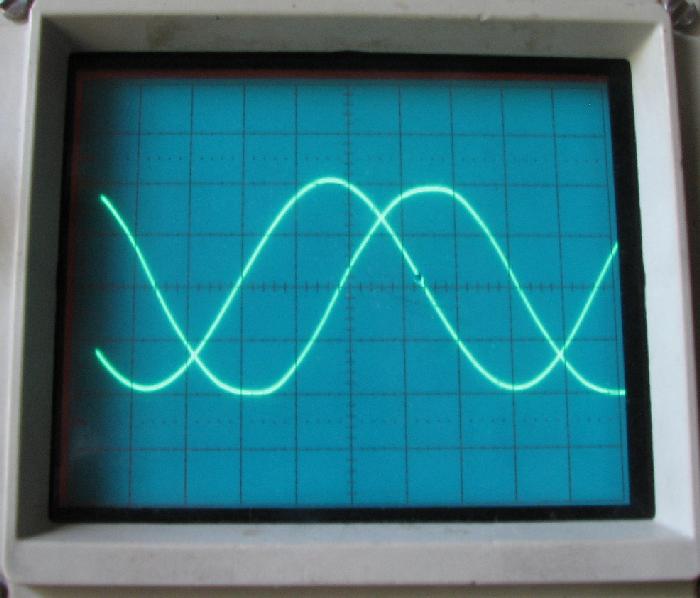

      Re: PC Restarting/ Shutting off abruptly.
      Really saggy-looking AC mains sinusoid - the top portion 'clipped' off due to ... extensive use of peak-rectifying power supplies (all kinds of consumer electronics?):
      http://www.youtube.com/watch?v=ozzp4RW5G54
      This is the result of being on kind the long-end of a power distribution line -
      - and something that PFC (which draws current during the entire 360 degrees of the AC sinusoid, rather than just during the peak and 'clipping' the incoming AC wave, as peak-detecting or peak-rectifying Power Supplies do using only diodes and caps ...

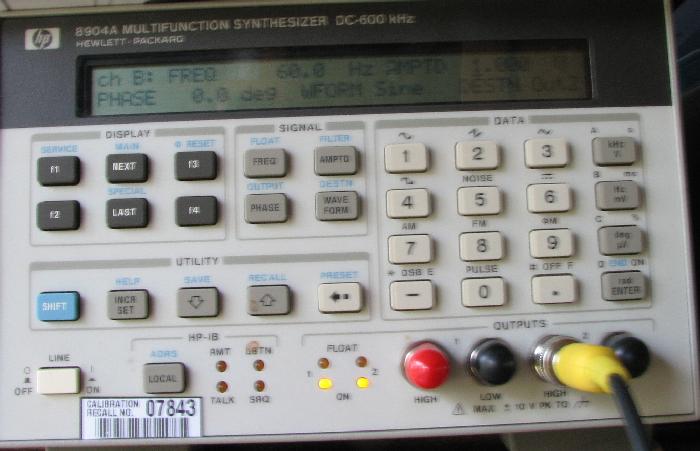

                            As I was saying ... I can view the 'signal' six ways from Sunday, swap channels, et cetera, the AC Mains signal always has the peaks clipped:
                            The 'clean' sinewave (for comparison) was generated by this instrument (note: It too is not currently certified to an NIST-traceable standard, but I have a warm fuzzy feeling it's working okay and would even 'fly' with it):

                                As I was saying ... I can view the 'signal' six ways from Sunday, swap channels, et cetera ...
                                I should add, I try to verify proper test equipment operation by either verifying with another instrument - or by cross checking with another type of instrument (perhaps a PC based scope or spectrum analyzer) ... I'm sure everybody does this ... right?
                                In the case above, swapping between CHs 1 and 2 on the O-scope resulted in the 'distorted' waveform always being associated with the AC Mains signal ...

                                    The scope isn't showing you what you think it is.
                                    1- The grid has 100's & 1000's of generators running in parallel. They aren't all going to be perfectly in sync, there will be load shifting between generators through the grid, and expecting a clean sine-wave on the grid is nothing less than naive.
                                    2- When you have to send voltage very long distances over wire, in order to have the correct voltage at the distant point from the source you have to crank up the voltage at the source. This means that loads near the source require a means of reducing the voltage is required. They aren't going to use an AC motor to spin another generator just to get a nice clean sine-wave at the correct voltage. They regulate it at the sub-stations and the method is to clip it.
