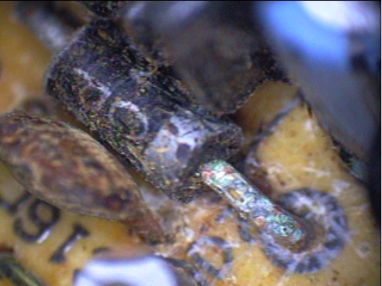

    • everell
      • Jan 2009
      • 1514
      Re: Snap, crackle, and fart....
      Not only does the glue get conductive over time, it is also corrosive. Here is a picture showing a diode which was completely covered with the glue. The glue had turned almost black. After removing the glue, you can see the greenish color on the diode lead which is copper oxide. This psu is a recently acquired Bestec ATX-250 12E.
      Old proverb say.........If you shoot at nothing, you will hit nothing (George Henry 10-14-11)
