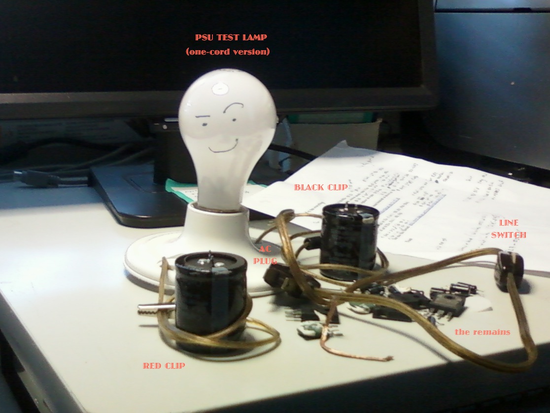

      The PSU with the broken LF2 does not light the test lamp. The other PSU lights the test lamp in the following pattern:
      Bright--> dim--> several bright blinks--> off
      My test lamp was derived from Toasty's circuit. It uses a scrap of lamp cord. One line (red clip) goes through the bulb, the other (black clip) goes directly to the PSU.

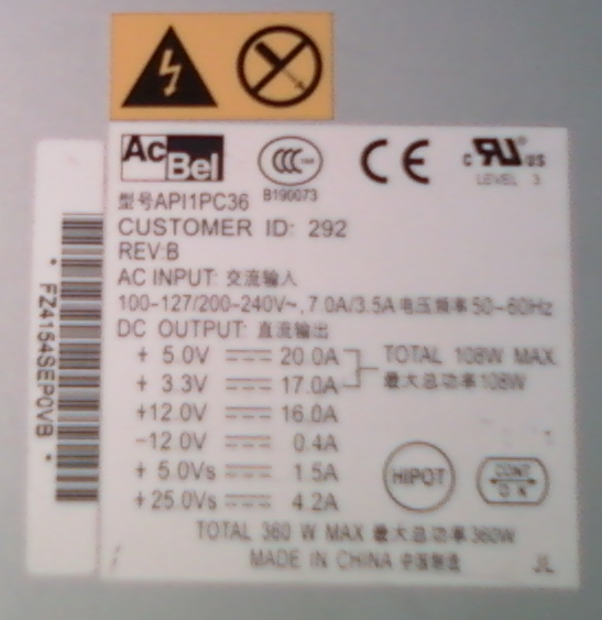

                  My project includes
                  3 - Apple p/n 614-0224 Samsung power supplies
                  1 - AcBel (see pic of label)
                  These units are in Apple Powermac G4 MDD machines

                  The Acbel was taken out of service because it made the computer goofy (had to be disconnected before each restart, lost PRAM, frequent freezes; false clues about the PMU and NVRAM, CPU, and logic board). The Acbel is a future job (after solder iron burns heal up).

                    An X/Y cap won't keep a supply from running, unless it is shorted.
                    The blink routine for the test lamp is normal. It's the caps and circuits charging up that makes it blink. When it comes on and stays on with no load, that's when there are problems.

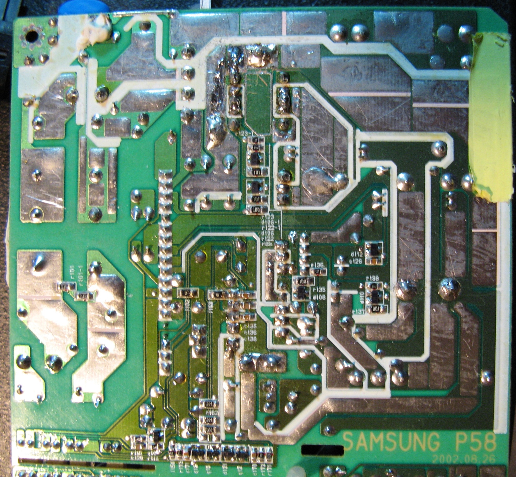

                          The attachment shows my first attempt at repairing anything electronic. It shows the "job" I did on the circuit. This is the mistake I am learning by.
                          I may have damaged a trace or let solder flow where it shouldn't, especially top center in the area of the single post of the heat sink and the pair of Mosfets. The board has a hacked at look, huh. I plan to pull another Samsung PSU as a guide to de-blobbing. Comments would be greatly appreciated.

                            Lesson in humility for the day: a 30 watt famous brand iron is not hot enough for solder wick. Lesson learned. My hacked Samsung board may clean up with -proper- solder wicking.

                              Solder wick is usually very good when it works, but if you don't have enough heat or a good thermal "bridge" then it just does nothing.
                              I see the areas you were trying to solder look connected to rather large fills, so probably you were sucking up too much heat there. Solder wick can also suck up some heat so your iron might be able to heat one or the other but not both at the same time.
                              Try a short piece of solder wick if you were holding the whole reel, to keep less mass and suck up less heat into it.
                              Also try adding fresh solder to the joint before desoldering and possibly add your own flux to the desolder wick. Some wick comes with flux in it, but some doesn't. Even if your does, if it's old, the flux may no longer work very well.
                              If you have a solder sucker, try that, since you only need to heat the board and not wick as well.
                              -David VanHorn

                                A 45w-60w typically needed here, with a substantial tip (larger mass). Or, a station capable of up to 800°F (425°C). I use a 100w gun type when working on the heat sink attachment points.
                                I find it surprising that you are working on the MOSFETs here without removing the heat sink assembly as a whole. Very difficult, no maneuverability, and near zero clearance. Coupled with the fact that 4 caps need to be replaced between the heatsink and the small upright board adjacent to it.
                                If you decide to remove it, be sure to be -VERY- careful with the temp thermistor. By your picture, it's located on the left side of the heat sink, the 2 vertical connections to the left of the marking r122a. Make sure the wires are straightened, the holes clear of solder, and the wires loose before trying to remove the heatsink.

                                    Some of the hacking came from the earlier desoldering, done mostly with the famous brand iron with the red bulb. It also takes awhile to heat up, enough to go have a snack while waiting. I now have a hotter iron and the solder wick works. Thanks for the advice. Every little bit helps.
