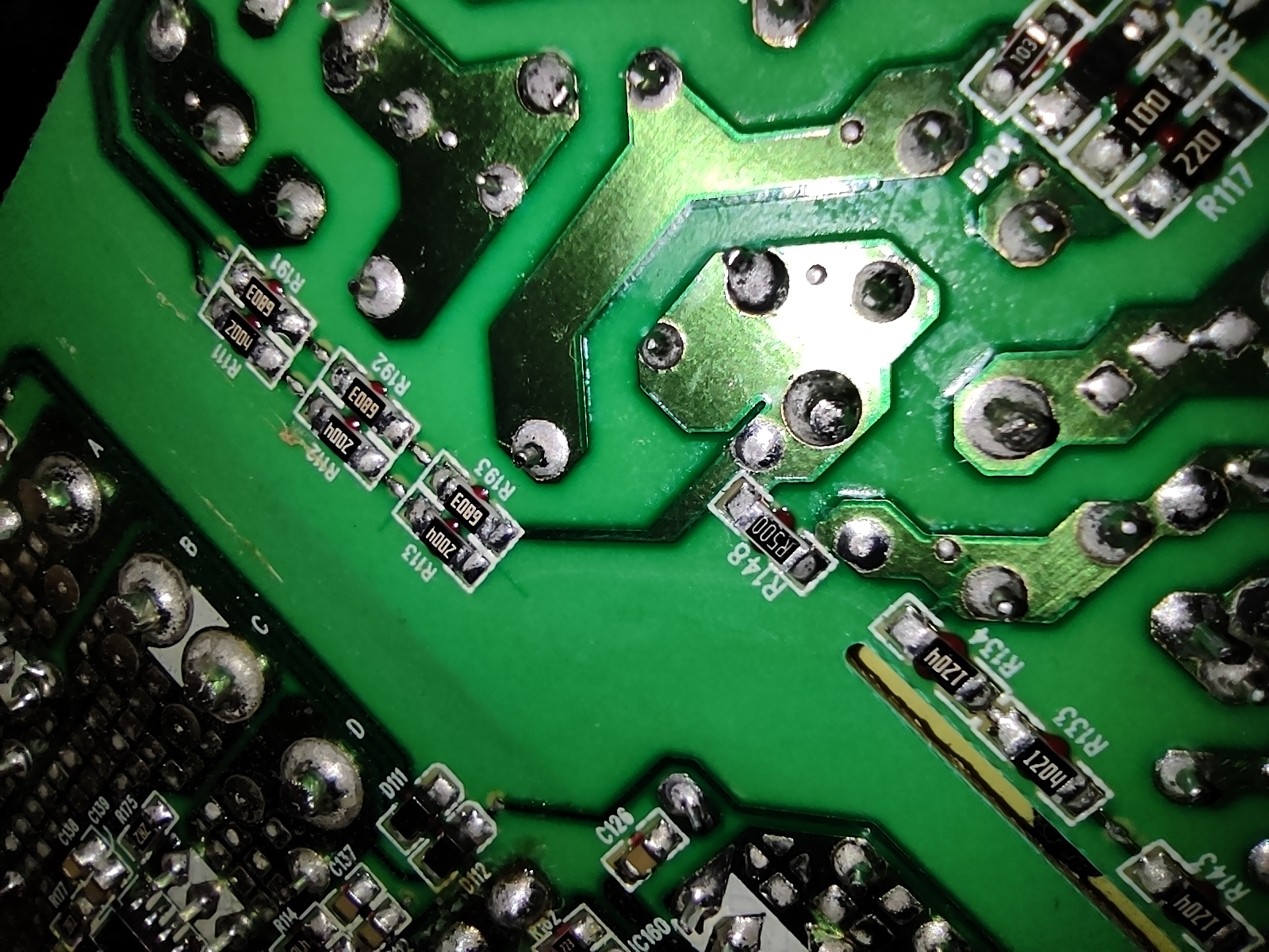

    I have one bad power supply for repair old Dell Desktop PC.
    Model of the power supply is H255E-01 for Dell Optiplex 760.
    It looks that controller IC106 is done. I can not read anything on this IC. Is someone who have a schematic for it? Resistor near the IC is bad too. It is R148 - i need to identify it too. Everything else looks OK, mosfets and fuse is OK. I would like to try fix it.

    Re: Old DELL Power supply H255E-01 - bad IC106 & R148
    Show a photo of the power supply board on both sides

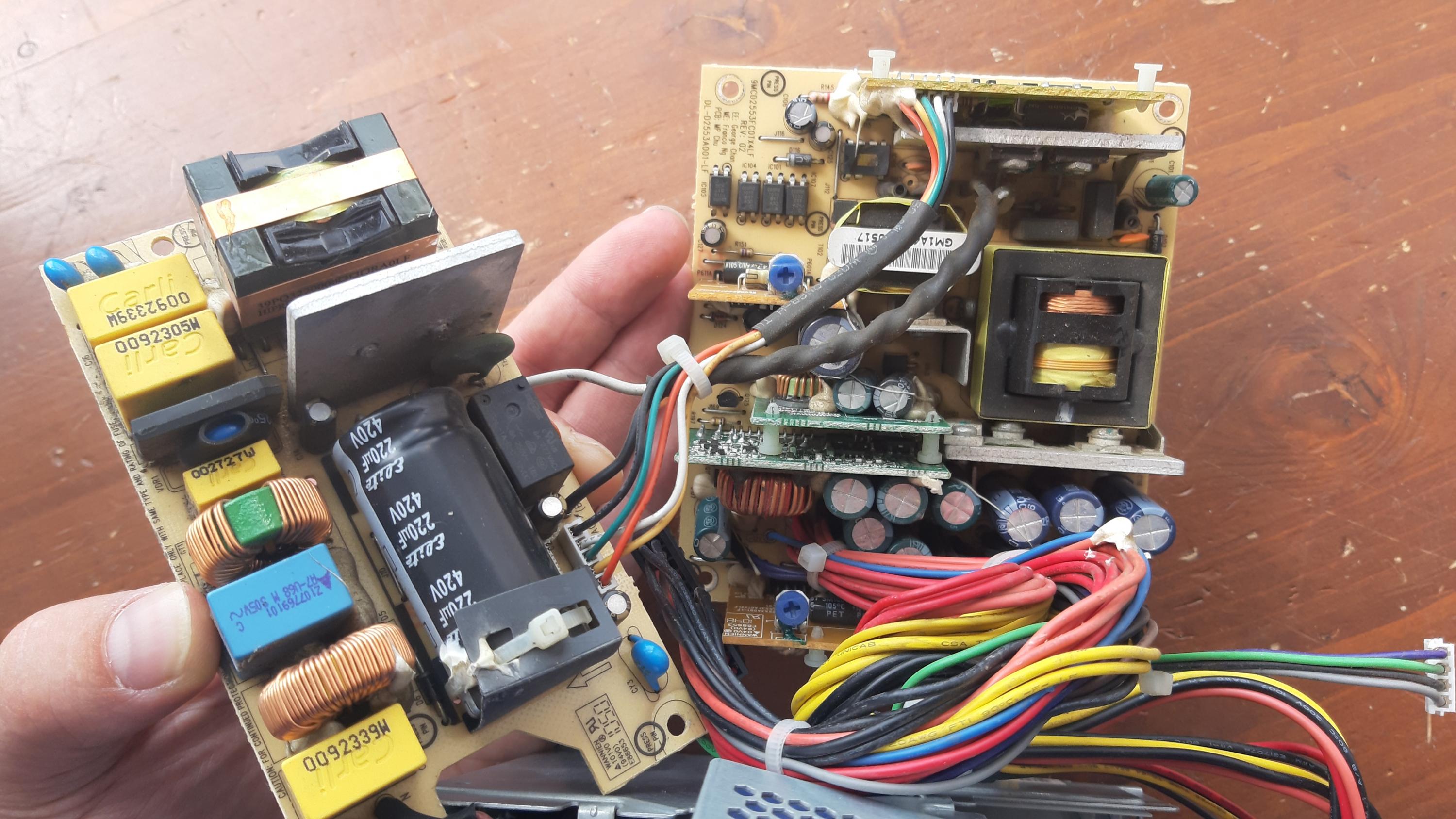

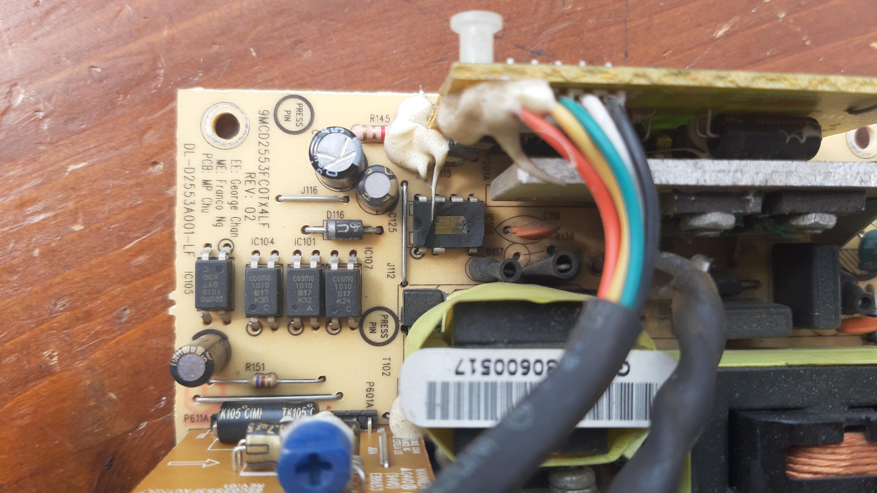

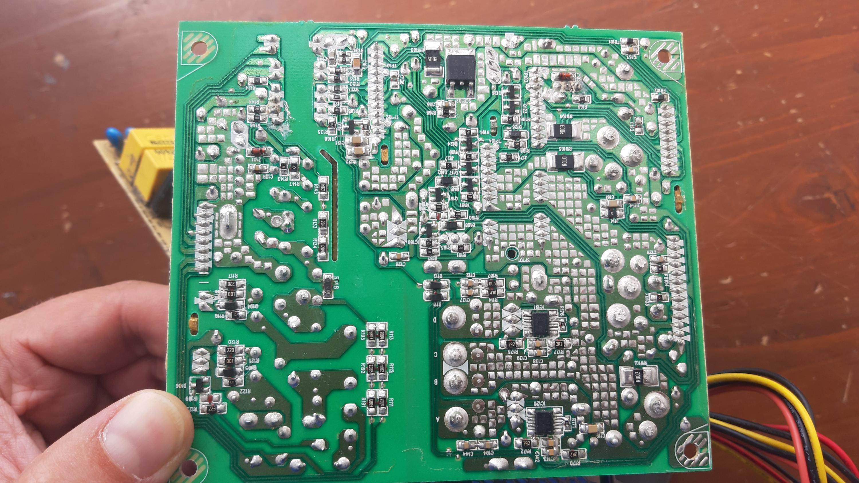

      Pictures.
        Ic106 - tny278pn - tny280pn

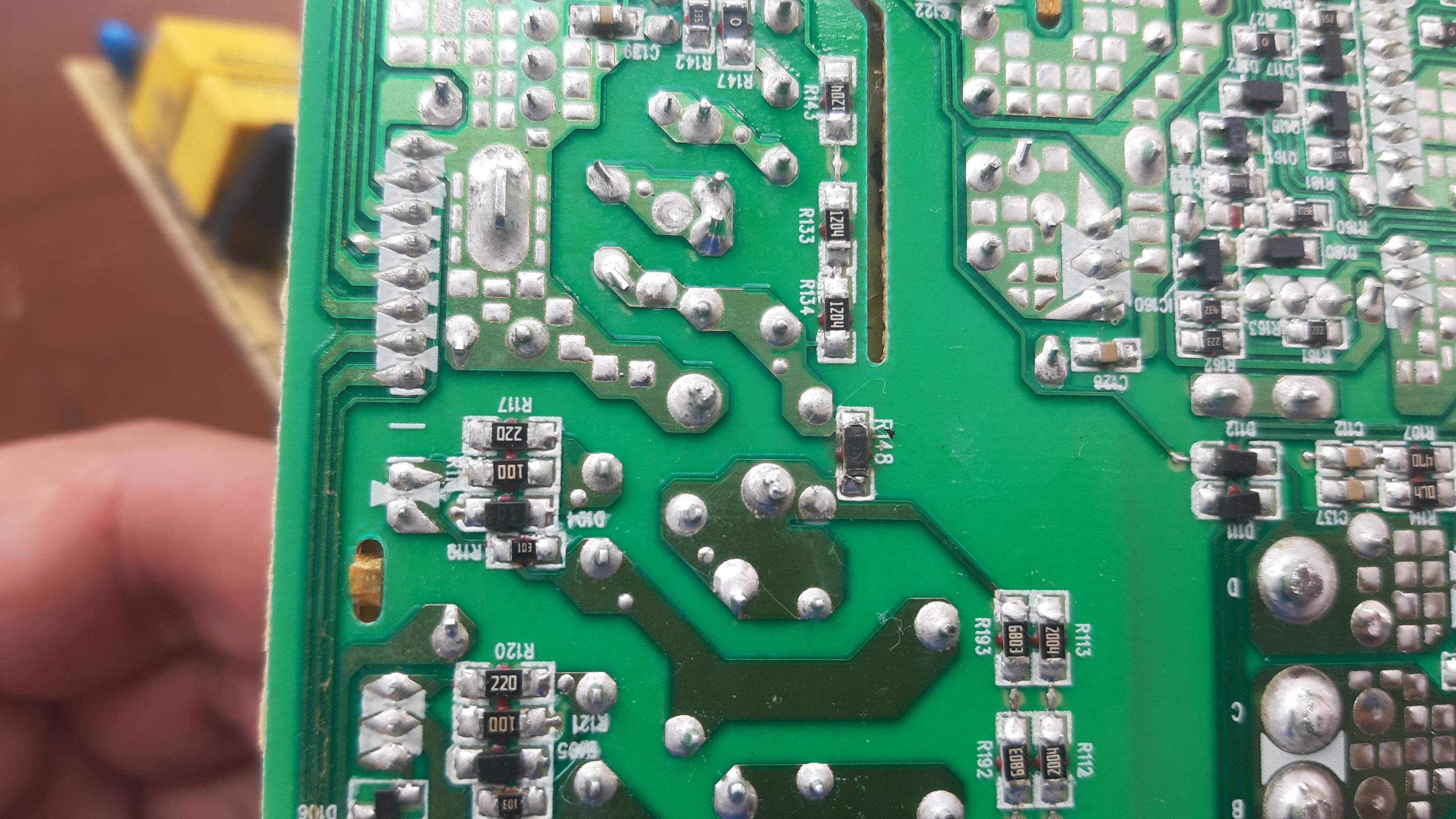

          Thank you very much. What do you think about the resistor?
              See what this resistor is connected to on the other side of the board
                R148 is 0.5 ohm resistor
