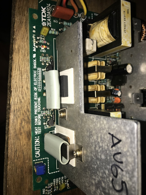

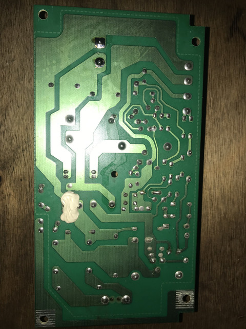

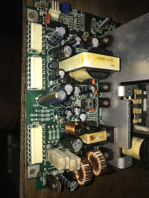

    Re: TDK VYK3637 SMPS Power Supply

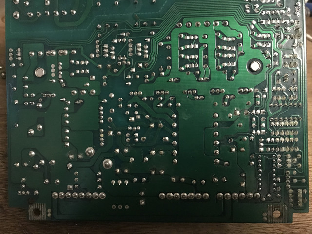

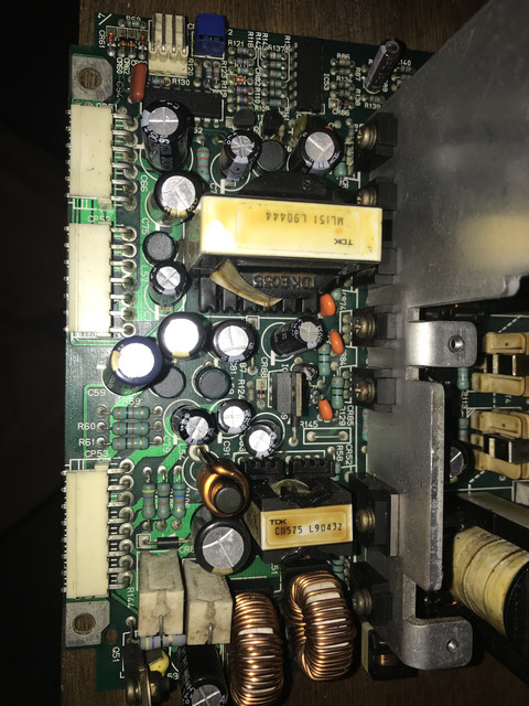

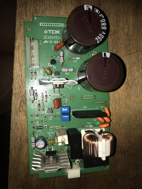

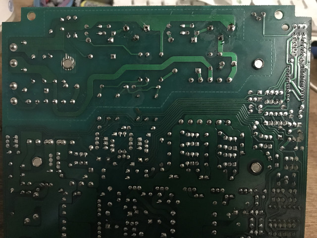

    Please post a picture of both sides of the circuit board in question we might be able to help you figure out what could be going on with it
      Here are some images of one of the power supplies.

        • 31044
        there is a tiny cap with black marker on top you didnt change - it's most vulnerable from heat
          Thanks I'll change that.

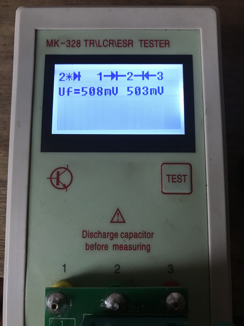

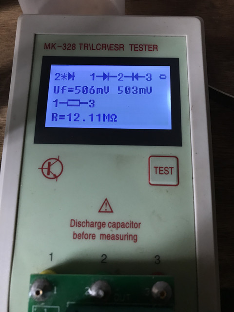

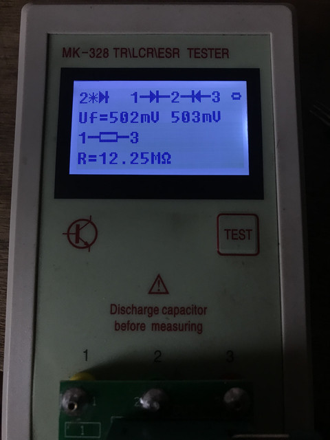

                          I pulled 2 rectifiers (B92M) out so far to test them ,and got an extra reading on one of them. Any ideas.?

                            I removed another B92M and got the extra reading on that one too.

                              Hi
                              Does anyone know if there are replacements for the Low Loss Super High Speed Rectifier.....ESAB92M-02 200V 5A------ ESAB92M-02N 200V 5A------ ESAC92M-03 200V 10A
                              Cheers
