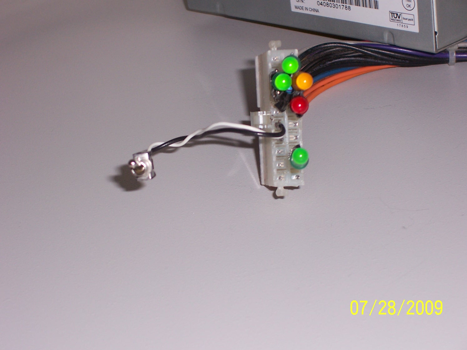

      I would suggest that you build (or buy) a power supply tester that has a LED indicator for each of the power supply voltages. I removed the ATX power connector from a bad motherboard, then added the LED and dropping resistor for each voltage. I installed a ON-OFF switch between PS-on and ground to turn the power supply on and off.
      I used amber for the 5vsb, green for +12, +5, and +3.3, and red for PS good. This gives a good visual indication of what is happening. You might have a problem in the timing of the PS good signal which will cause start up problems.
      I posted a thread earlier about this power supply tester with more photos and schematic drawing. Refer back to it if you decide to build one.

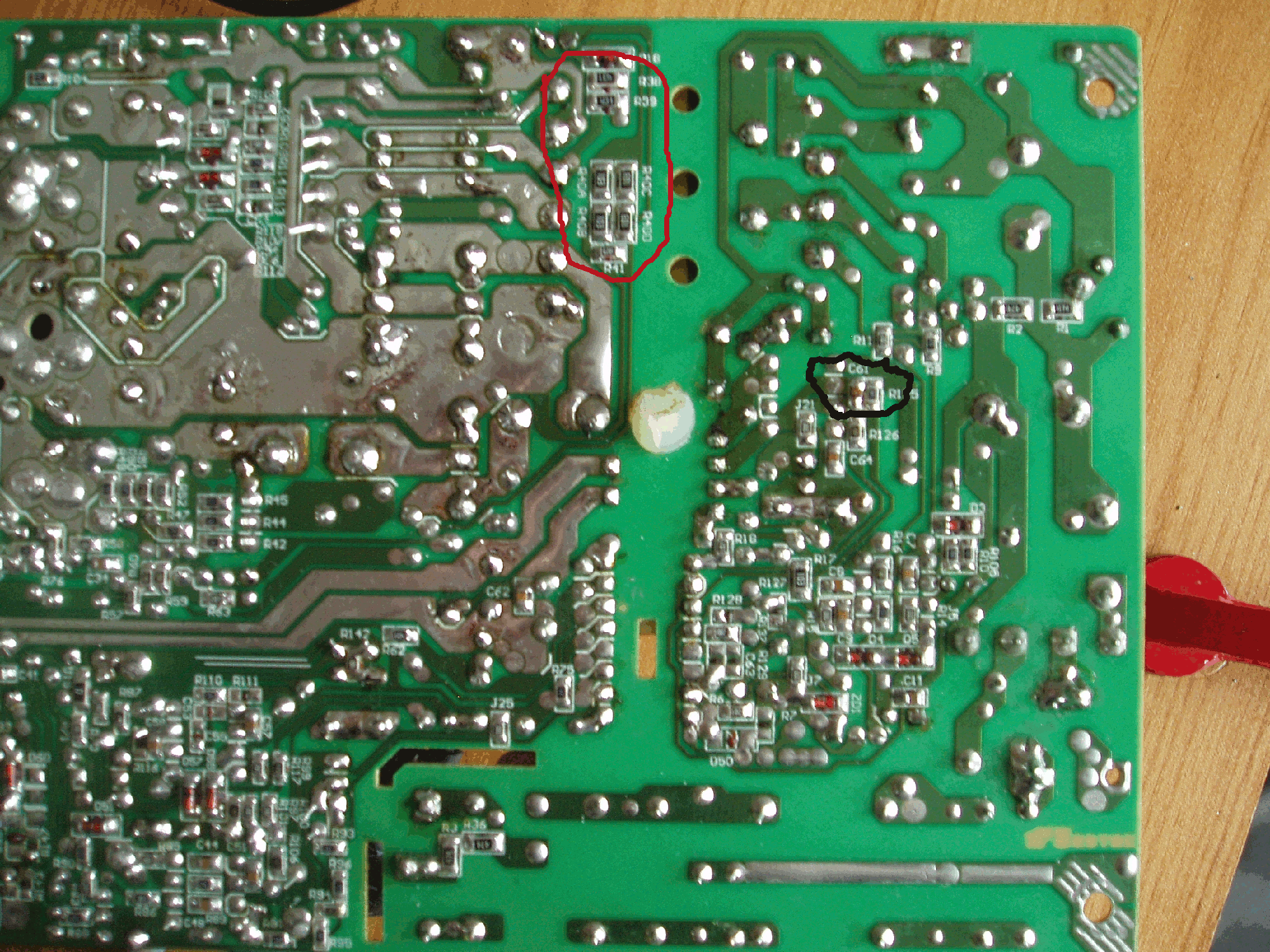

                  I had an unusual problem with a Bestec ATX-250 12Z (circuitry very much the same as your 300 watt version). After reviewing my notes which I made more than a year ago, seems that the 12 volt line was loading the power supply. This symptom seems in line with your problem, the fan sometimes loads properly, sometimes doesn't. The fan is on the 12 volt line.
                  The reason I recommended the tester with LED indicator lights was so that you can observe for any irregularities with the PGO (power good output) signal.
                  On my 12Z, coming off the main switching transformer providing the 12 vac, is a parallel resistor combo R38 and R39, each being 431 ohms. This feeds a diode, which then feeds a resistor network leading to the PGI (power good input) of the supervisory chip. This network is where I found my problem.
                  There is a group of four 10K resistors labeled R48A, R48B, R48C, and R48D. R48A and R48B are in series, making 20K. R48C and R48D are in series making 20K. Then these two strings of 20K each are in parallel making the network the equivalent to 10K. This 10K network and resistor R41 20K form a voltage divider to provide the proper amount of voltage level for the power good to operate properly. All of these resistors are tiny surface mount resistors on the bottom of the pc board.
                  On my 12Z, one of the 10K resistors in the four resistor network was bad, making the effective resistance of the network lower enough to give unpredictable results for power good signal, which caused the problem. As I remember, I was able to see this problem using the power good LED indicator.

                    Did you check the resistors listed in my last post? They are the resistors inside the red circle of the attached picture.
                      Hi everell ,
                      yes i did check the resistors like you said and they were fine ..i have put it to one side for now as i am working on a monitor i got and also trying to understand how to operate my scope i just bought.
                      Thanks once again for your input as i do appreciate it . I will come back to the psu later as i would like to do a few tests with my scope once i get the hang of it lol.
