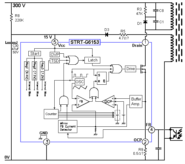

    Hi I am looking for a data sheet for a component that is expected to have failed but need proof. This component is in a switching power supply for an Aiwa XC-RW700 . It is a 5 pin IC with a heatsink. STRT-G6153
    I have no voltage to the inputs of the three 12VDC regulators. I will post a pic of the board in question when I get the chance. Thanks for the help.

      Yeah, i tried that one and other sites like that with no luck. I'll try to cross reference it maybe. Someone with a switching power supply had to have come across this part before. I see it's on ebay for about $7 after shipping.

        I have searched the datasheet but I have found nothing.
        The only thing I found is the attached picture showing the connection.
        Hope this help to troubleshoot the PS.
