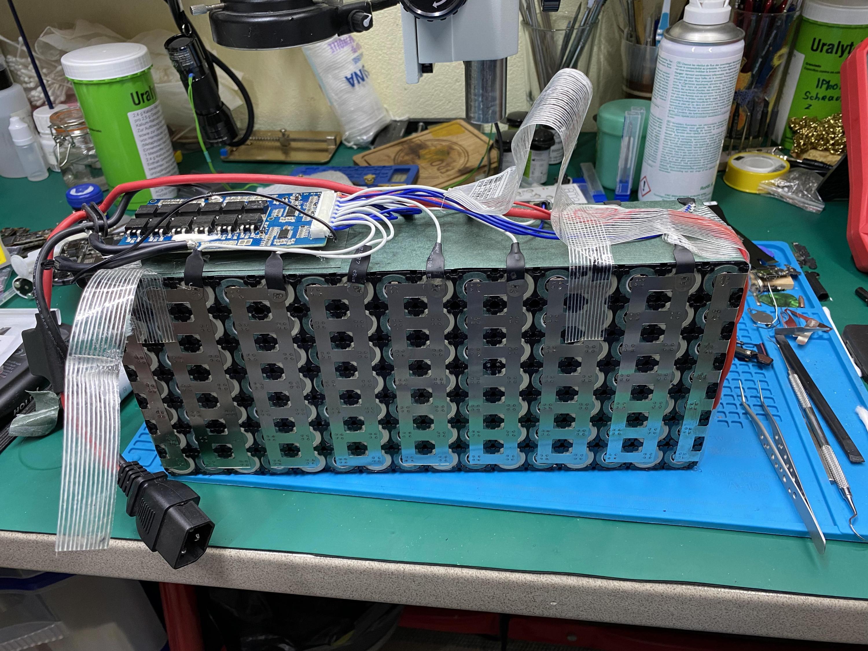

    before repairing the battery 49v after 5 minutes of charging 54v means that the battery is charging, now 54v

            Re: I need a charger schematic YLT6722000
            16S7P Li-ion... at 54V it's almost dead, so it'd suck up a lot of current.
            Don't know, would have to reverse engineer that circuit in depth to figure out what's wrong and why the fr207 is heating up.
              This is understandable, but the current consumption is 2.10A
                it turns out if the battery is completely dead this charger is very weak
