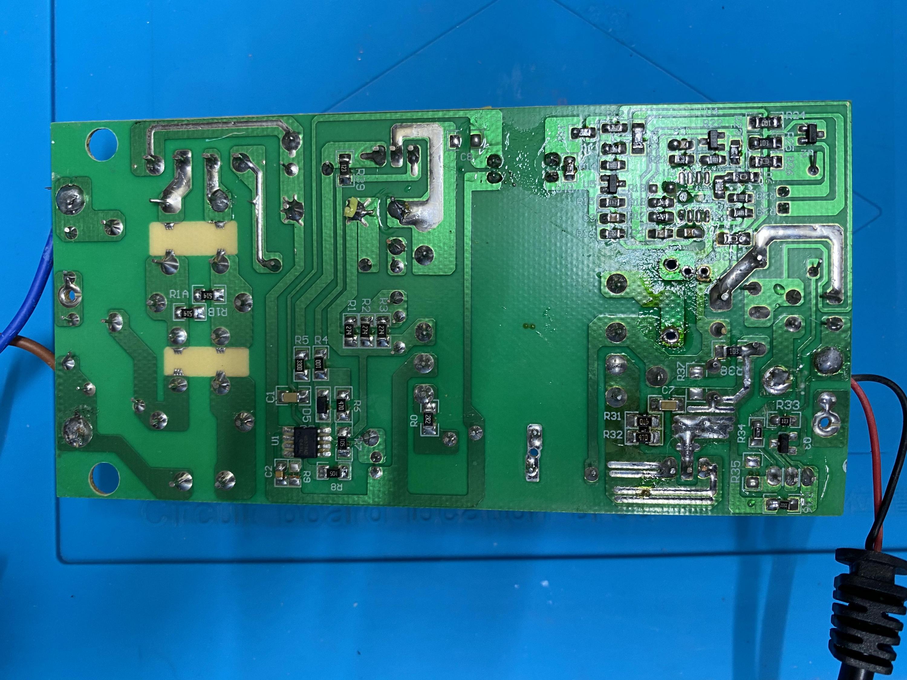

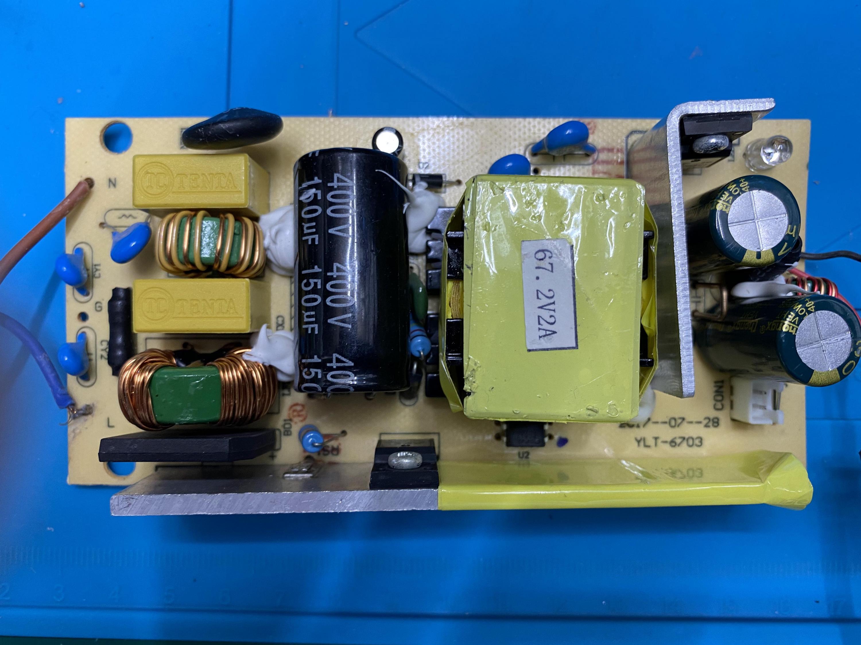

    Please post some pictures of this battery charger board front and back of the board we might be able to help you with it
    Please decried what is the issue with and what you have done so far

      top and bottom view

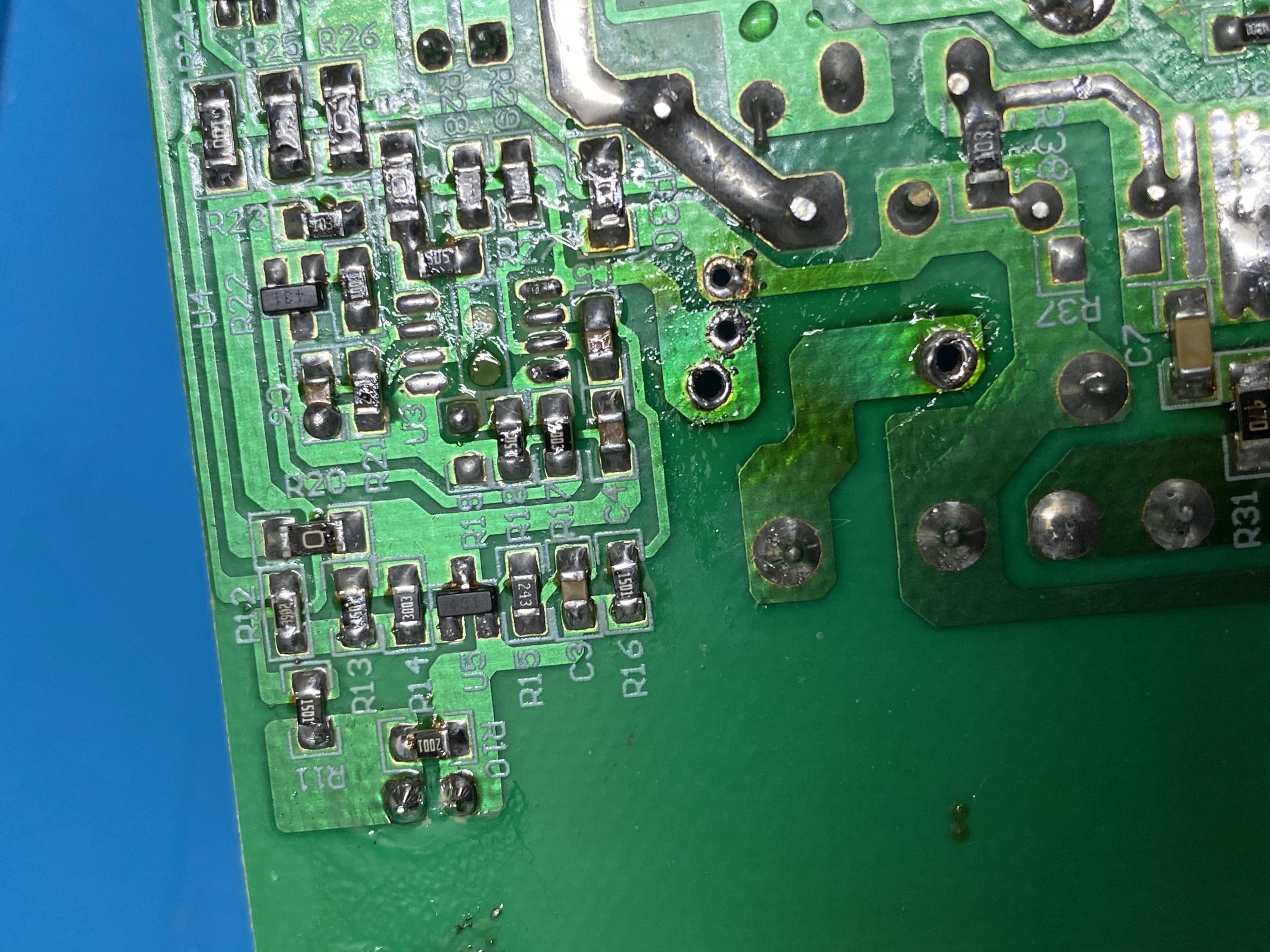

          D3 diode was short-circuited and on U3 the supply resistance is 109 ohms
          LED was always green

                  replaced the diode fr207 and u3 LM358, the battery charges after 5 minutes of shorting the diode and LM358.
                  exactly as it was
                    Re: I need a charger schematic YLT6722000
                    need to figure out why it's over current, surprised lm358s fry as their outputs were specced to be shorted to a rail indefinitely, but not beyond a rail.
                    What capacitor was there?
                    This can't be the 2A output, must be a feedback output of some sort...

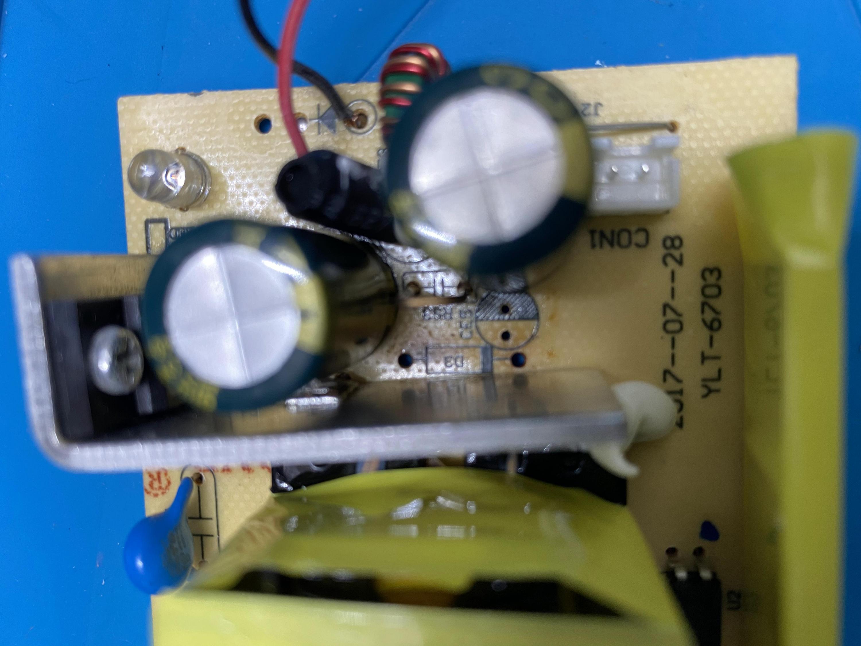

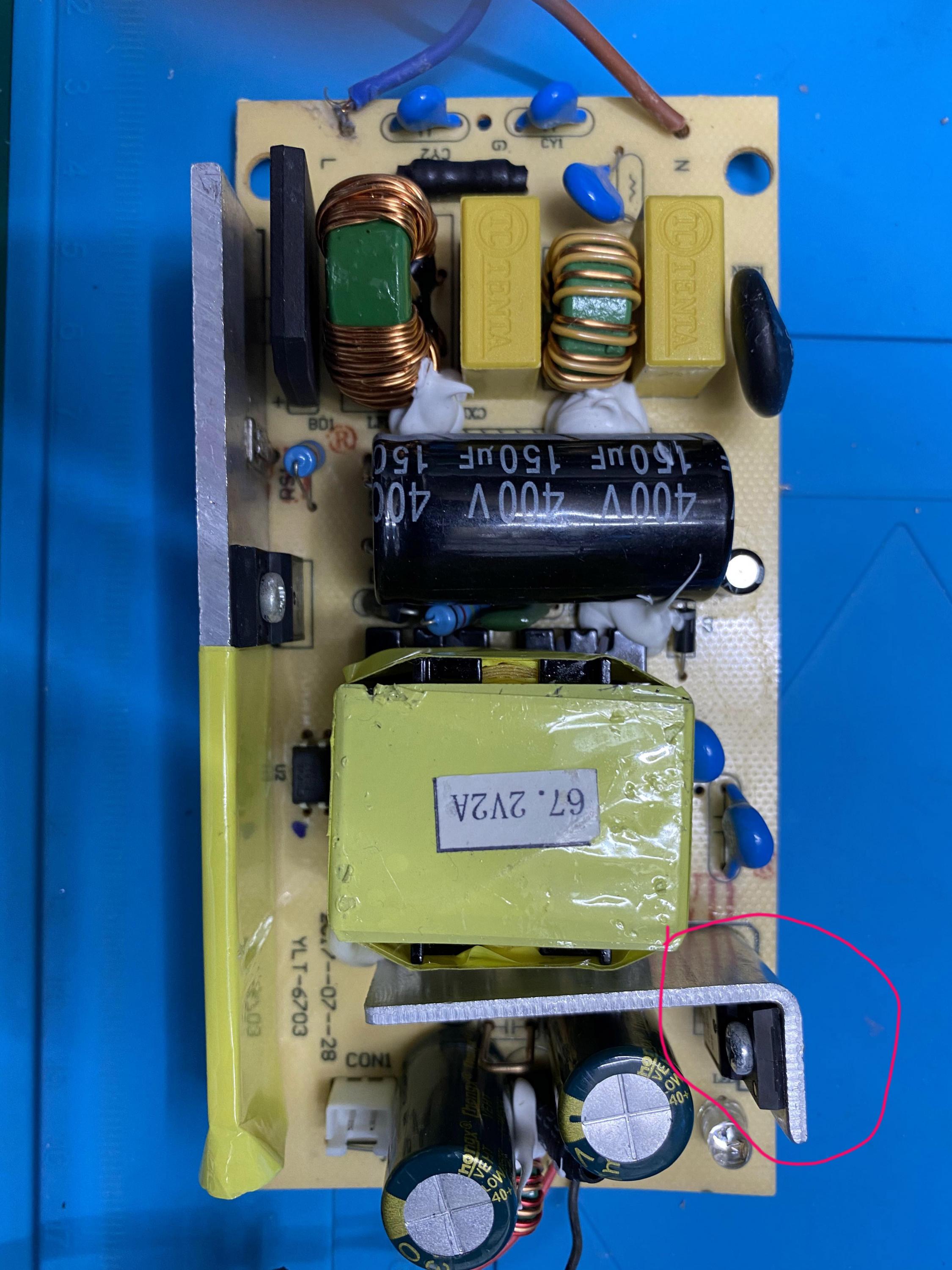

                              also heats up MUR1060FCT
                                Does it heat up with nothing connected?
                                Sure the battery that's being charged is okay?
                                Might be normal too, or simply underdesigned...
                                  without load all cold voltage at the output 67.4v, when you connect the battery is strongly heated FR207, the output is 54v

                                      FR207 heating up is still kind of strange, the MUR1060FCT I can understand heating up...
                                        BTW If you must "upgrade" the FR207, you can try the FR307 but I don't think that's the right course of action...
