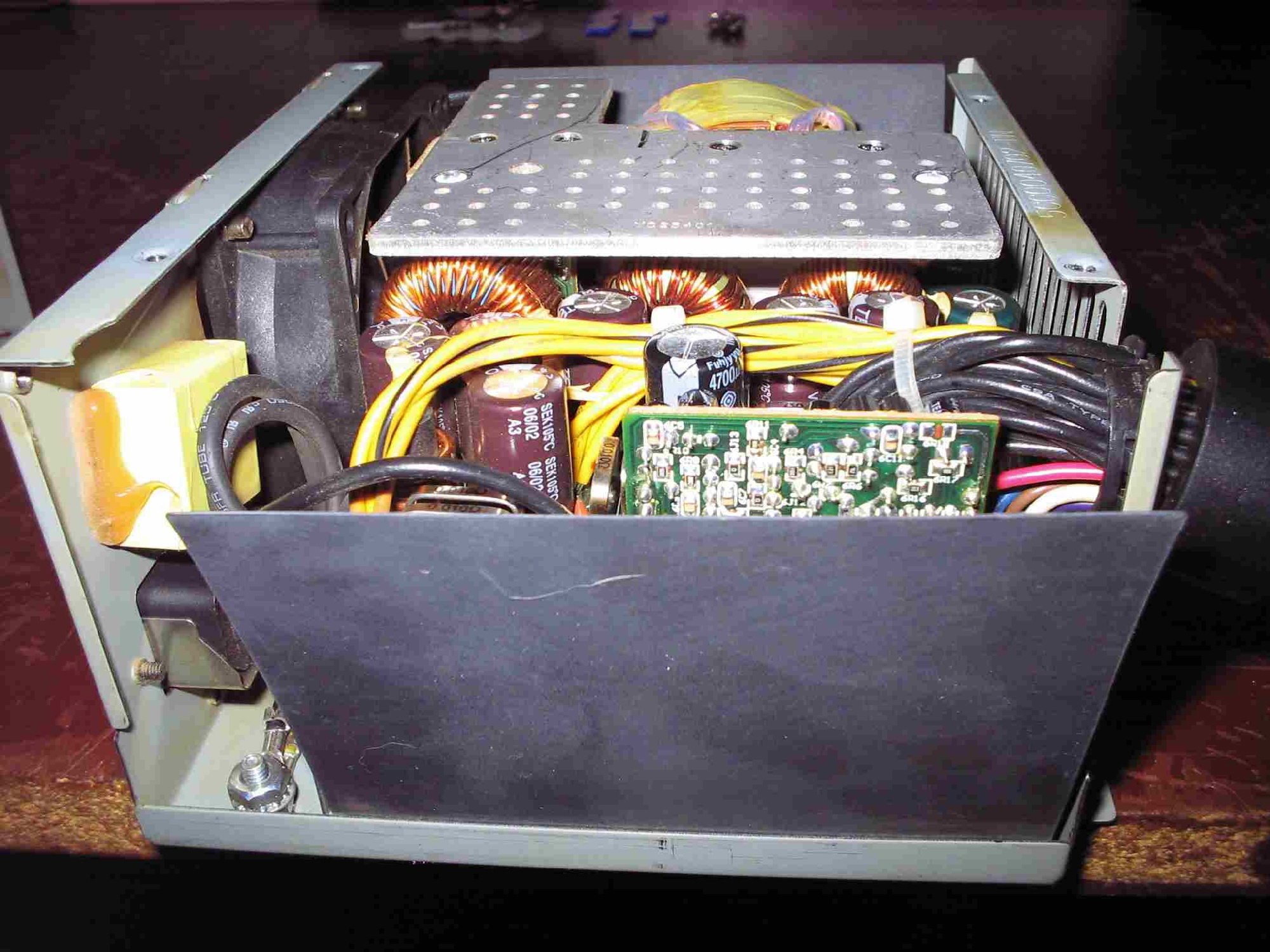

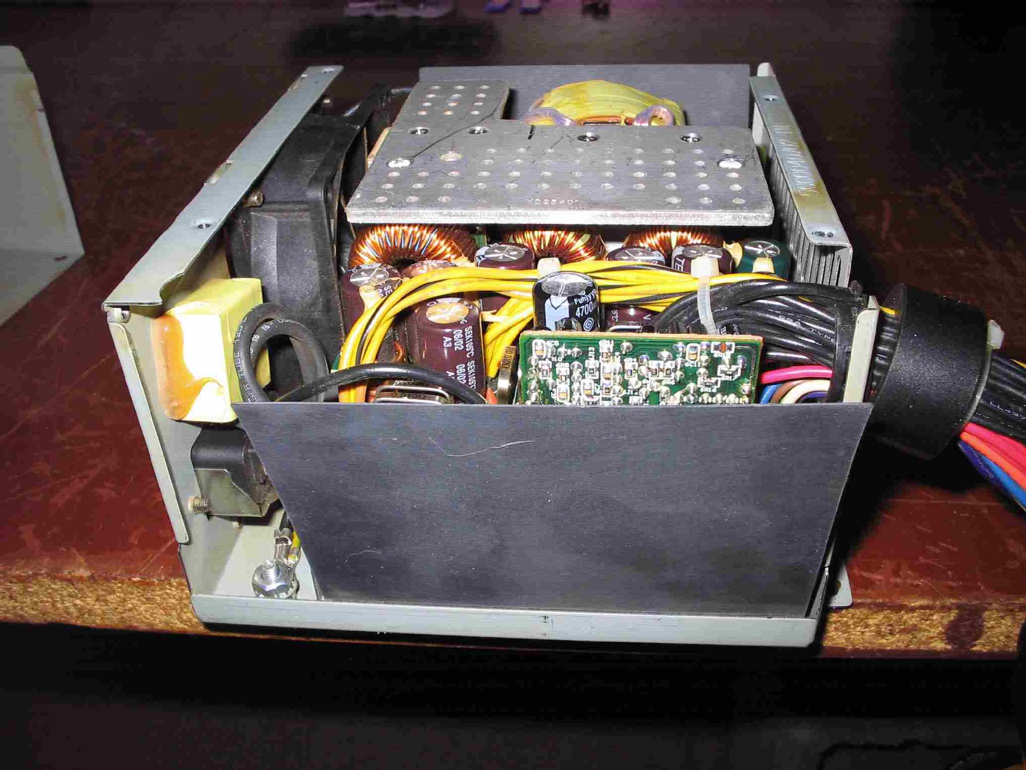

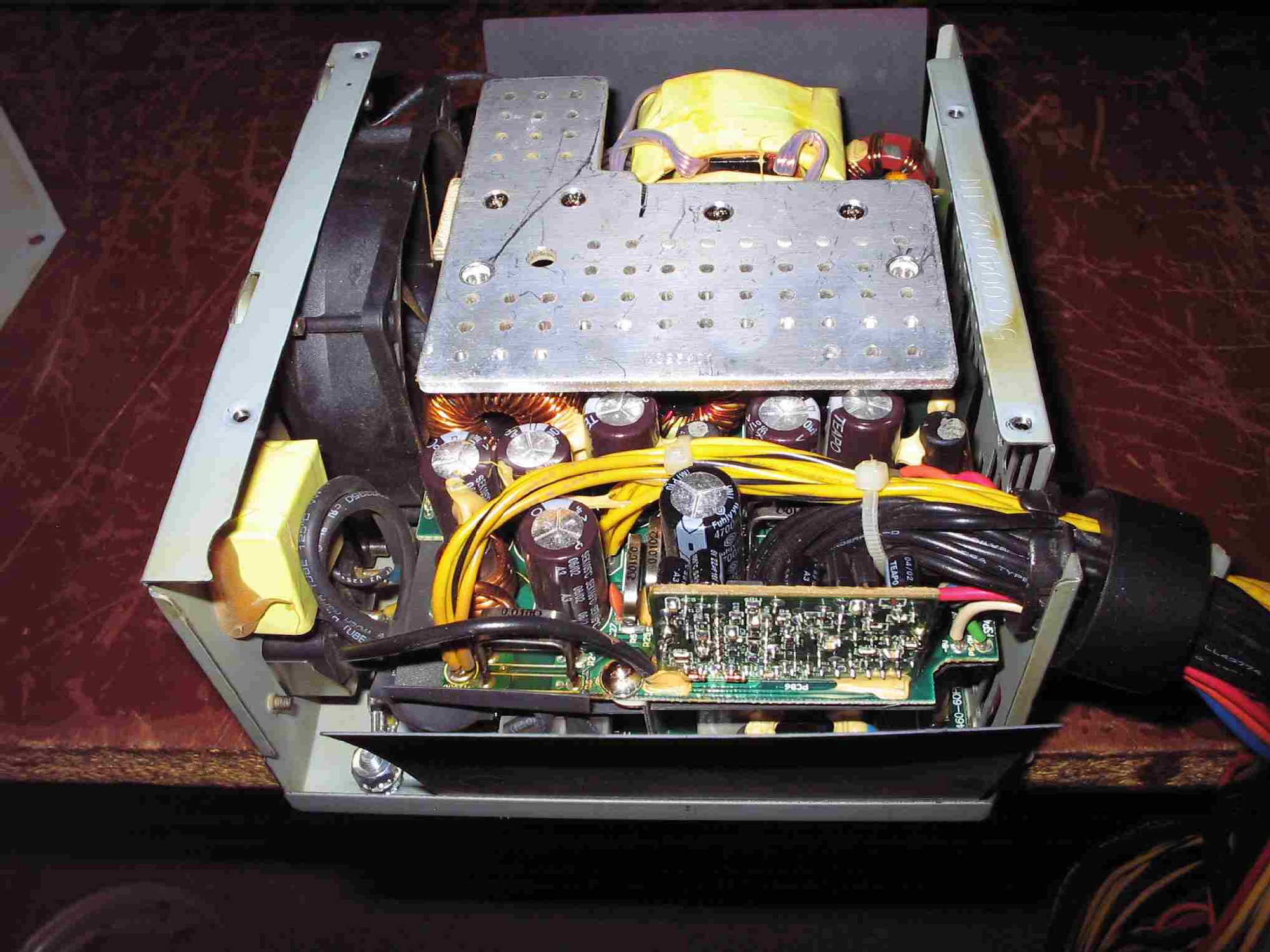

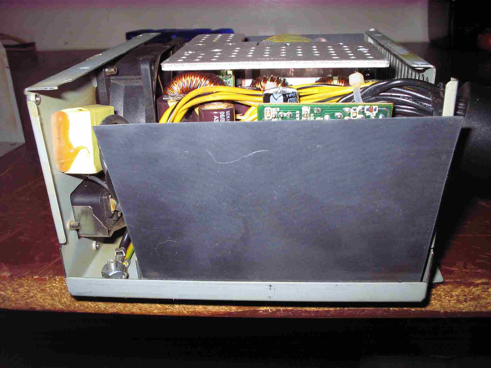

    Hello all! First of all, I've had this PSU for about 2 years now, bought used of "the Bay". A great PSU, zero problems and rock solid. I usually shoot some compressed air through it every 3 months or so, but yesterday I did finally take off the cover to clean it. First thing I see is this domed Fuhjyyu 4700uf 10v. Yay. The surrounding caps are all Teapos and look fine. Now, using the search it seems the Fuhjyyu's are a common problem in this PSU. My question is, where do you begin disassembling this PSU to get at the cap? Does the whole thing need to come apart? I see some of you folks have experience with this particular PSU, could you give me a little guidance here? Where do I start? Thanks for any suggestions/help.

      ANYWAYS, back to the OP's question. I would start by unscrewing the top pcb and freeing up the wires coming out the back. Try lifting it gently off the top and see what else is holding it down. If it is a connector, note the location and orientation and disconnect it. If it is a soldered in wire, note the colors of the wires and what holes they are connected to and see if you can unsolder them.
