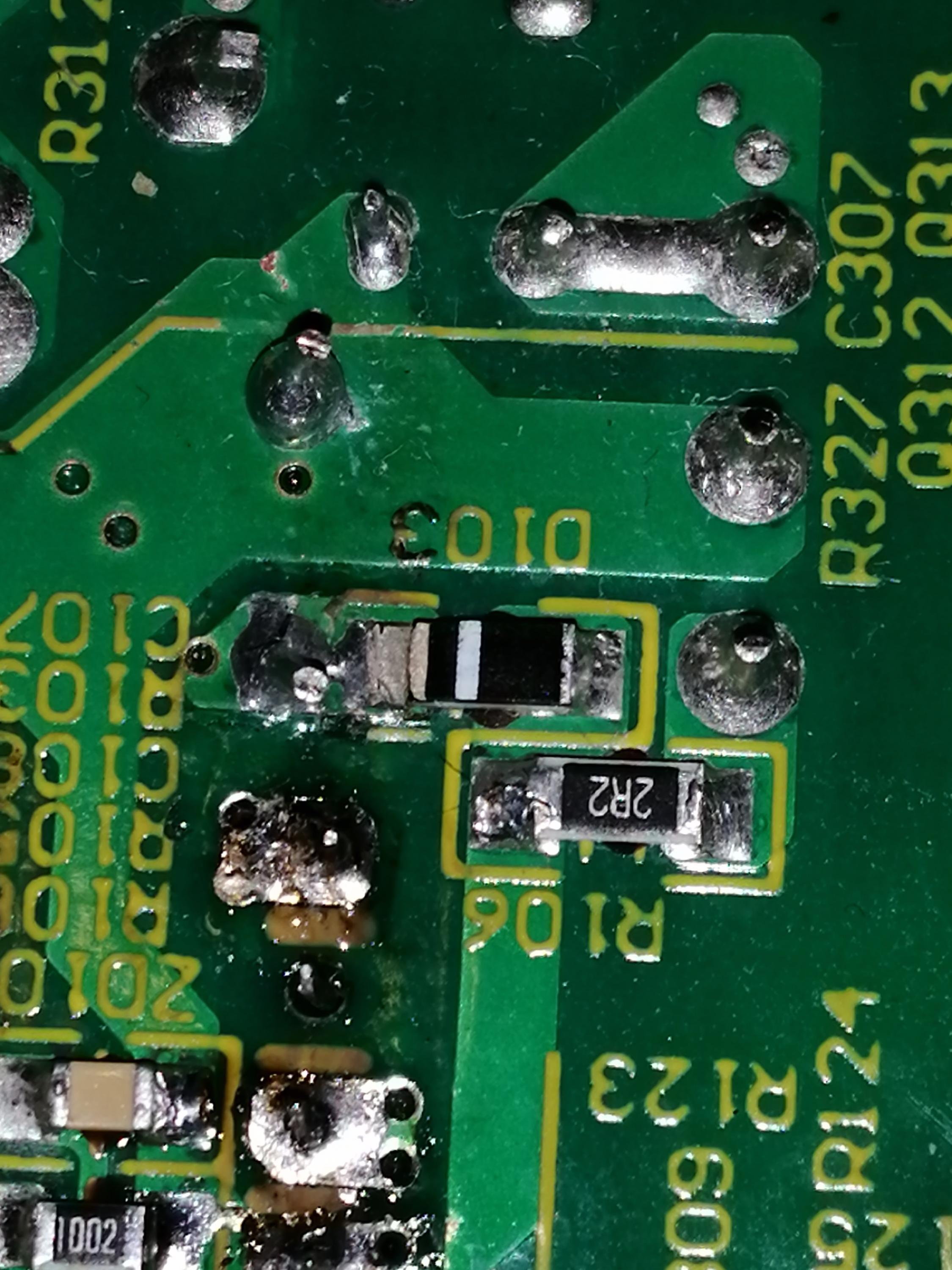

    Fast forward to yesterday, I had some free time to poke it with a multimeter and I noticed a broken diode. The solder mask under it was cracked and separated from the PCB as well.
    I don't know the specs of the diode because it doesn't have any markings on it, so I need some help finding a replacement. An electronics store in my country sells this one:

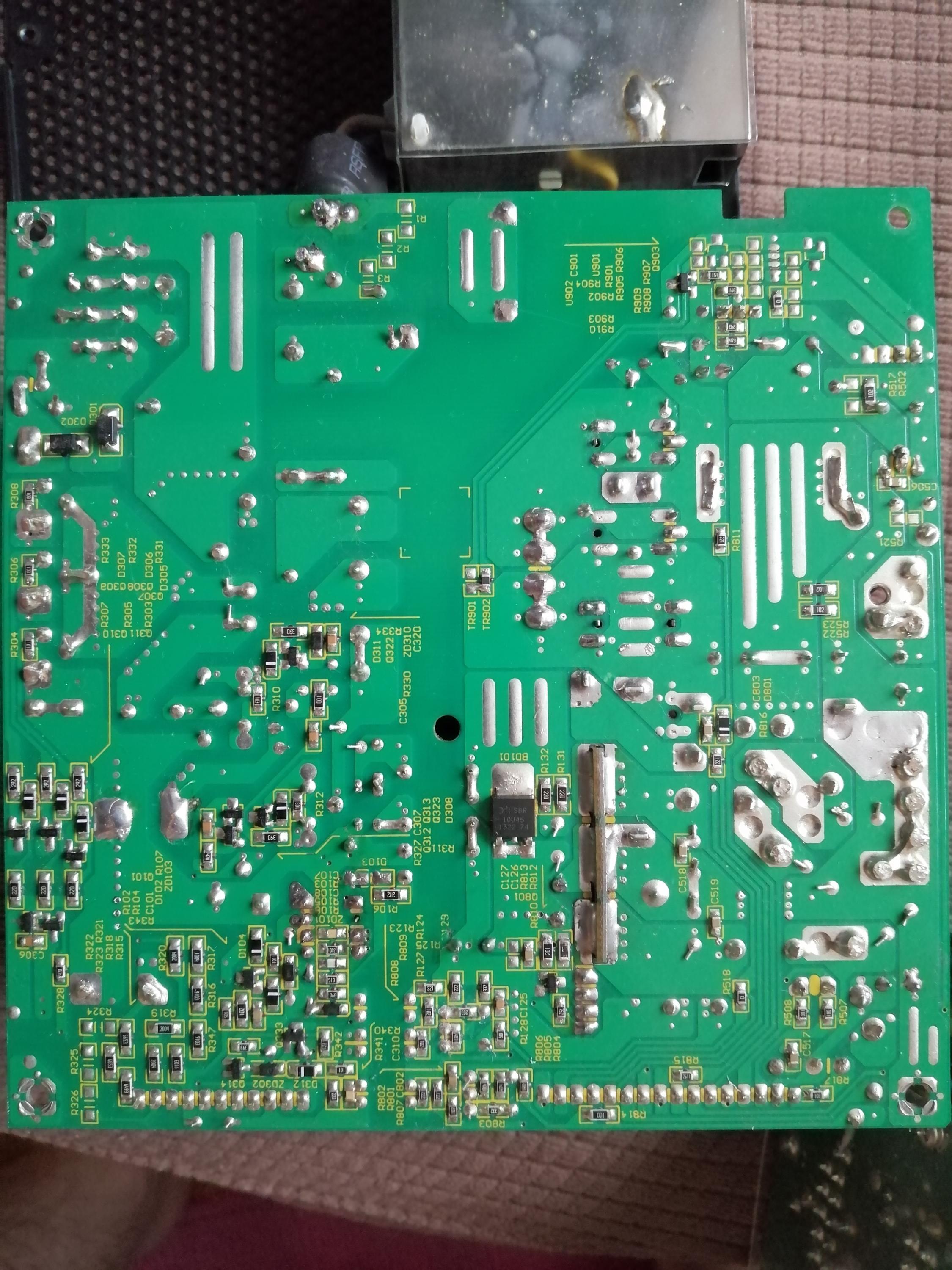

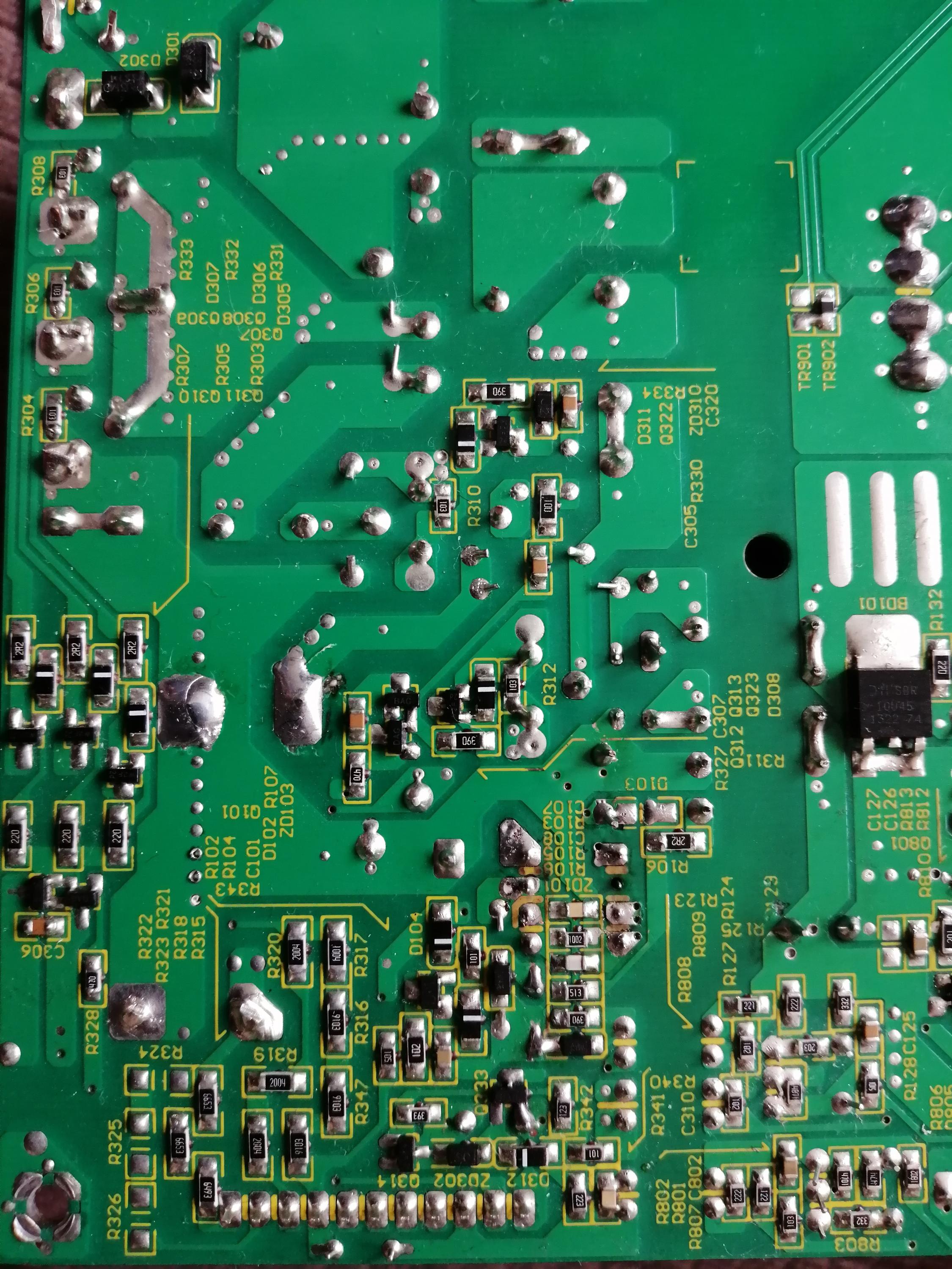

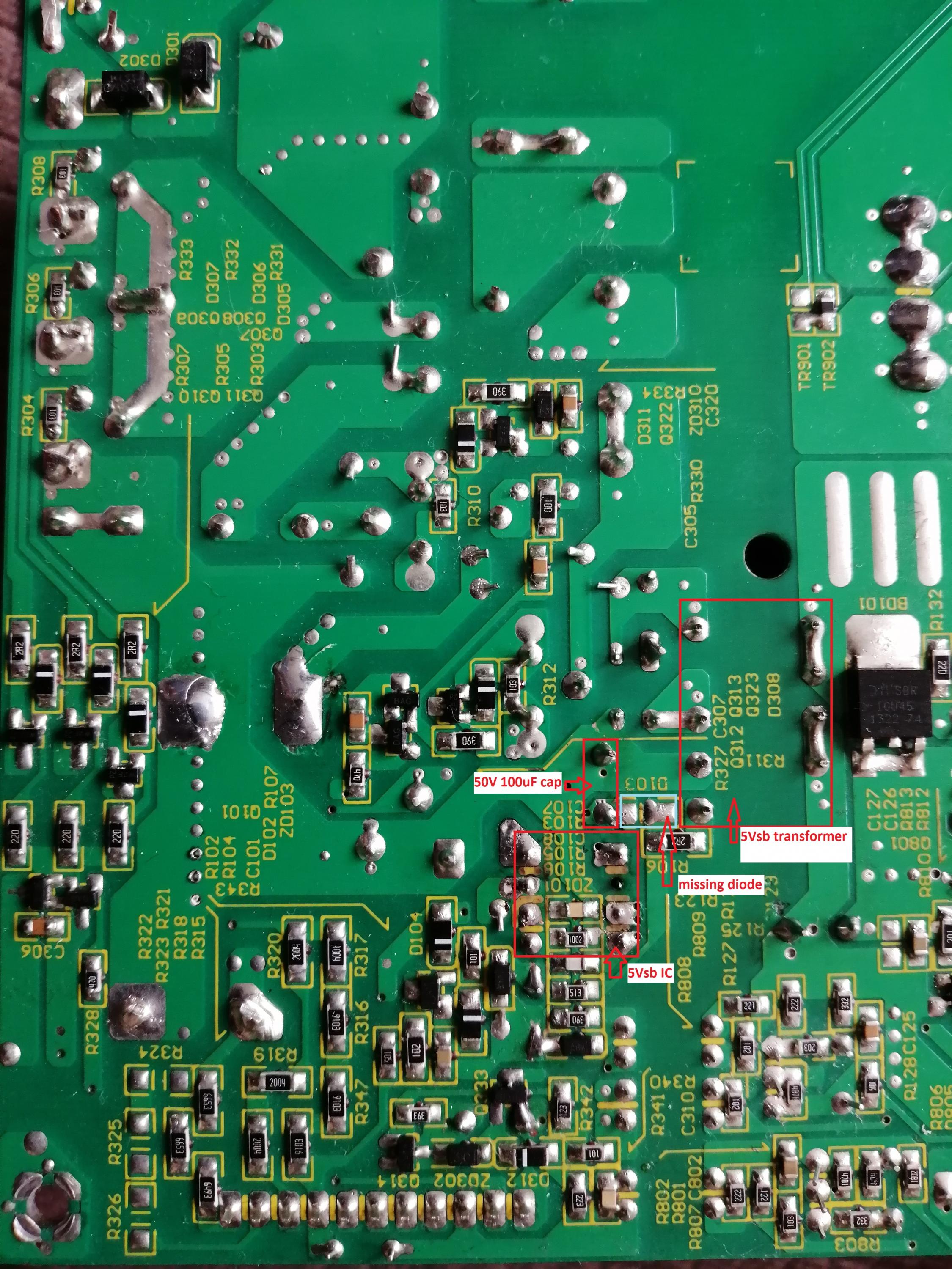

    I'll include some pictures of the PCB and the problem area. The diode in question is D103 on the PCB (it was already removed in some of the pictures).
    Any info is appreciated.

    The diode D103 is an ordinary 1N4148 but in a small SMT package. Notice the PCB pads are actually for a larger diode, which is what I would put in.
    Something in a SMA or SMB package or even MELF, but fast-recovery only.
    I would use ES1B or LL4148 MELF. Schottky parts like SS16 60V are too low voltage.
    No good (too slow) is S1D, LL4002, M7, RS1 etc.
    The diode seems to be for supplying power to the 5VSB IC.

      Thanks for posting. As per your advice, I soldered an LL4148 MELF diode and - good news! The power supply turns on now. All that's left now is to test it with higher load.
      Interestingly enough, when I first hooked it onto a motherboard, the 5vsb LED turned on and then immediately off, making me think that the repair was unsuccessful. After I disconnected the PSU from the motherboard and jumped PSON to ground the PSU turned on. After that it started working normally with the motherboard.
