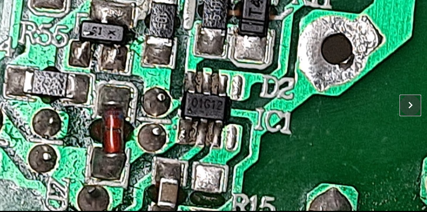

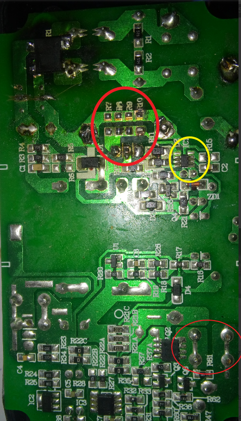

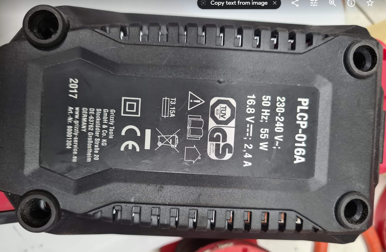

    I am trying to rebuilt this charger after the output diodes shorted and eventually blew the primary side of the SMPS. I need to know the part number of the IC.
    Model:PLCP-016A charger from the PARKSIDE drill set.
    Parts faulty: R7, R8, R9, R10 all 1R5.
    MOSFET transistor HF4N60,
    IC1 marking on IC is 01G12 -- need this part number.
    Thanks!
