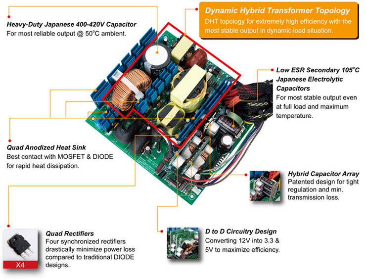

    Hi guys, here's a electronic newbie question: can we use polymer caps for a pc psu?
  • 370forlife
    Large Marge
    • Aug 2008
    • 3113
    Re: polymer caps for psu?
    Short answer: no
    It's hard to find polymer caps over 1000uf, with the decreased uf, the rails loose the umpf, or think of it as a truck, the uf as it's weight. When a large, sudden load increase comes along, such as the truck hitting a car, the truck is going to slow down more the less it weights. Basically, the less the uf rating, the lower the voltages may drop when confronted with a larger load. The drop would be so quick a multimeter wouldn't pick it up either.
    The very low ESR of polymer caps can also make ripple worse, as the pi filters are "tuned" to the certain esr of the caps used originally. Lowering (or raising) this ESR can cause the ripple to increase.
    There are some new psu's with polymers in them, they use them on the dc-dc daughter boards that generate the 5v and 3.3v from the 12v. They also use standard electrolytics, with some polymers thrown in on modular pcb's or after the pi filters as supplementary. Don't know if they really do anything, or if they just are more of a marketing gimmick.

          Enermax modu87 PSUs Many sites recommend them

            CWT and Superflower loves them too. I think superflower was one of the first to start doing it. Won't be surprised to see it in low watt psu's soon with the efficiency craze.
