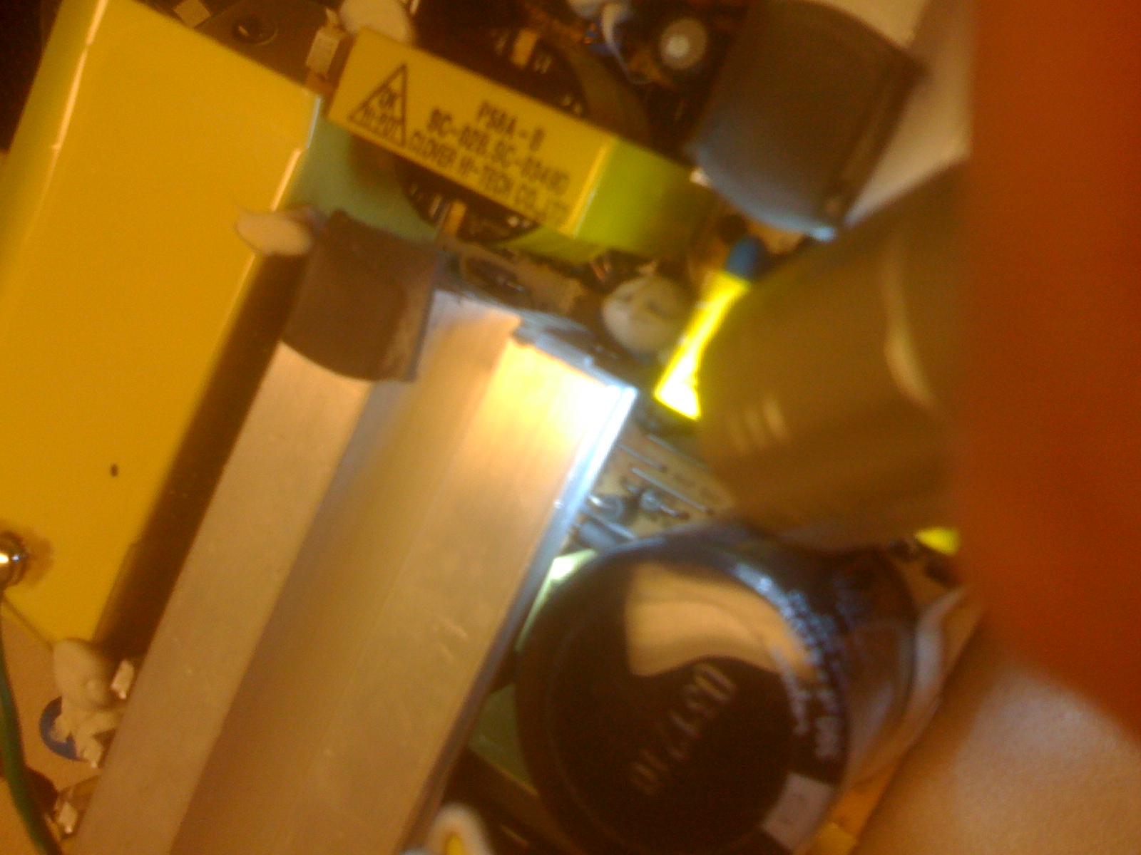

    Hi Everyone,
    I have a bad PS from a Power Mac G4 MDD or mirror door machine. I took it apart and found a blown fuse. It blows a new fuse immediately upon being plugged in. The computer works fine with another PS.
    So there must be a dead short in this thing somewhere. I have a little electronics knowledge but would like to learn more and get some experience repairing electronics.
    I don't notice anything burnt in the PS, but I did notice some diodes of this type:
    http://www.cartft.com/image_db/1n4001.jpg
    that looked like balloons. Like they had pressure inside them and expanded. They are labelled with a DXXX on the board as in D100, D101, etc. (those aren't the exact numbers, but you get the idea). I've found 3 so far, all in the same area. I've never seen a diode that looks like this. Can anyone comment on that observation?
    I also noticed this PS board has some CapXon capacitors and as I recall, I have seen a lot of these go bad on both Dell and Apple computers.
    I would appreciate any help to tell me where to start troubleshooting this thing. I have a volt-ohm meter and that's it. Do I need any additional tools?

        This is a Samsung 360W supply. It is exactly the same as the one in this thread:
        https://www.badcaps.net/forum/showthread.php?t=7165
        I've attached a picture of the weird-looking diode. Sorry it's kind of poor. I'll try to get a better picture on Monday.

          Re: Repairing bad power supply from Power Mac G4 MDD
          The white round with black band is fine and correct.
          See post #2 for your problem above.
