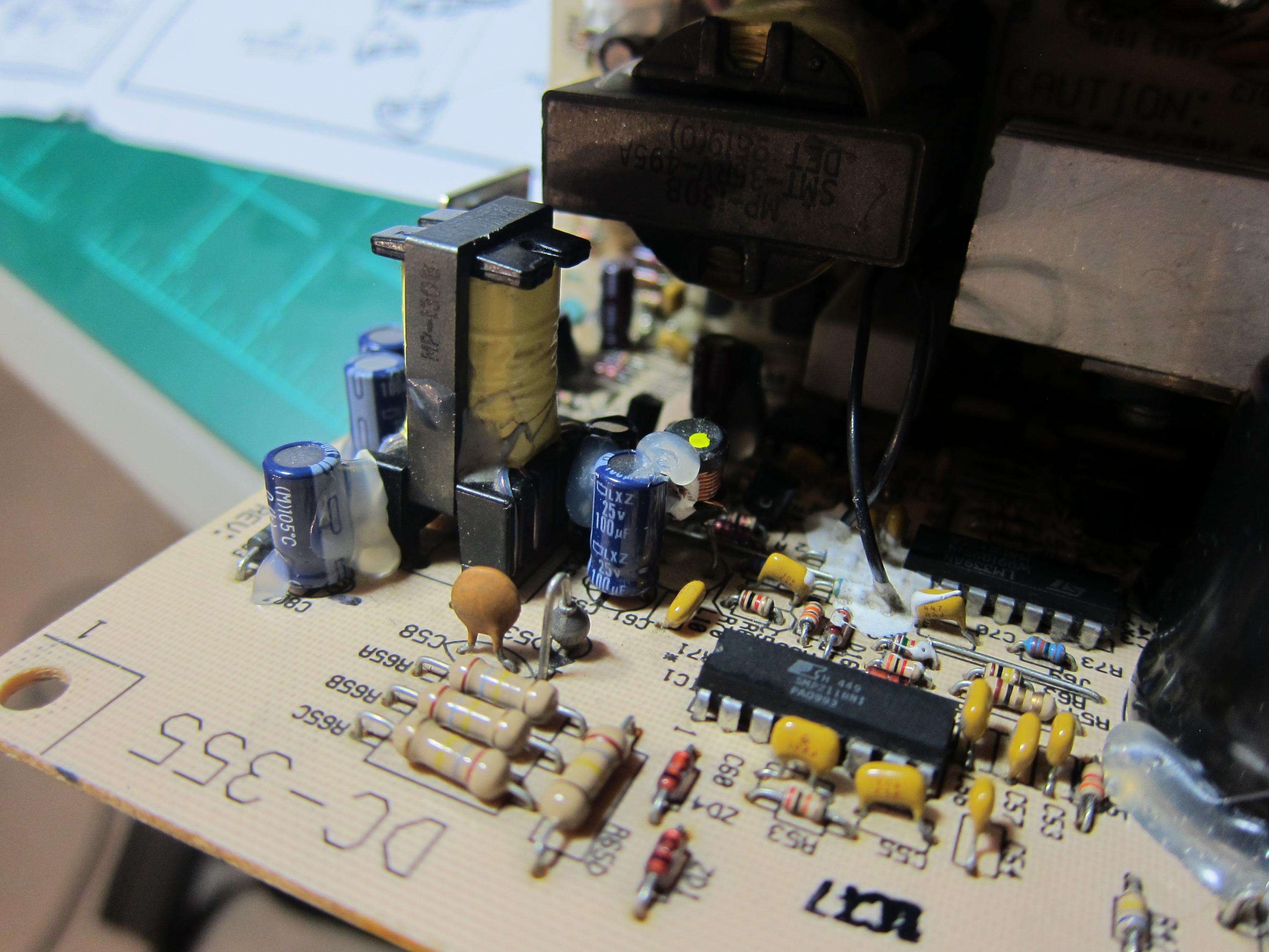

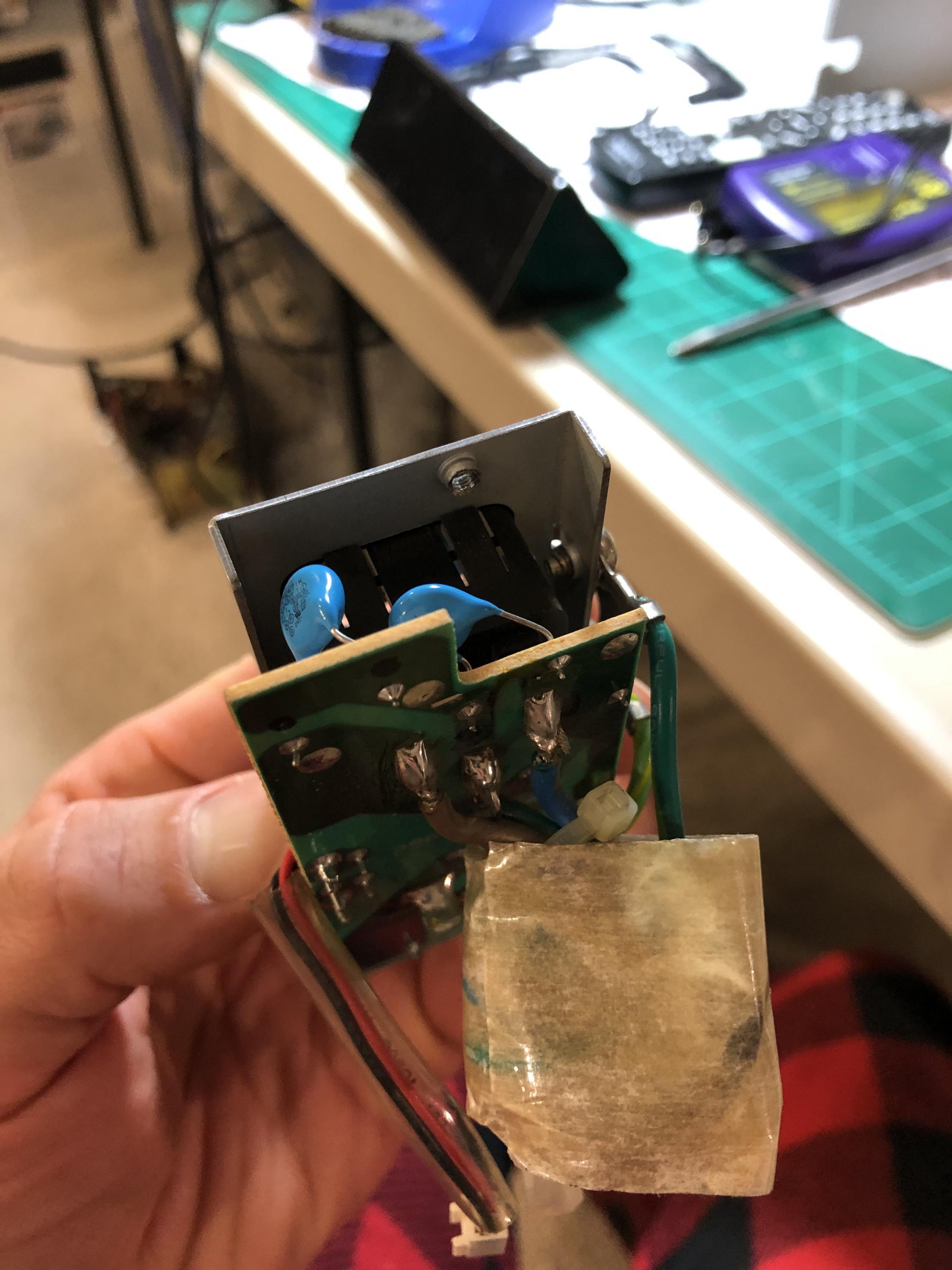

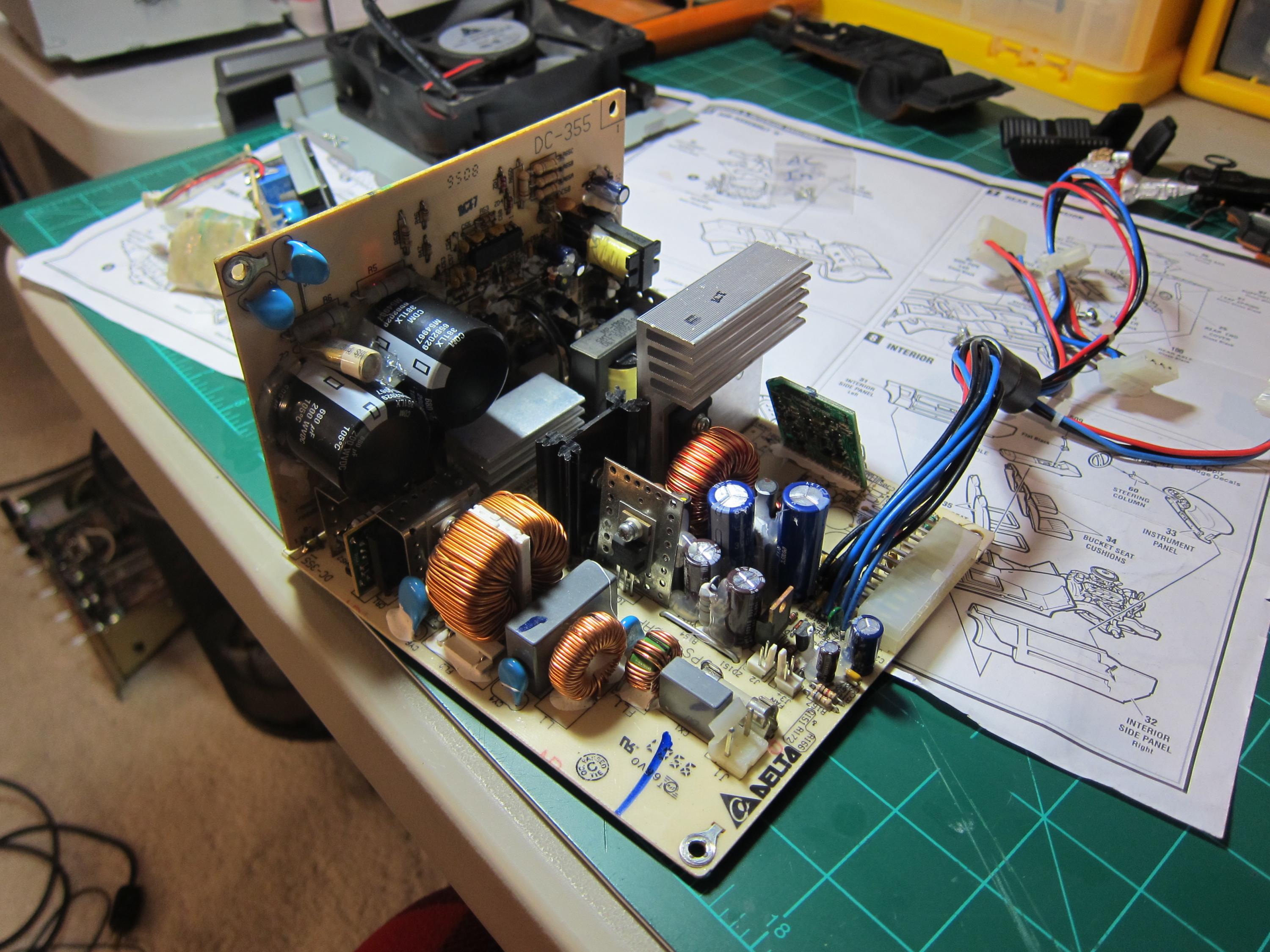

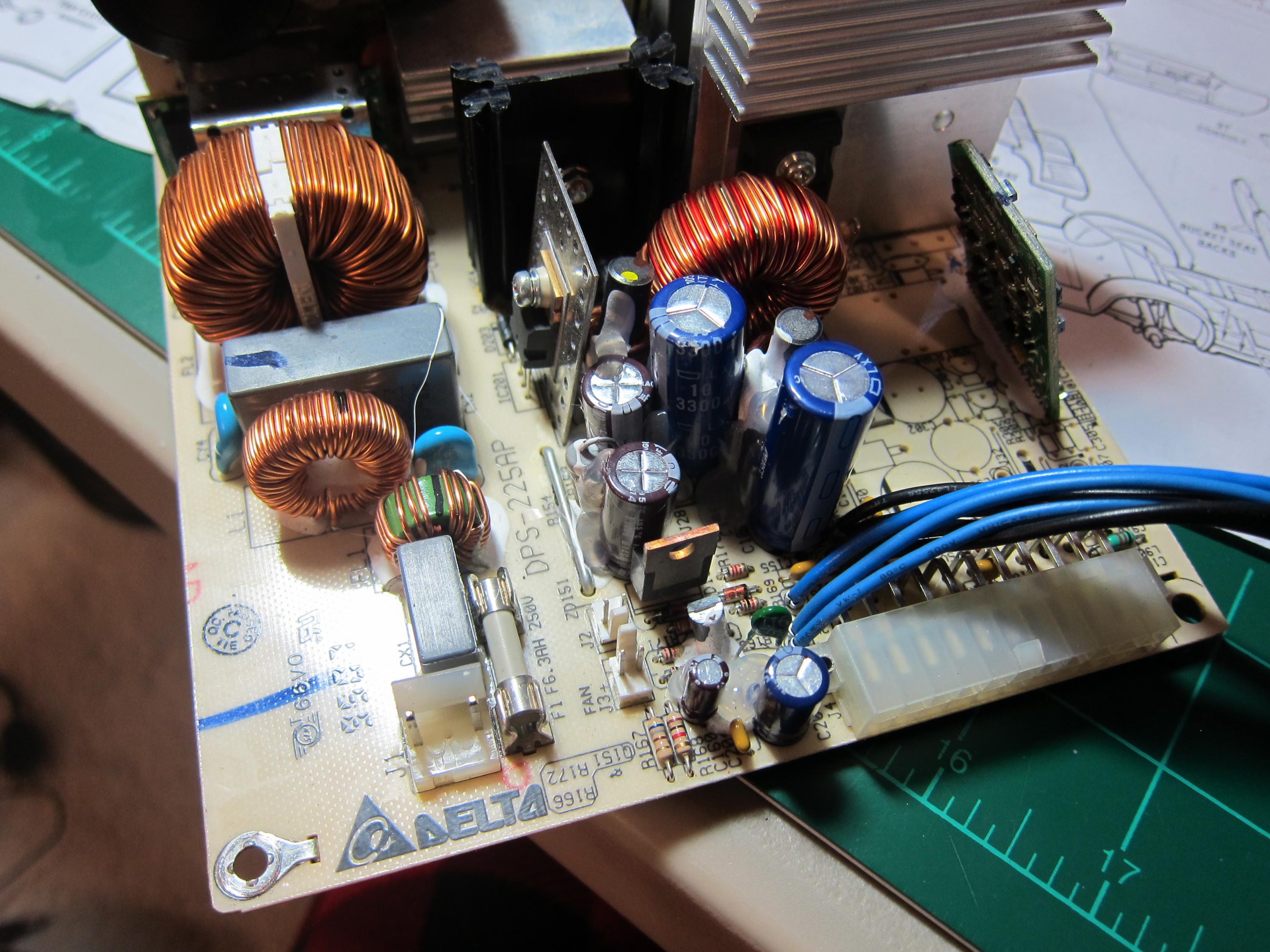

    This is my first thread, and I am new here. I am part of the 68kMLA forum, and I was referred over here by one of the members there who is a member here as well.
    I have a power supply from a Power Mac 8100 (Delta Electronics, Model # DPS-225AB Rev: A0, Apple Part Number 614-0040). It worked fine prior but, being close to thirty years old, it was time to recap. I have done a lot of capacitor replacement, but am by no means an expert at all. I looked up the replacement parts and ordered on Mouser. All electrolytics were replaced with same capacitance and voltage rating (or higher voltage if the identical could not be found). After reinstalling, all seemed to be well: machine starts normally, everything runs. However, after about five minutes, the entire PSU shuts down all of a sudden. Dead. This is a soft power on power supply: it has no on/off switch, and it supplies a +5V trickle current to the motherboard for soft power on/off signaling. If I try to start it right when it dies, I hear a switch/relay click inside and then right off again. I can do it about three times till it won't do anything else. Only if I unplug the supply, let it sit for 15-20 minutes, then try again will it restart again, only to last for five minutes.
    I checked output voltages, and all grounds are connected properly, all +5V read 5, all +12V read around 12, and all -12 are around that too. They all are consistent: the output is dead on until the supply suddenly shuts off.
    At this point, I do not know enough to troubleshoot further. Anything else to try, and any more information I can supply to assist in figuring this out?

    pictures?
    what caps did you fit?

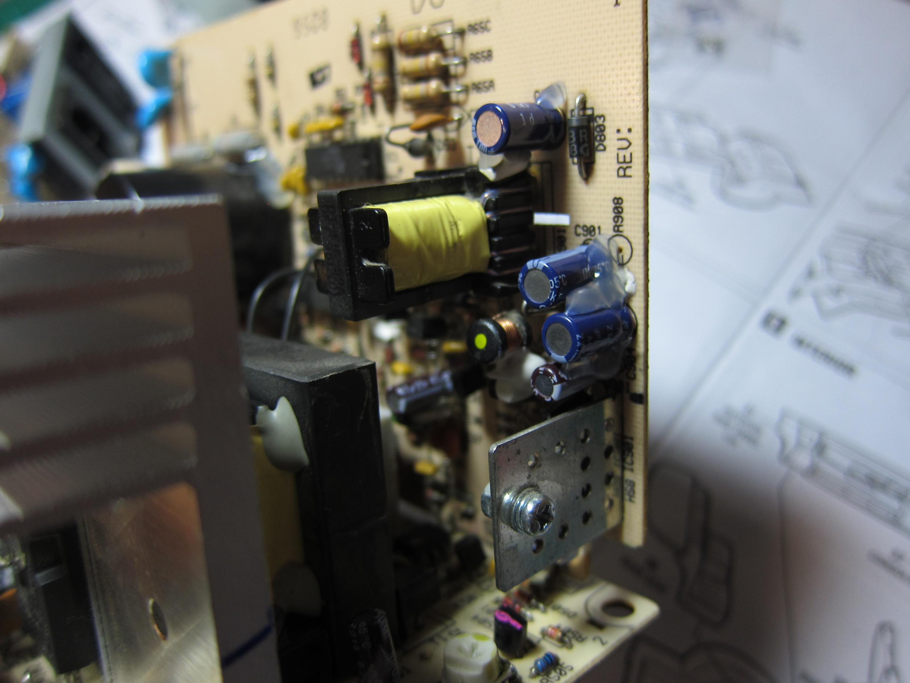

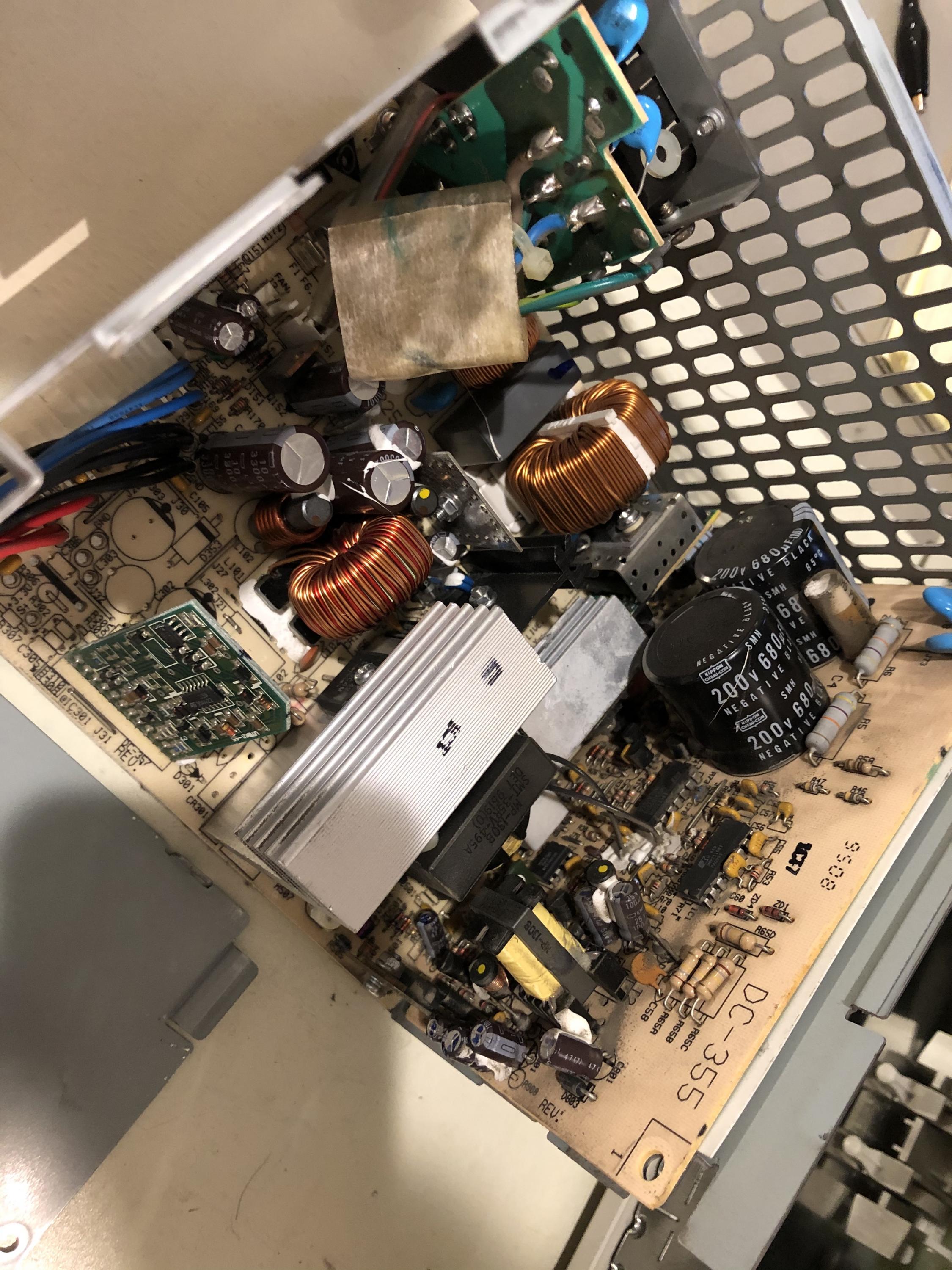

      Re: Recapped PowerMac 8100 PSU and now unstable

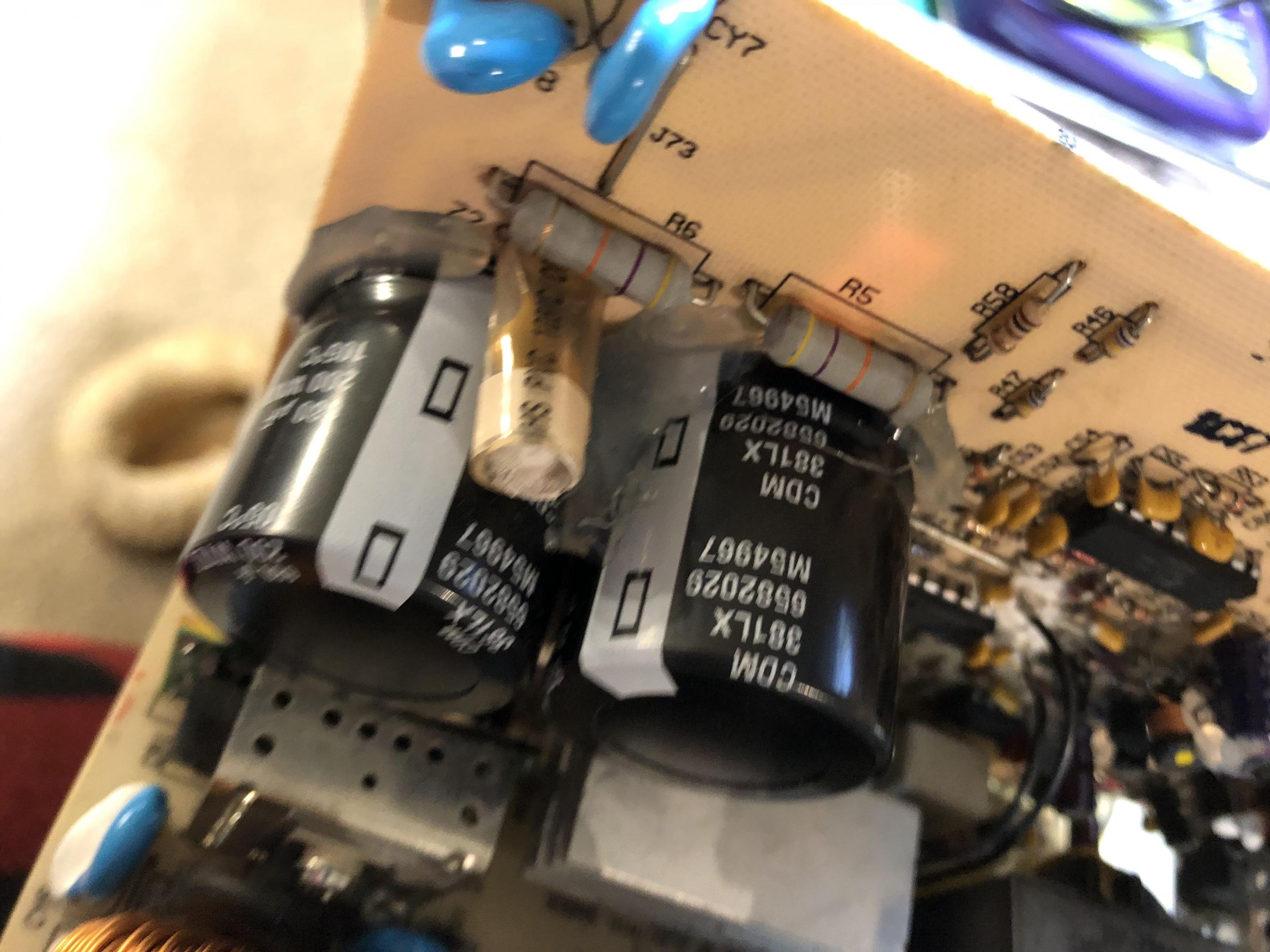

      Attached are three photos of the supply prior to recapping. They were not the best photos, mostly for my reference while I was working. There is a horizontal board, vertical board, and also a tiny board that is sandwiched in there that I had to remove to replace two or three more.
      I'll also attach a list of the caps I used to replace the ones on it with.

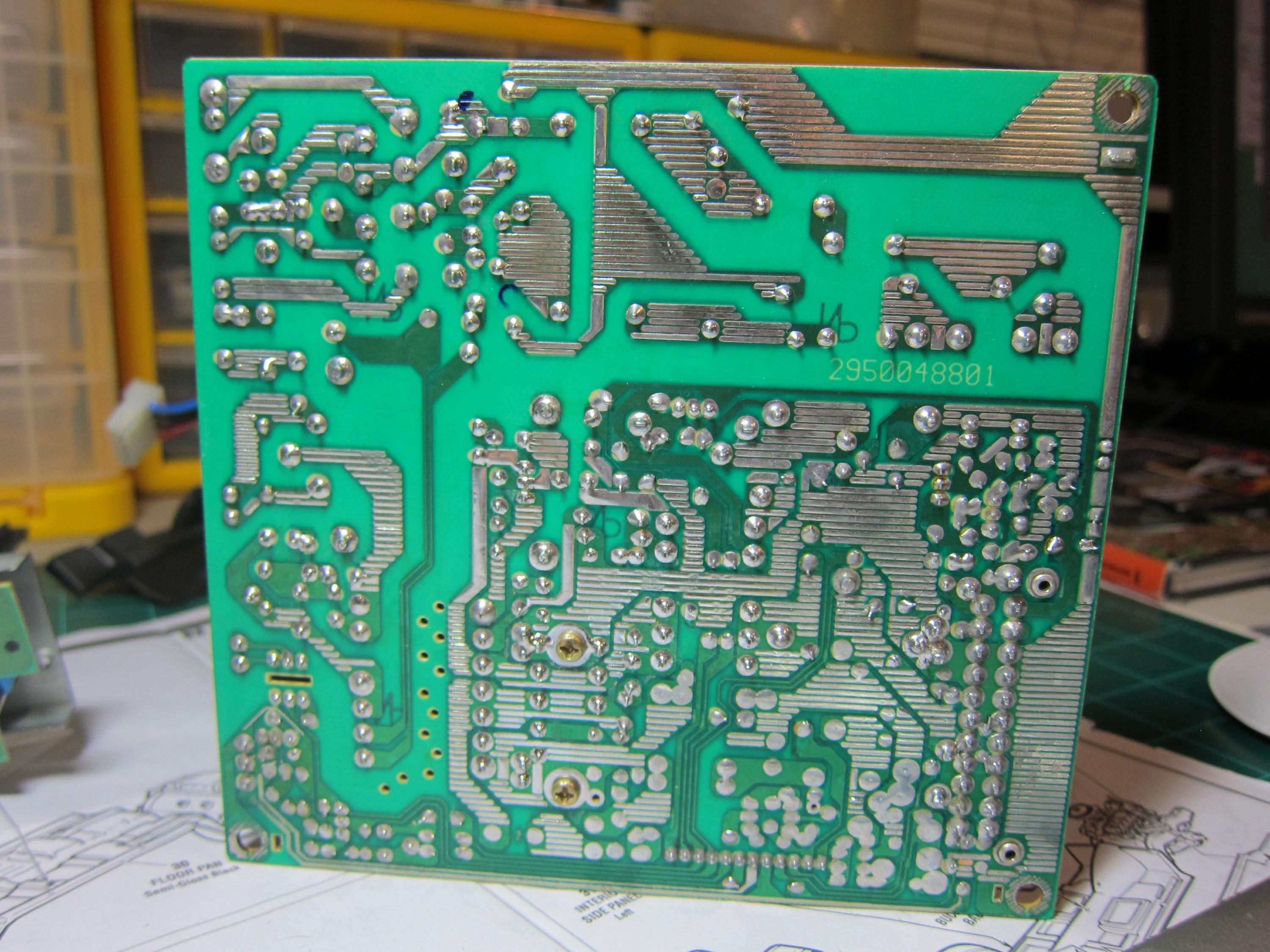

        Can please post some pictures of the front and back of the board now after you recap it
        Did you recap the daughter board or boards if it had more than one
        Did you replace all the capacitors except the main filtering capacitor
        If you did not replace all of the capacitors why not

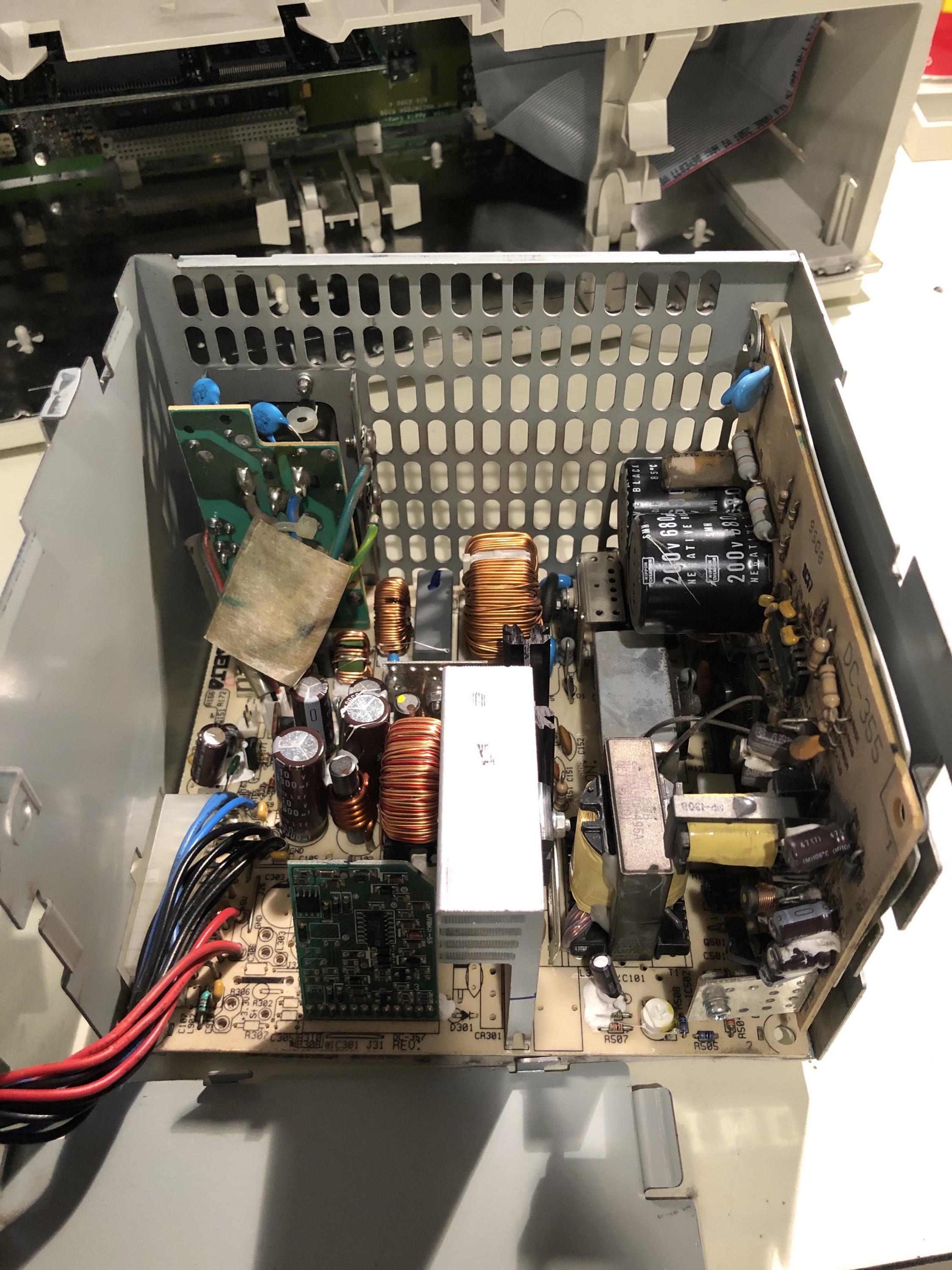

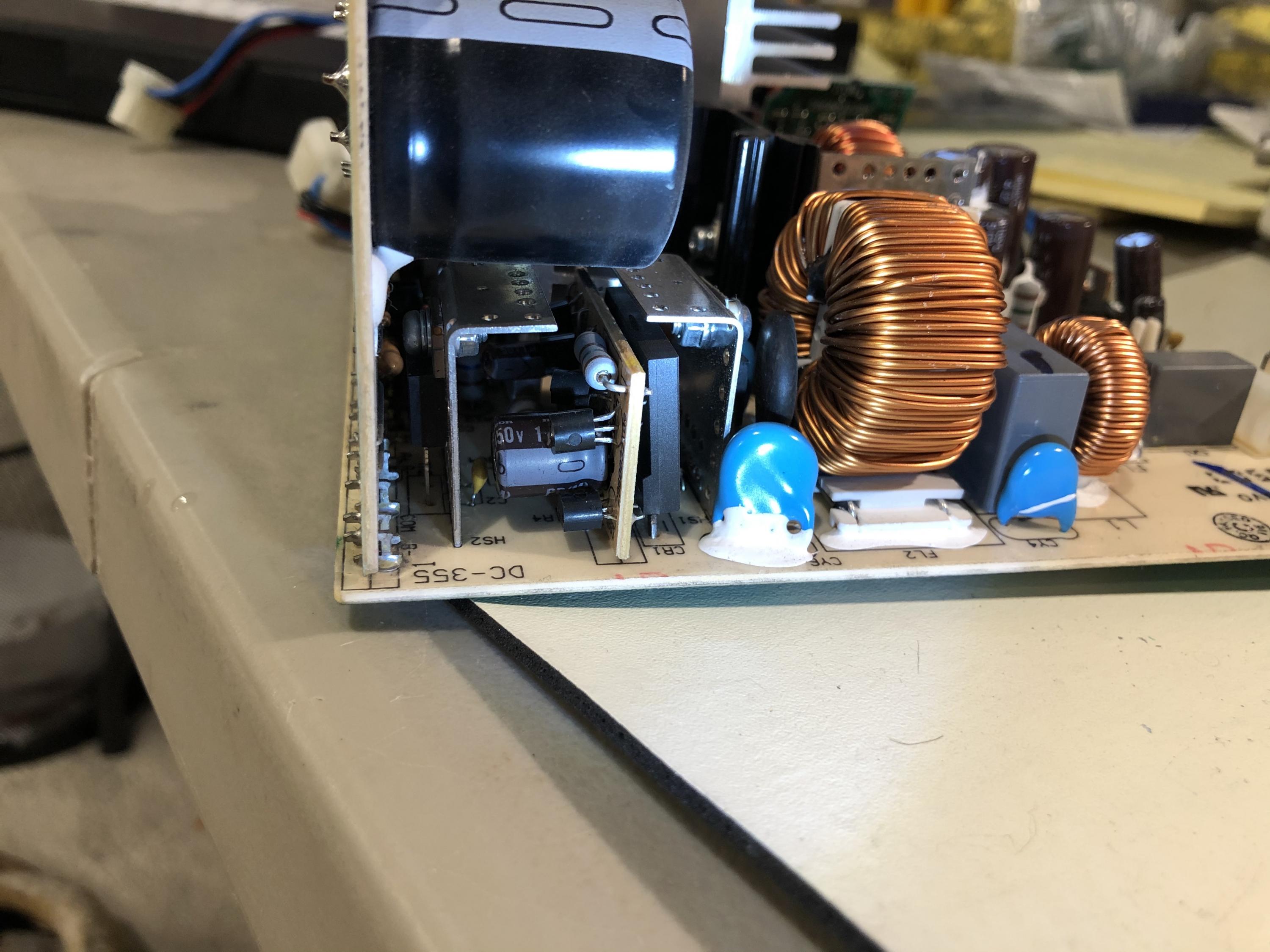

          All were replaced - including the large filter ones. Will have to take more photos now to show the whole thing.

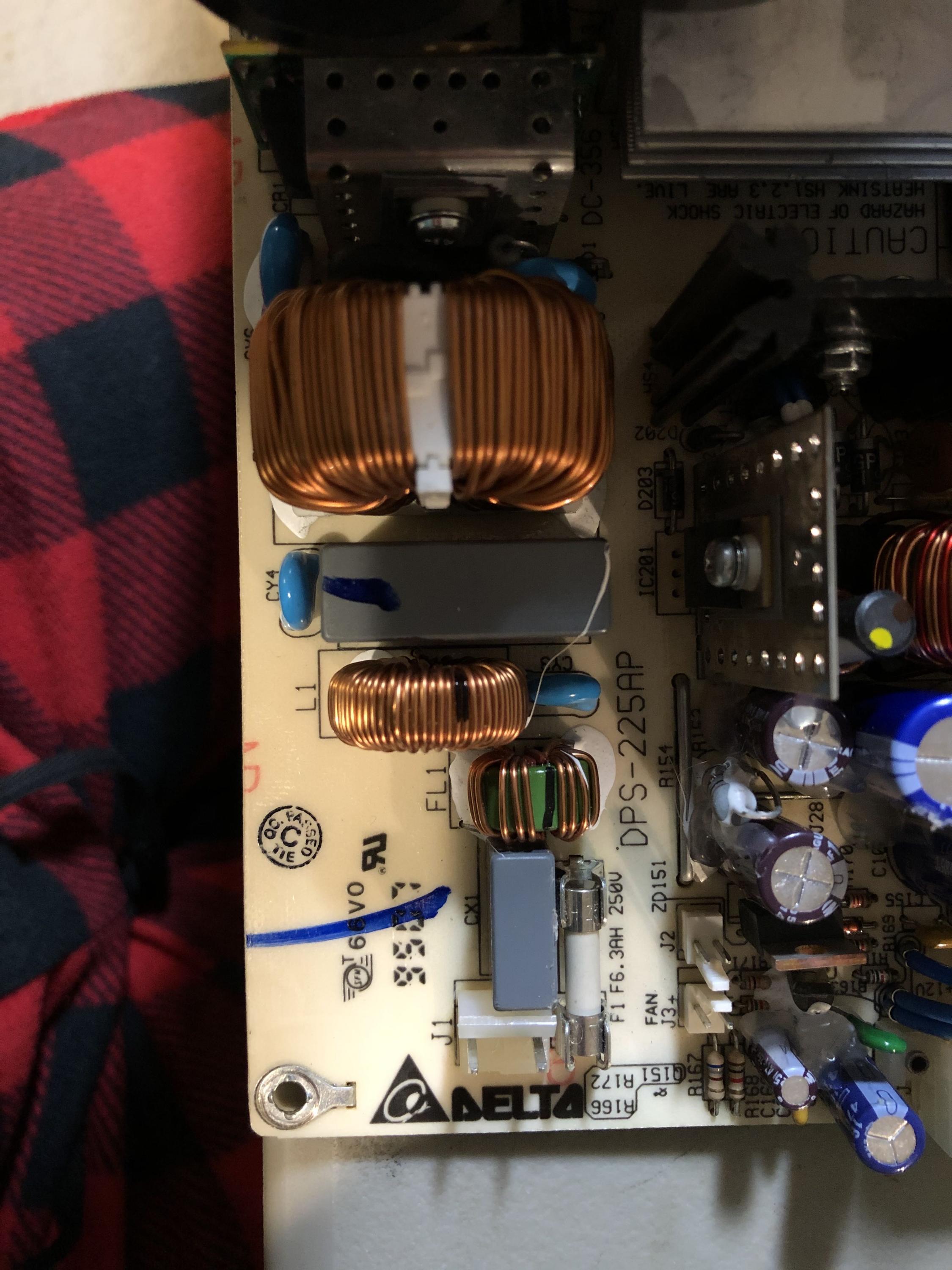

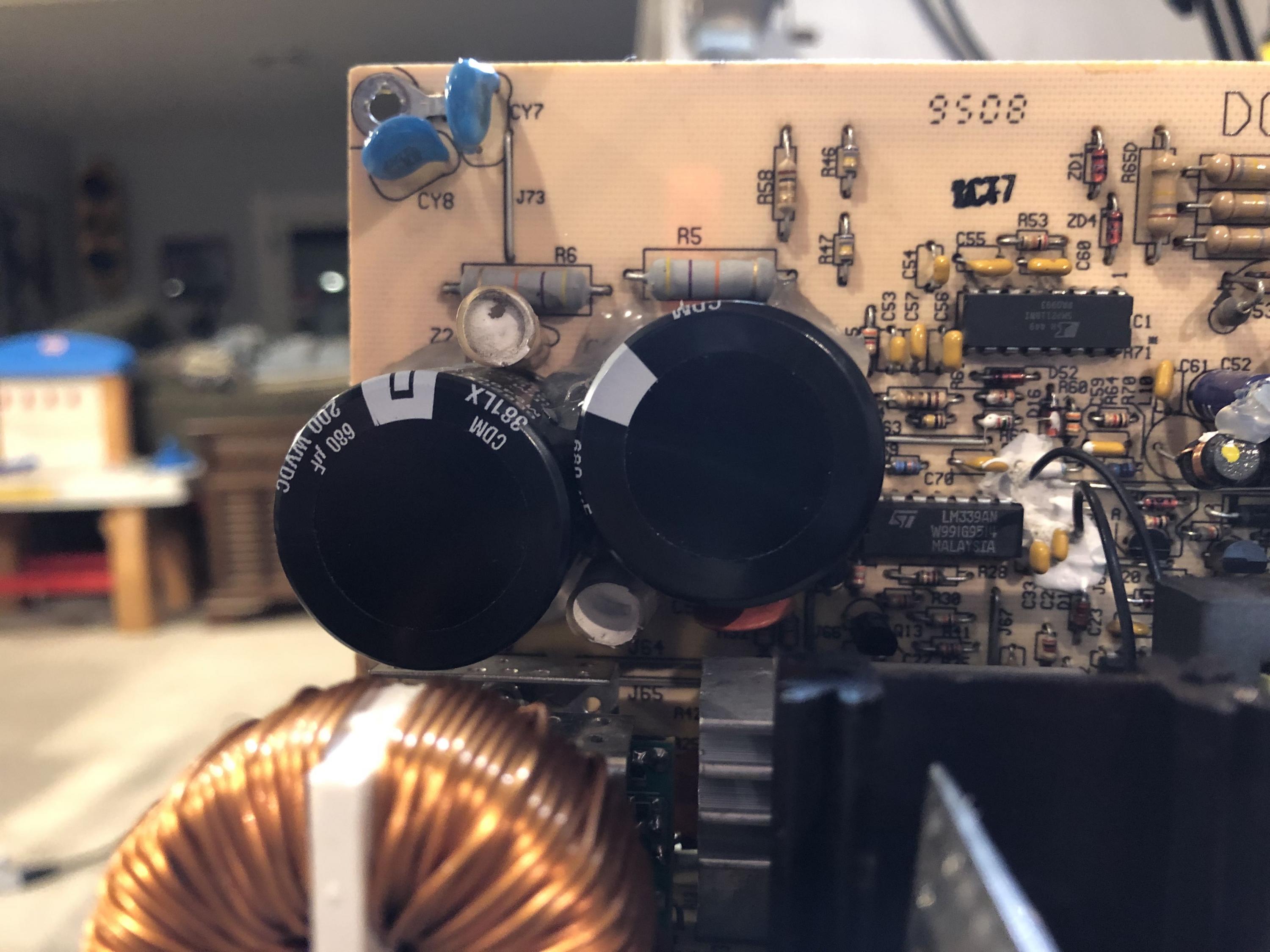

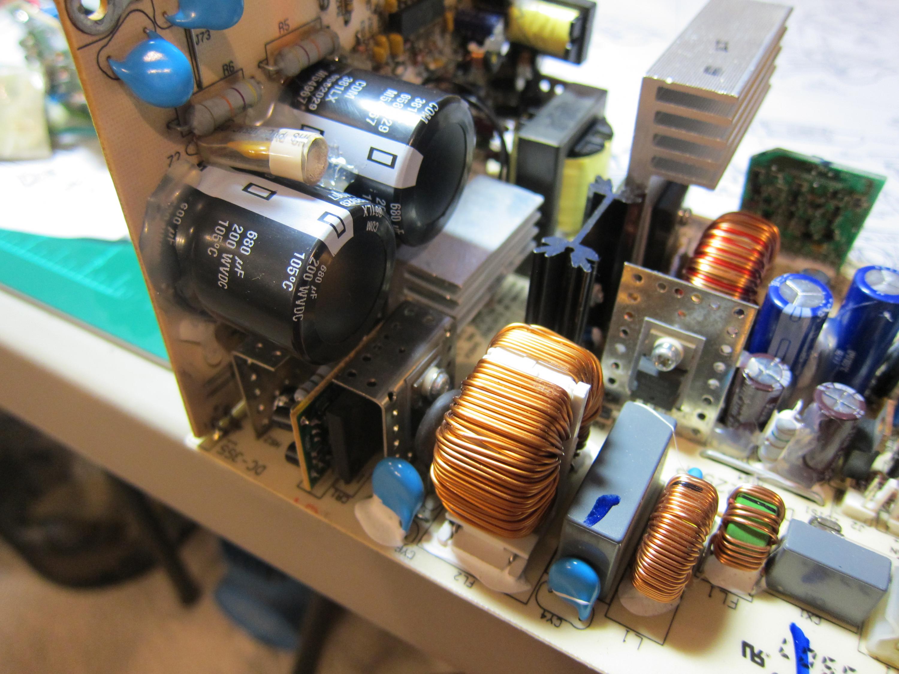

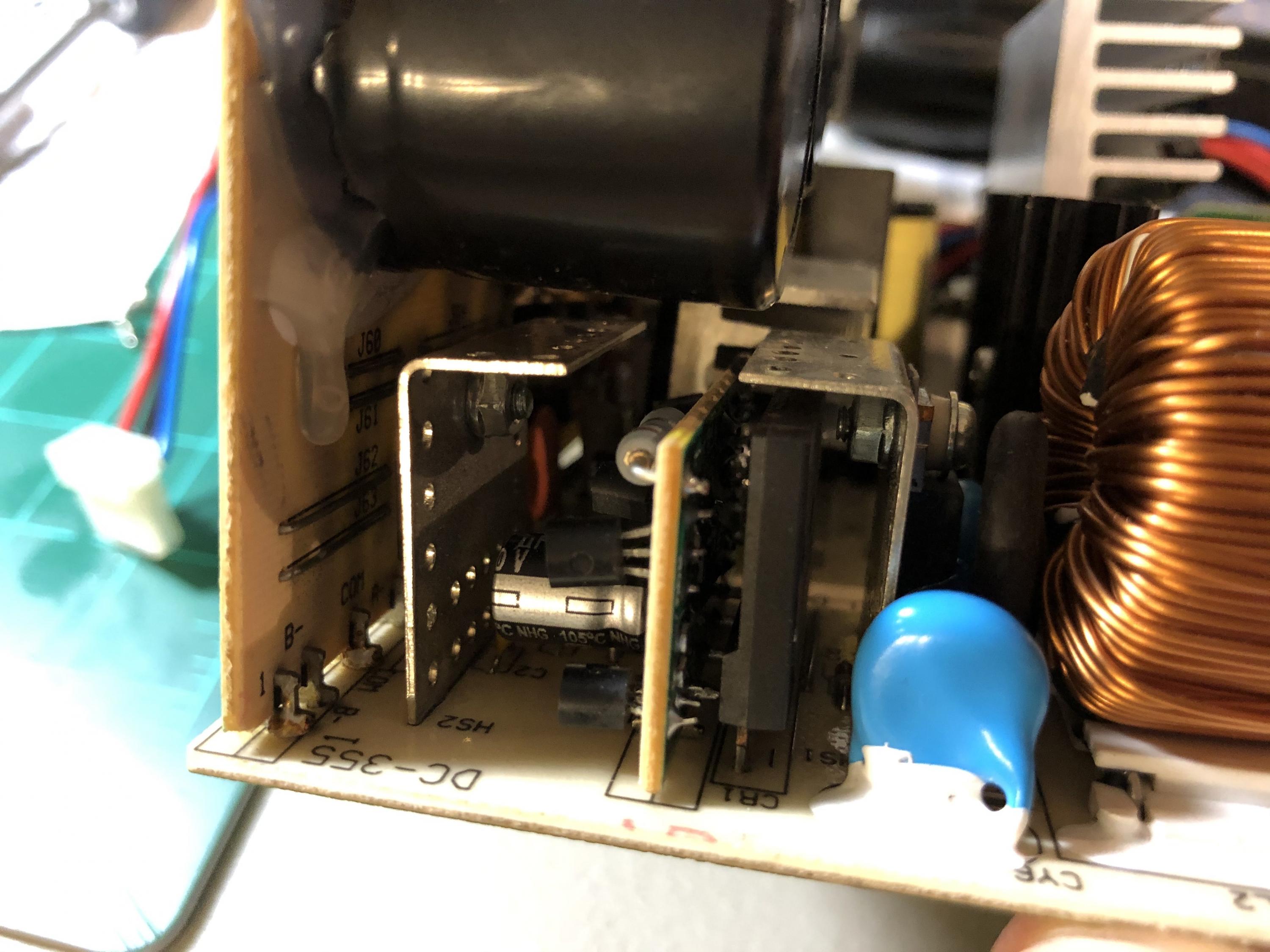

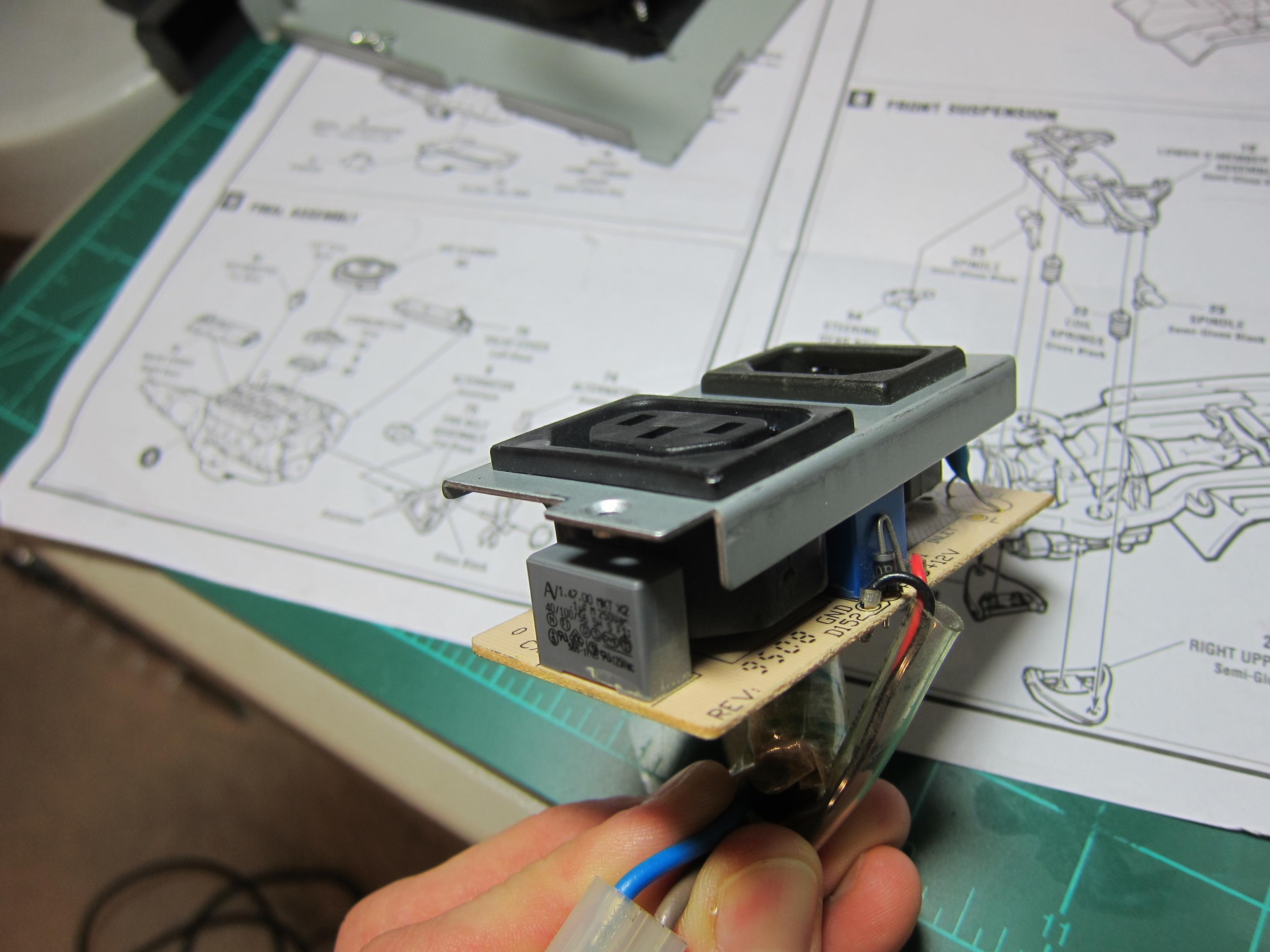

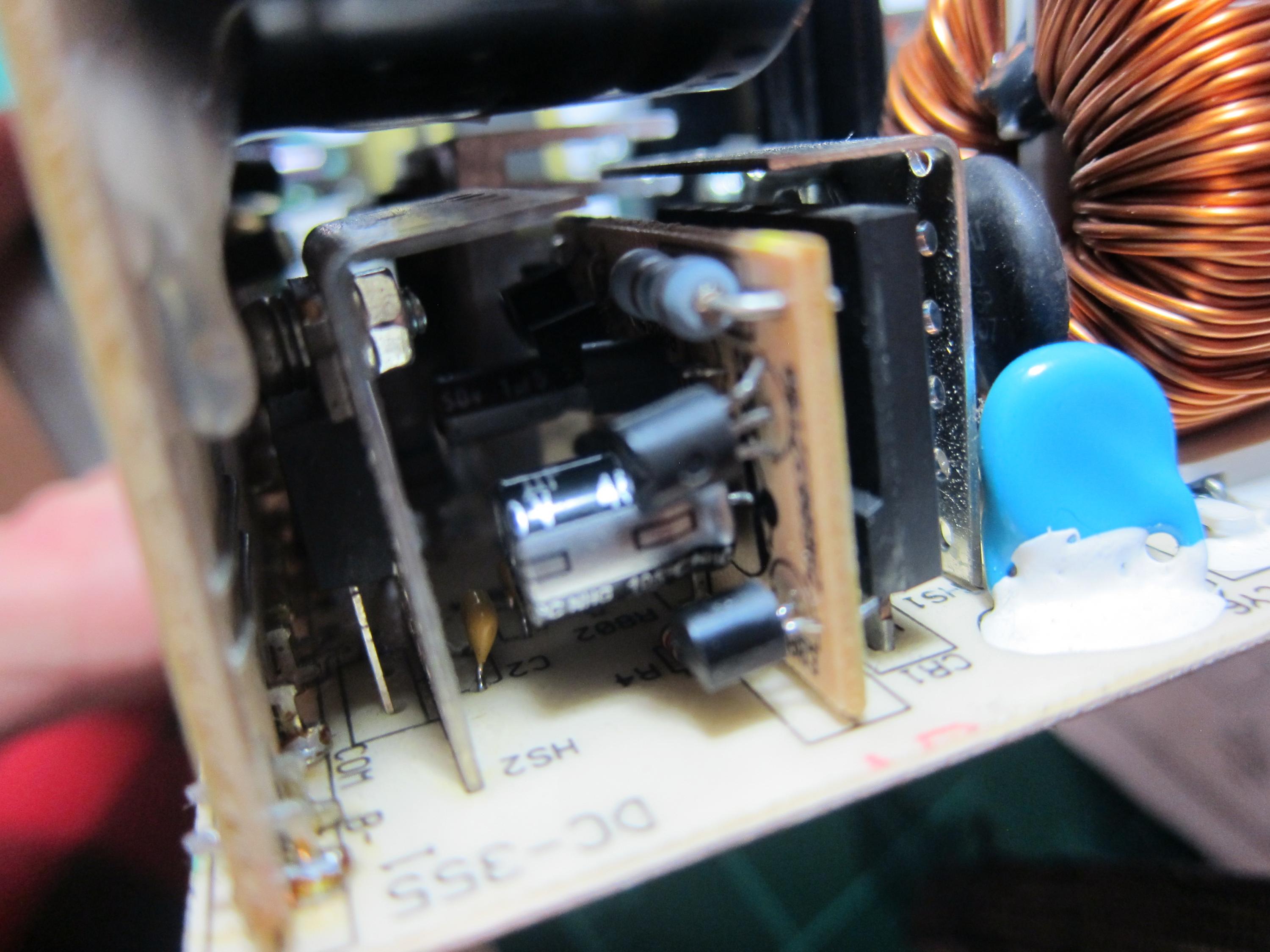

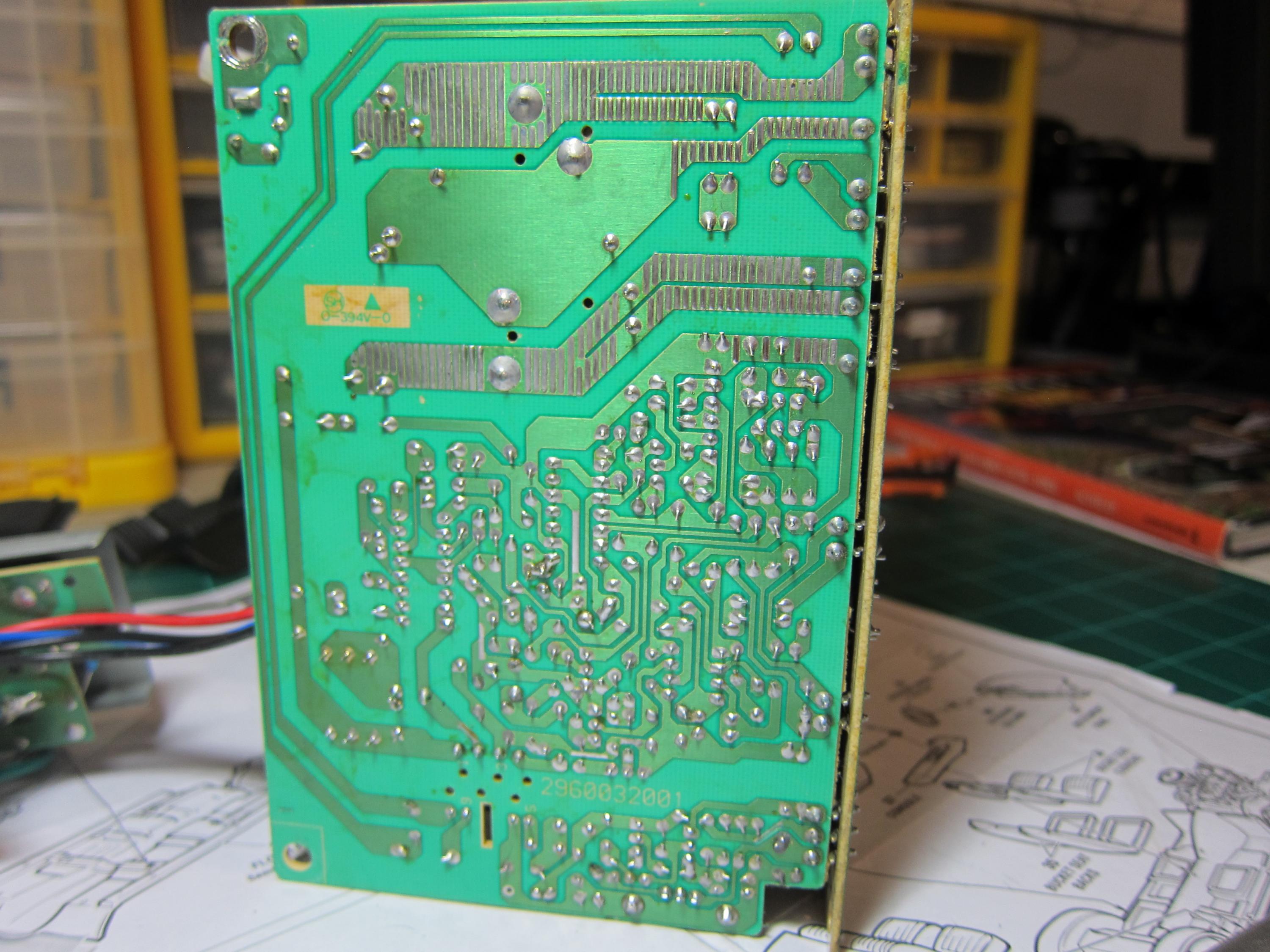

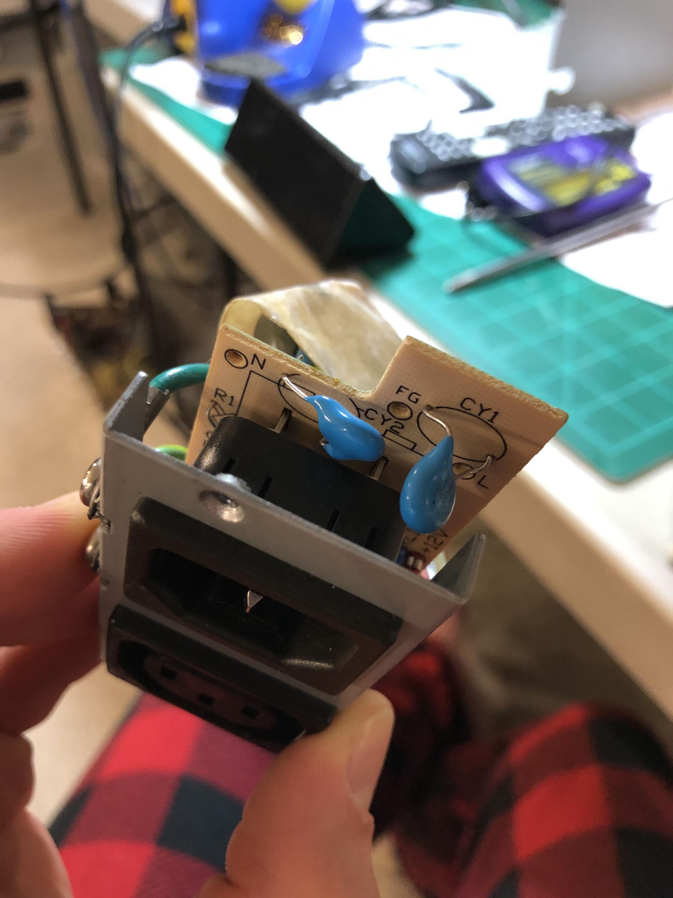

            Attached are the photos. There is the small 120VAC in/out repeater board. The rest of the supply is two main boards at 90 degrees to each other. There are also two small daughter boards, one that had two caps that I replaced (the photo that looks like a cave). The other has what looks like small control circuitry. The undersides of the boards are very clean as well. Again, this worked fine until after the recap. Now it just shuts off after a few minutes.
              Ok I have a question for you about the capacitors that were chosen what criteria did you use
              I checked one of them and you used EB series I would have use FR unless that series that you select was on the board originally there if use the wrong series it possible to have stability issues please show a picture of the the capacitor that you used a different series than what was originally on the board
              Panasonic Electronic Component FR FC

                      one of the original output caps is clearly a chemicon LXF
                                      There are a number of ceramics and what look like thermistors in the input section. There is also a board with transistors, etc. on them that is tied into the circuit. The input from the mains is connector J1. The last photo is the actual input board. There are two disc caps on there, they appear to bridge between the hot and neutral to ground, respectively.
                                      The gray box cap, CX1, in line with the connector J1, has a listed value of 0.1µf on its casing, but tests with both my ESR tester and DMM at 0.58µfm with ESR of 2.2ohm. Not sure if this could be artificially high due to it being in-circuit, I can take it out and test separately. Would it being way more than 10% out of whack possibly cause this?
