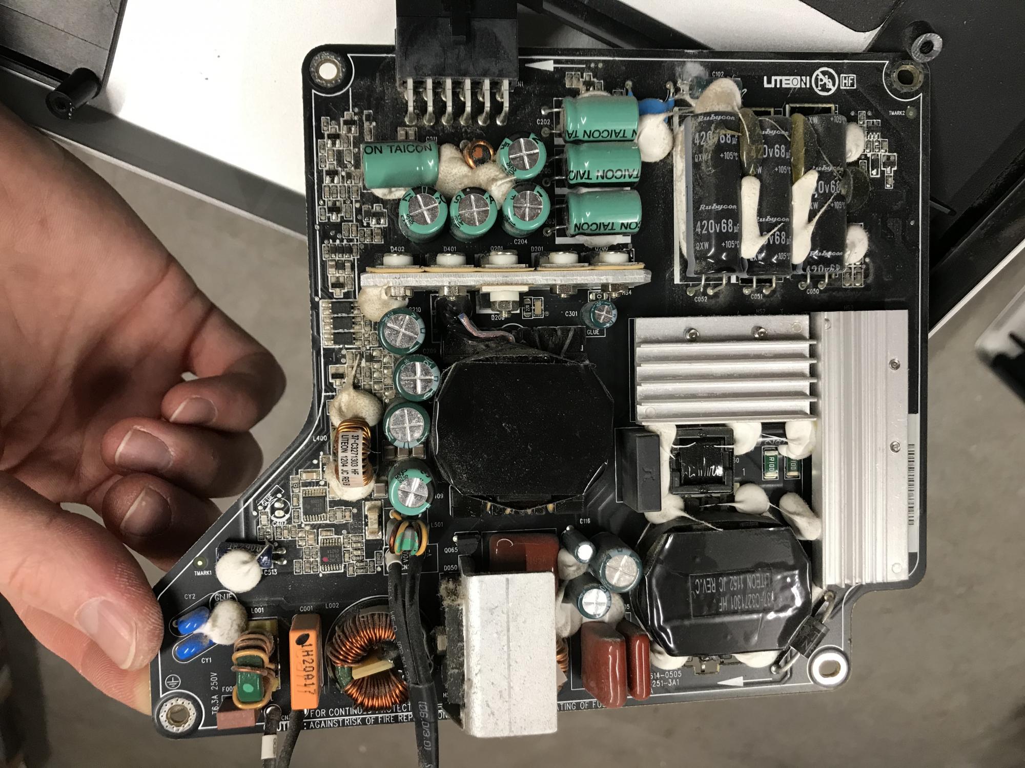

    Hi all, I’ve got a couple of these power supplies. Both of them power on the thunderbolt display without issue, but they won’t charge a macbook through the MagSafe cable. I’ve checked the output voltage on the MagSafe plug from the PSU and I have around 6.6-6.7V when this should be much higher. Probably around 14-18.5V. Everything on the board looks clean. No bloated or leaking capacitors. Could anyone tell me what capacities on the board are for the MagSafe charger specifically? Might change those and see what happens. In case you are wondering, the cable further to the right on the pic is the one which leads to the MagSafe cable. Any other pointers? Thanks

    First of all do you have an ESR capacitor tester if not I would highly recommend that you replace all of the capacitors on this board
    The only ones that you might not have to replace are the main filtering capacitors on this board but this depends how old this device is and how much it has been used or not been used if it has been in storage
    The brand of capacitors ( greenish color ones )that are on this board are known for failure with no blotting or popping there tops

          Taicon output caps are of middling or lesser quality, and Lite On isn't the best at using them with really long-term reliability. at ~9 years old (there's what looks like an "1152" date code on a transformer) those Taicons may be ready for retirement.

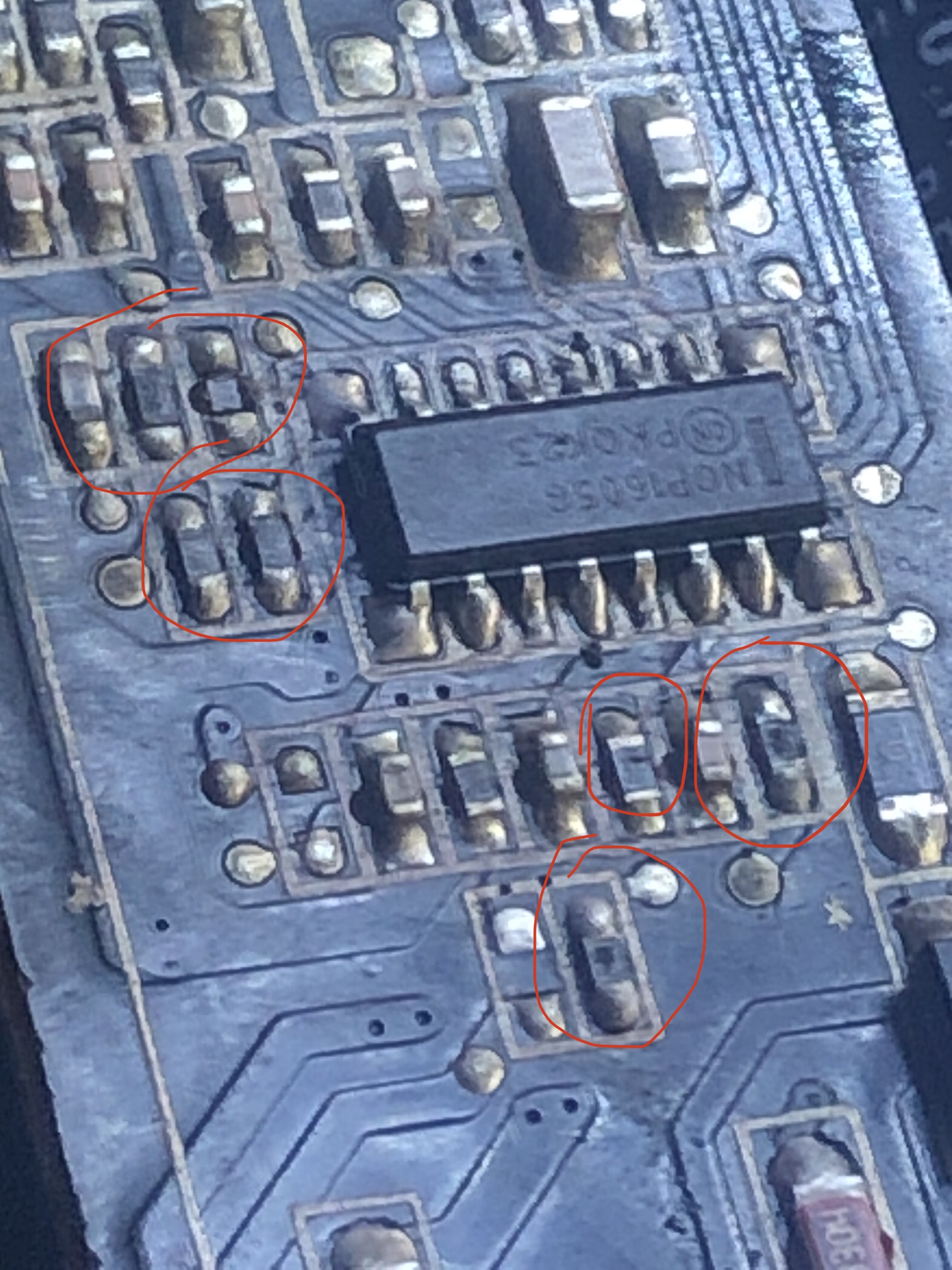

            hey do you mind sharing images of this section of the board . The Power factor correction circuit of the thunderbolt display is shorted some of the components . I've changed the NPC1605G IC , but supporting over voltage protection and feedback circuits are still damaged .
            Ive highlighted the components I require in the attached images.
            thanks

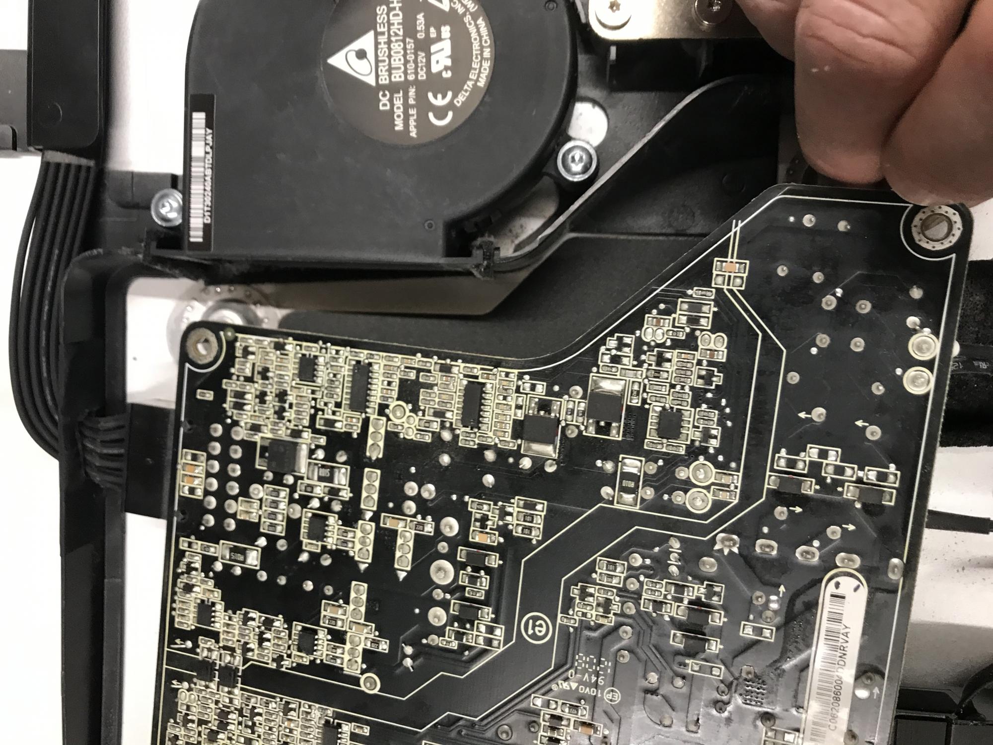

              Hi Sam I have the same problem and I have changed all the electrolytic caps, except the 420v 68uf ones, I have checked the fuses but they are ok, but I don't have dc output, and what I can see is that the 420v are not charging more that 10v or so if I leave the board connected for 1 hour, everything seems to be good under the microscope, where else could I check? Tia

                  I'm a total newbie on Power supplies, can you show me where is the bridge rectifier in these pics? Tia
