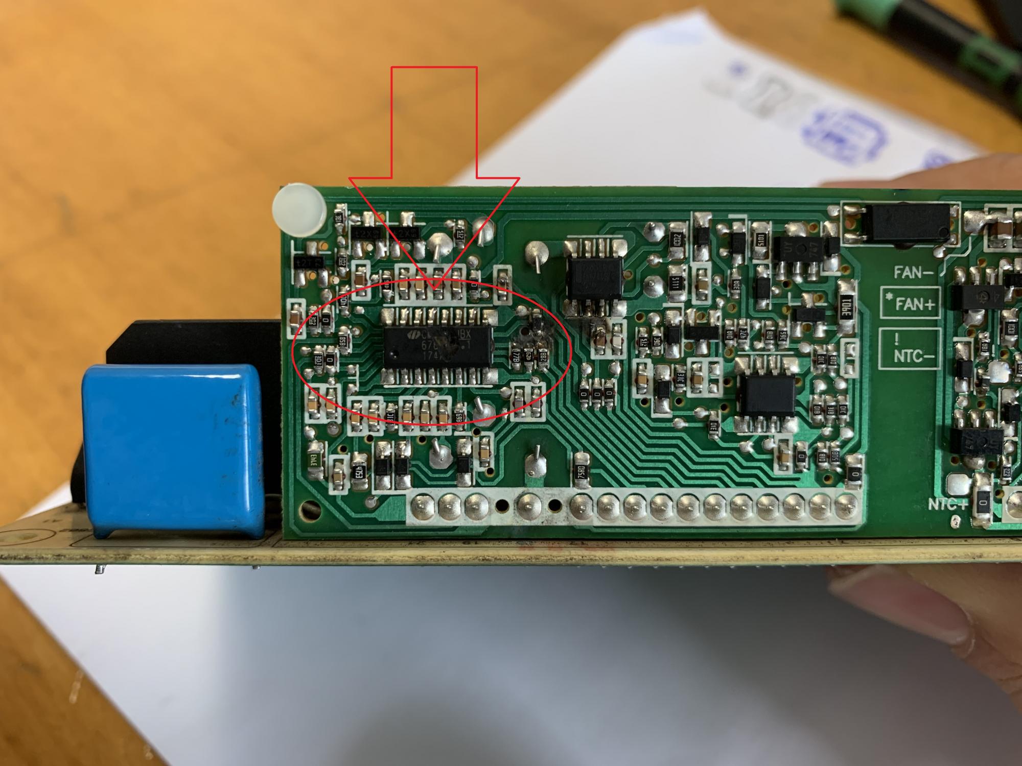

                Does anyone have a picture of the daughterboard on the side?
                My PSU has an 8 pin IC blown on the small board and I can not read any numbers on it.
                • Alex Rabinovich
                  • Mar 2022
                  • 3
                  • Russia
                  Re: Delta DPS-200PB-185A Schematic
                  left to right: CM6800, NCP1203, LM393, LM393

                    #29
                    Hello
                    can anyone help, telling me the partnumber for the component in the picture ?
                    mine is blown up.
                    thanks
                    • TecnicaNTT
                      • Feb 2015
                      • 72
                      • Portugal
                      #30
                      Originally posted by alex rabinovich
                      left to right: Cm6800, ncp1203, lm393, lm393
                      thanks !
