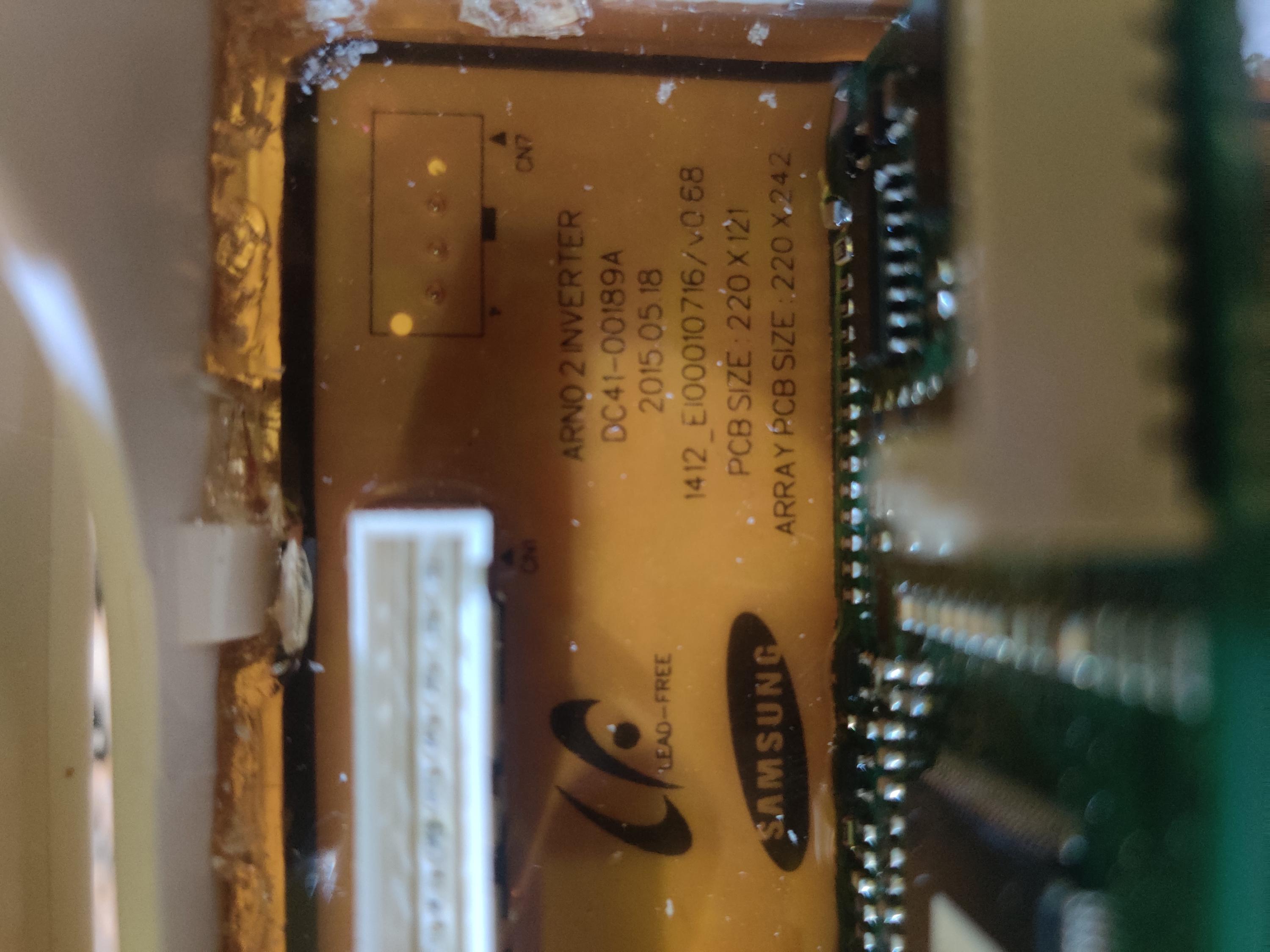

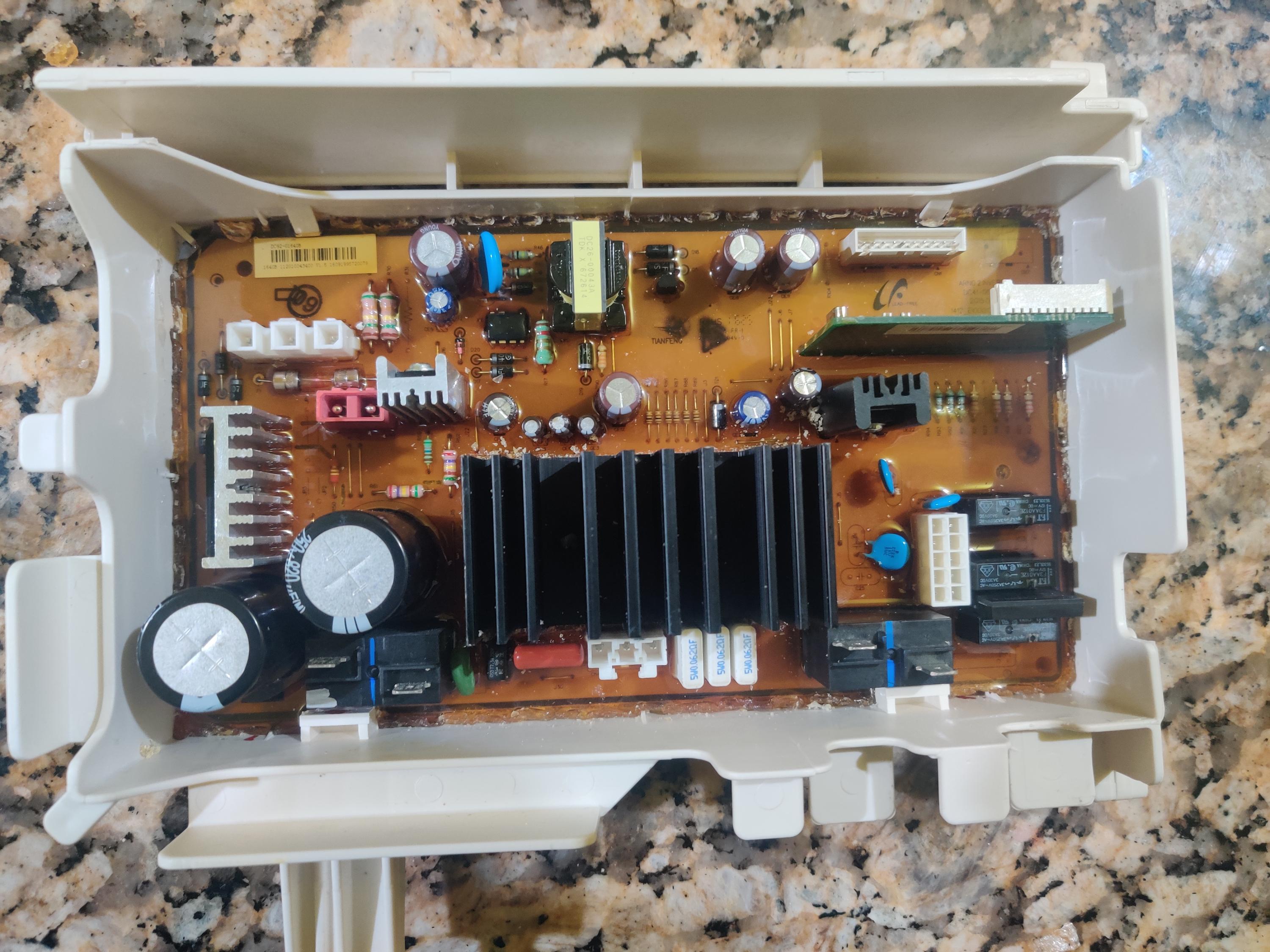

    Hi there,
    I have samsung eco bubble washing machine.
    I was using multimeter probes to test voltage and the probe slipped and it seems something was shorted.
    Now the machine won't power on.
    PCB dc41-00189a
    I'm a Newbie Please help me to troubleshoot this pcb.

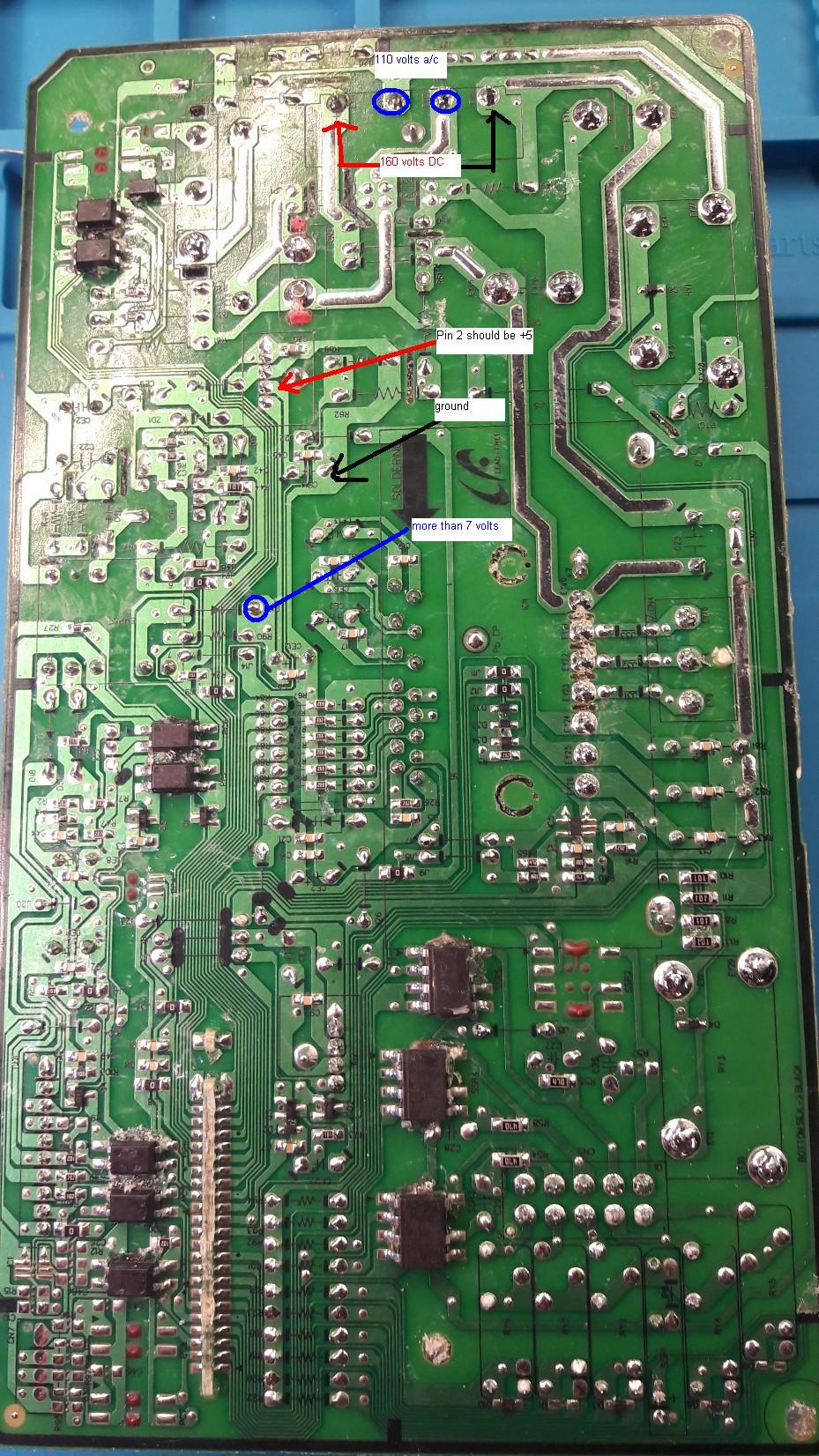

                  I am using J26 as the Ground. Here are the Results:
                  Input of Regulator IC is not constant. It moves between 7.5VDC to 2.2VDC constantly. It goes DOWN and then UP again.
                  Regulator Output is not constant either, Moves Between 5.5VDC and 0.7DVC constantly. It goes DOWN and then UP again.
                  There is no fixed readings for these input and Output.
                  What wher you checking when you shorted something? that might give a clue to what you shorted.
                  I was checking the voltage of the Big Capacitor and the probe SLipped. RED probe was on the + of Capacitor and BLACK probe was on the Ground of the Regulator (I wasnt sure what I was doing).
                  The RED probe slipped and touched something in that area and the Board gave a CLICK sound and went off.

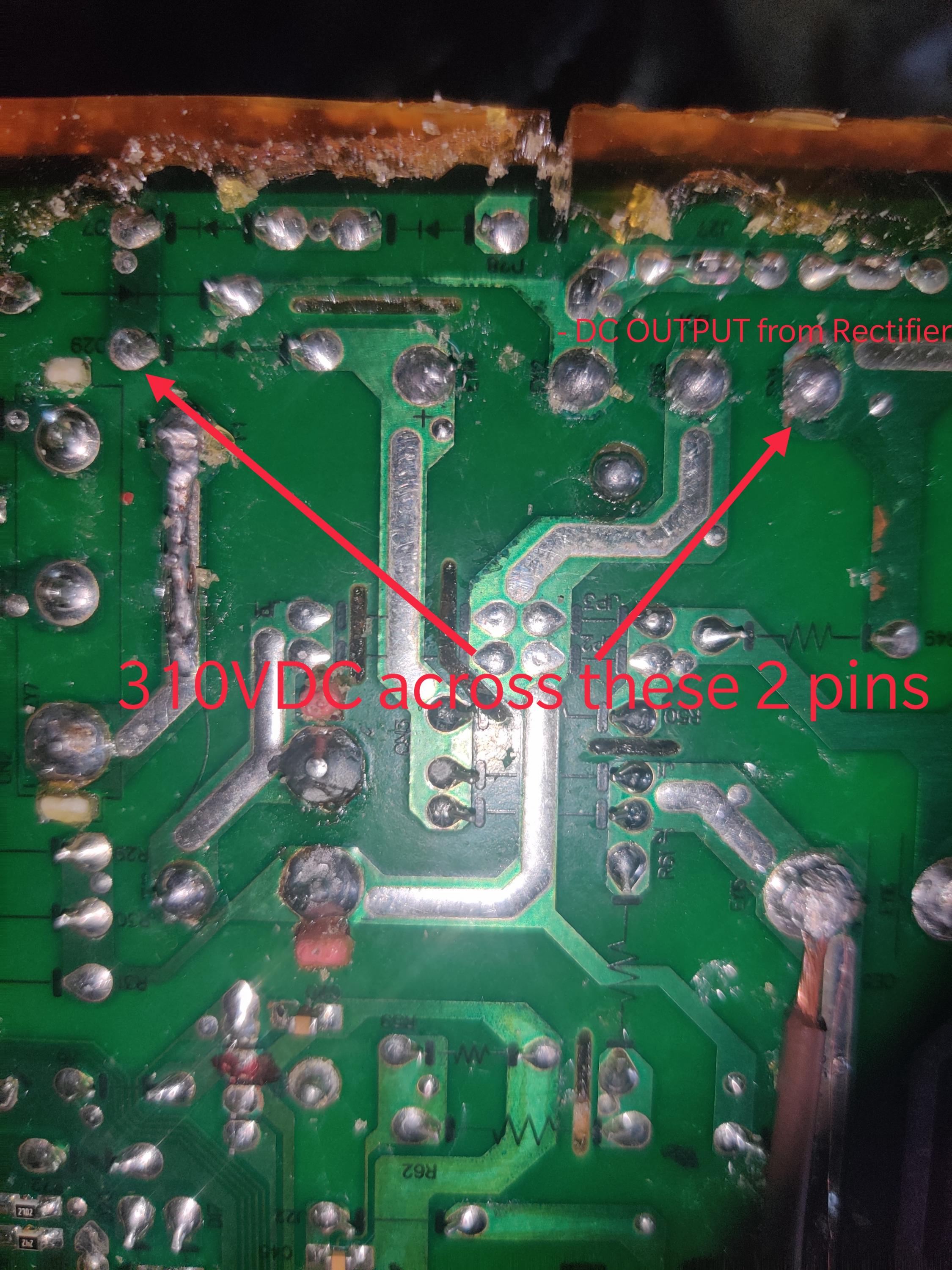

                      The output of the Bridge Rectifier is about 7VDC across the 2 outer pins.
                      That seems weird to me as well.
                      The input is 110VAC at each center pin (I used the Chassis as the ground for this)

                        Re: Samsung Washing machine won't power on dc41-00189a
                        There are two different grounds, When checking voltages on the primary side you need to use, HOT ground or Bridge rectifier (-)
                        When checking voltages in the secondary, you need to use cold ground (see picture of trace side)
                        It is likely that the main bridge rectifier does not have any A/C input due to the main relay not being energized
                        Which "BIG" capacitor where you checking when the probe slipped? one of the 820µf caps in the primary? or CE2 primary for the smps

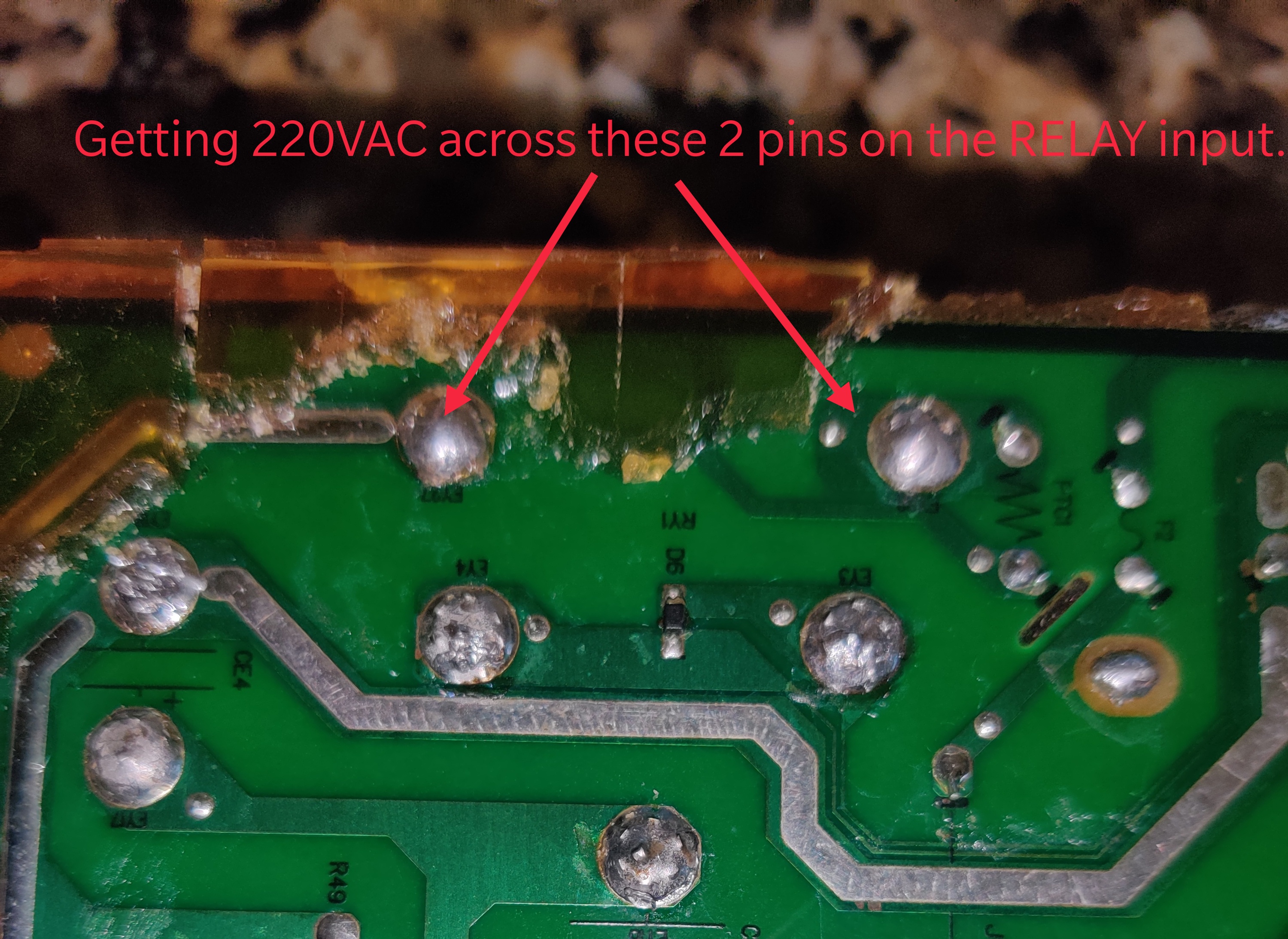

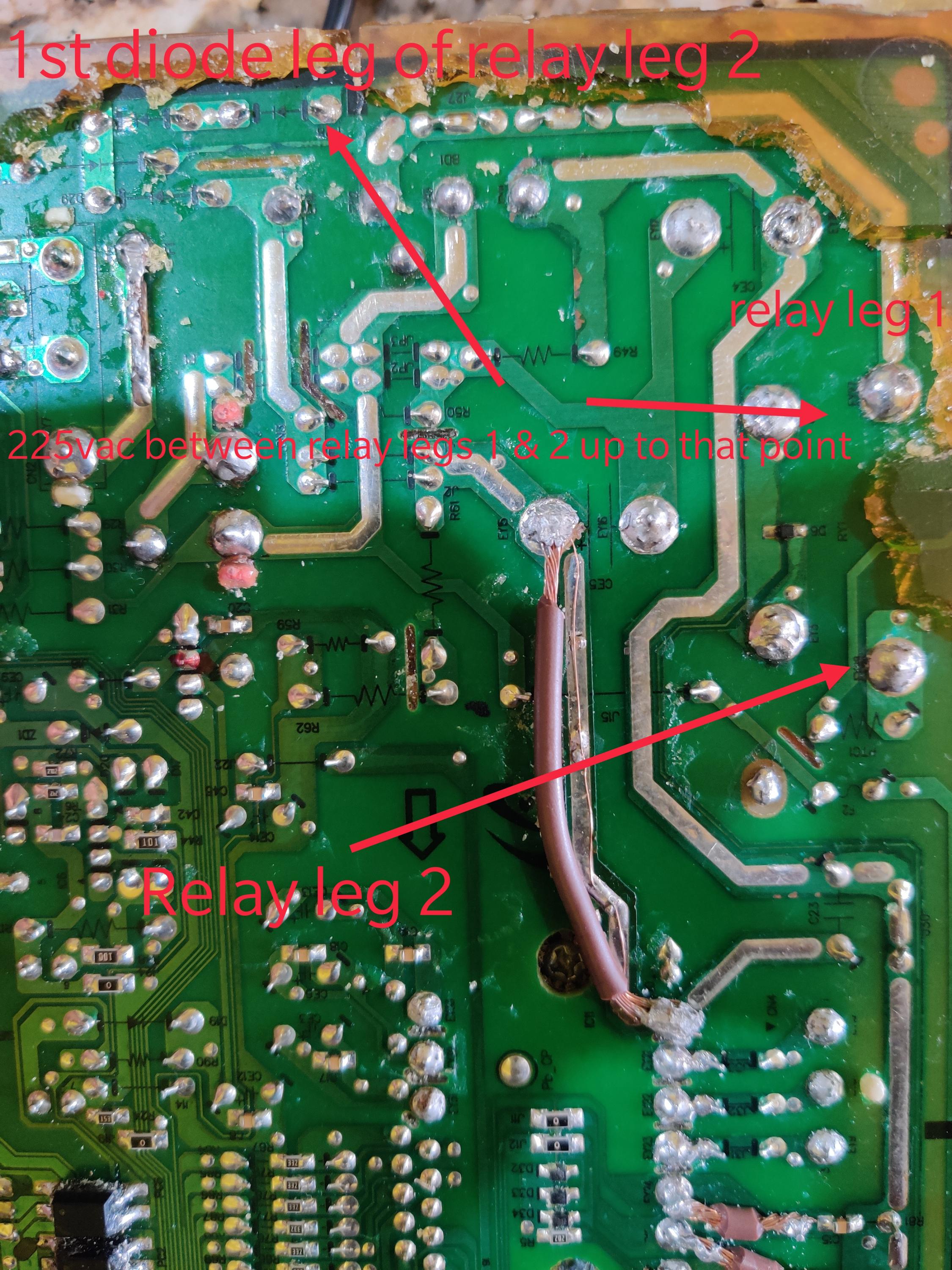

                          The MAIN Bridge Rectifier has 110VAC on each of the 2 Middle AC pins

                              At pin 2 where I should be getting +5 dc I am getting no constant voltage... Moving from 5.5vdc to 2.5vdc and back. Not constant.
                              At the pin where I should be getting 7vdc I am not getting a constant voltage... Moving from 7.5vdc to 2.5vdc and back.
                              Could there be an explanation for no constant dc voltage at those points?
                              I used the recommended hot and cold grounds.
                              Please point me in the right direction.
                              I am getting 3vdc on the output of the main Rectifier bridge.

                                Don't worry about the main bridge voltage, you will not have any voltage until the relay connects it.
                                You could have a bad voltage regulator ic, or there could be a damaged component that is supplied by the regulator. You could also have a bad smps circuit that is not operating properly and causing the voltage to jump up and down.
                                There is also a 12 volt regulator IC on this board (KIA78R15PI) you need to check it's input and output voltage as well.
                                Check if ZD1 is ok and not shorted, then check the other diodes in that circuit, D17, D20, D19, D5 (and the one next to it D?)

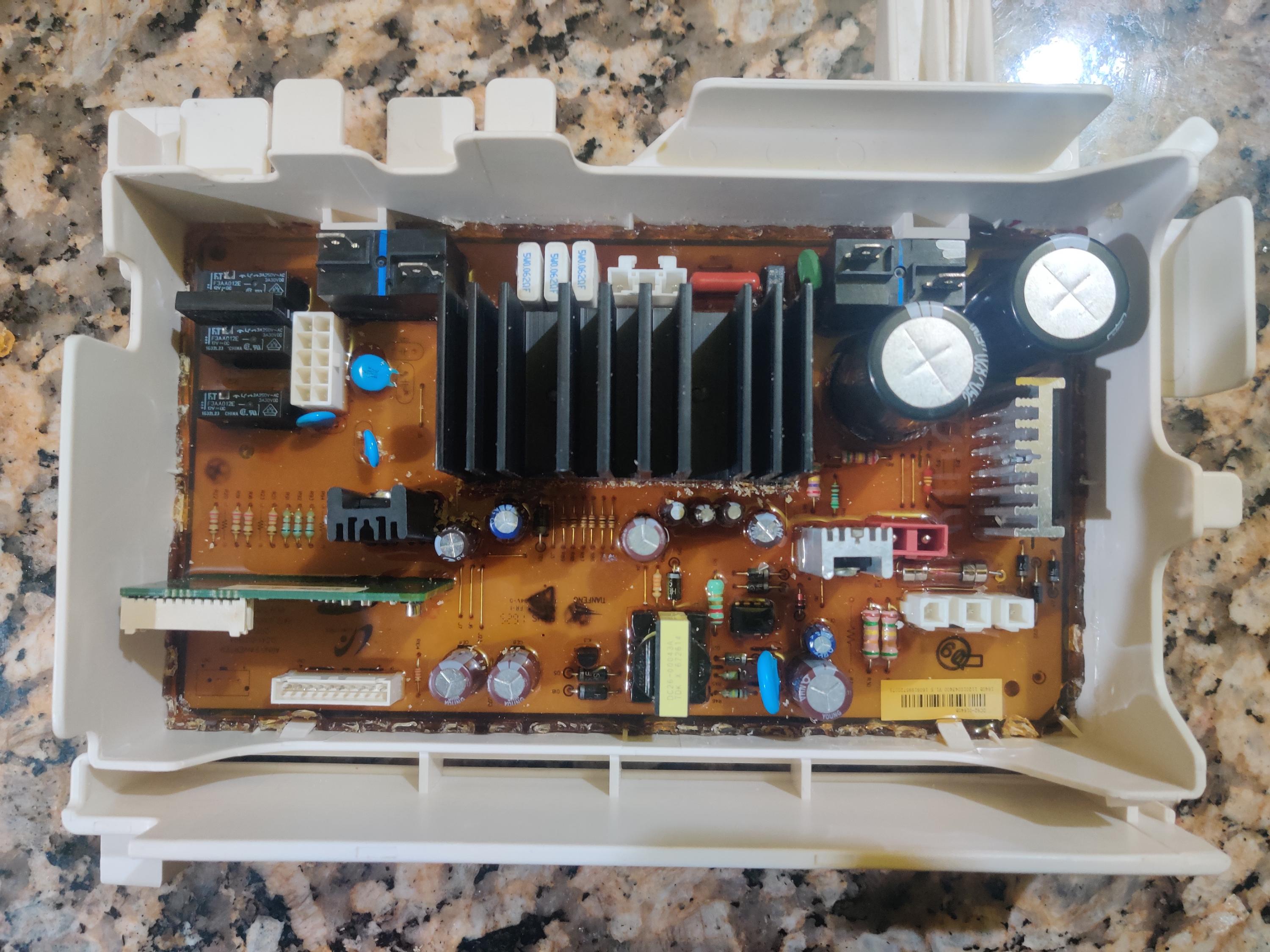

                                  Zd1? Was this one a typo? I don't see any component with that marking on the pcb

                                    There is a glass diode, ZD1, near D20 and CE9 (near the 7 pin smps ic) Also I believe the 12v regulator (ic2) is mounted to the small black heatsink

                                      There is no shorts in the diodes in that circuit. Here are the readings for each using the diode test function of the multimeter
                                      ZD1: 580
                                      D5: 512
                                      d18: 516
                                      d17: 570
                                      d19: 515
                                      d20: 594
                                      I also reversed the probes of the multimeter and the reading was 1 on each of those diodes.
                                      Input is 3.5vdc to 1.5vdc... not constant... Up and down
                                      Output is 2.5vdc to .75vdc... Not constant... Up and down
