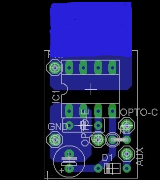

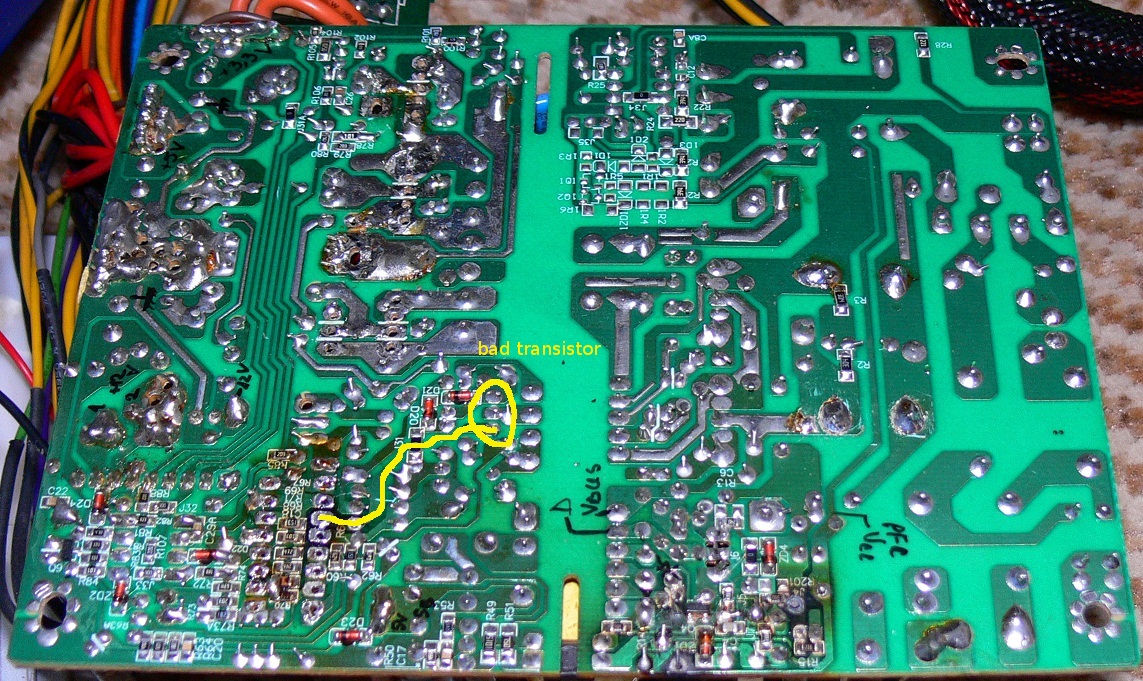

    Will do, as soon as i get back home, in a couple of hours. "Top down" = photo from the component & heatsink side, right?
    Time zone difference <= i'm currently studying and working in Finland; currently 1:34pm over here
    The 5vsb board is only done "virtually"; i'll enlarge the drain trace anyway, for better heat dissipation. I'll figure out something until i actually etch it / put it together.

      Re: Antec SP500P "resurrection"
      Also, before etching that pc board, you might want to add a little more heat sink. See my attached photo as suggestion.
        Yeah, something like that is what i meant by "enlarging the drain trace"

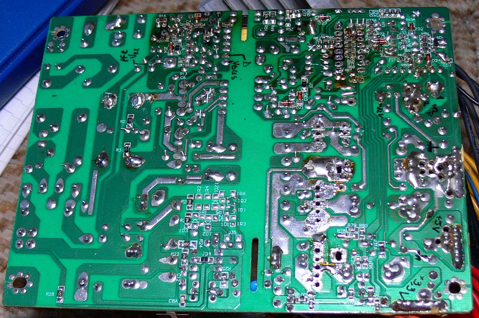

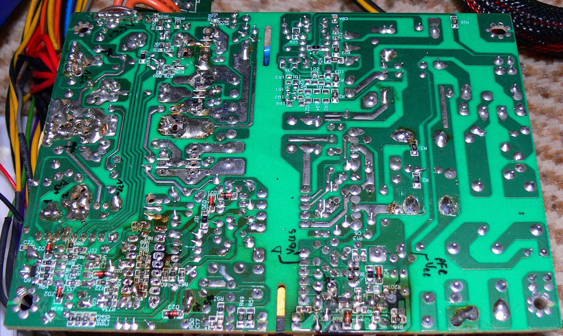

          Ok, here are the results of today's photo shoot: two views of the solder-side (so each side can be well seen in the foreground), one view from the top, and a detail with the PFC section.
            Solder side photos look great. Now you might as well remove the other heat sink and its transistors The smaller of the three transistors is the 5vsb switcher which you won't be using. So you will have to remove the heat sink to get it out. Then you can take some photos of the entire top side of the board and we can begin looking for other damage around the switchers. You won't be able to see it very well until that heat sink is out of the way.
            While you have the heat sink out you will be able to measure the transistors for leakage. Also let us know what transistors are being used (markings on the transistors). Mine were D209, yours may be something else.

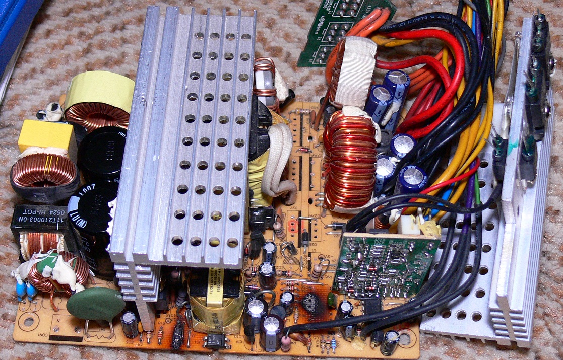

              Yeah, i was thinking about removing the other heatsking as well. Gonna do that when i get back home today (leaving for school / work pretty soon; 7:30am here).

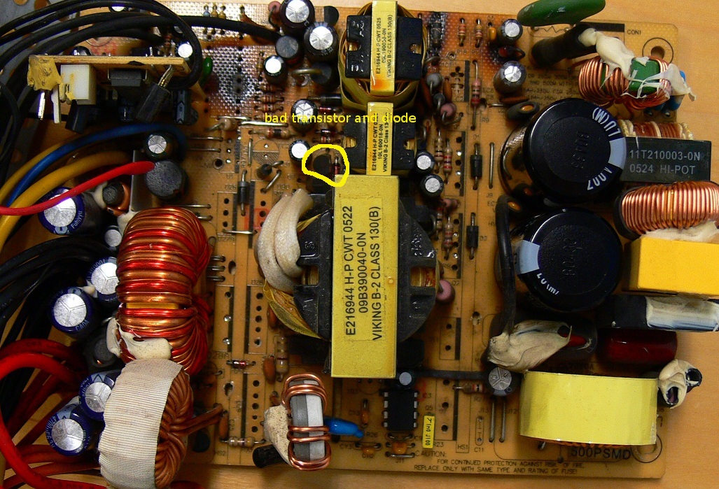

                  Update: As i was de-soldering the main switchers, i got to the 5vsb switcher, and i noticed there's an exfoliated track (the one that passes under the J6 chip jumper, and maybe under the (MELF) ZD4 (there's some black stuff between it and the board surface).
                  This is somewhat visible in the 3rd photo from my initial post.

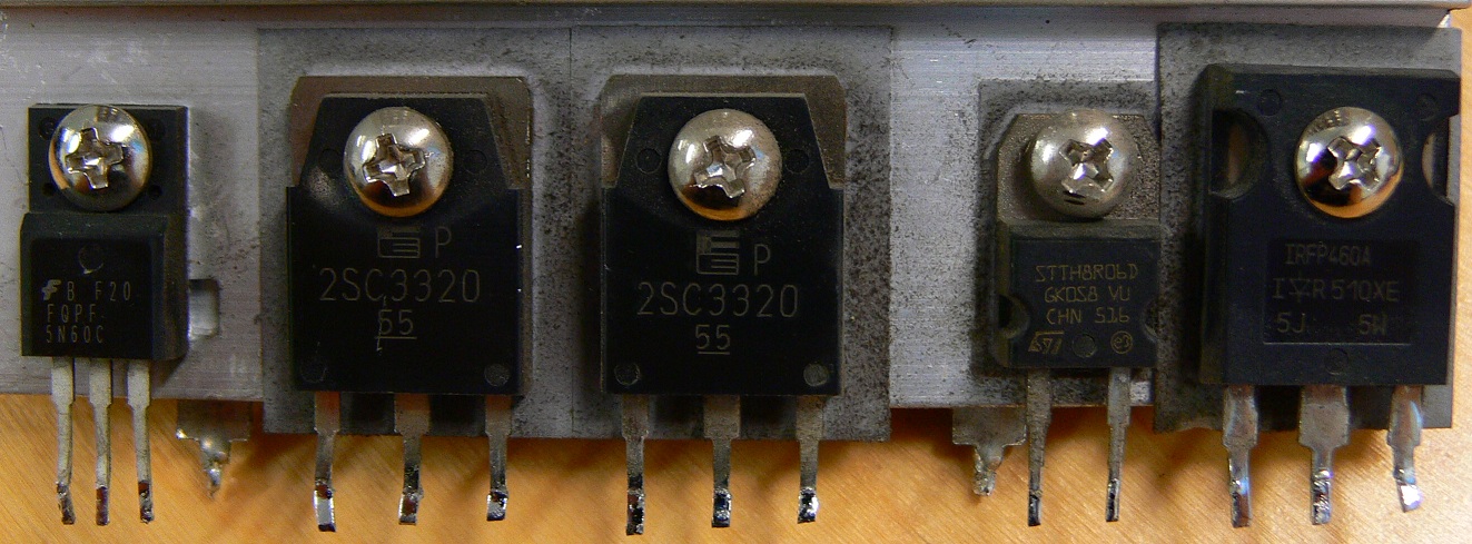

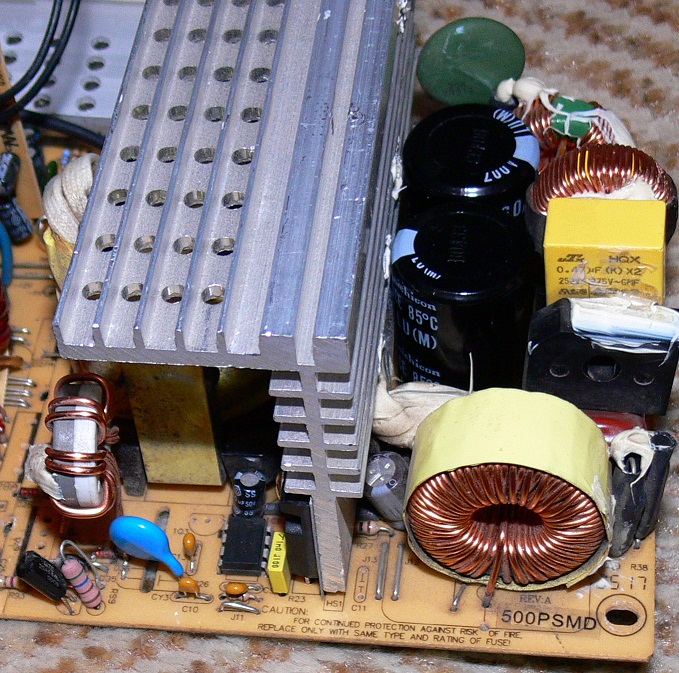

                    I ended up bringing the PSU and my soldering gun to school, so here's a couple more photos, the primary heatsink with the silicon, and a "more naked" top view of the board.
                      The main switchers (2SC3320) seem ok (Vbc=436-438mV, Vbe=527-540mV). PFC diode = 392mV, PFC switcher seems ok (483mV with red probe on drain and black probe on source).

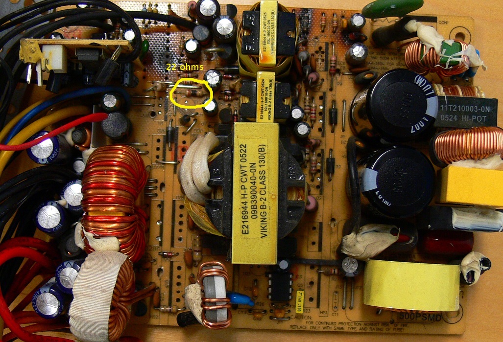

                        Resistors in main switching circuit don't look burnt - that's a good sign.
                        The value of the burnt resistor (see attached photo) is 22 ohms 5%. I think you will need to replace it!

                                The bad transistor which caused the burn damage needs to be replaced. See circled parts in attached photo. The diode in the circle is probably bad also. You will not be able to measure it while in circuit. It is just a 4148 diode, very common.

                                    That small bad driver transistor is an H945 device. I looked up the datasheet for that, and the 2SC1815 and they seem to be a 95% match (a difference in the ft, but for switching at under 200KHz, that shouldn't be so critical). I've got a few of those recovered from some other psu's so i'll make the switcharoo tonight.
