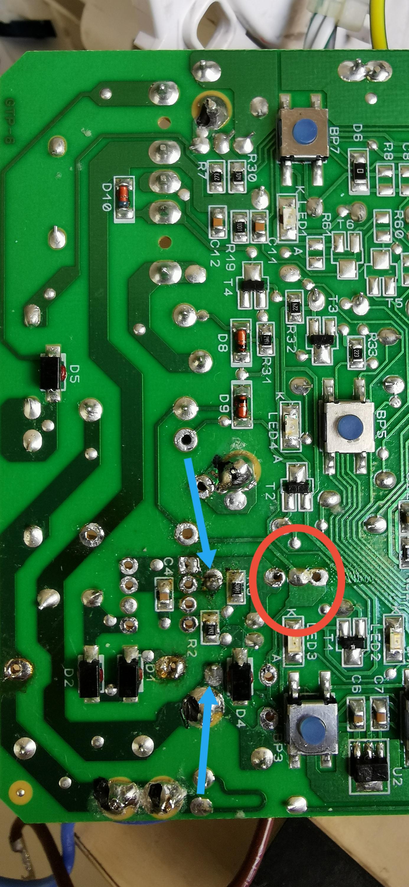

      Now about D3, what other bad components would cause the 2 solder points to read, with or without the D3, 30ohm both ways?
      • CapLeaker
        Leaking Member
        • Dec 2014
        • 8352
        Re: Tefal GV8962 Pro Express steam iron - no power
        Originally posted by beetle1303
        Sorry, I don't get what you meant..

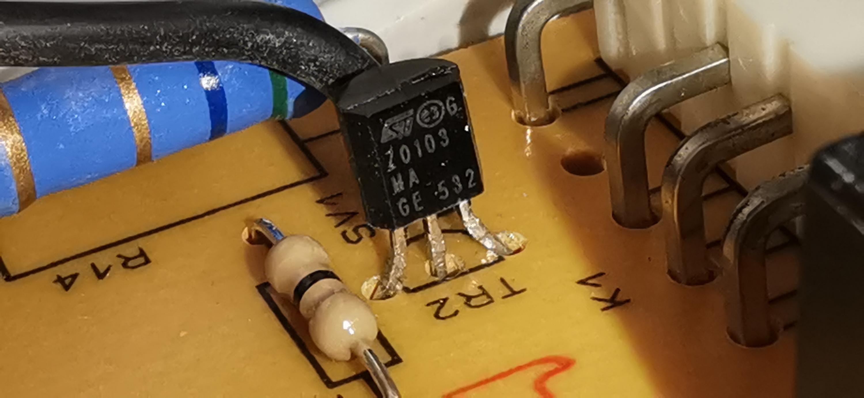

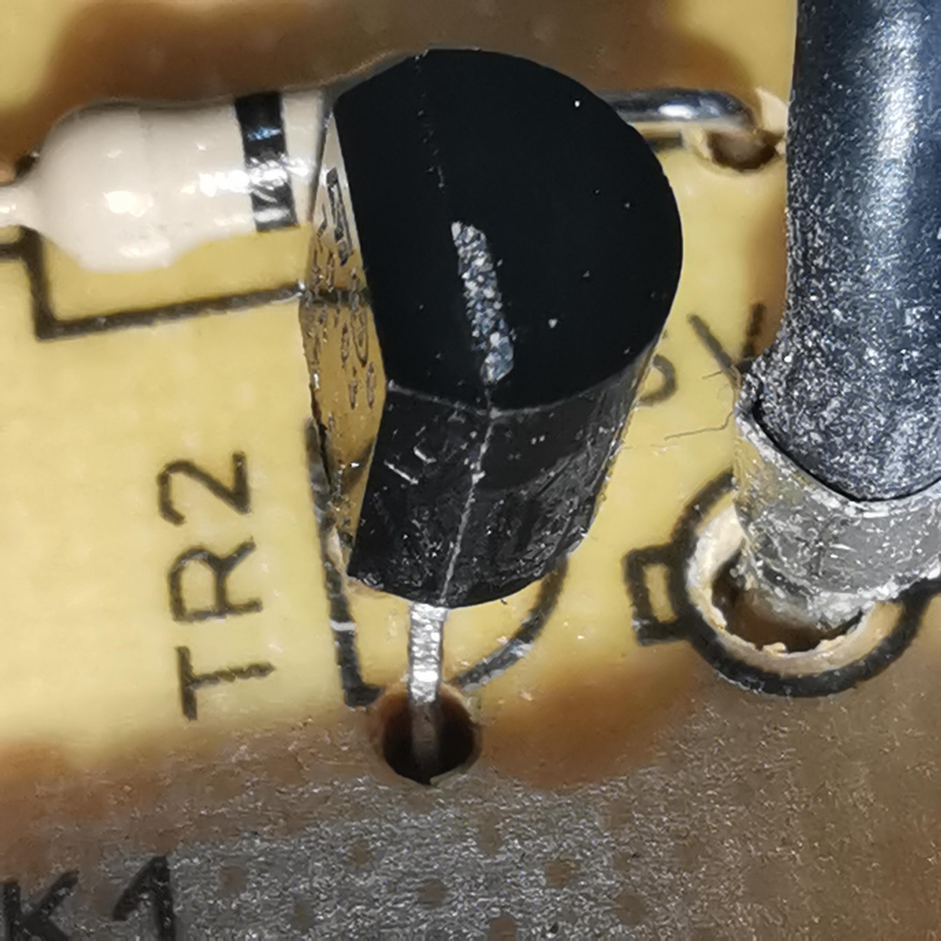

        TR2 reads 846 ohm one way between left and center pins, 793 reversed direction, and open in all other combinations.
        Your pic #1 bottom right. TR2 looks like it is damaged a little on the top. What is printed on TR2?

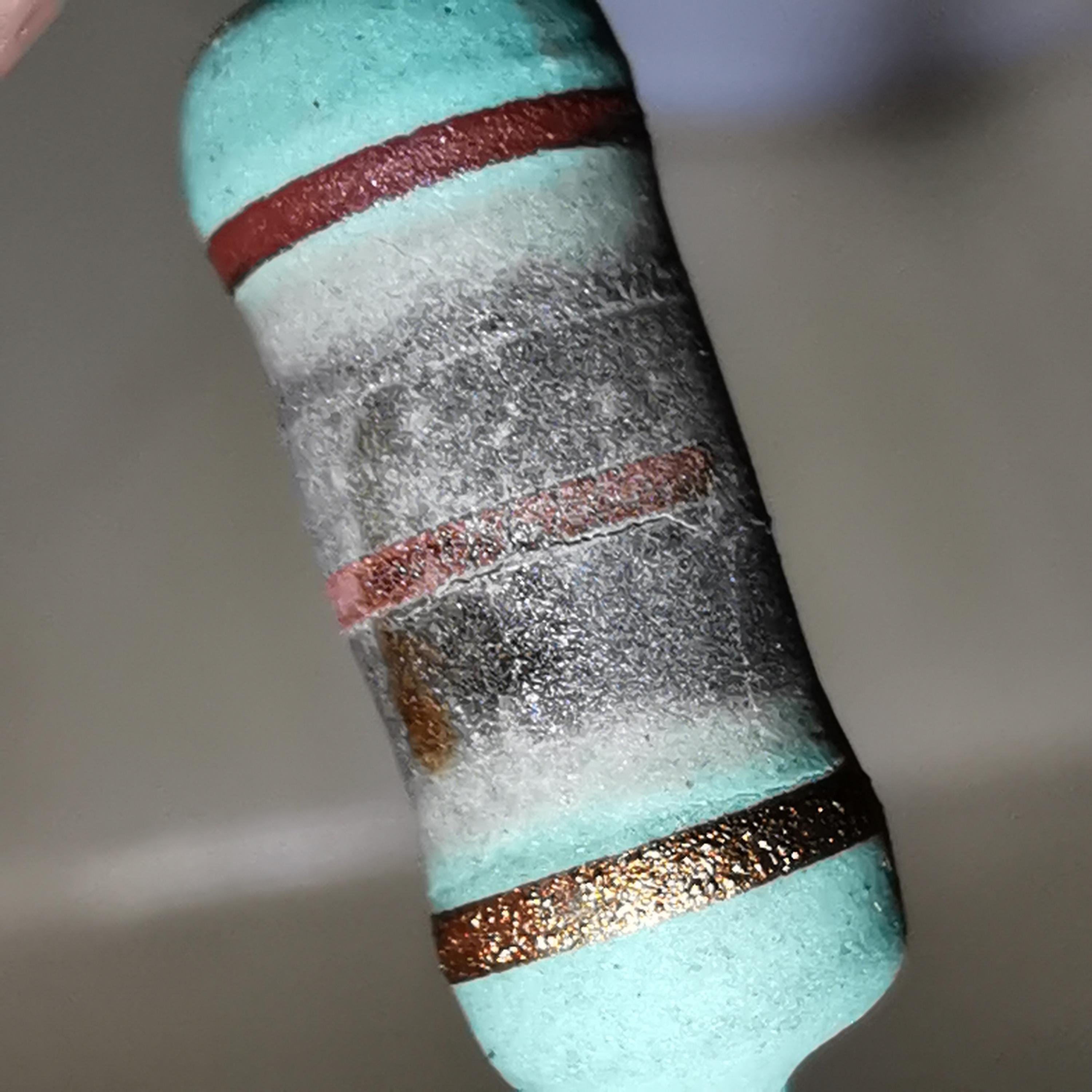

          Yes, using this 5W 100ohm is bad idea.. I have gotten a 2W 100ohm to try out later.
          Yes, that was a very bad idea actually. In this case this resistor is a flame proof (green colour) resistor that is used a fusible resistor. Now you putting is there a 5W resistor, I am not sure if that is actually the only damage it did (blowing that 50V cap).
            Z0103MA. There is some think there but don't seems to be cracked...
              Yes, valuable lesson learnt, thank you.
                The value of that fusible resistor will be likely be <10 Ohms.
                  https://ar.pinterest.com/pin/621848661029499082/
                  From this picture view - it seems like a 4-band resistor: Brown, ?, Brown, Gold. Brown, Black, Black, Gold gives 10 ohm, unless it's Black, Grey, Black, Gold to give 8 ohm?

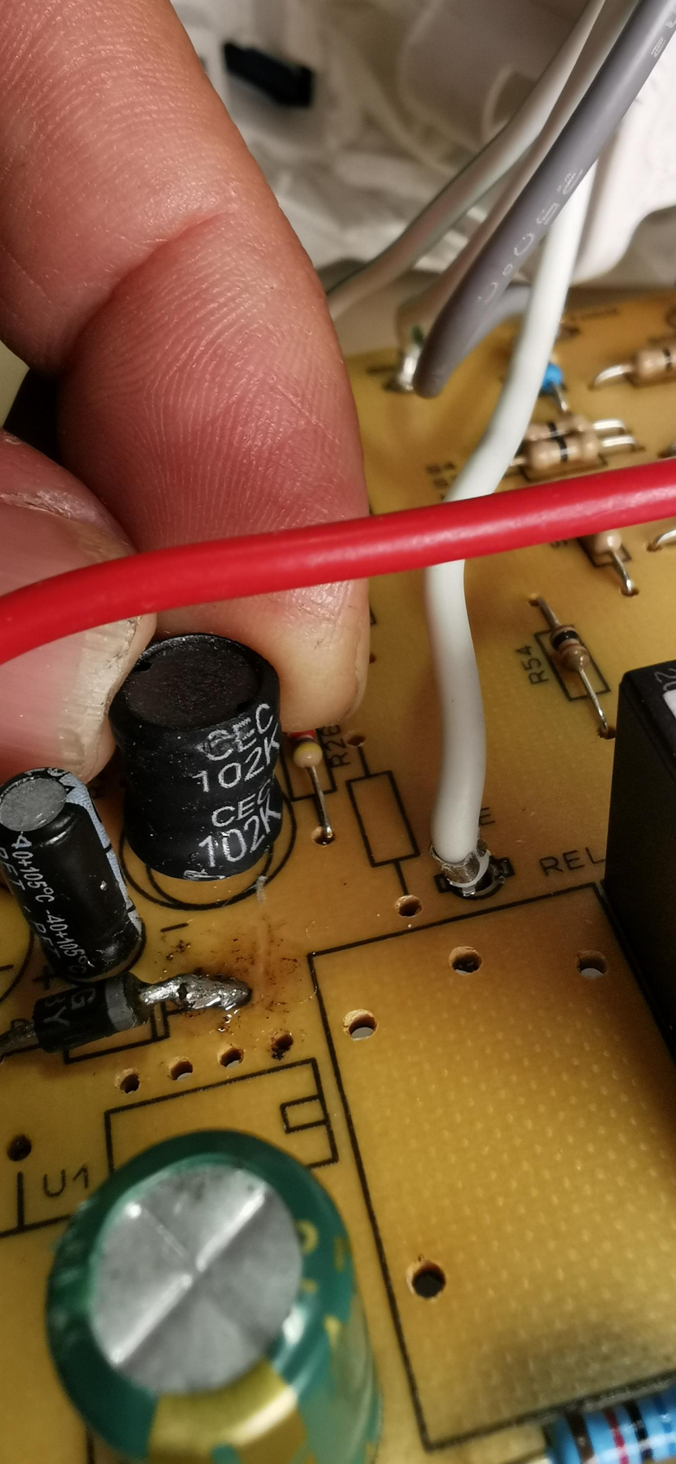

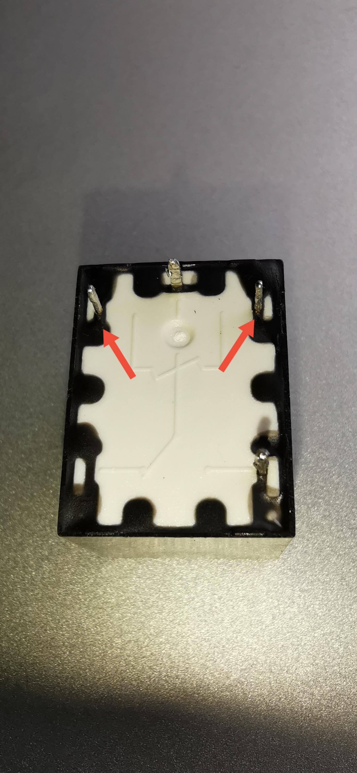

                    #29

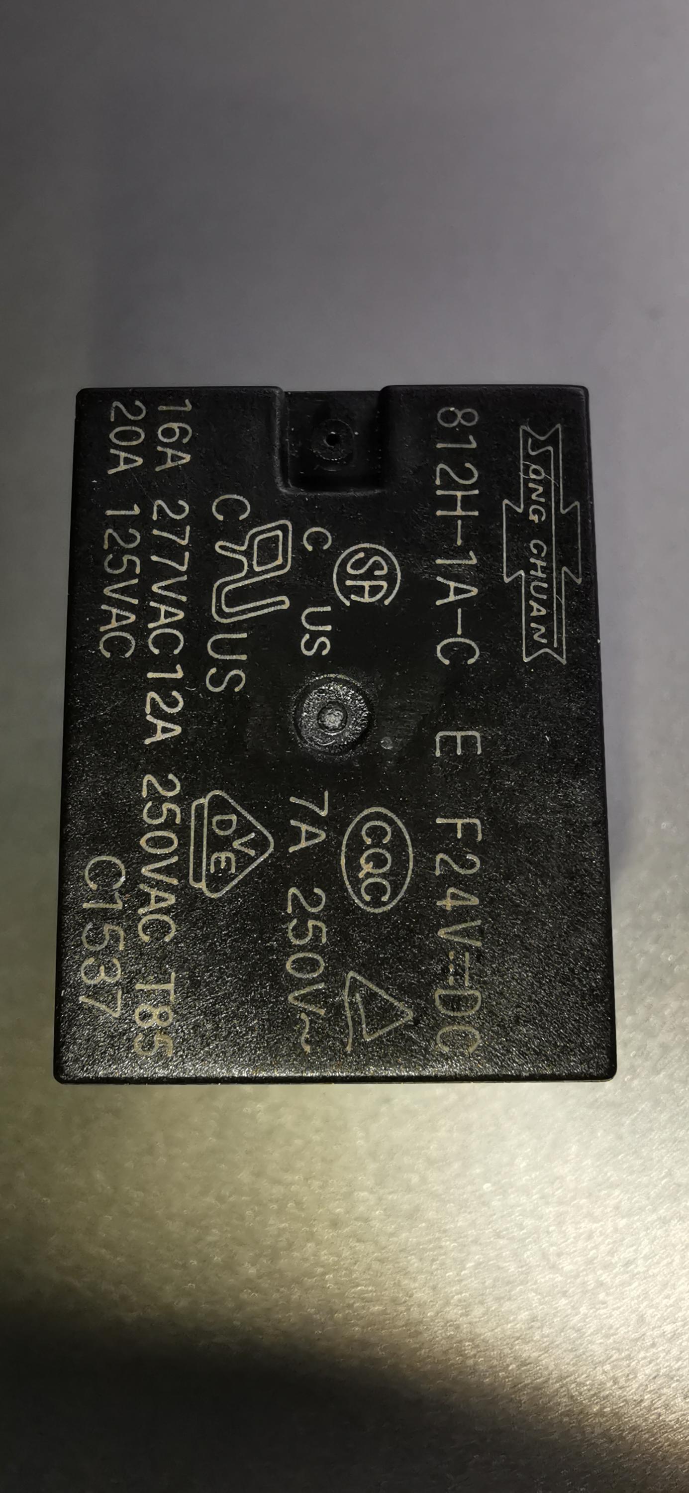

                    I moved one of the 2 relays, and here's a findings:
                    1) The pins (red arrow) reads 1569 ohm
                    2) I applied 12V, both directions, to these pins thinking it should click, but it does not.
                    3) The in-circuit relay also reads 1569 ohm, and also does not click when applied 12v to the coil pins.
                    Is this normal?
                    Next I removed the inductor L2:
                    1) I don't have DMM that read inductance, but resistance reads 1.8 ohm.
                    2) With L2 moved, D3 now reads correctly at 579 ohm in one direction only.
                    Does this means L2 is bad and shorted?
                    • CapLeaker

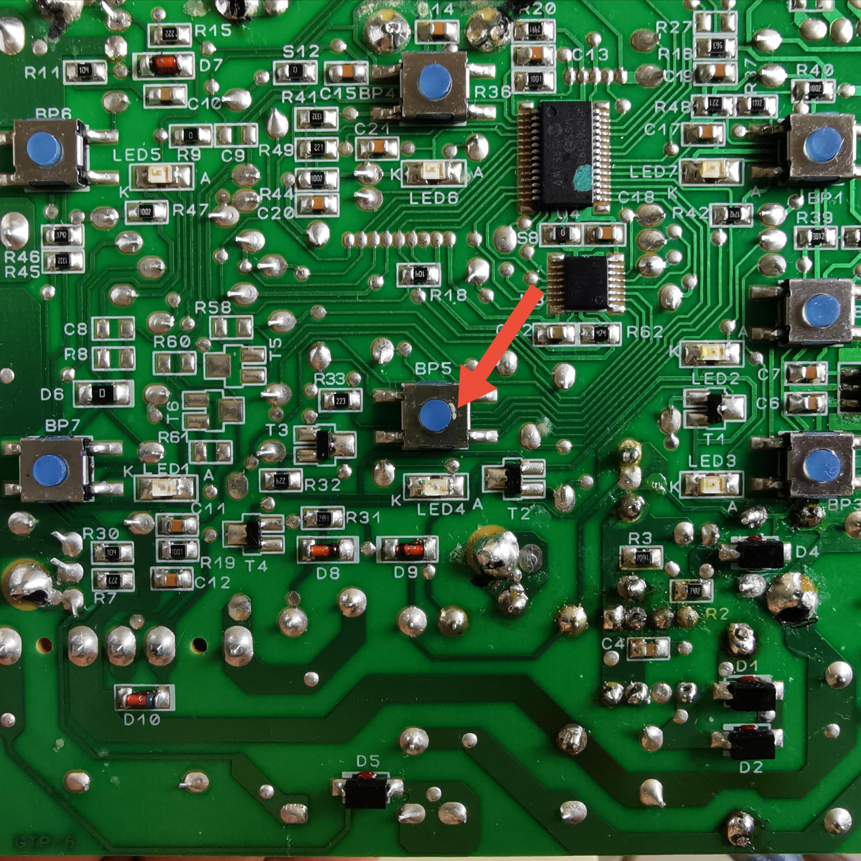

                      #30
                      the first 2 pictures show a 24v relay not a 12v, the 3rd pic the inductor. The inductor should be ok showing 1.8 Ohms.

                            #33
                            Arh.. silly me.. Yes, I applied 18v and it clicks, both off and in-circuit.
                            With Inductor L2 removed, D3 measured correctly at 579 one way. When removed, it measured 30. Seems to by-passed to a shorted circuit somewhere?

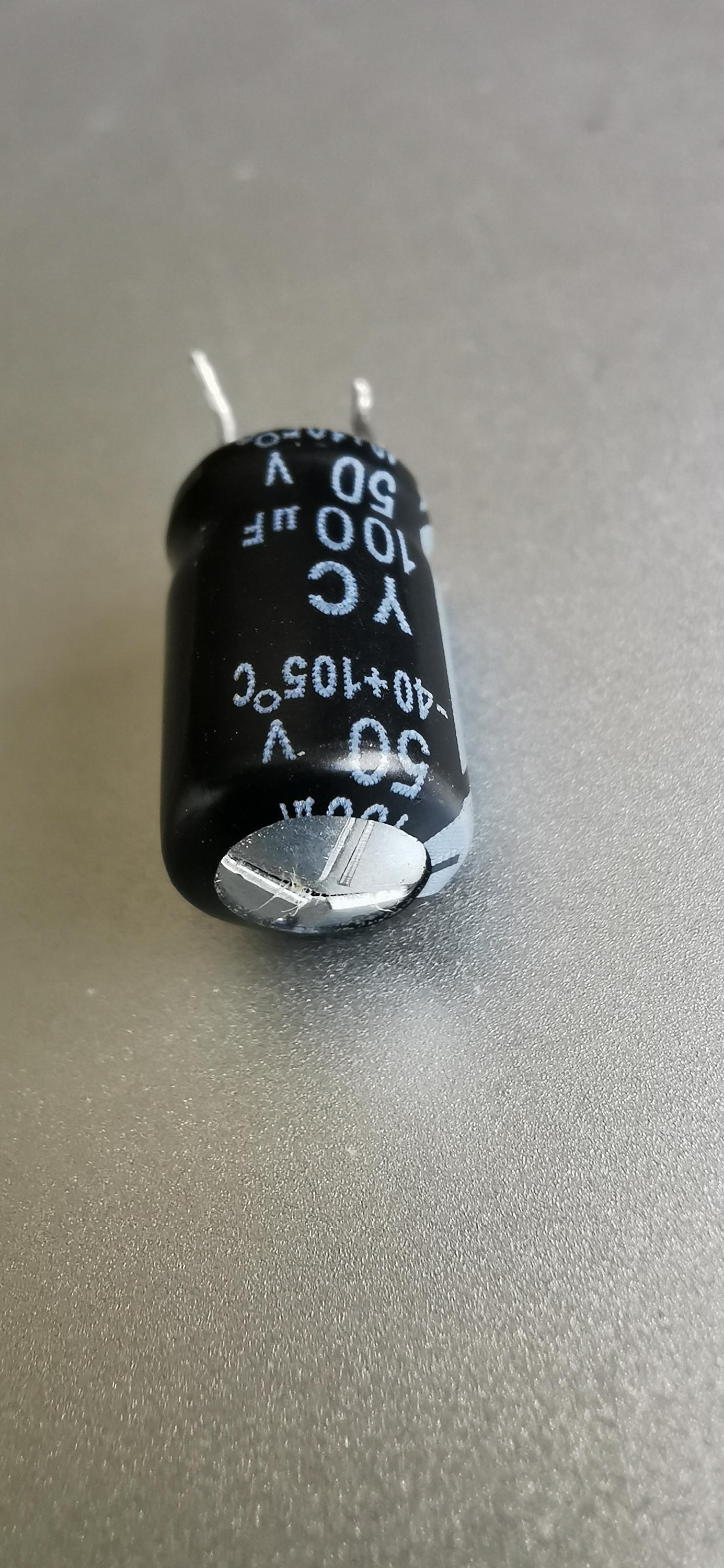

                                #35
                                Why don't you remove C2 and check it out of circuit, or remove it and check the solder pads to find out what is reading 30Ω

                                      #38
                                      C2 already removed when it "exploded" on powered up.. but it still ready 89uF off circuit. The 2 solder pads between them ready 30ohm. I traced the +ve pad along the path to R31 and R31 read 120k ohm.
                                      Not sure where to trace further...
