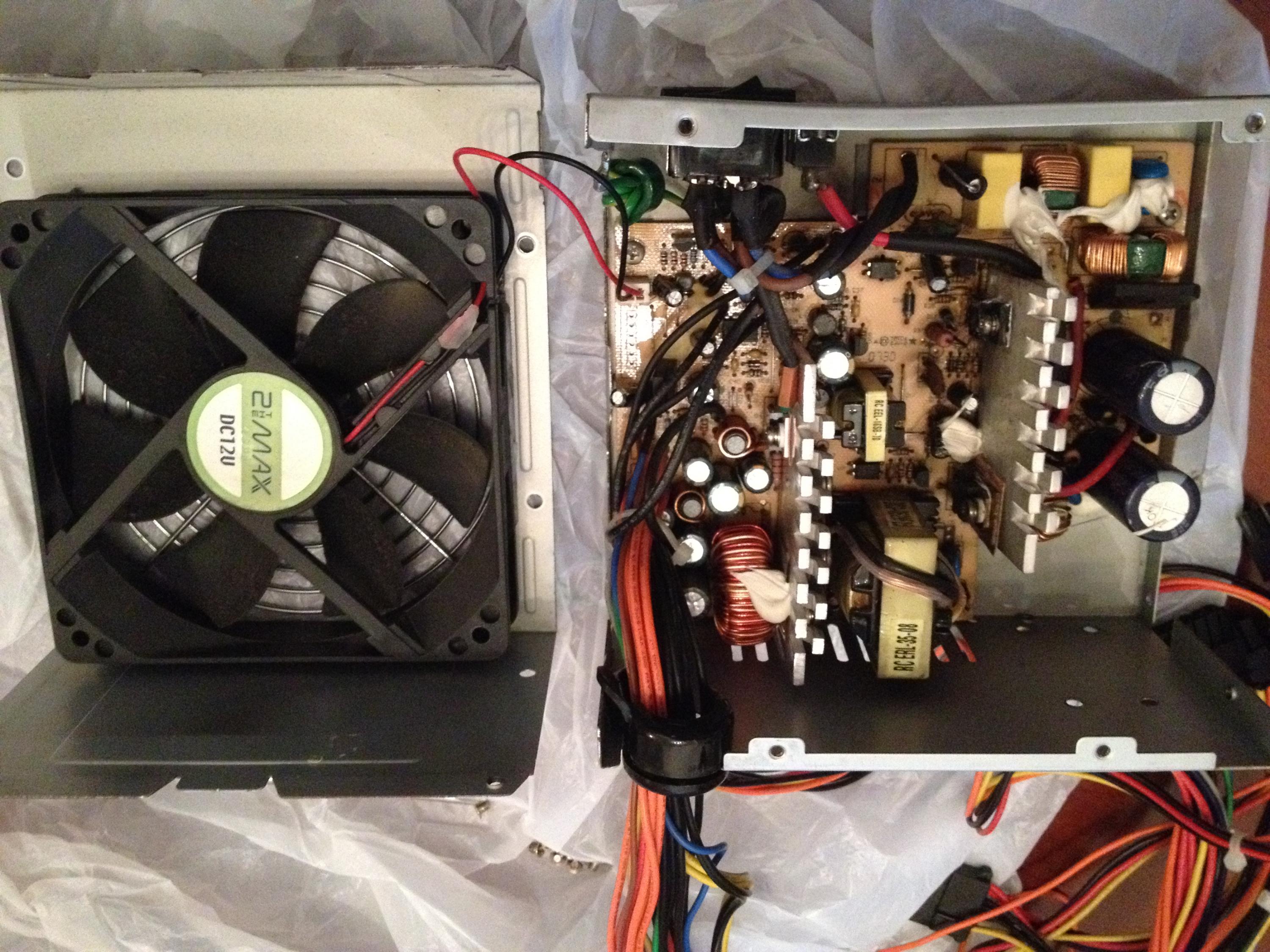

            2theMax VP350R. Seems to have a complete transient filter stage. Pair of Capxon 680uF primaries. Tiny heatsinks though. Junk or a keeper?
              Re: the gutless, bloated, and fried power supply hall of shame
              Seems to be able to do like 300-350 W. But the input caps seem rather small for 680 uF to me.
              Just wanted to ask about this heatsinsk too. They have rather small area at first sight, but I think I can help it by bending the fins. On the other hand, it is thicker than the usuall thin crap with more fins. Do you think it will be better for cooling?

                      Why does this PSU only have one toroidal coil in the secondary filter stage? I have typically seen two in most power supplies?
                        I guess it doesn't use a magamp for the 3.3V, but runs it directly off the transformer.

                          What are the transistors and rectifiers inside? Seems like 13009 and some TO-220, if they are shottkies, than it's definitelly better than it seems on first look…
                              Definitely a keeper!
                                Primary switcher is a ST P10NK60Z. I can only make out the 3.3v rectifier which is a MBR3045.

                                        As for the PSU, I think one toroidal coil and two ferrite coils for the PI filter is fine: it's a transistor forward design so it's more effective. Remember that toroidal coils can get warm, and it seems there is a decent amount of coils on the primary.
                                        I've always wondered, though... how would a pair of 13009s (TO-220 or TO-3P/TO-247 as some of them are) compare to the rectifier shown (STP10NK60Z)? Especially since this is a forward rather than bridge PSU...
                                          I have a PSU just like that (a 430W Thermaltake). That PSU actually uses DC-DC conversion from the 5V rail, which is why there is no separate toroid coil for the 3.3V rail. The part for it on the heat sink is a MOSFET.
