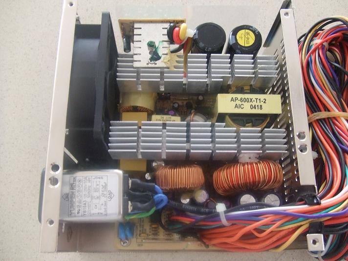

    Overview shot. Quiet a well built power supply. The transient filter starts out with a 3300pf Y cap and a .1uf X cap built into the ac receptacle, as well as 4 Y caps, 2 X caps, and 2 coils on the PCB. The bridge rectifier is crammed in there as to where I cannot see what it is, but has a heatsink and is right in front of the fan. You can also see the secondary side chokes of massive proportions.

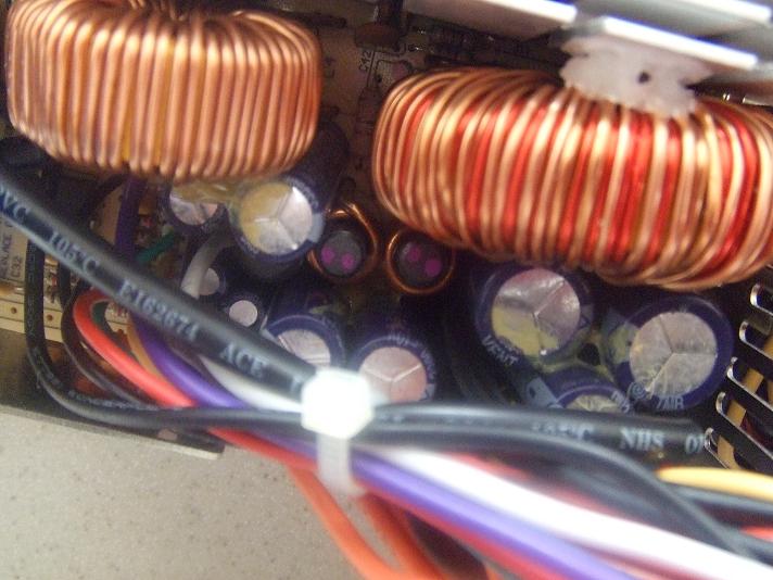

    The secondary caps. Sigh. Yup, Fujiyuu. Every one from the 820uf primaries, all the secondaries, and even the small ones down to the 50v, .1uf's. I ordered new caps for the secondary from topcat. I was able to match, or exceed, all of them except for the 4700uf, 16v cap on the 12v rail. The 12v is filtered by one 4700uf 16v (12.5mm x 25mm) and a 3300uf 16v (10mm x 30mm) I ordered 2 Samxon 3300uf 16v caps (10mm x 30mm) I remember hearing somewhere on here that kc8adu or somebody took one of these brand new 12.5mm 4700 Fujiyuu's and it wasn't even close to 4700, so it should be fine.

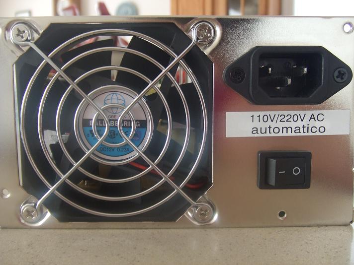

    Now a word about the PF correction on this. Remember how I said that it makes you think it has it.
    Note the 110/220 "automatico" sticker in place of the voltage switch. Nope, no switch behind it either. So it has APFC then, right?
    Well, nope. Thats what this little module is. It literally automatically switches between 110v and 220v. No PFC of any kind here.
    If you looked at the JG review of the rosewill based on the same design, you'll notice the voltages just don't budge. This is a very good platform (sans the caps). In case you were wondering, the secondary schottky's on this are as follows:
    3.3v: 1 40A, 45V schottky. Assuming 30% duty cycle, 28A. Close enough (may not actually have 30% duty cycle, just a common duty cycle)
    5v: 2 40A, 45V schottky. Assuming 30% duty cycle, 56A. Overspec'd
    12v: 1 40A, 45V schottky. Assuming 30% duty cycle, 28A. A little overspec'd.

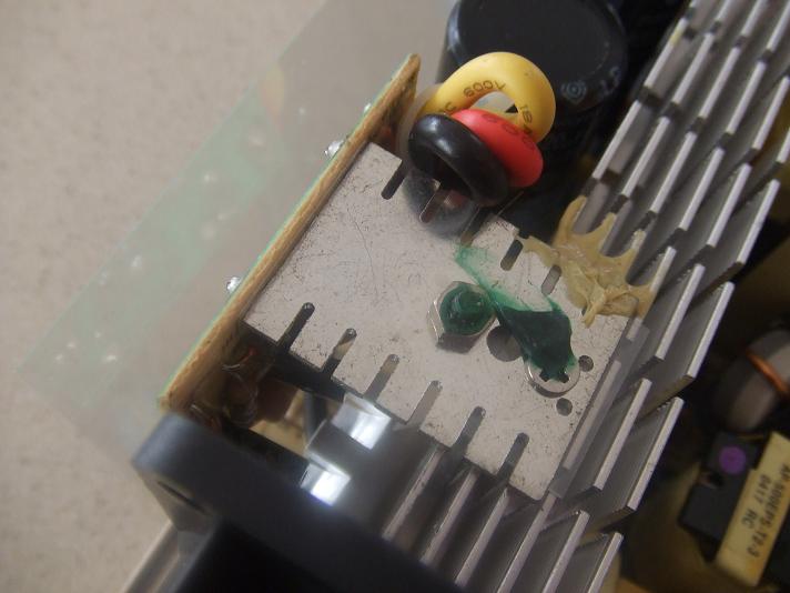

    I cannot get a good enough view of the primary switcher to ID it's part number.
