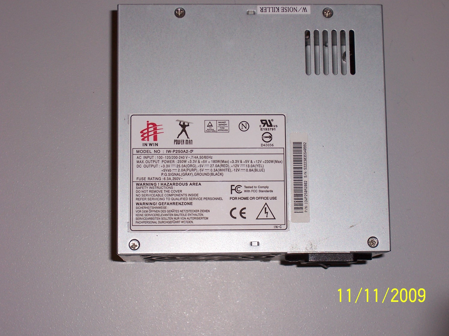

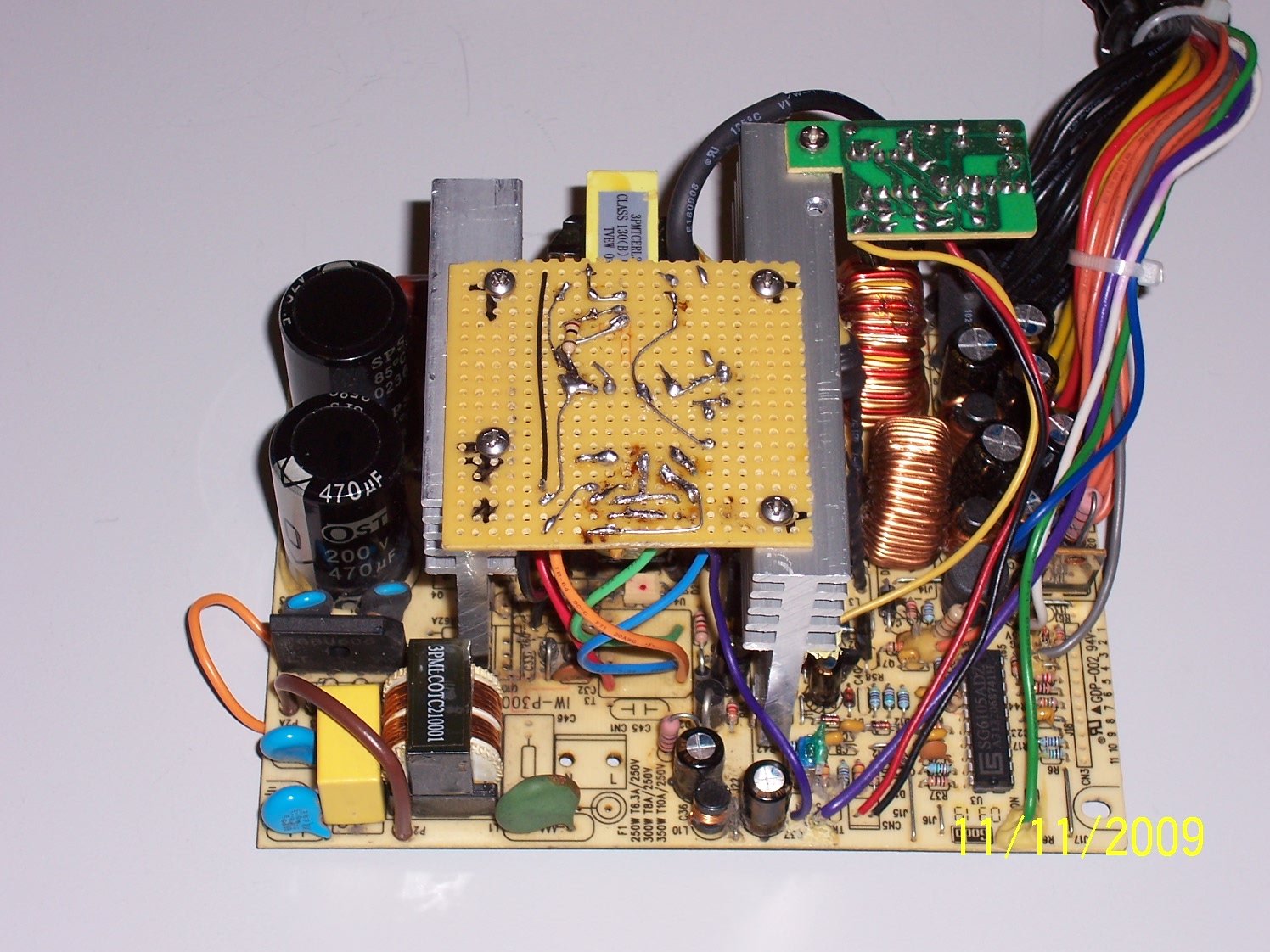

This is a Powerman model IW-P250A2-0 which had a "blasted" 5vsb circuit. Both switching transistors black and broken, along with a few other parts. I made an attempt at replacing bad parts and powered up. Blasted the transistors again, along with a few other parts, and damaged the 5vsb transformer, one winding open and one winding shorted.
I wasn't able to find an exact replacement transformer, but used a transformer from a Fortron psu which had a badly burned pc board. I constructed a 5vsb circuit on breadboard using the DM311 IC rather than the 2 transistor design. 5vsb came up at 5.02 volts. Power supply came up running fine, all output voltages look good.
Photos attached. It may look "strange" but it now works just fine.
