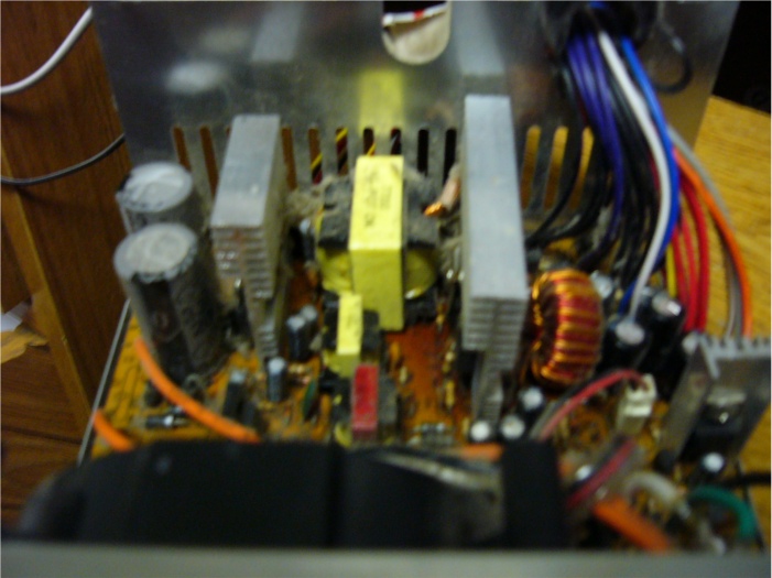

    ok, so camera flash gordon here horrifically misjudged time: i now have the pics
    WARNING- if you have a weak stomach, grab a barf bag NOW!

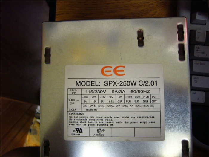

    first: the label:
    250w my ass. 25.0 on at most. you will see why... READ ON!

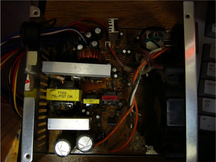

    next, an overview:
    pitiful in every way. not a single good brand cap, even some fakes! say hi to rulycon!

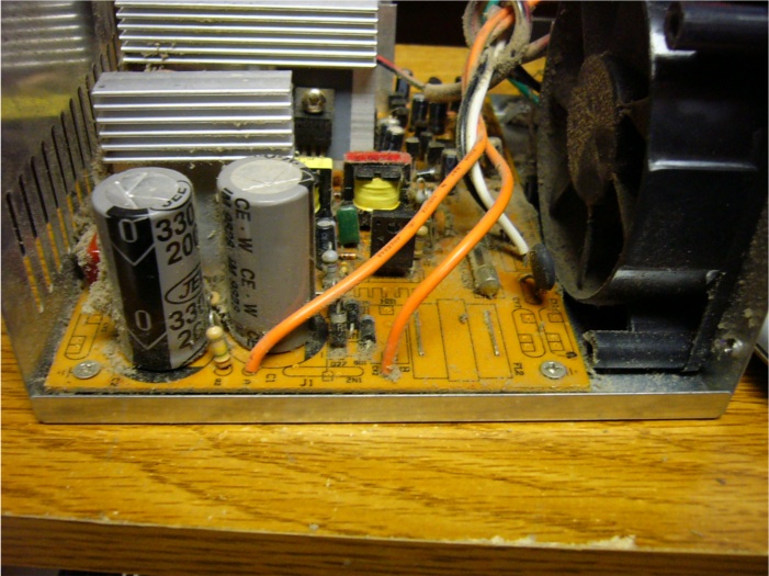

    the primary side (or lack thereof):
    nothing good here:
    • tiny jee primaries
    • 4 2A diodes
    • no choke
    • no x caps
    • no y caps
    • lots of jumper wire

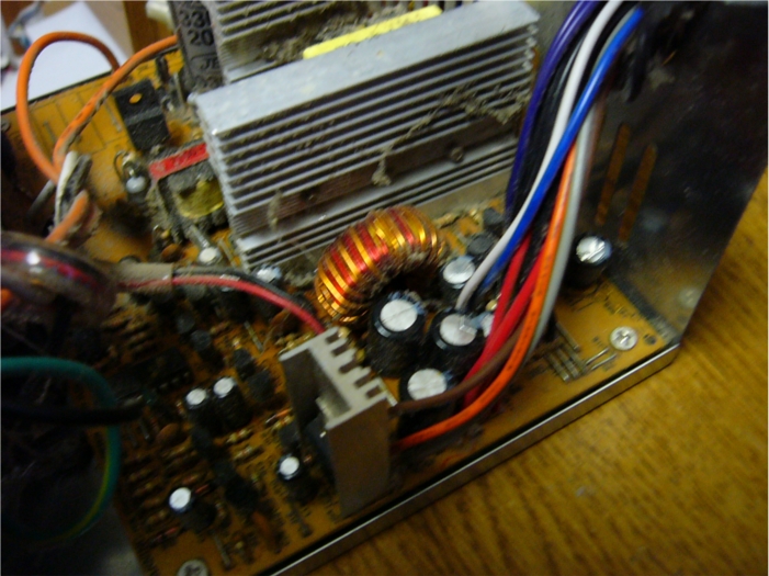

    next, the weak secondary side:
    lets see... i DID see 2 PI coils, but only one torroid... few caps, and they are sc if bigger, rulycon if smaller w/ "K" vent. most vented caps are bulged. thin wire too.
    next, the heatsinks:
    look how small they are! tiny silicon too, and look at those winpy transformers! 250w is soooo overrated for this box o' fun

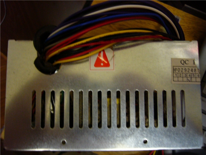

    last, the sheet metal:
    those are the only vents in this unit, other half was solid. they were clogged with dust when i pulled it form a bp6 box...
    and trust me, the metal is thin. really thin.
    who buys this crap? lesson: a cheap psu is usually going to cost you more in the end.

      There's another brand I know of called "TT" (NOT short for thermaltake). The heatsinks are fairly small, the fans sometimes only last a few months, I havent seen them with good caps, and the case is so thin that it gets bent when you plug in and unplug the power cord, although the ventilation is a bit better than yours

        Looks like a classic leadman.

          i think its a pre-hisoric powmax here's why:
          ee also makes cases. i have 2 right now, the one this one came out of was well built, i have a brand new ee that i flimsy with a new psu that i have yet to open... and the both have ee stamped in big letters in the bottom.
          BUT- i used to have a powmax case... the bio II to be exact. flimsy but looked sweet. and it had the same logo in the base.
          anyway, i have a fex old pics of it, and this is the only one with a hint of my find:
          i had thought it was CE as in the safety certification, not ee as in a brand. i was wrong... i rember it being stamped the exact same way os the oler ones i have.
          so, powmax=ee

            My guess would go with Leadman/Powmax/Sun Pro as well. The "7700"-marked transformer and those tiny heatsinks seem to be consistent in their low end power supplies. Looks somewhat identical to a "380" watt Sun Pro Raidmax of mine.
            Speaking of the crappy heatsinks, look at the heat damage on the PCB in the second to last pic !
            And, yes, it is possible that this is a really old Leadman unit, judging by the cut-out for an old style AT turn-on switch. I've noticed that old Deer PSUs have this as well. They probably just used the same case production line for both AT and ATX PSUs. Apparently a cost-cutting technique saving valuable beans.
