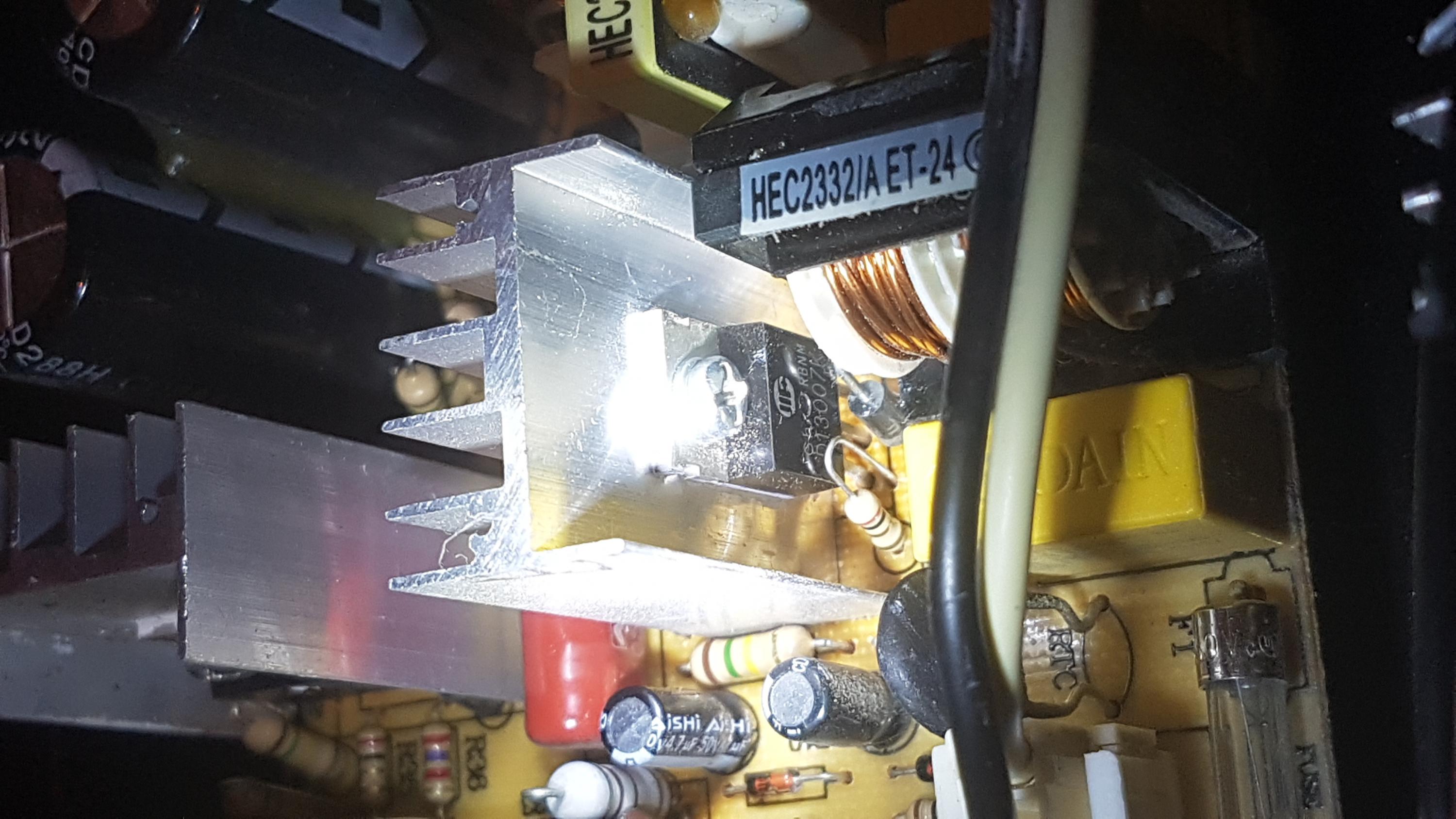

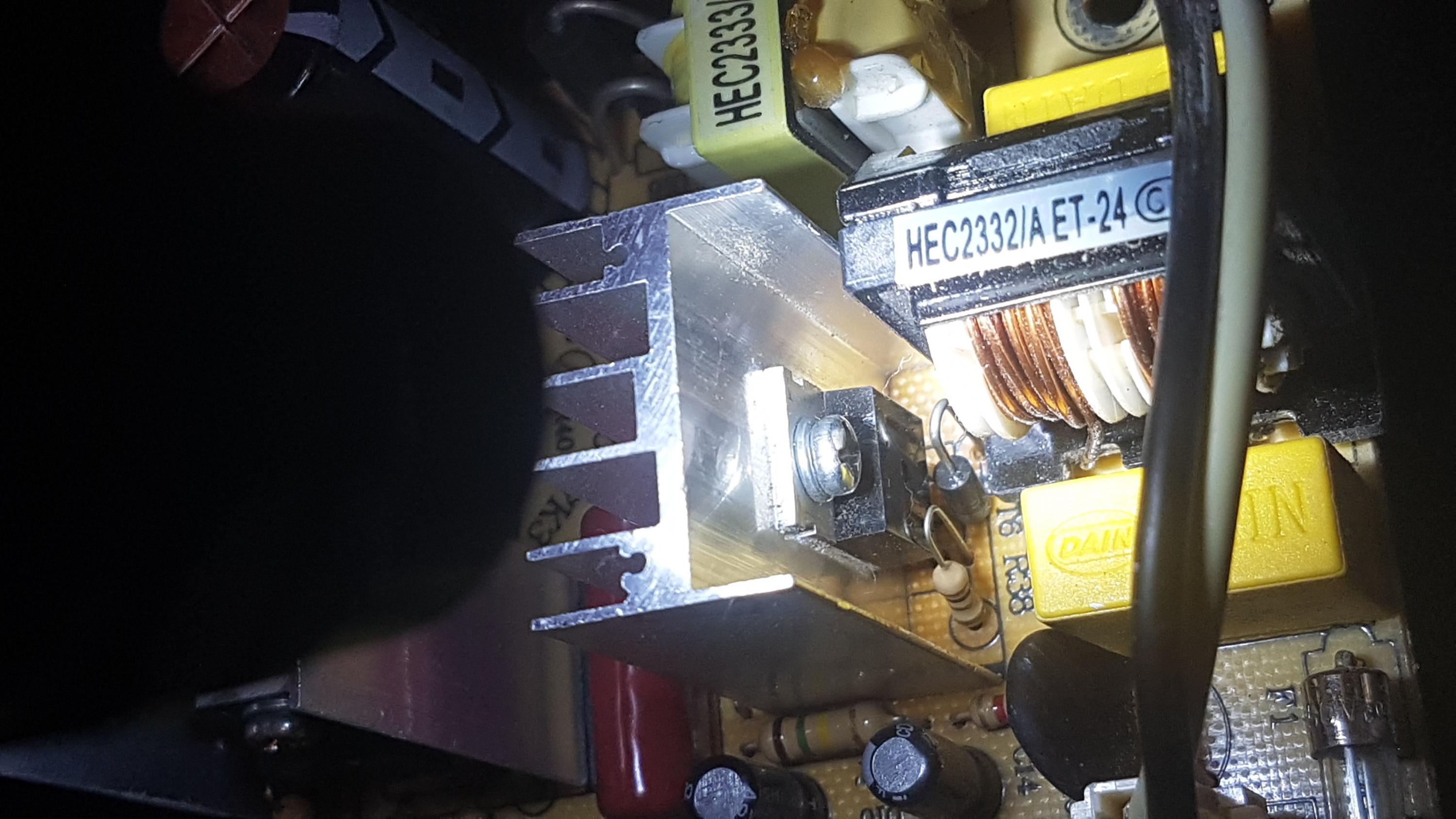

    If these are T6, T7 they have D13007K on them.
    Is D15 a diode you're speaking of?

      There's many different ways to troubleshoot something. You can take measurements with power on, you can remove parts and test them.
      You can guess the bad parts and change them. Some people start at the beginning or middle and work through a circuit.
      To test the two power transistors, there are a zillion websites and youtube videos on how to do that. I would put the multimeter on diode-test and see what you get with them in-circuit (power is off!). You could compare readings between the two of them. The D13007K transistor does not have an internal C-E diode (there is one in the circuit).

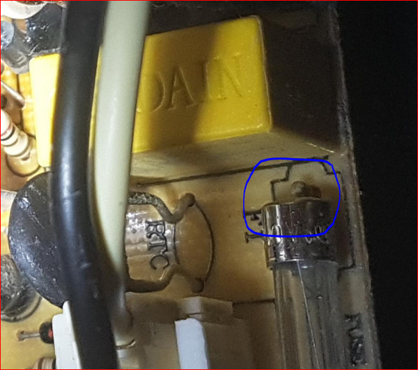

      Is this connection to the fuse OK? It didn't look right.
          What do you think it should read? I believe it read 0.04 ohms when I tested it.

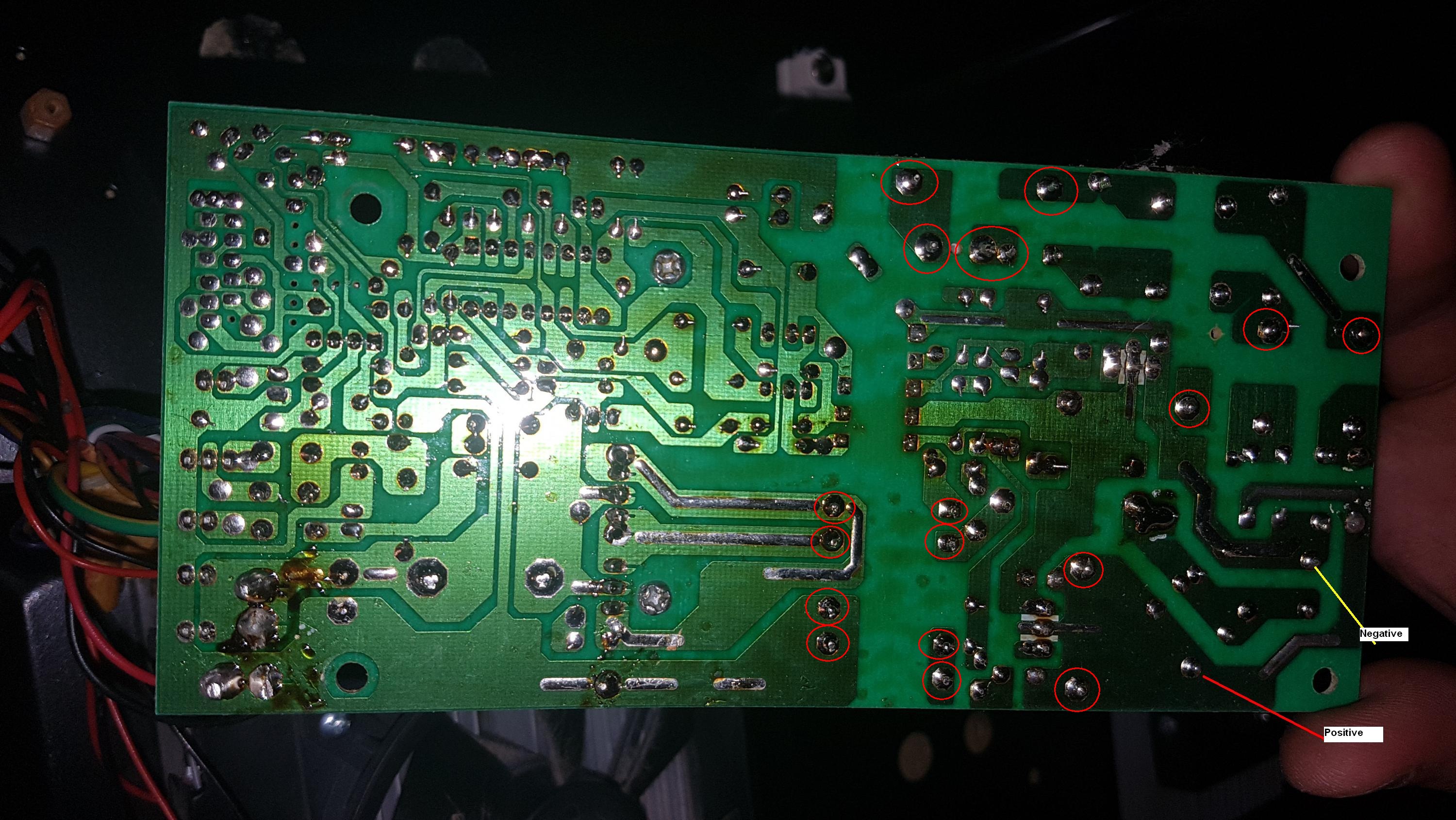

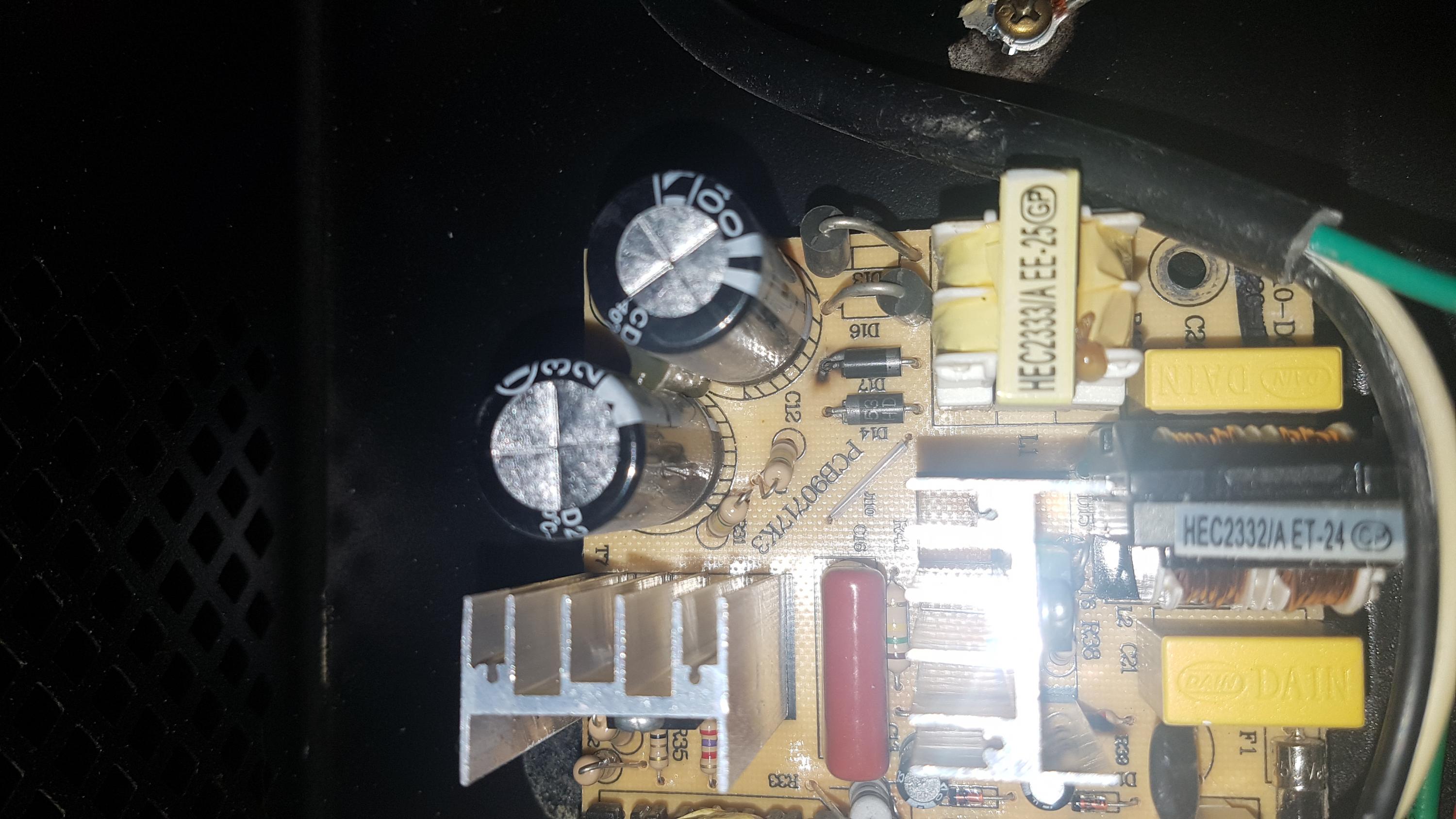

            Please check the attached photos, I have marked the same point but on the top of the board, so you can check if you have 160VDC with the board mounted.
            I have also marked several solder joints that look bad, please check them.
            Redwire asked you to check the fuse again: it looks in the photos like one of the sides is physically broken? Just check that it is really physically connected well to the board.
                  So, picture 2 is the same as pic 1 just front/back . I should check voltage? I understand its dangerous. How can I be safe? Gloves?

                    In the quoted post R_J asked you to check the rectified AC voltage.
                    Without that check it is hard to get further: but this is a dangerous check done with power connected as he mentions.

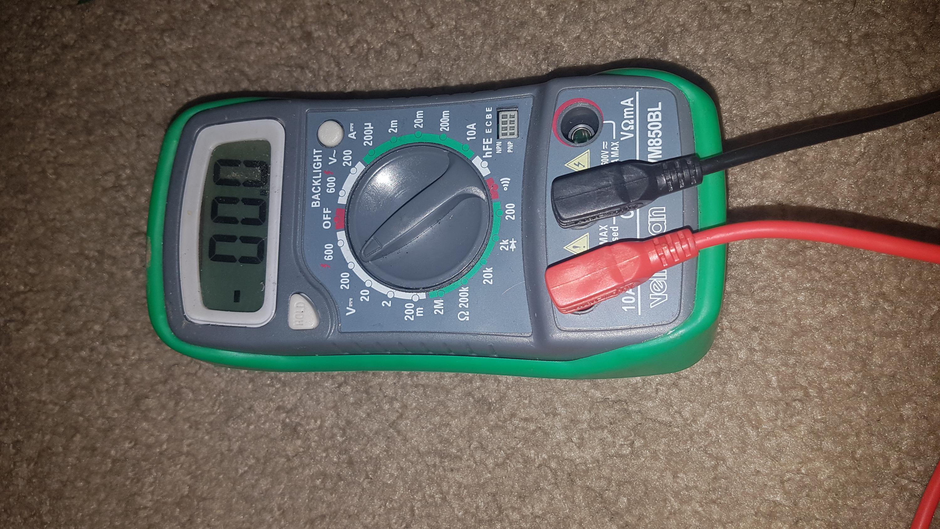

                    I checked the rectifier ac voltage and it sparked twice... should my multimeter be the other way? Spot looks burnt now
                    I tried multimeter with red in the other slot and it didnt spark, no reading or rather went from ~50 to 0 quickly.
                    Fuse looks good

                      your meter is set up wrong .no wonder there was sparking .put red into volt ohms .black to common .
                      p.s fuse in the meter might be blown now plus maybe more damage to it .

                        I checked before spark with correct meter setup with no reading

                          test your meter with known good voltage source such as a cell battery .

                            Still works.. reading a 3v cell @ 3.12 volts

                              meter is set for dc volts .you said you were measuring ac volts . you really want to be measuring the dc volts at the large capacitor . or dc out on rectifier which is same thing .

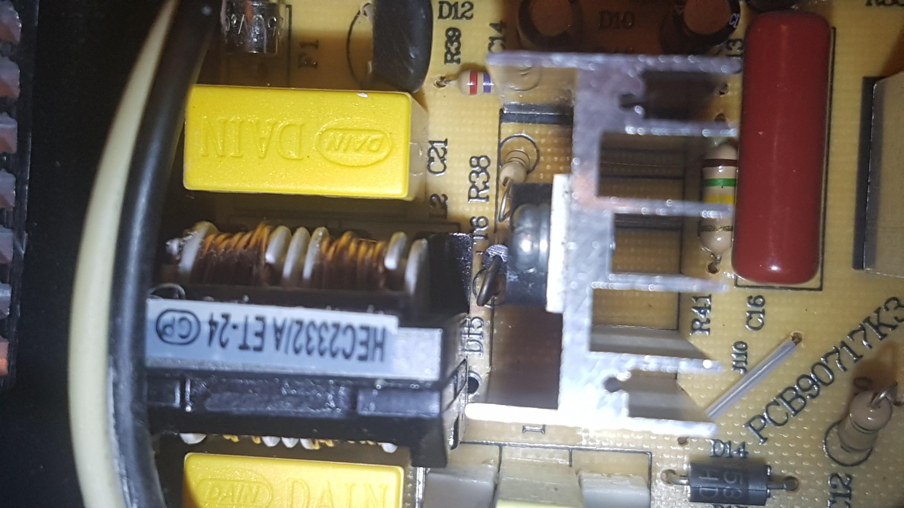

                                        As for redwires comment, he is talking about the power transistor there with the heat sink on it. A diode is like a 1 way check valve for electricity. It let's power flow in one direction. He is saying that some Transistors have a diode in them (this is called a body diode). This is to protect the transistor from things like switching of transformers.
                                        On a transistor, you have 3 pins. Collector, Base, and Emitter. He is saying that there might be a one way check valve from the Collector Pin to Emitter. This doesn't normally conduct from Collector to Emitter, but instead conducts from emitter to collector. (Reverse polarity) He mentioned this because testing transistors means checking to see if power flows from one pin to another using your multimeter. You can run into issues if you don't know what to look for/might diagnose the problem wrong.
                                        I think Redwire is pointing to something being wrong with the "Snubber network". When power going to a big inductor like a Transformer is suddenly cut off, the voltage jumps through the roof(as in, hundreds of volts). A snubber network absorbs this spike to protect the Transistor. (The body diode is also useful in this.) If there is something wrong with your snubber network (burnt up looking) then it means that it might not be doing it's job. That could have killed the Transistor.
