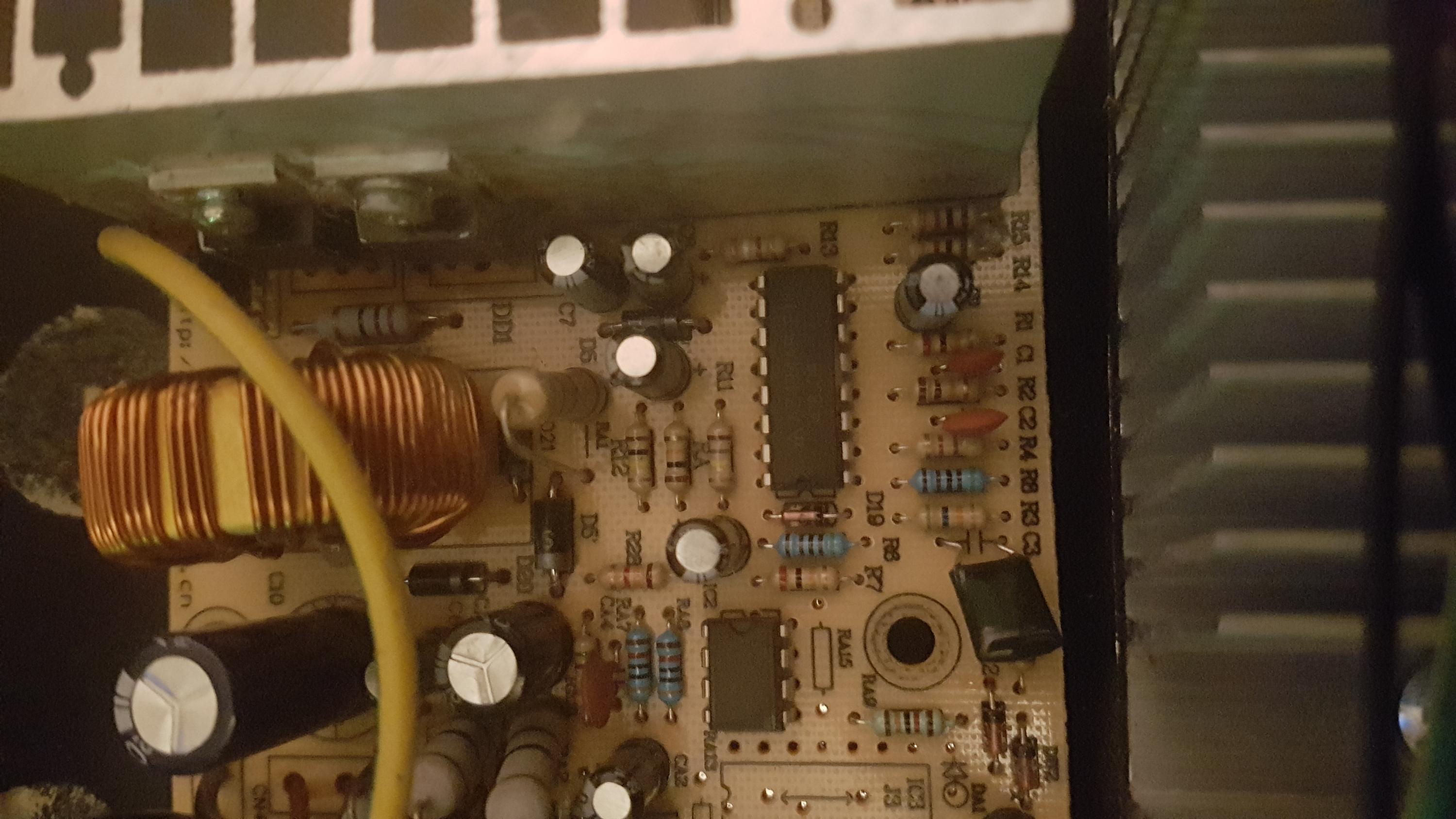

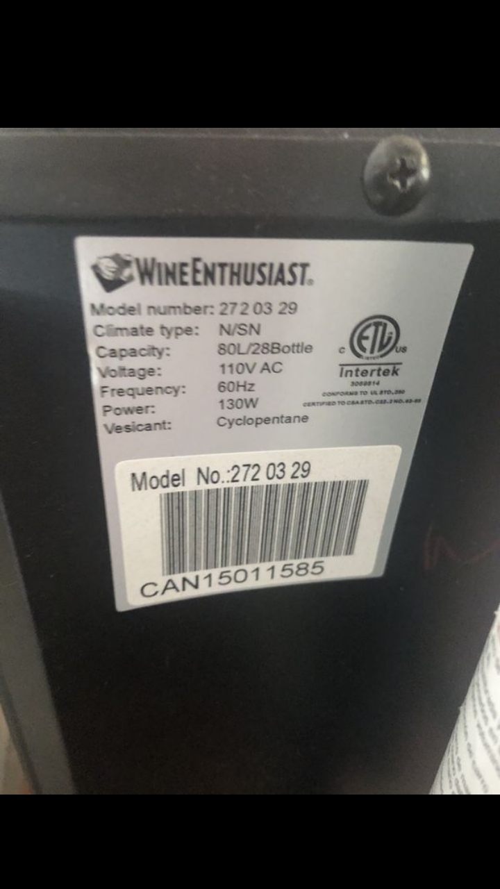

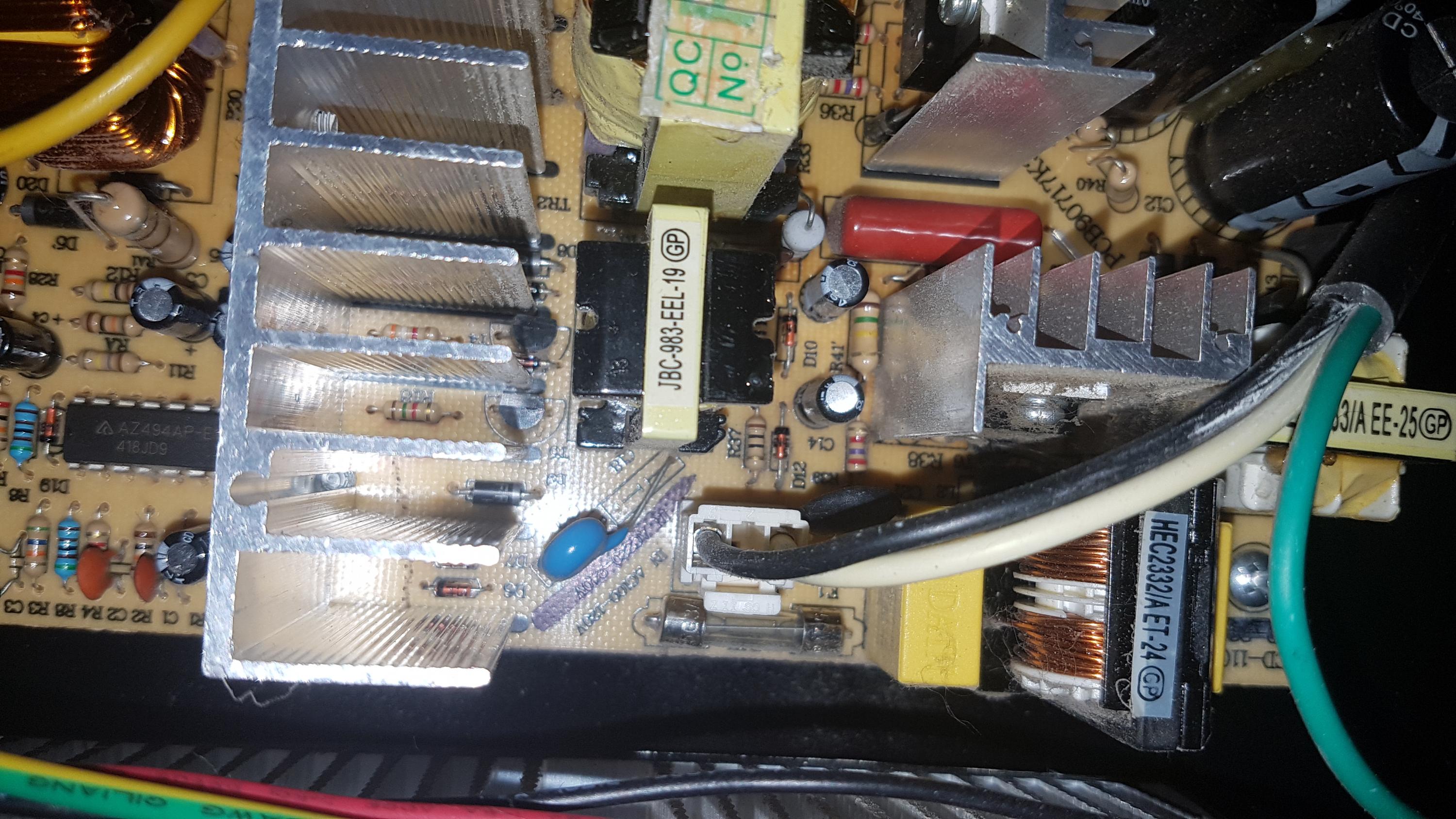

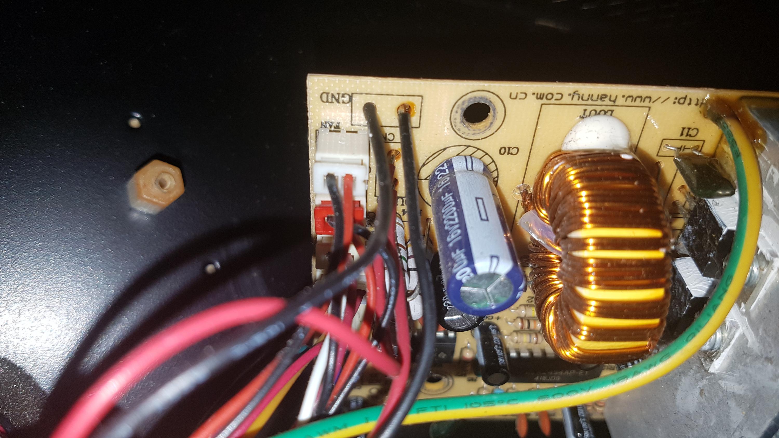

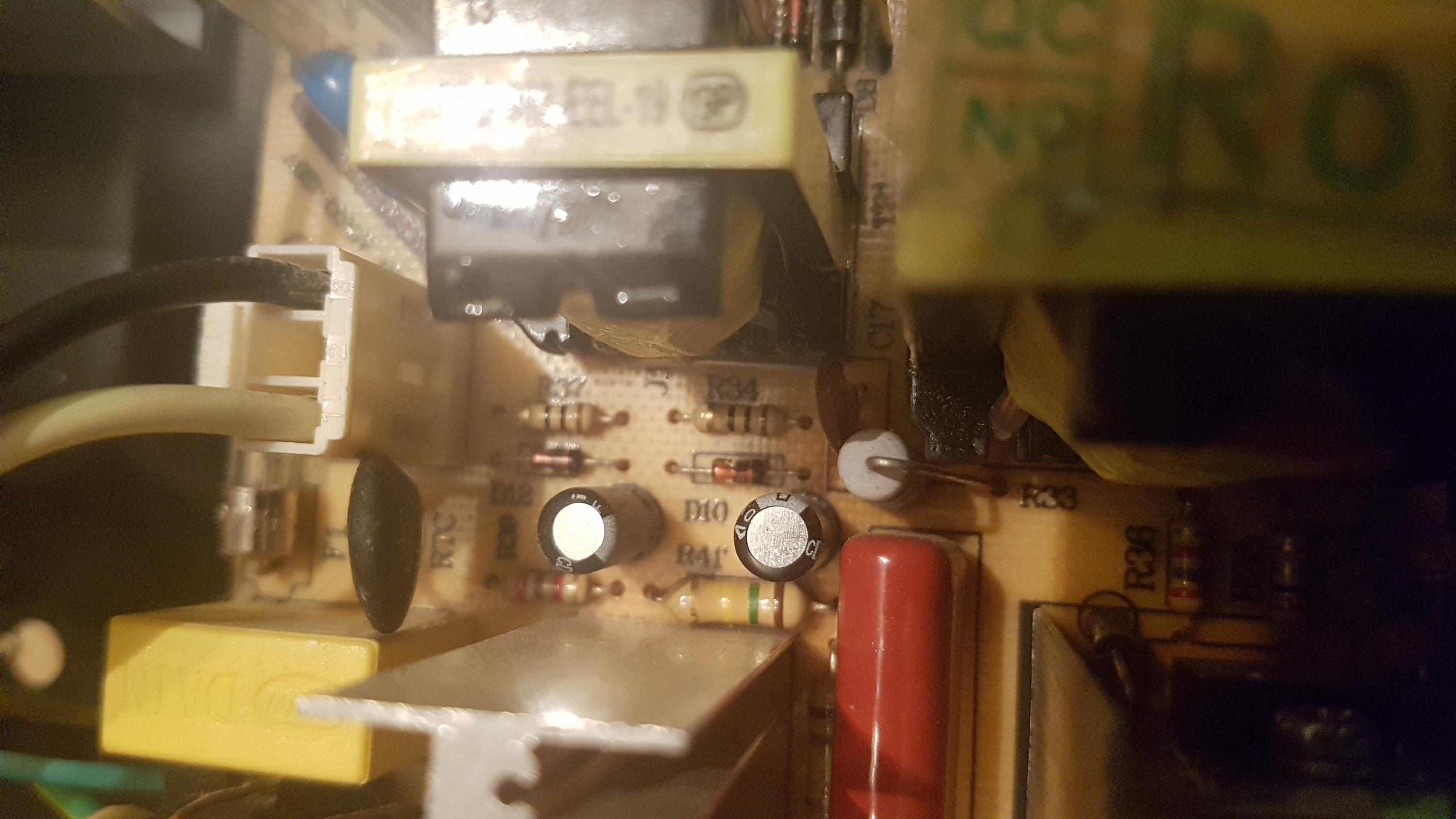

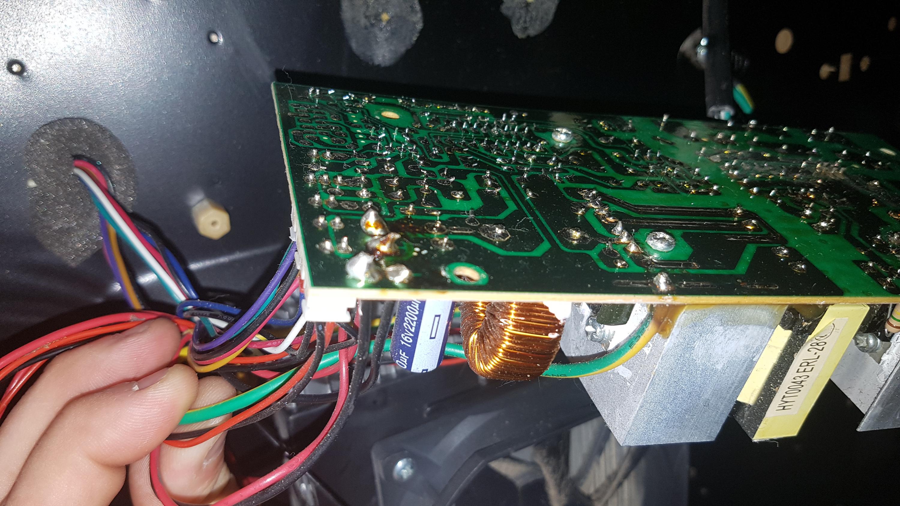

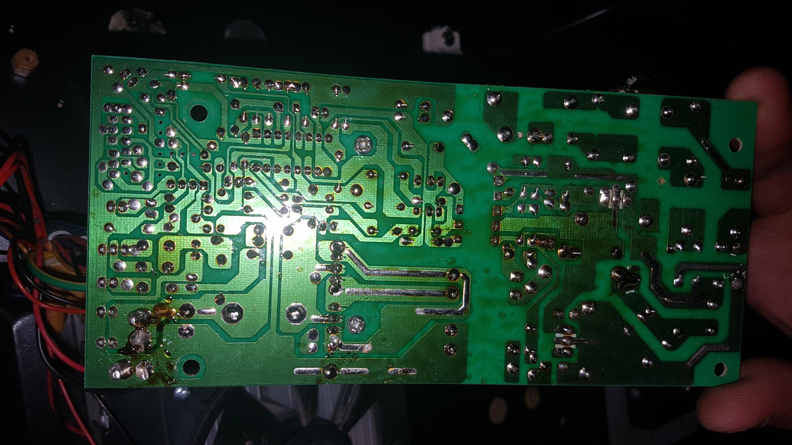

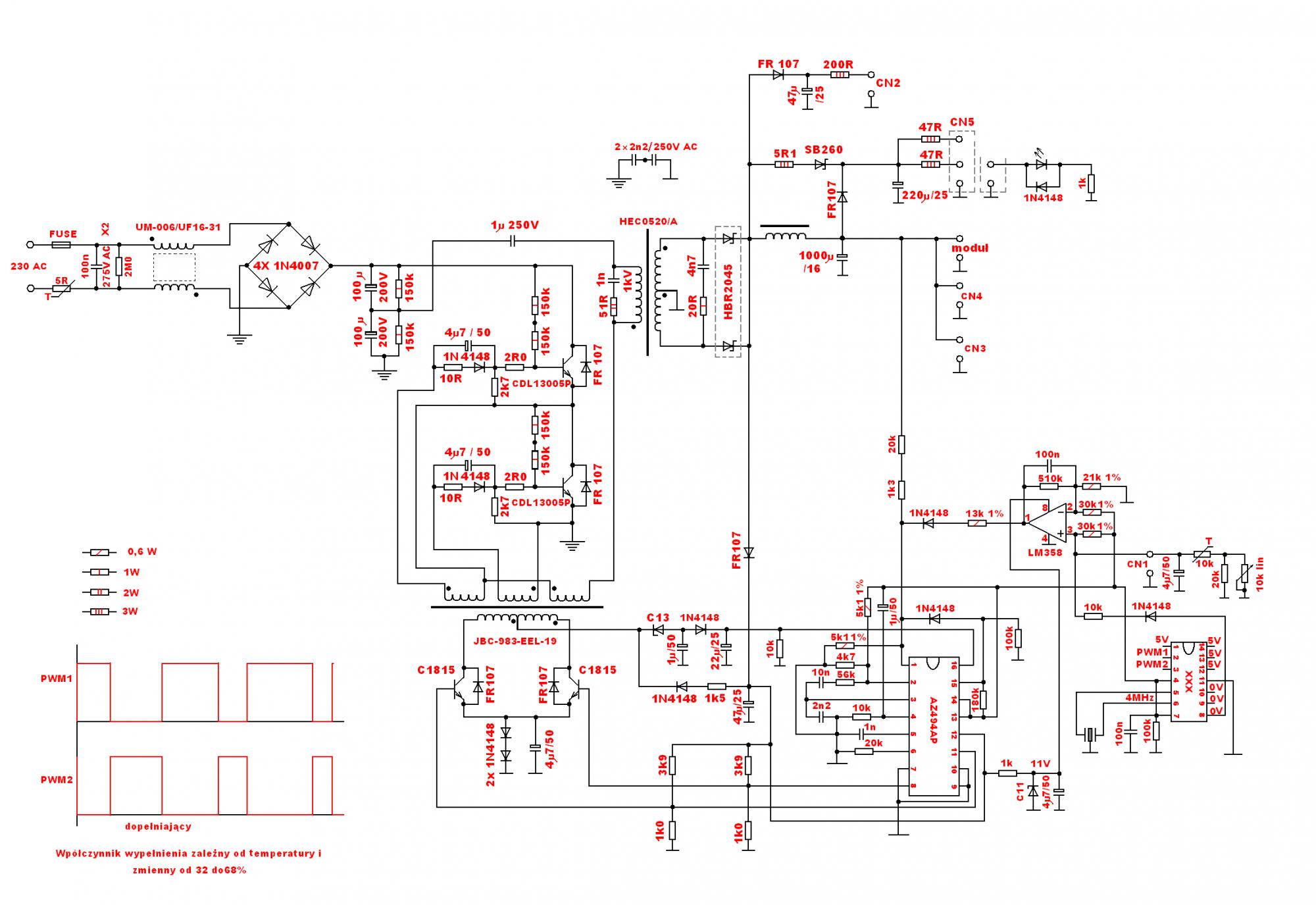

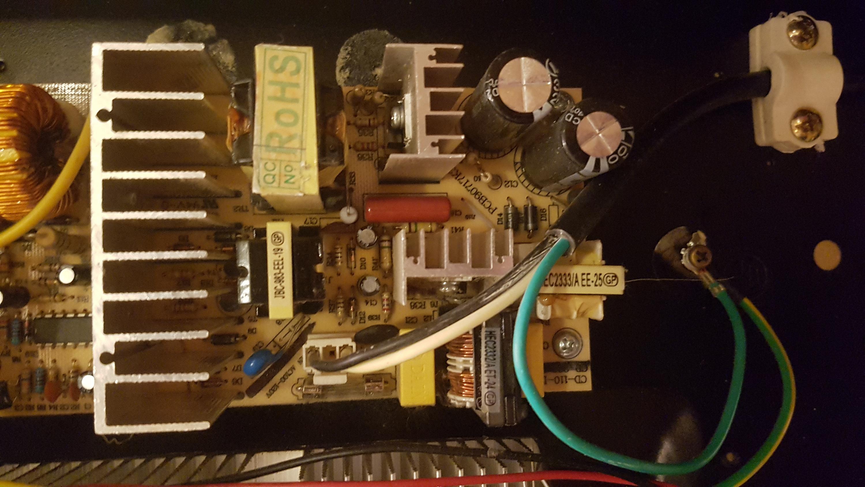

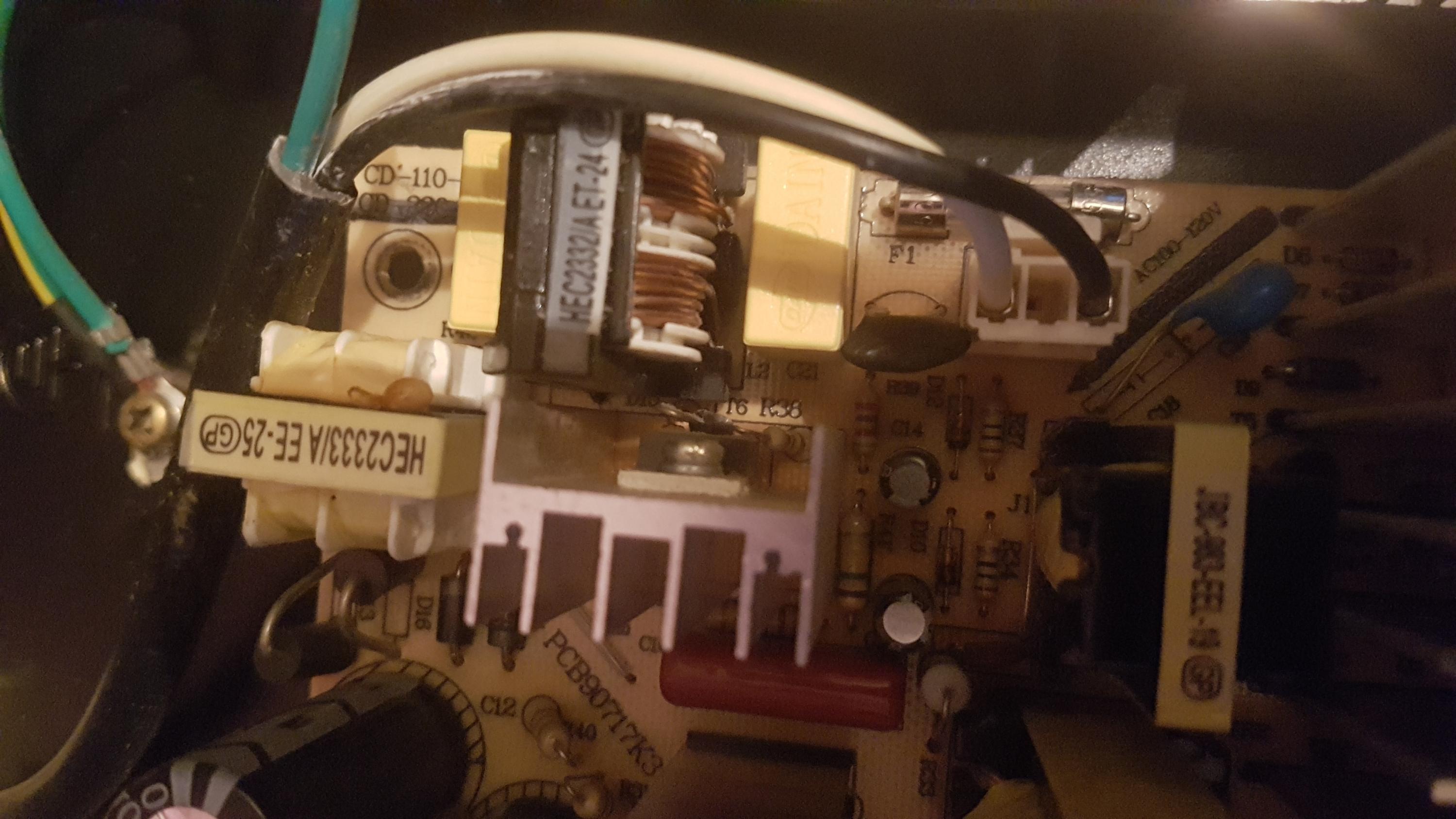

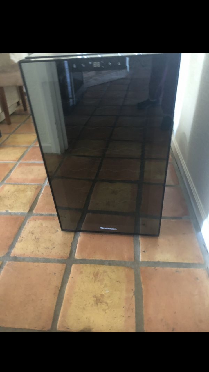

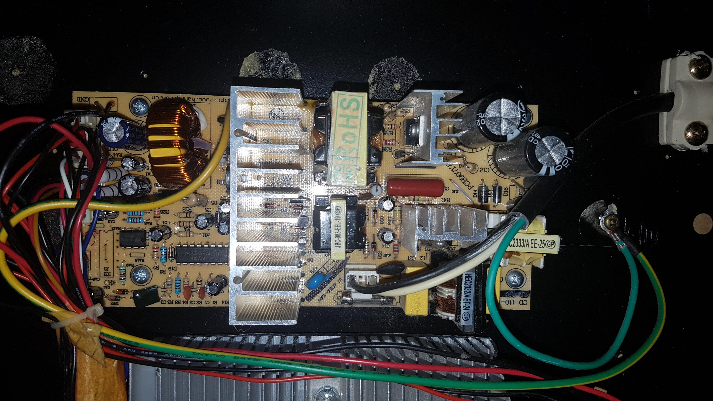

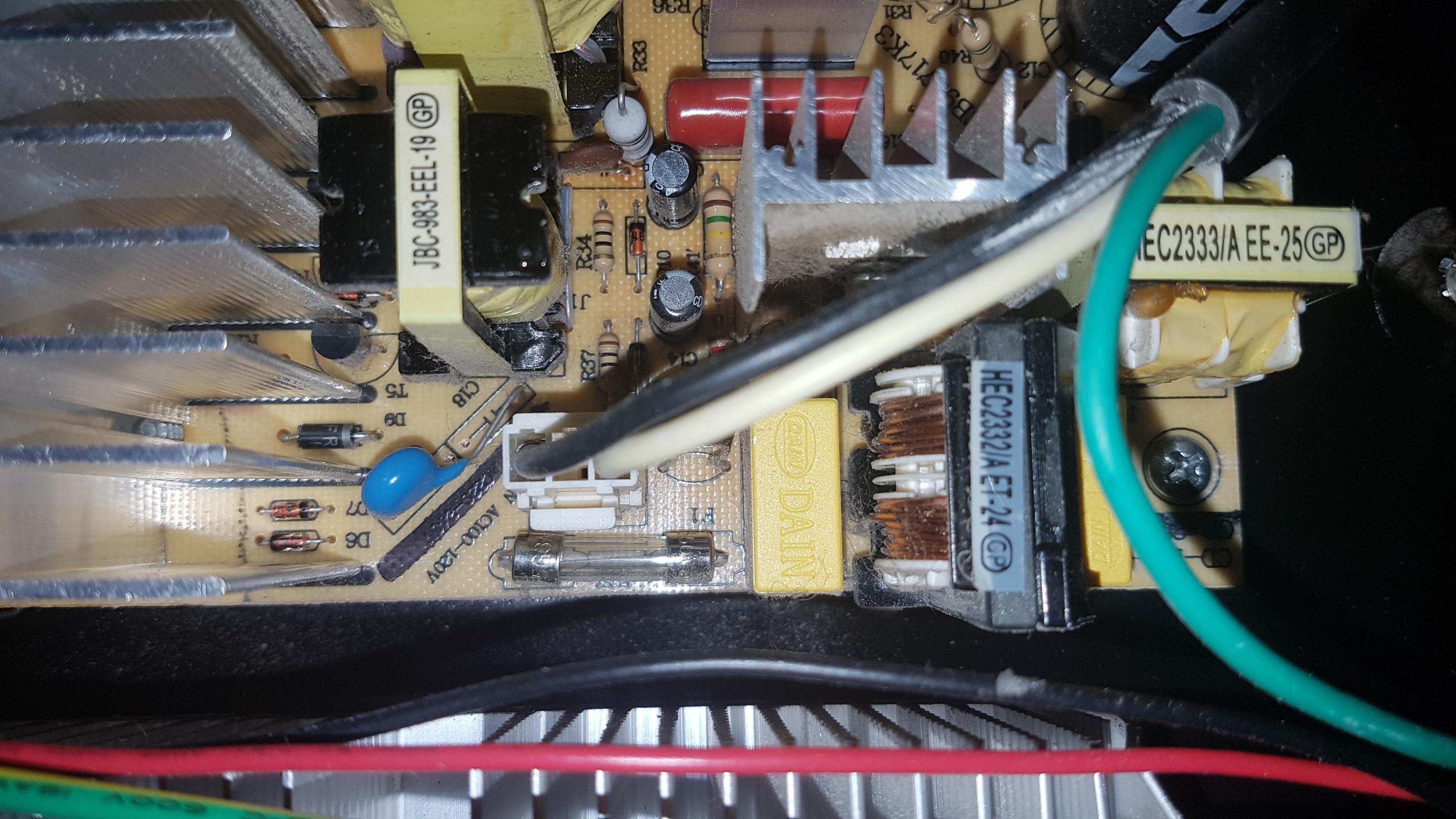

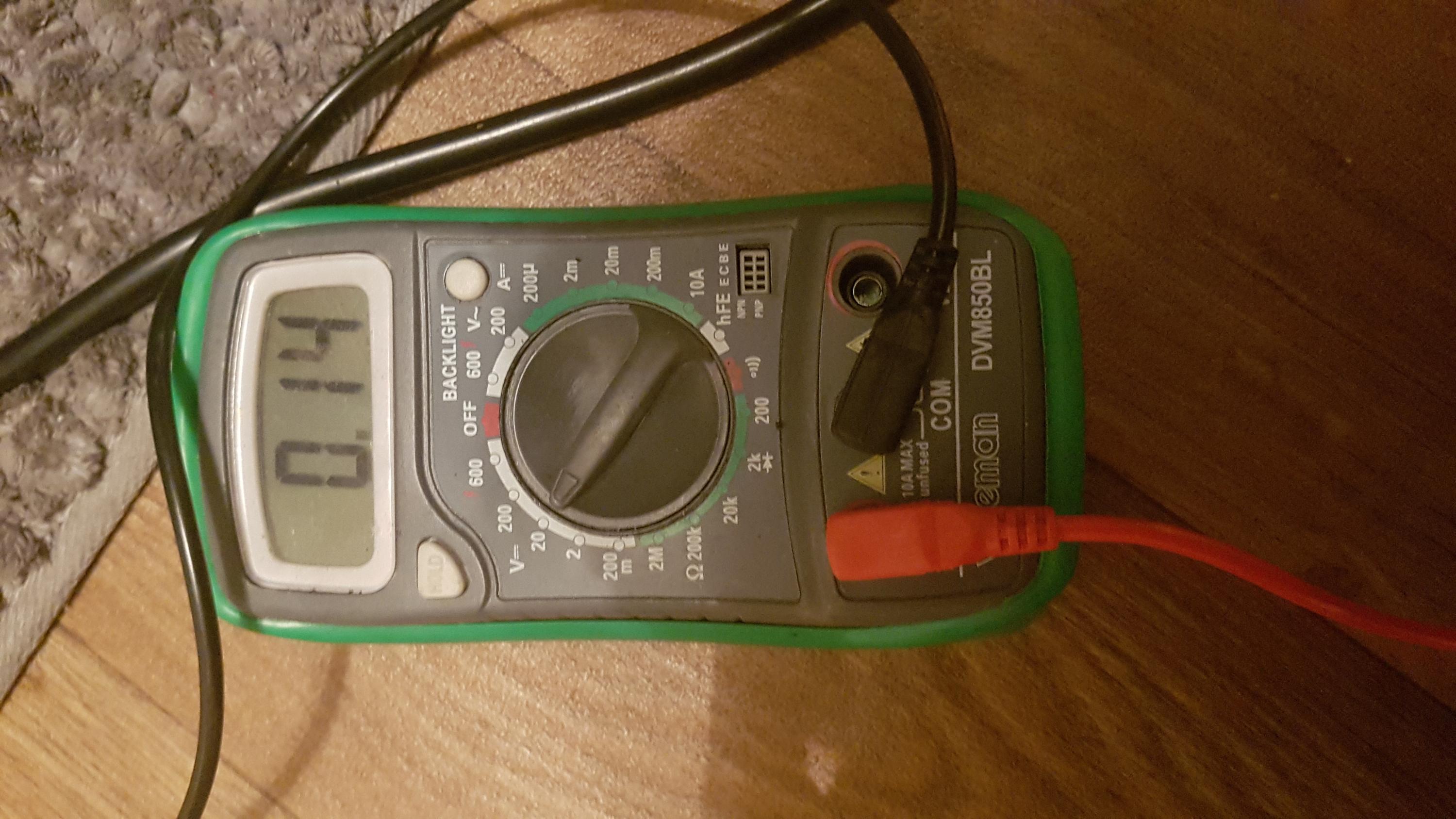

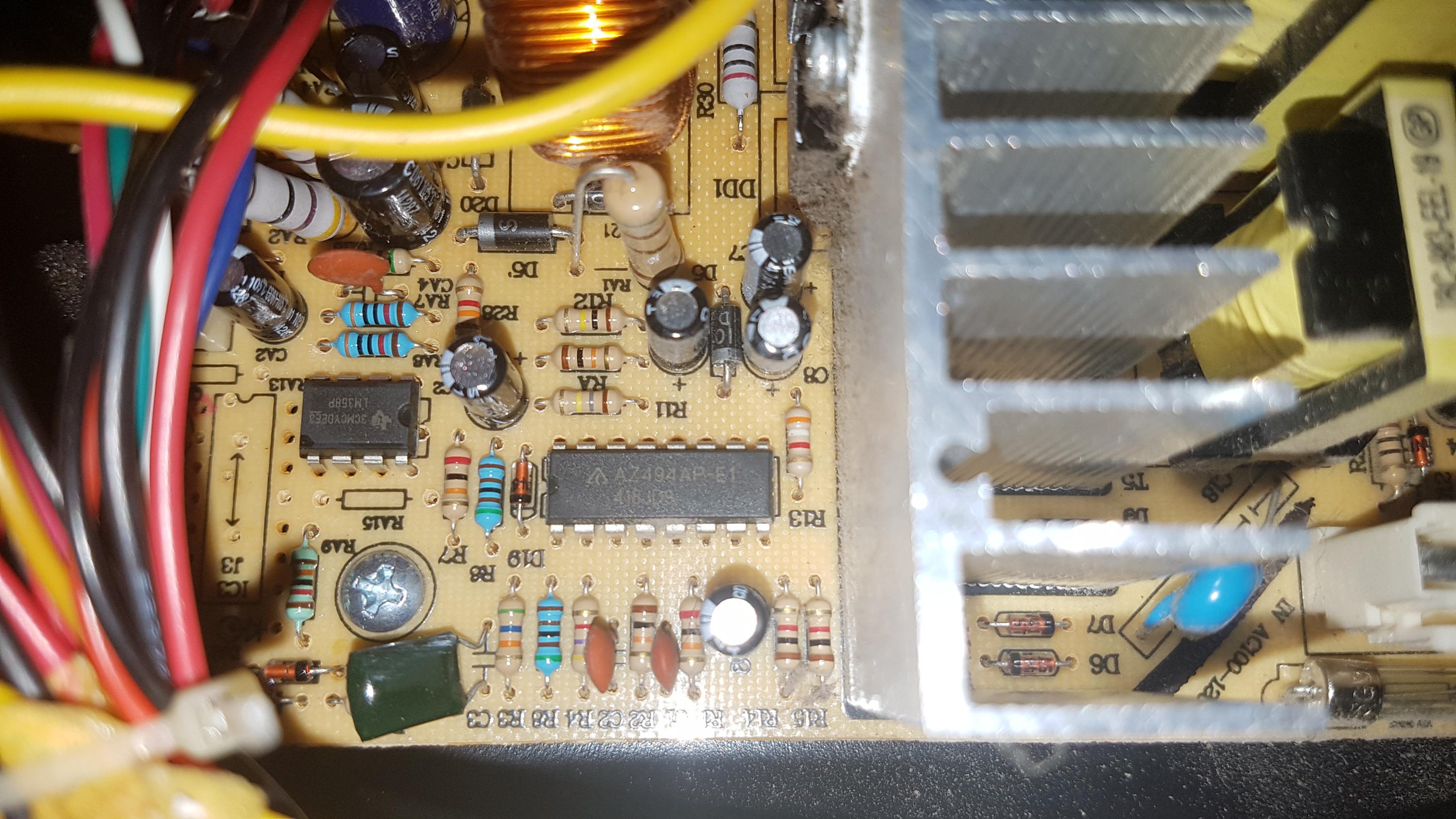

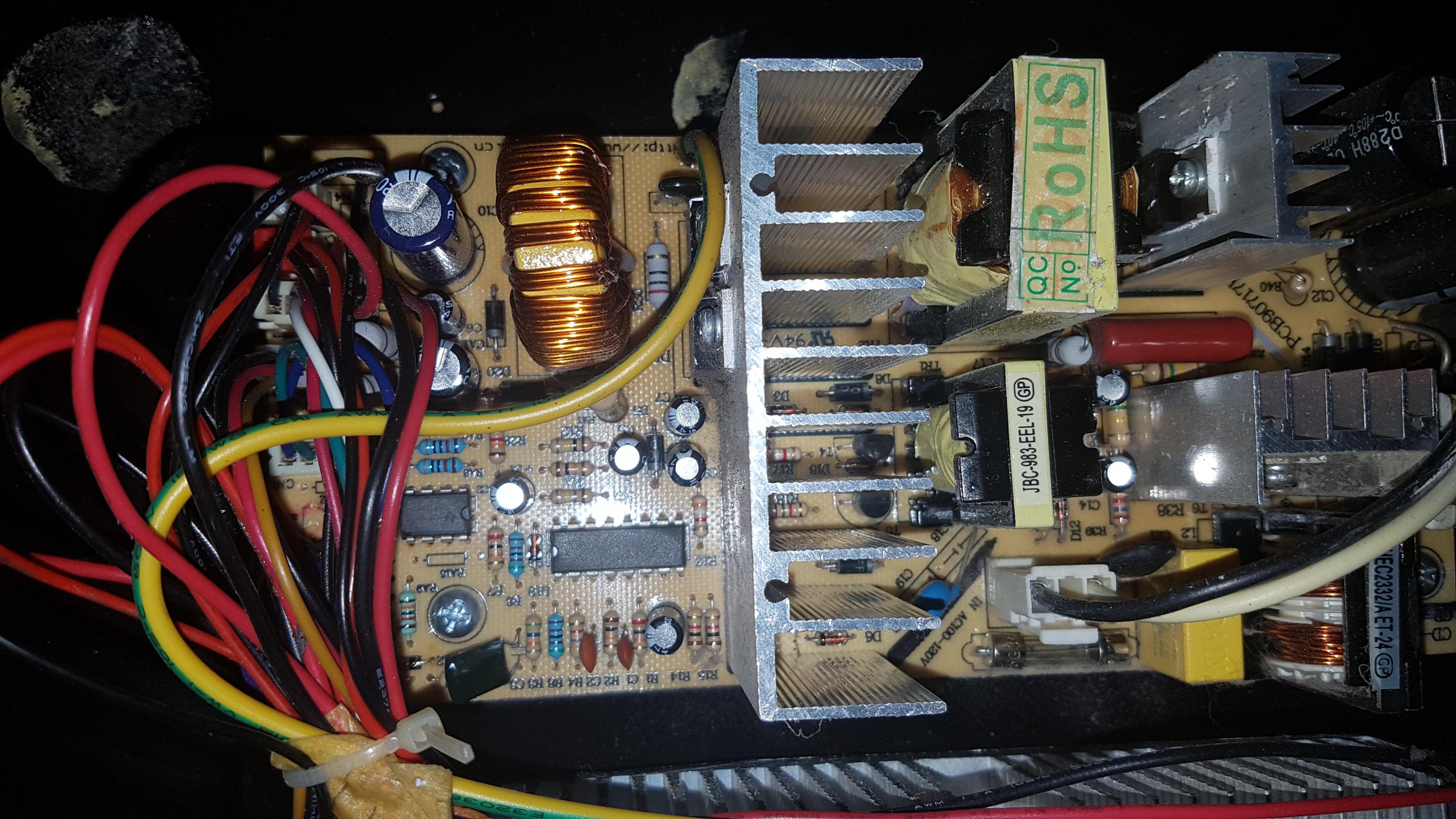

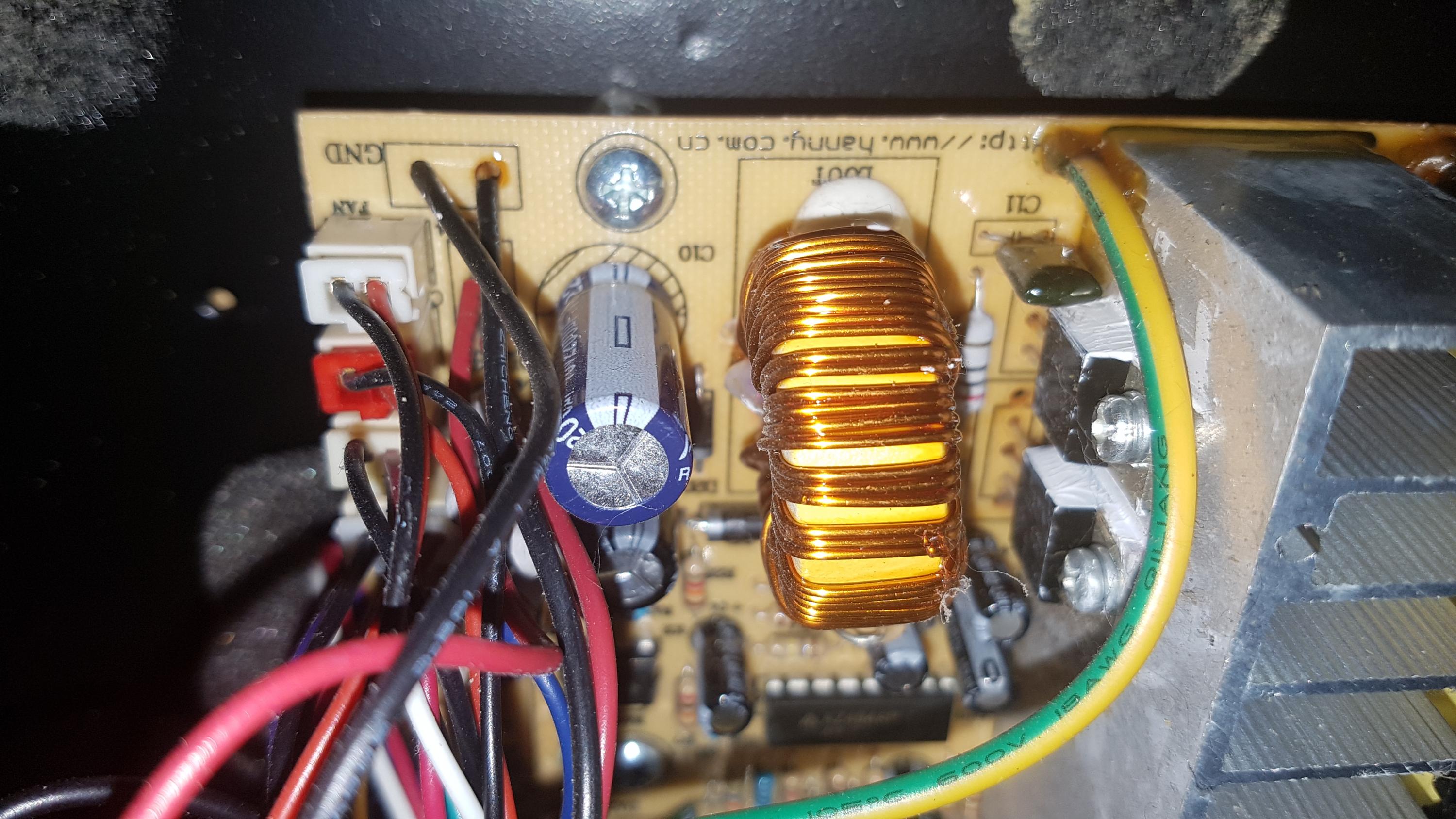

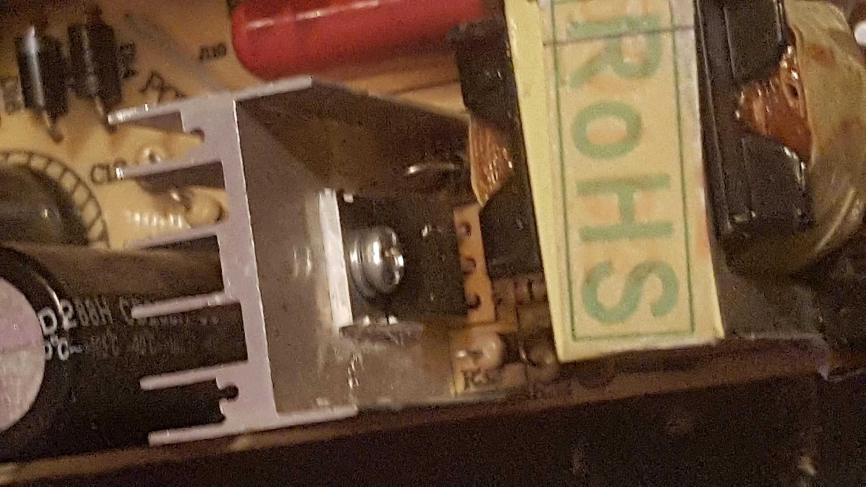

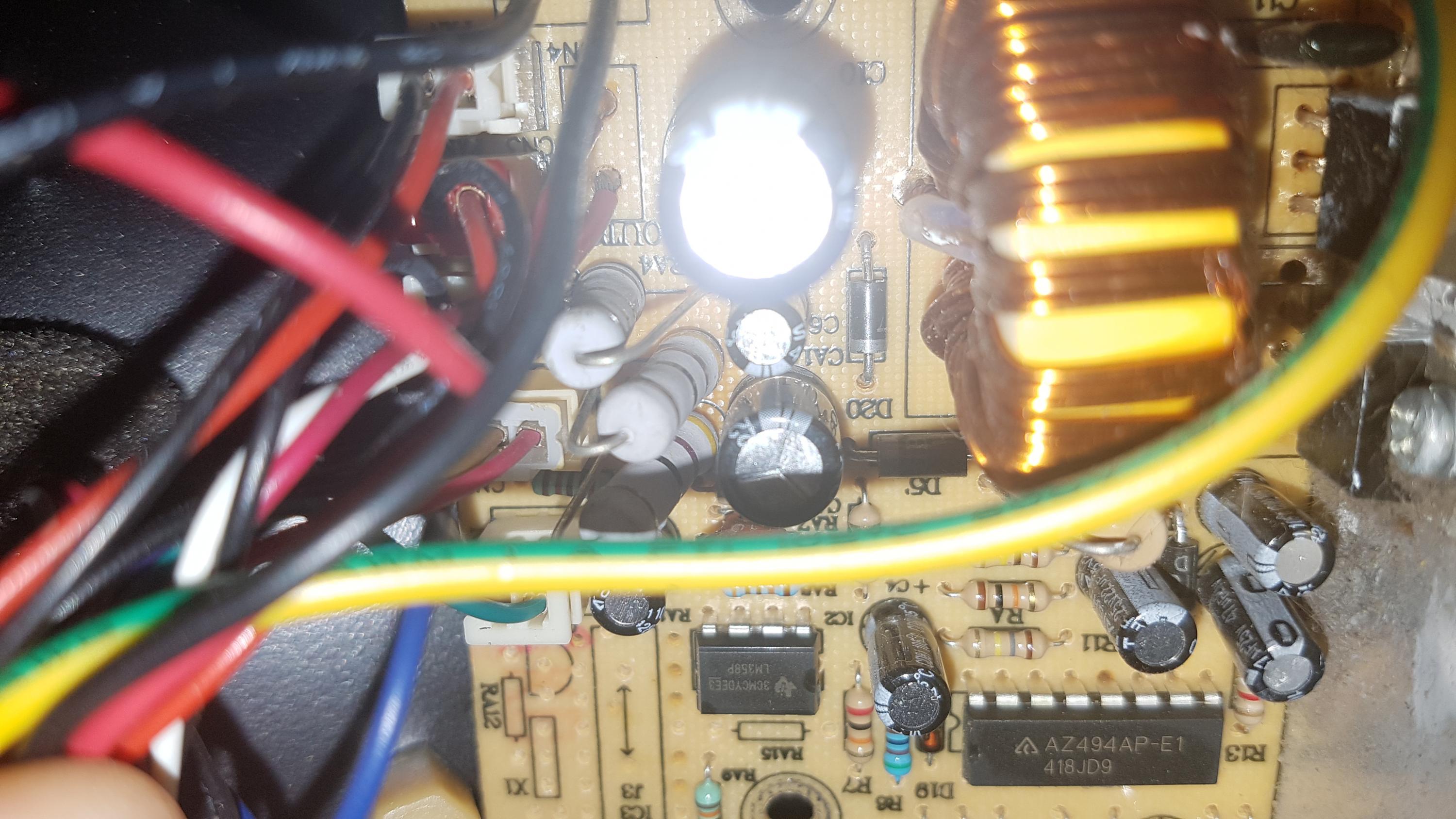

Wine Enthusiast wine cooler, no power. Model # 272 03 29
  • ajsterr4
    • Jun 2016
    • 115
    Wine Enthusiast wine cooler, no power. Model # 272 03 29
    I'm gonna take this thing apart very soon, gonna give it a a look over. Check for burn marks and bulged caps.
    I read to check for continuity throughout, I have a multimeter, what process should I follow? How can I check for bad fuses as well?
    Any info helps, I got this unit for free. Thanks to everyone here.
  • CapLeaker
    Leaking Member
    • Dec 2014
    • 8276
    Re: Wine Enthusiast wine cooler, no power. Model # 272 03 29
    Do a visual check on everything, take pictures and go from there.
    • ajsterr4
      • Jun 2016
      • 115
      Re: Wine Enthusiast wine cooler, no power. Model # 272 03 29
      Do a visual check on everything, take pictures and go from there.
      Look at these pictures please.
      Last edited by ajsterr4; 11-30-2019, 08:34 PM.
      • R_J
        • Jun 2012
        • 9576
        Re: Wine Enthusiast wine cooler, no power. Model # 272 03 29
        In picture 1 or 3, upper left corner, check if you have around +12 volts between ground and OUT (red wire). You did check the fuse, correct?
        Last edited by R_J; 11-30-2019, 08:37 PM.
        • ajsterr4
          • Jun 2016
          • 115
          Re: Wine Enthusiast wine cooler, no power. Model # 272 03 29
          Originally posted by R_J
          In picture 1 or 3, upper left corner, check if you have around +12 volts between ground and OUT (red wire). You did check the fuse, correct?
          Plugged in?
          I'm not getting 12 V, I'm trying the rear solder connections is that ok?
          Last edited by ajsterr4; 11-30-2019, 08:51 PM.
          • ajsterr4
            • Jun 2016
            • 115
            Re: Wine Enthusiast wine cooler, no power. Model # 272 03 29
            Originally posted by R_J
            You did check the fuse, correct?
            No how do I do that?
            I think that's good my multimeter beeps and shows. 0.04 ohms
            It wont allow me to take the fuse out so I tested it on the board
            Last edited by ajsterr4; 11-30-2019, 08:52 PM.
            • R_J
              • Jun 2012
              • 9576
              Re: Wine Enthusiast wine cooler, no power. Model # 272 03 29
              The fuse seems to check good.
              Check if you have DC voltage on the input capacitors It will be around 160VDC. Be very carefull, this is the a/c line side of the power supply
              • CapLeaker
                Leaking Member
                • Dec 2014
                • 8276
                Re: Wine Enthusiast wine cooler, no power. Model # 272 03 29
                the fuse is soldered in, you can't take it just out. If the fuse measures a short, which it does, it's good. We have to figure out where the problem is, is it on the secondary (low voltage) side, or is there a problem on the primary (mains circuit). If you do poke around the primary side of the PSU while plugged in, be careful. After all this is 120VAC, after the rectifier into the main filter capacitor are 170VDC. If you measure DC voltages on the primary side, the negative lead of your DMM goes to the negative of the main filter capacitor. Working with DC voltages on the secondary, the negative lead of the DMM goes to the negative of the output capacitor or GND.
                • redwire
                  • Dec 2010
                  • 3912
                  Re: Wine Enthusiast wine cooler, no power. Model # 272 03 29
                  For the technical guys, there are hand drawn bits and pieces of the board's schematic on the Web. I did find this "roughly similar" schematic, at least to help understand the basics.
                  It looks like a half-bridge SMPS that is self-resonant (for start-up) and then the TL494 takes over and running off the Peltier module power afterwards.
                  Common for the small capacitors by the heatsink to fail, like C8 on power for the TL494 47uF 25V to VCC pin 12.
                  Wine Fridge Power Board similar longggg thread here: https://www.badcaps.net/forum/showthread.php?t=42346
                  edit: Power Supply board CD-110-C also used in Haier wine coolers.
                  Last edited by redwire; 11-30-2019, 10:19 PM.
                  • ajsterr4
                    • Jun 2016
                    • 115
                    Re: Wine Enthusiast wine cooler, no power. Model # 272 03 29
                    What's the best way I can carry out these tasks safely? I have an esd wrist strap and esd gloves. It would be nice if I could test it on a table, but I guess I have to have it all plugged in to test?
                    You can probably tell I am a not up to speed on diagnosing electronics, the challenge is nice but I also want to learn.
                    What is the TL494, is that a CAP or PWM - is that the same thing as a transformer?
                    On the primary side you say be careful, so I will try to not touch anything, only with probes, yes?
                    Edit: C8 is a cap should I refer to c8 on that schematic or the c8 on my board? It says CD-110-D6
                    CD-220-D6
                    Last edited by ajsterr4; 11-30-2019, 11:40 PM.
                      • 31122
                      Re: Wine Enthusiast wine cooler, no power. Model # 272 03 29
                      there is a ceramic capacitor almost between the 2 transformers - c17
                      it looks very dark!
                        • 31122
                        Re: Wine Enthusiast wine cooler, no power. Model # 272 03 29
                        Originally posted by ajsterr4
                        What is the TL494, is that a CAP or PWM - is that the same thing as a transformer?
                        TL494 is the larger of the 2 chips on the left
                        • ajsterr4
                          • Jun 2016
                          • 115
                          Re: Wine Enthusiast wine cooler, no power. Model # 272 03 29
                          What's the best way I can carry out these tasks safely? I have an esd wrist strap and esd gloves. It would be nice if I could test it on a table, but I guess I have to have it all plugged in to test?
                          You can probably tell I am a not up to speed on diagnosing electronics, the challenge is nice but I also want to learn.
                          What is the TL494, is that a CAP or PWM - is that the same thing as a transformer?
                          On the primary side you say be careful, so I will try to not touch anything, only with probes, yes?
                          I'm going to have to do alot of reading, will I need an ESR meter?
                          • ajsterr4
                            • Jun 2016
                            • 115
                            Re: Wine Enthusiast wine cooler, no power. Model # 272 03 29
                            Originally posted by stj
                            there is a ceramic capacitor almost between the 2 transformers - c17
                            it looks very dark!
                            So test this one? How should I, what reading am I looking for?
                            • ajsterr4
                              • Jun 2016
                              • 115
                              Re: Wine Enthusiast wine cooler, no power. Model # 272 03 29
                              Originally posted by stj
                              TL494 is the larger of the 2 chips on the left
                              This long chip? I see C8, should I test TL494 or the SMPS?
                              Do I refer to the schematic for TL494 to test?
                              Will my multimeter cut the mustard? No ESR meter
                              • ajsterr4
                                • Jun 2016
                                • 115
                                Re: Wine Enthusiast wine cooler, no power. Model # 272 03 29
                                . If you measure DC voltages on the primary side, the negative lead of your DMM goes to the negative of the main filter capacitor. Working with DC voltages on the secondary, the negative lead of the DMM goes to the negative of the output capacitor or GND.
                                What is difference between main filter capacitors and the output capacitor on secondary?
                                Do I need an ESR meter?
                                • redwire
                                  • Dec 2010
                                  • 3912
                                  Re: Wine Enthusiast wine cooler, no power. Model # 272 03 29
                                  There is an electrocution hazard when taking measurements off a live board that is flopping around.
                                  Check if you are OK with your experience level and the dangers of working on mains-powered equipment. A slip with a multimeter probe can be bad if something shorts or your hand is touching the fridge.
                                  Capacitor C17 and resistor R33 are the snubber network, they do make a lot of heat and see high stress, and the chinese always use cheap parts there. C17 looks like a dog. Maybe 1000pF 1kV. R33 is half cooked. Need a side pic.
                                  But their failure would just stress the main power transistors...
                                  With the power off, I would use a multimeter and test the power transistors T6, T7? the ones on the two small heatsinks possibly part number CDL13005.[/s]
                                  edit: OP shows they are D13007K.
                                  Note some transistor makes have an internal diode across C-E.
                                  edit: No internal C-E diode in D13007K.
                                  Last edited by redwire; 12-01-2019, 01:40 AM.
                                  • ajsterr4
                                    • Jun 2016
                                    • 115
                                    Re: Wine Enthusiast wine cooler, no power. Model # 272 03 29
                                    Should I be testing from the backside (green)side of the board? I can hardly get my probes into position for the caps. C17 wasnt reading anything , c8 is difficult to test. Should I worry about something blowing up if I use multimeter? I dont want to touch something the wrong way.
                                    • ajsterr4
                                      • Jun 2016
                                      • 115
                                      Re: Wine Enthusiast wine cooler, no power. Model # 272 03 29
                                      Originally posted by redwire
                                      There is an electrocution hazard when taking measurements off a live board that is flopping around.
                                      Check if you are OK with your experience level and the dangers of working on mains-powered equipment. A slip with a multimeter probe can be bad if something shorts or your hand is touching the fridge.
                                      Capacitor C17 and resistor R33 are the snubber network, they do make a lot of heat and see high stress, and the chinese always use cheap parts there. C17 looks like a dog. Maybe 1000pF 1kV. R33 is half cooked. Need a side pic.
                                      But their failure would just stress the main power transistors...
                                      With the power off, I would use a multimeter and test the power transistors T6, T7? the ones on the two small heatsinks possibly part number CDL13005.
                                      Note some transistor makes have an internal diode across C-E.
                                      C17 is like a whoopie cushion looking thing, 102 1-KV
                                      R33 is white maggot looking thing with a long pin coming off top?
                                      With the power unplugged or off? If plugged in, power isnt on. These?
                                      How the heck do I test T6,T7?
                                      • ajsterr4
                                        • Jun 2016
                                        • 115
                                        Re: Wine Enthusiast wine cooler, no power. Model # 272 03 29
                                        Originally posted by redwire
                                        Note some transistor makes have an internal diode across C-E.
                                        What's this?
                                        It seems like there will be numerous components on this board that could be bad, we will not know until I test them. But I cannot say I know properly how to do that.
                                        If I look for new board, problem could come back because of cheap parts on board.
                                        I'm still determined
                                        • magik20
                                          Wine Enthusiast 170 Bottle N'Finity Wine Cellar Model # 273 02 70
                                          by magik20
                                          Hi everyone,
                                          I'm hoping someone might be able to offer some guidance on repairing a Wine Enthusiast N'finity 170 bottle wine cellar, model 273 02 70.
                                          I recently acquired this unit for free via Facebook Marketplace, hoping to fix it up as a gift for my wife. I have some basic electronic skills (comfortable with a multimeter, basic soldering, identifying components) but I'm definitely not an advanced technician.
                                          The main challenge is that when I picked up the unit, the main control/power board had already been removed and the previous owner said it needs a...
                                          04-30-2025, 04:46 PM
                                          HP ZBook 14 G2 Base Model Notebook 14 Specification for Upgrade or Repair
                                          This specification for the HP ZBook 14 G2 Base Model Notebook can be useful for upgrading or repairing a laptop that is not working. As a community we are working through our specifications to add valuable data like the 14 G2 Base Model boardview and 14 G2 Base Model schematic. Our users have donated over 1 million documents which are being added to the site. This page will be updated soon with additional information. Alternatively you can request additional help from our users directly on the relevant badcaps forum. Please note that we offer no warranties that any specification, datasheet, or...
                                          09-06-2024, 05:27 AM
                                          HP EliteBook 840 G2 Base Model Notebook 800 Specification for Upgrade or Repair
                                          This specification for the HP EliteBook 840 G2 Base Model Notebook can be useful for upgrading or repairing a laptop that is not working. As a community we are working through our specifications to add valuable data like the 840 G2 Base Model boardview and 840 G2 Base Model schematic. Our users have donated over 1 million documents which are being added to the site. This page will be updated soon with additional information. Alternatively you can request additional help from our users directly on the relevant badcaps forum. Please note that we offer no warranties that any specification, datasheet,...
                                          09-06-2024, 05:27 AM
                                          HP ProBook 640 G1 Base Model Notebook 600 Specification for Upgrade or Repair
                                          This specification for the HP ProBook 640 G1 Base Model Notebook can be useful for upgrading or repairing a laptop that is not working. As a community we are working through our specifications to add valuable data like the 640 G1 Base Model boardview and 640 G1 Base Model schematic. Our users have donated over 1 million documents which are being added to the site. This page will be updated soon with additional information. Alternatively you can request additional help from our users directly on the relevant badcaps forum. Please note that we offer no warranties that any specification, datasheet,...
                                          09-06-2024, 05:27 AM
                                        • edugimeno
                                          Wine cooler flickers at startup and doesn't cool enough
                                          by edugimeno
                                          Hi there!
                                          I have an old wine bottle cooler, it's a basic peltier cell system with a power supply built in with the controller board, with a simple display at the front door and 2 push buttons to select the desired temperatura.
                                          Symptoms are it doesn't barely cool down, and makes a chirping noise at the board.
                                          Both fans on each side of the peltier are (now, after much cleaning) running smooth and silent
                                          When you turn it on, the front 7-segment display flickers for a variable time, usually like 1 minute but sometimes nothing or 3 minutes... Then turn on solid (but still some...
                                          03-01-2025, 04:51 AM
