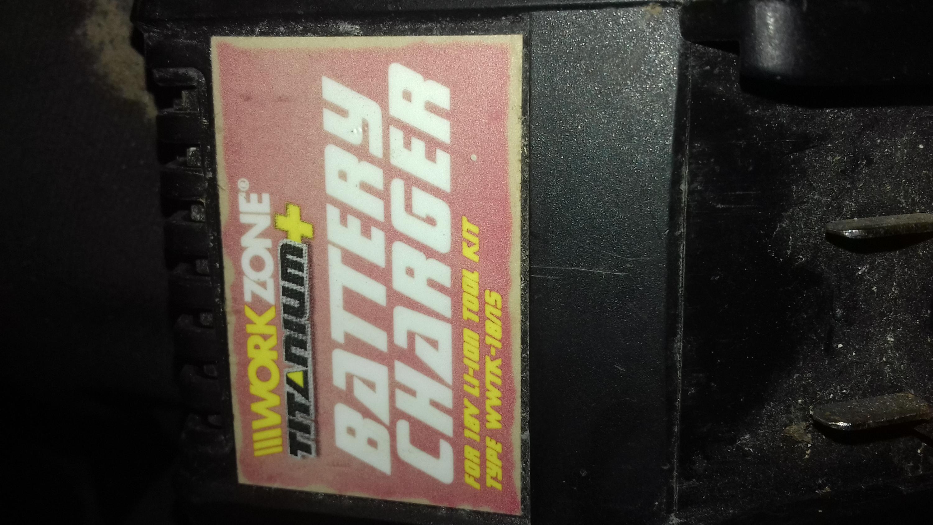

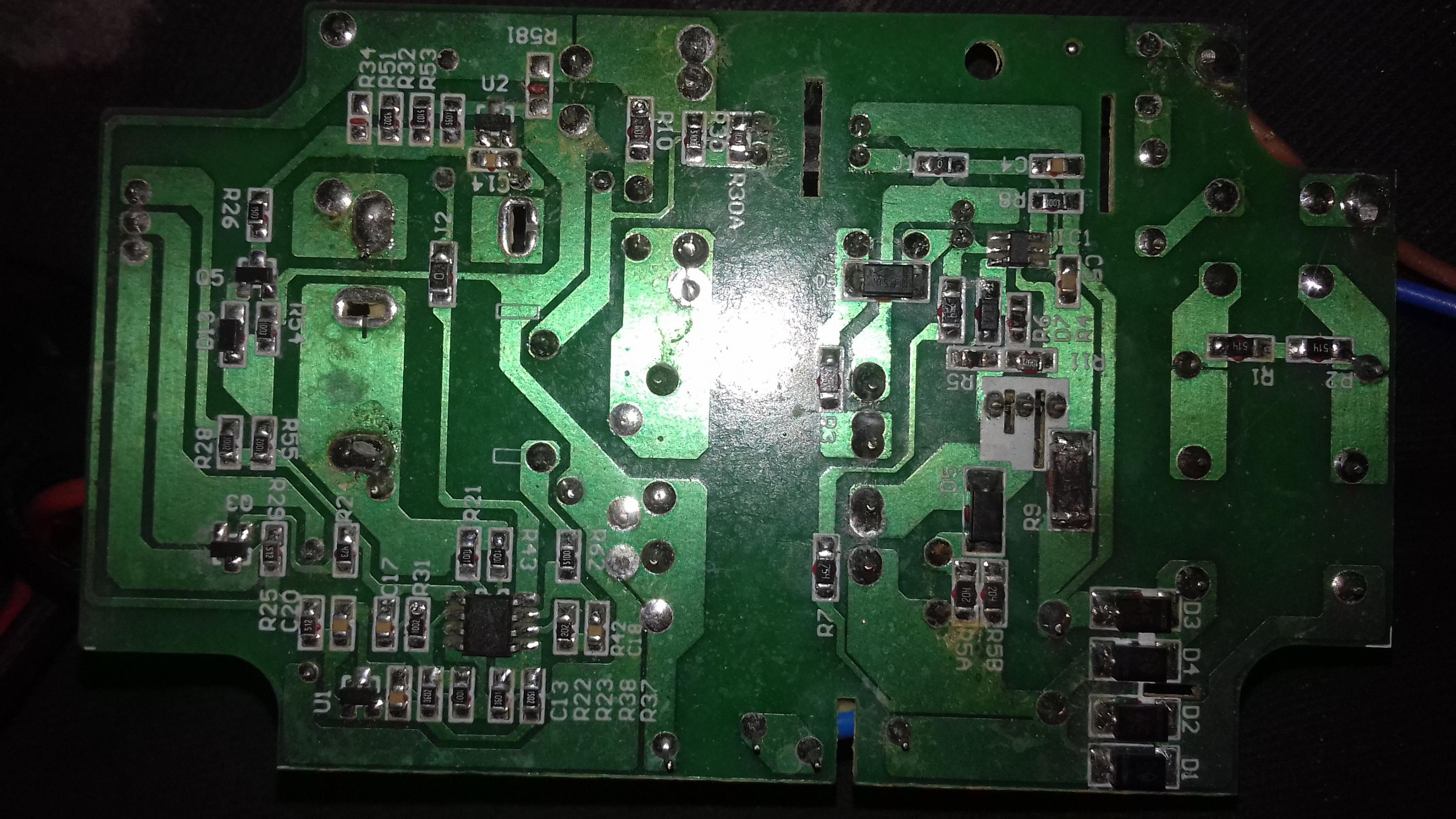

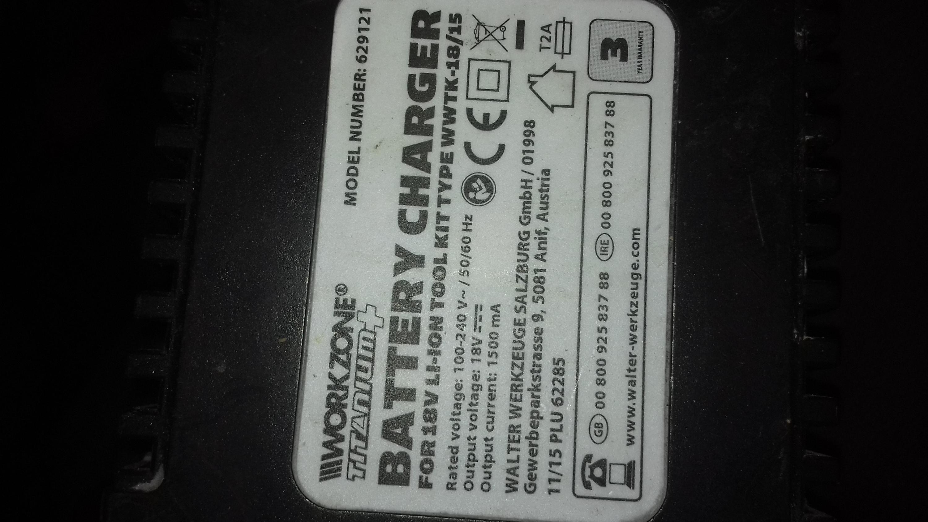

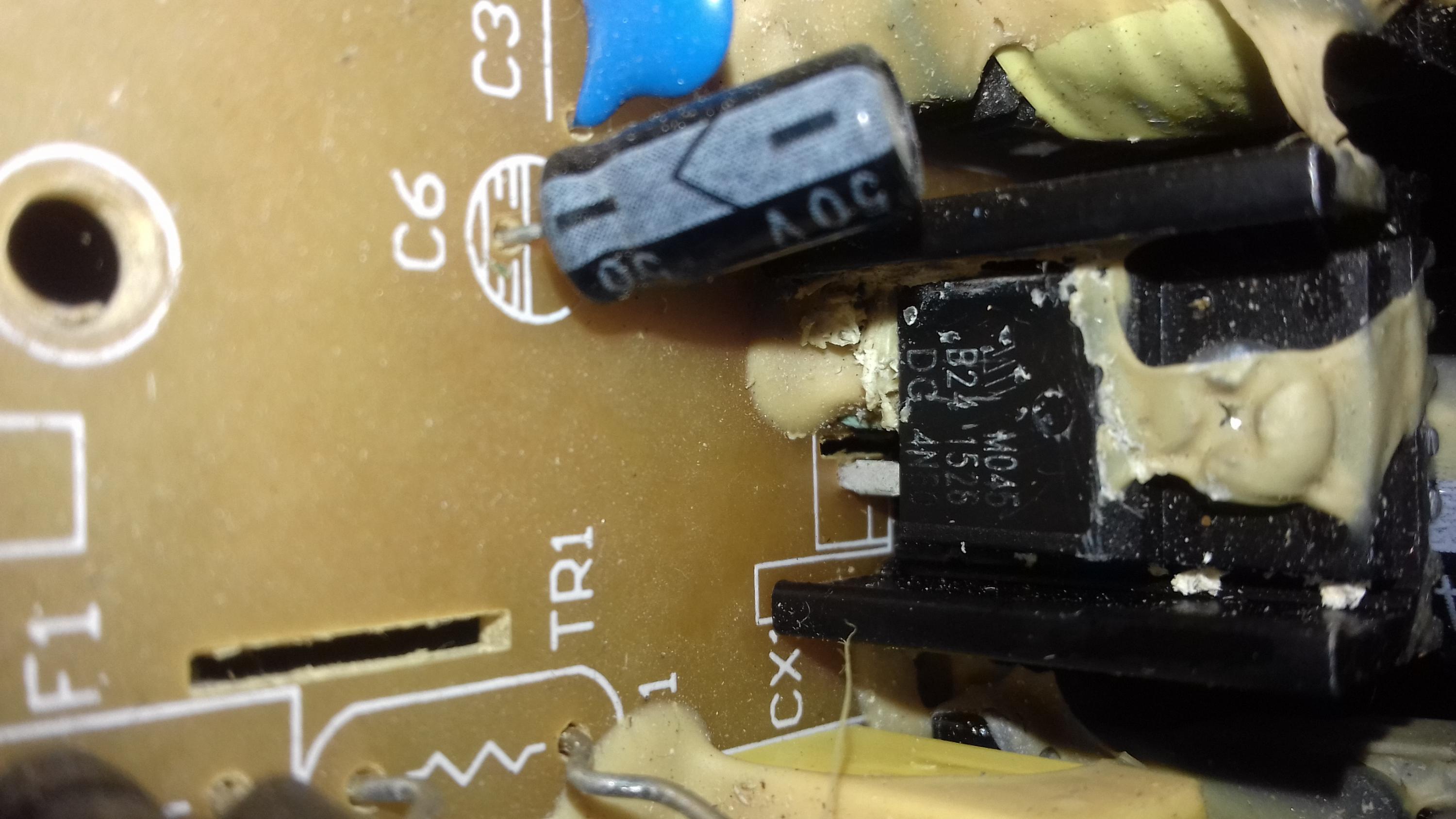

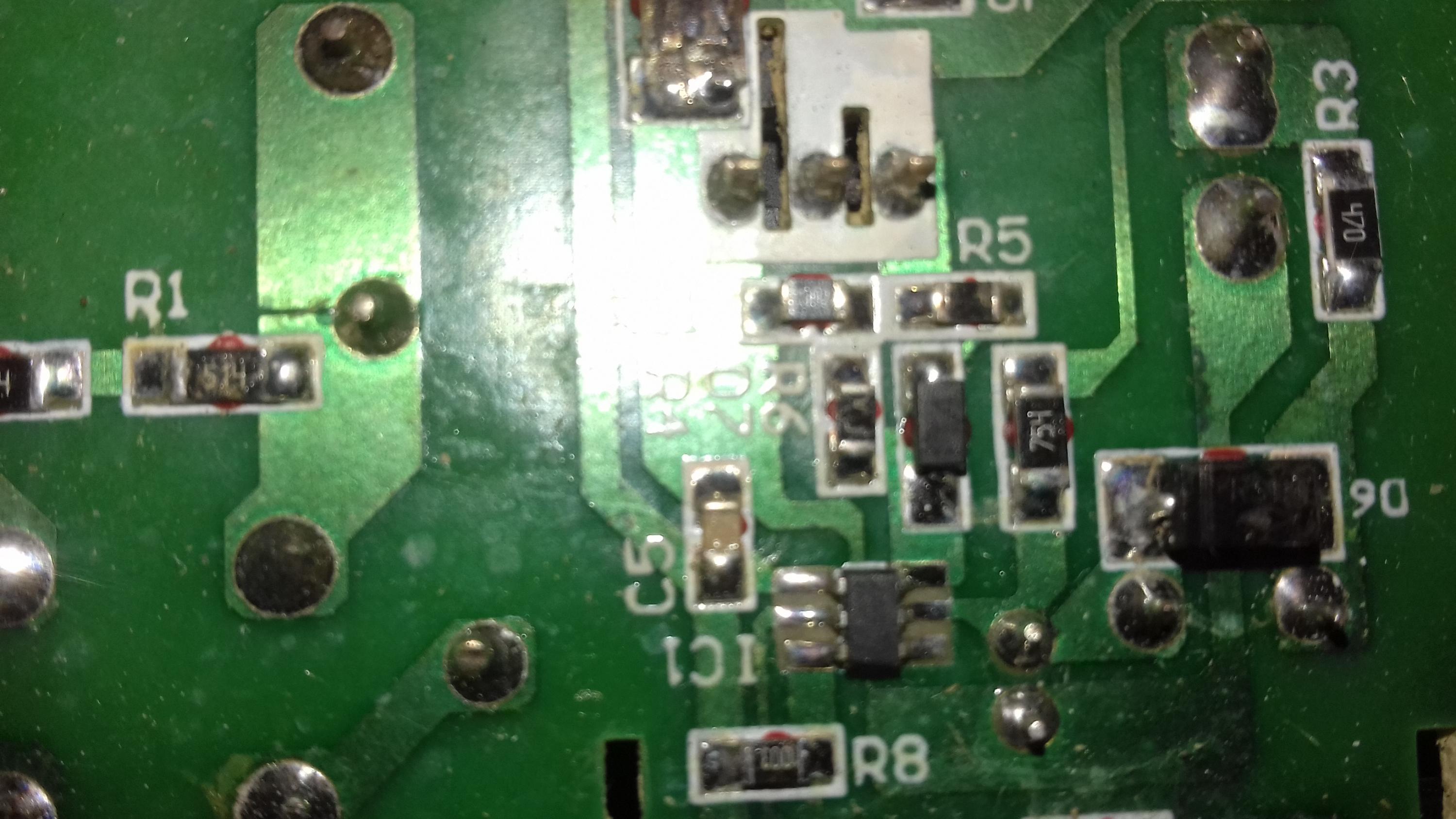

    have a battery charger here that blew itself up like they do .only trouble is i cant find a schematic for it .its a 18v workzone one .so far there are 2 obvious blown resistors and maybe another one , plus the fet is totally shorted which i could do with a cheaper sub for as expensive to buy .
    here are some pics .will post more in next post .
    ah yes unknown resistors are R9 R5 R11.

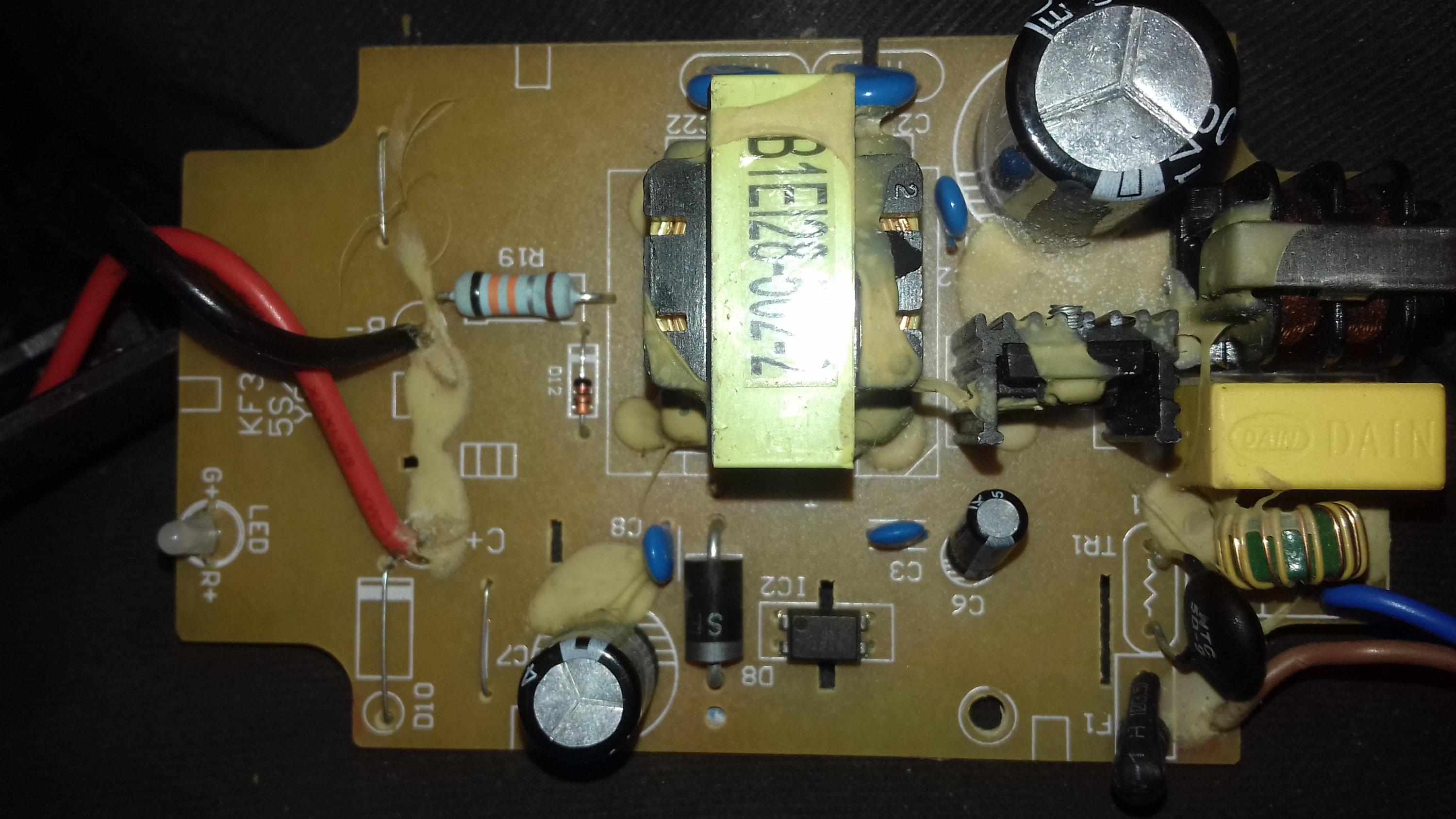

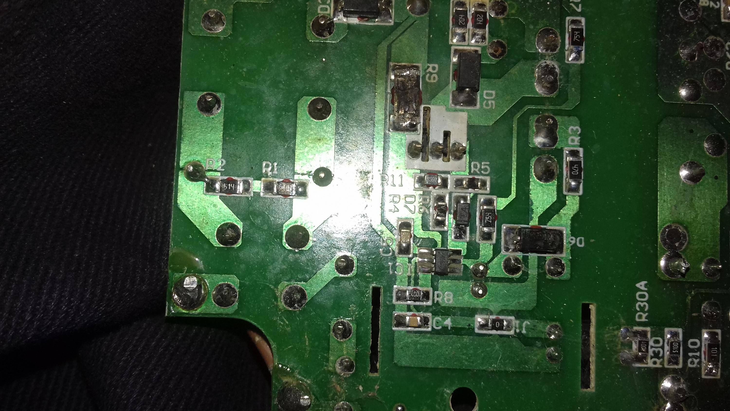

    Re: need some help with resistor values
    more pics .oh the fet is 4n80

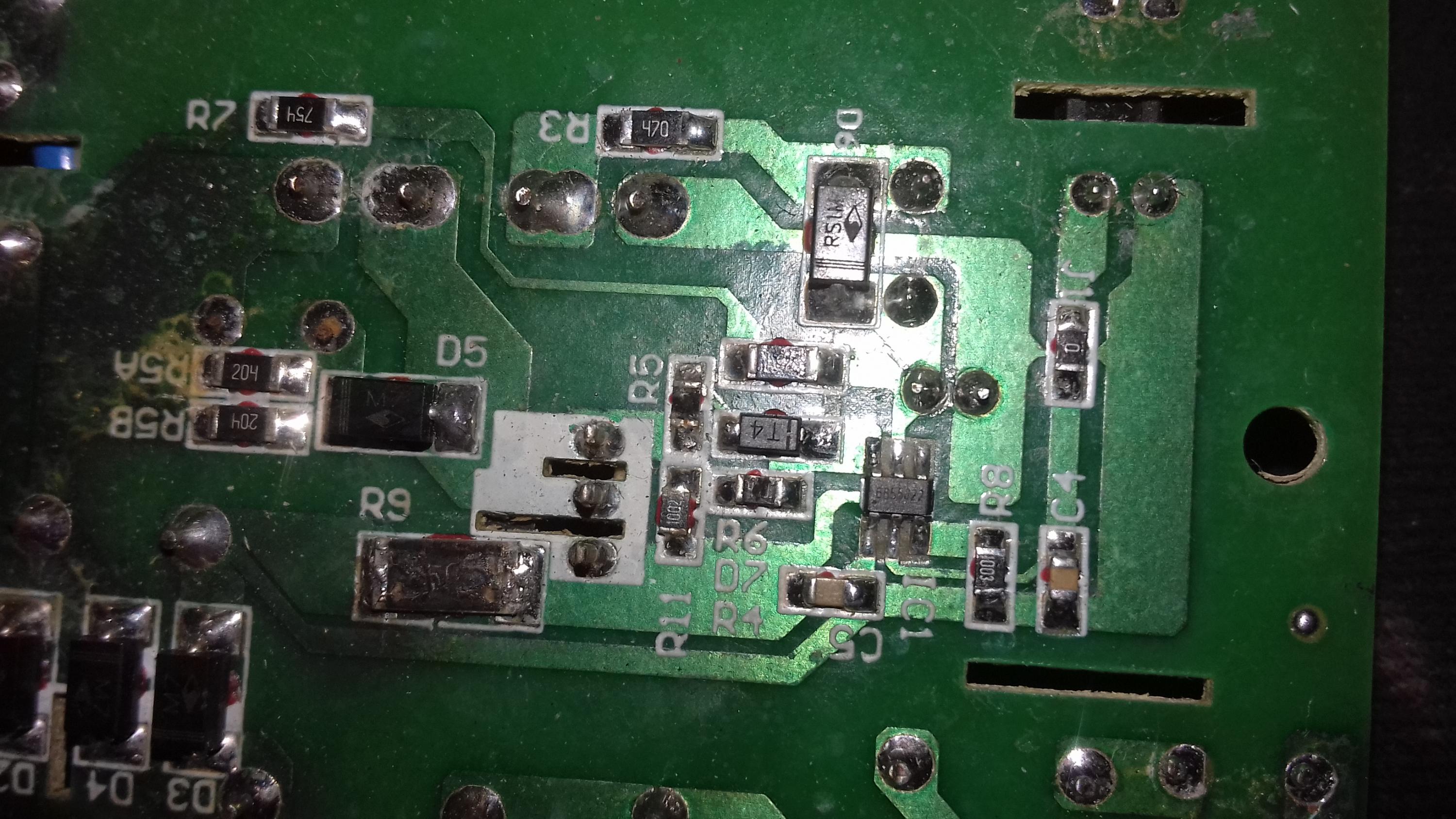

        If R5 (gate resistor) is blown, it is likely that ic1 is also defective. R9 is likely a low value 1Ω or less, R5 could be around10~30Ω R11 seems to be 100 which would be 10Ω
          yes i wondered about the ic cant see what it is though yet .
          edit ...
          looks like 6B55322 . the 3 might be a 1 .
            clear ish pic of ic
            • R_J
              • Jun 2012
              • 9535
              The ic seems to be a Cr6855 60w current mode PWM control chip
                    r11 is actually 10k and still good .its R4 i cant figure out .i see it starts with a 4 .
                    reads about 280k in circuit
                    edit .removed from circuit it measures 1.3 meg . which doesn't seem right as first digit is a 4
                                  R9 will be the source resistor for the fet, The ic monitors that line to control the current, If you used a 1K, and the fet turned on, the voltage developed across the resistor will blow CS input of the ic, Max input on that pin is usually 5~7 volts
                                  R9 is usually less than 1 ohm, Also if the fet shorted drain to gate, and blew R5, I can not see how the ic would handle 300vdc going to it.
                                      Without the fet, the ic will not see any voltage on the CS pin, it might try and output a few cycles, then shut down, it depends on how the ic operates.
                                      A similar ic would be the ON-Semi NCP1251, its pdf explains how it operates and it may be similar to the Chip-Rail ic works
