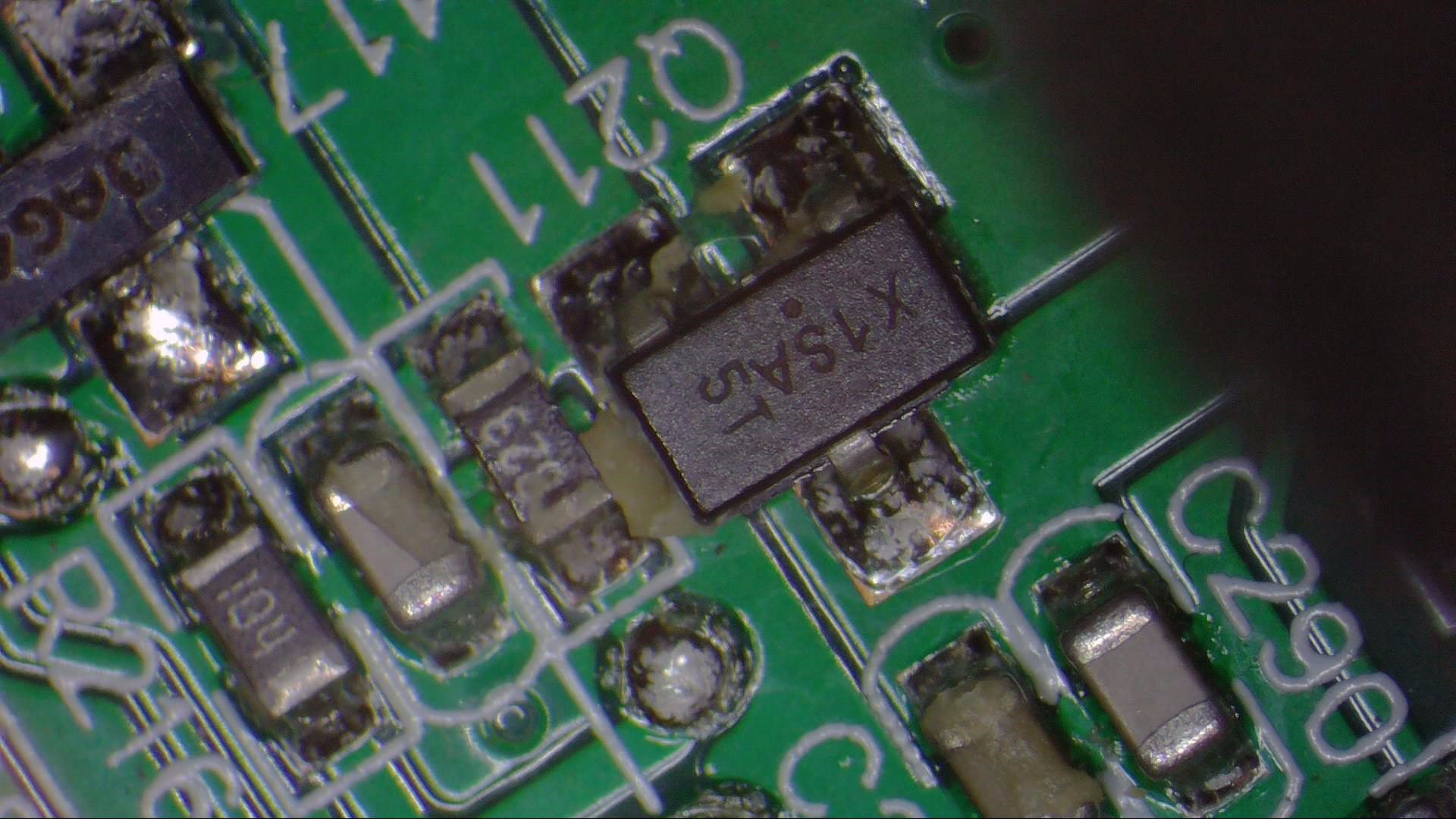

    Hey, I'm having a hard time finding a replacement for this IC, pretty certain it is a mosfet, but I need to know what kind. It relays about 20VDC as a part of charge circuit. I have identical one on this board that is blown due to short.
    Sorry I couldn't get it right side up under the microscope for the photo, the board is still a part of a large soundbar that I barely fit under it anyway.
    Thanks!

    could be 2sk425 or 2sk94-1 related
    if your sure it's a fet.
    if not then maybe a bft93

      Looks very simiplar to Alpha & Omega AO3401A 30V 4Amp P-Channel MOSFET
        Bingo, that is it. I even have AO3401 in stock for replacement, marked A19T.
        Thanks for the help!
