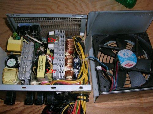

    If it is a nicer brand power supply and lower wattage it may have OCP (over-current protection) that is kicking in. Jamicon's are not recommended caps, also. Or you may have a very heavy 12v load with a light 5v load with a group regulated power supply and are crossloading it, causing the 5v to go up and the 12v to drop to a unsafe level.

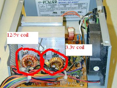

        Crossloading is when you have a larger load on the 5/3.3v rails and a low load on the 12v which causes the 12v to raise in voltage, and the other 2 rails to decrease in voltage. It can also work the other way, where the 12v has a large load which causes the 12v to drop, and the 5/3.3 rails to increase. This is a cause of group regulation, where the psu has large filtering coils on the output side of the unit, and usually two rails will share one coil, while one gets it's own. Usually the 12/5v will share the largest one, while the 3.3v gets it's own smaller one. In some low end units, all three rails share the same coil.
        Usually harder for the main caps to die, but if they are really off brand caps than they might have very little capacitance left in them.
        Now is this orion a HEC orion? In that case, it may have OCP as HEC's lower end units may not be real good, but they do have some basic protections.

            That is group regulation, 2 coils for 3 rails.
            Independent regulation, 3 coils for 3 rails.
            Whichever one it is, it dosen't really matter as you said it still does not work with different loads.
