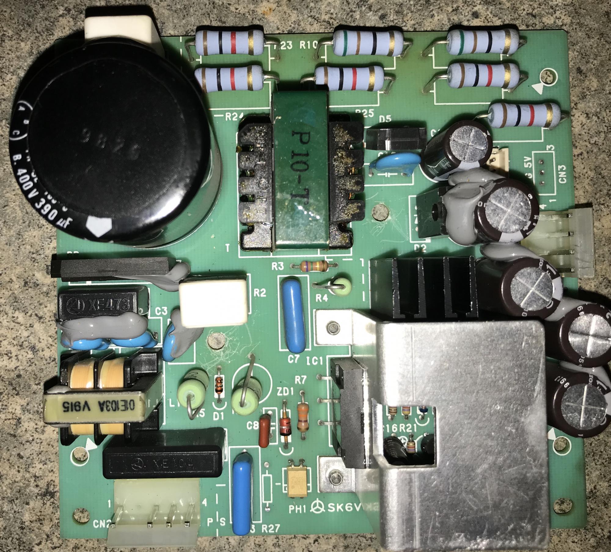

    Allen-Bradley 1747-L30C Series C FRN 6 SLC 500 Processor Unit
    About two weeks ago this PLC gave some problems turning on but I was able to get it to turn on

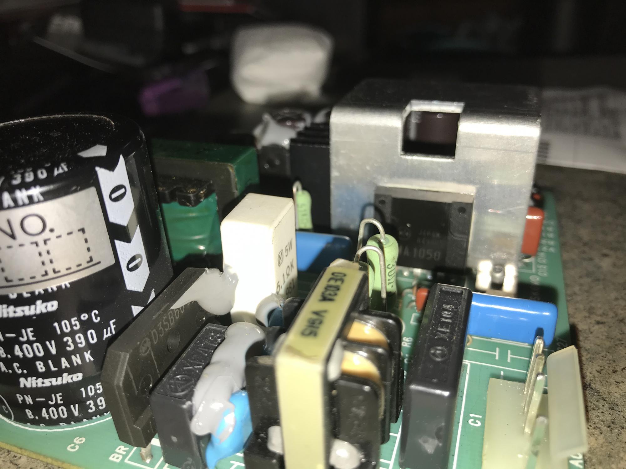

    Then yesterday it would not turn on at all so I took it apart and found that it has a switching regulator ic chip ( MA-1050 ) which I found some I bought 2 of them
    I have bought from this seller a few times before
    https://www.ebay.com/itm/MA1050-Orig...53.m2749.l2649
    Going to recap this power board and change the optic sensor because it looks like it has been running warm it is yellow looking which may or may not mean anything the part number is
    ( P521 ) which I ordered a couple of them
    https://www.ebay.com/itm/TLP521-1-Or...53.m2749.l2649
    I will see if I can bring it back to life or not or one of the ones that I bought on EBay
    I also bought a few of them off of EBAY I did not pay no more than $50.00 or is some cases less than $25.00 each the listing says that at least they power on
    The manufacturer of the machine wants $6000.00 ( plus installation ) for a up graded PLC that the tech support person that I have been dealing with him for years says to me this is not something you want to do your self because it might not be just plug and play some of the programming might need to be tweaked a little bit and you would have to have the programming hardware
    This power supply board has two 24 volt rail and one 5 volt rail

    Re: Allen-Bradley SLC 500 PLC switching power supply dead
    I wouldn't expect a Japanese PSU design in Allen Bradley, this looks like Toshiba or Hitachi.
    I'd check under the heat sink (rivets?!) for any blown or old parts. Usually the snubber resistor and capacitor age pretty bad. D1, ZD1 check too. The IC is rated to 850V so what happened.
      This is what I have to figure this out this why I ordered those two parts to see if the power supply comes back to life or not
      When I seen switching power supply do not want to turn ON most times for me it been that the switching regulator ic chip has been the problem or that the optic sensor has some type of issue of some sort
      There are no parts under the heat sink
      I have not check any of the resistor or diodes on this board yet but that might not be a bad idea to check them but nothing on this board jumps out at me to direct me to this part of the board for a problem
      But I did not see any resistors that look like they were running hot but that does not mean that they are good
        Ok
        I tried to power up the power supply board that was in this machine and the fuse blew with a flash two amp fuse
        This does not look very good
        looks like the rectifier is shorted
        looks like the switching power regulator is shorted
        I will not know for sure until I remove these two items and see if I still have a short if it does then I will still have to remove parts until I get rid of short 8 ohm across the main filtering capacitor
          UpDate
          The problem with this power was the MA1050 switching power regulator ic chip was shorted on the output pins to the transformer
          Replace the switching power supply regulator ic chip and replace the optic sensor and the power supply came back to life
          The bridge rectifier was ok it was not shorted but when I checked the main filtering capacitor it showed that it was shorted but it was the switching regulator ic chip that was shorted
          Which is a good thing I now have a few good power supply for this PLC
          It just me that I have to figure out what happened to this switching power supply to understand what happened to the PLC and I have come to the conclusion that when the switching power regulator went stupid it might have taken out the micro controller that controlled the PLC but like what was mentioned earlier may also be true that it might have taken a hit on the selector switch power supply ( which is a 24 volt half wave rectifier setup with filtering capacitors ) so who know what else has happened to the rest of the machine
            Update
            On switching power supply
            Recap it and ran it for at least 2 hours and ran with out any problems
