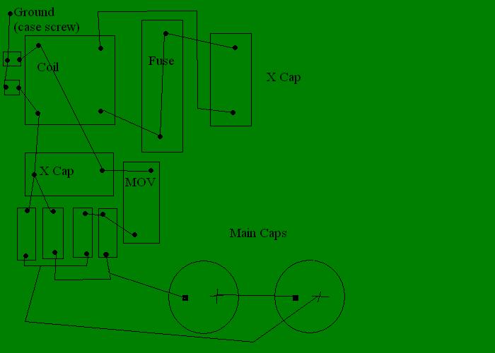

                          Re: Installing bridge rectifier in place of 4 diodes
                          The diodes are laid out differently in that sunpro than in this one.
                          WARNING I made this diagram at 3:22 in the morning.
                          Those little boxes next to the coil are Y caps
                          • Wizard
                            • Mar 2008
                            • 2296
                            MOV, no. NTC yes. NTC start high then resistance drops as this heats up, and always dull looking.
                            MOV is always OPEN till specific voltage threhold is reached, shorts out. MOVs is always across each of Neutral and ground, and HOT and ground. The small blue caps across diodes rectifier is to quieten down diode noise. Said devices are usually shiny.
                            Cheers, Wizard
                              Yup its a NTC. Like I said, 3:22 in the morning.
                              Whats interesting is that the two diodes connected to the X cap there were a lot bigger and rated at 3A, 1000v. The two connected to the NTC (labeled MOV on this,) were much smaller and rated at 2A.
                                I have a junker PSU that has a similar diode configuration - bigger ones on one side of the AC and smaller ones on the other...weird....
                                anyways, judging from your picture, it should be easy to install the bridge rectifier: The + should go on the bottom left, the - should go on the bottom right, and the two AC pins should go on the middle two on the top.

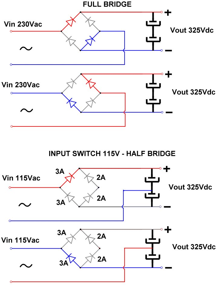

                                    • Gianni
                                      • Jul 2008
                                      • 681
                                      • Italy
                                      The reason is that at input 230Vac all 4 diodes work while with the input switch in position 115Vac only 2 diodes work because one input line is connected in the middle of the two input bulk capacitor. In this case at the same output power, the input current is higher.
                                      I don't know how much cents they can save using a 2A diode instead of 3A diode.
                                      I attach here a schematic with colored current path for both configuration full bridge and half bridge.
                                      If you check diodes connection and input voltage switch connection you should confirm this schematic.
                                      Ciao
                                      Gianni
                                      "In the confrontation between the stream and the rock, the stream always wins...Not through strength, but through persistence."
                                      H. J. Brown
                                      • Toasty
                                        • Jul 2007
                                        • 4171
                                        The switch turns the circuit into a voltage doubler.
