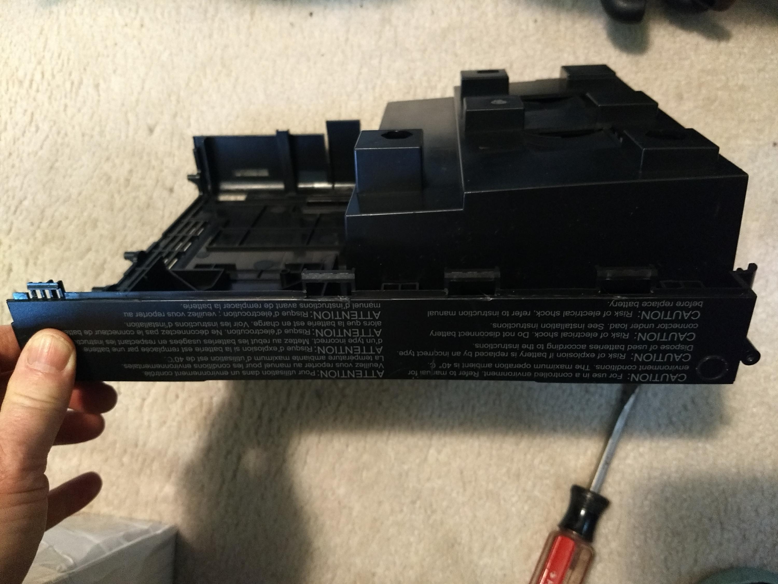

    Greetings,
    I'm looking for tips or tricks to open up the case of this UPS. It's a CyberPower CP1350PFCLCD. I've got the front and back and top covers off, batteries out, and the seam along the top of the case has all the catches released.
    On the bottom seam, only one catch is visible, it looks like there are at least two more that are hidden. I'd like to open this case up to check for bad caps on the circuit board (fault code F03 - charging circuit not working).
    The real trick is that I want to be able to close the case again, without using non-factory parts like screws and a patch.

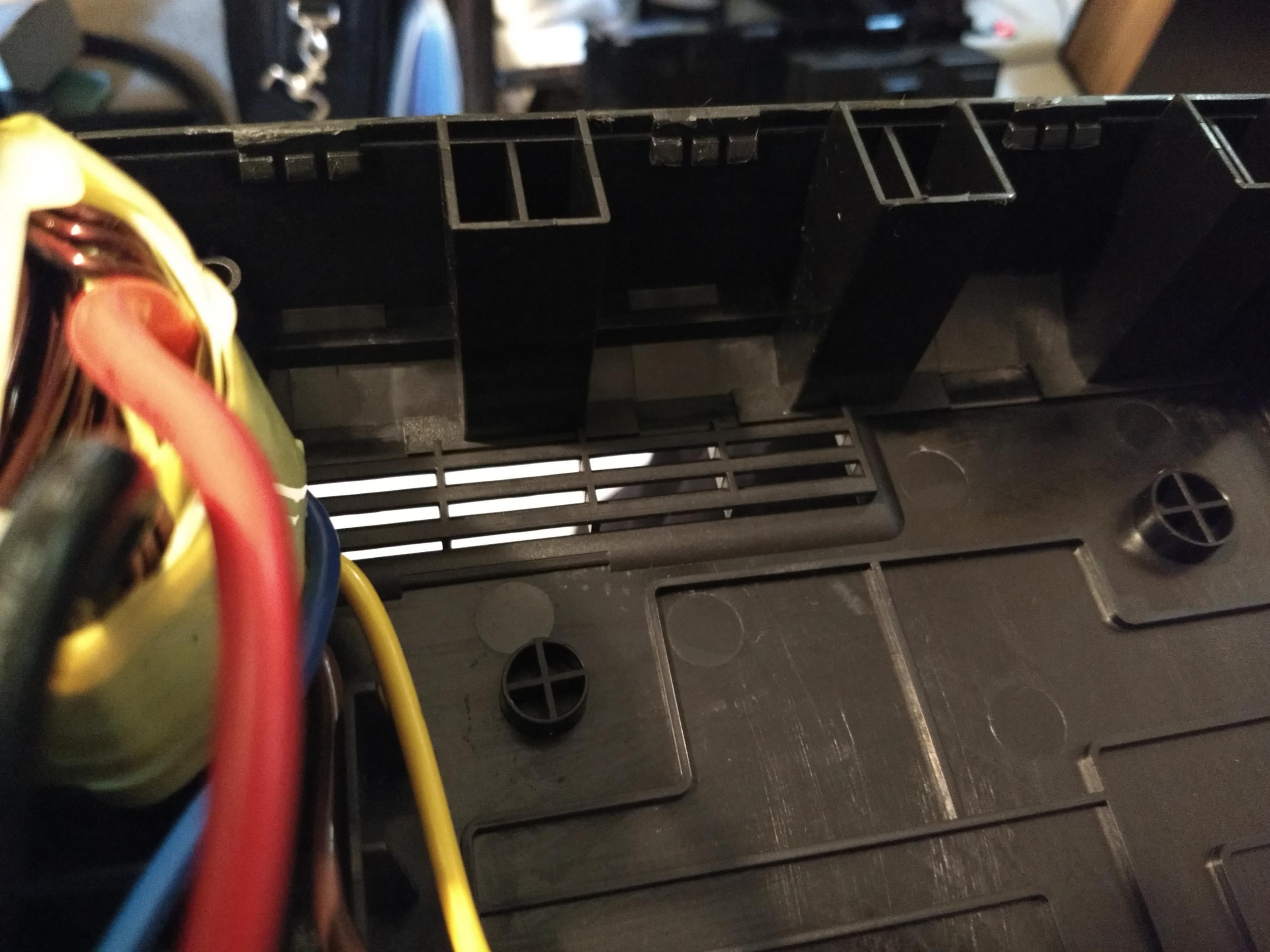

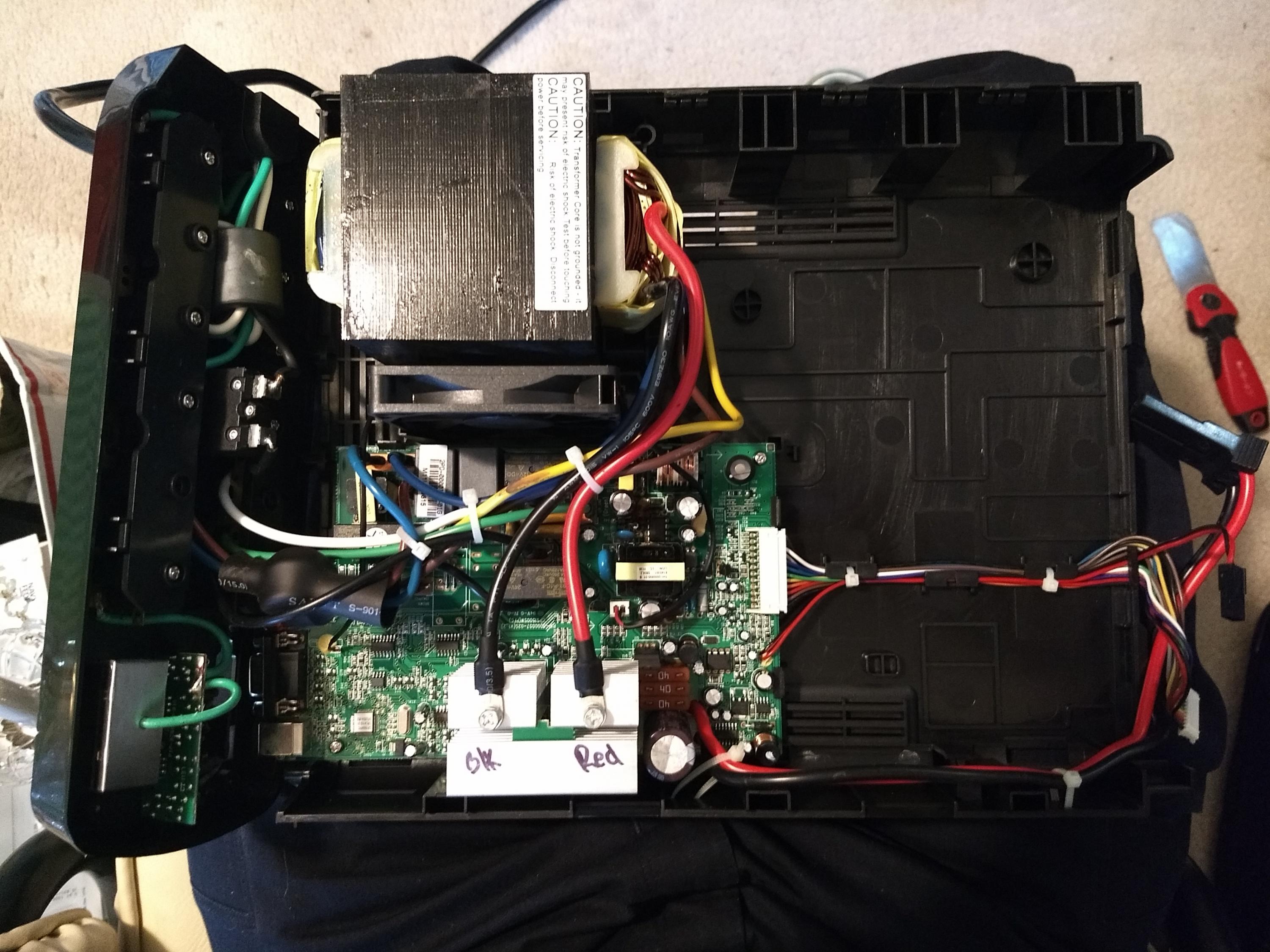

            Success! Carefully examining the bottom seam, I noticed three areas where the color of the black plastic changed ever so slightly. They had a length about the same as the one visible catch, so I tried with a putty knife to put pressure on them so they would open in the same manner as the visible catch. Once I had two out of three release, the case wanted to open up like a clamshell and then the third came free.
            • Maxbumpo
              • Sep 2019
              • 12
              Re: How open case? CyberPower CP1350PFCLCD
              Here are some pictures.
              One is the entire half of the case with the board and transformer, rear cover.
              Next are a couple closer pix of the hidden latches, showing the male and female parts.
