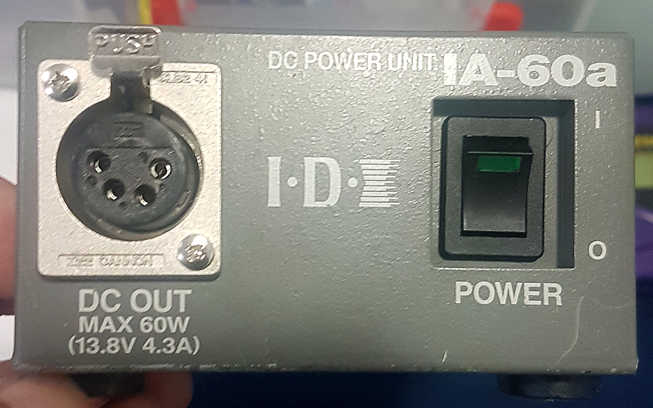

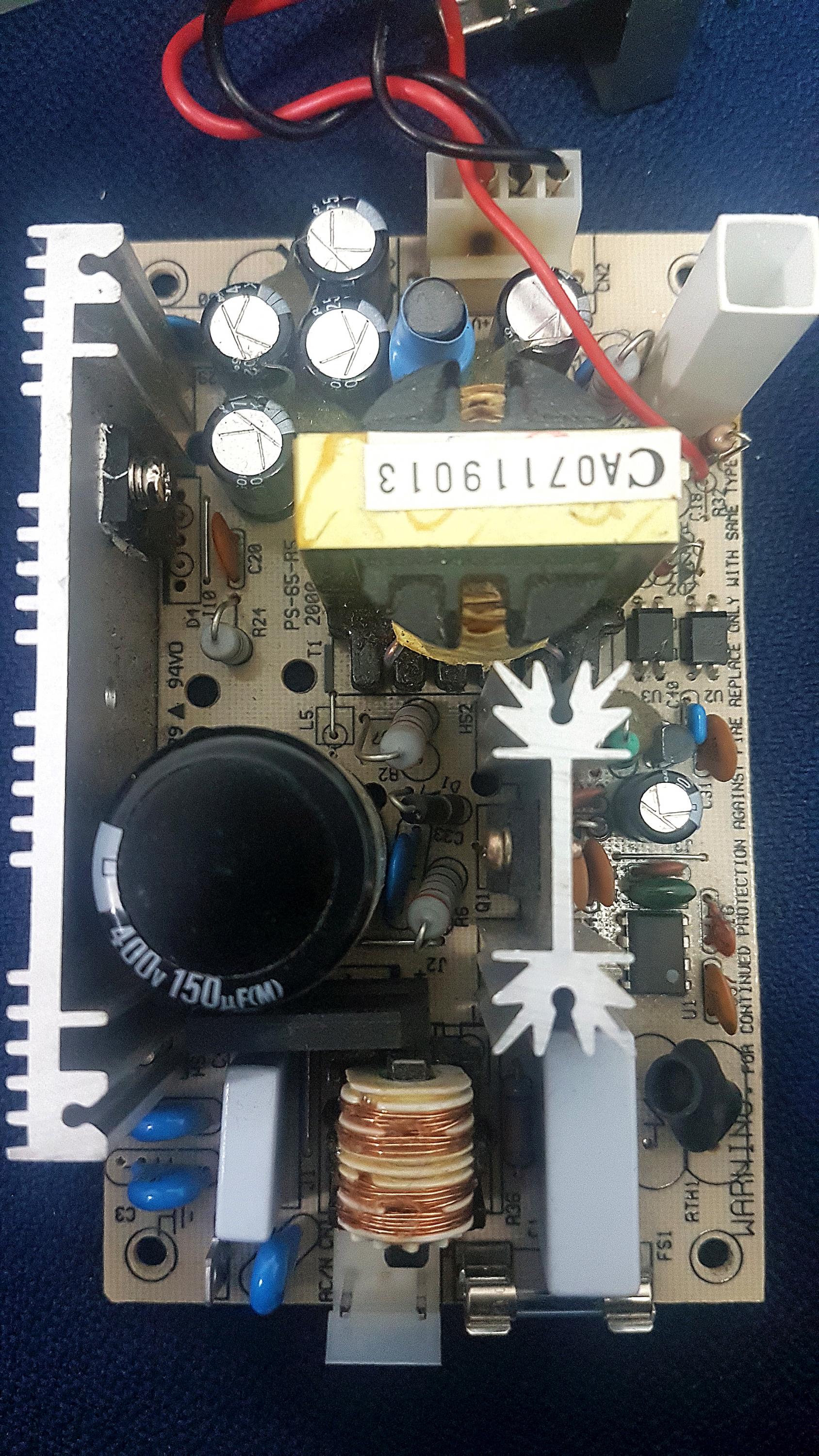

    IDX camera power supply turns off after a while when warmed up. But will turn on again quite quickly when power is cycled.
    Any help on what to do to diagnose this fault would be very much appreciated.

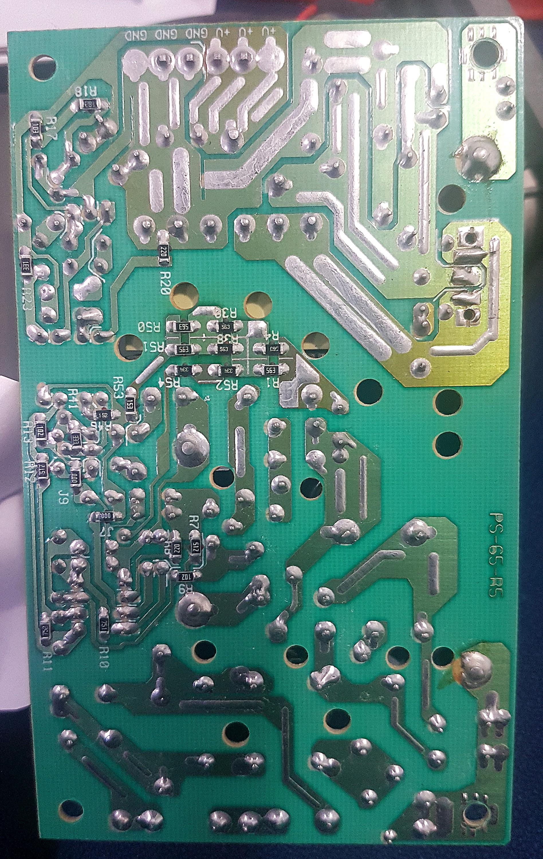

    A lot of the board's soldering (to through-hole parts) looks like fractured joints.

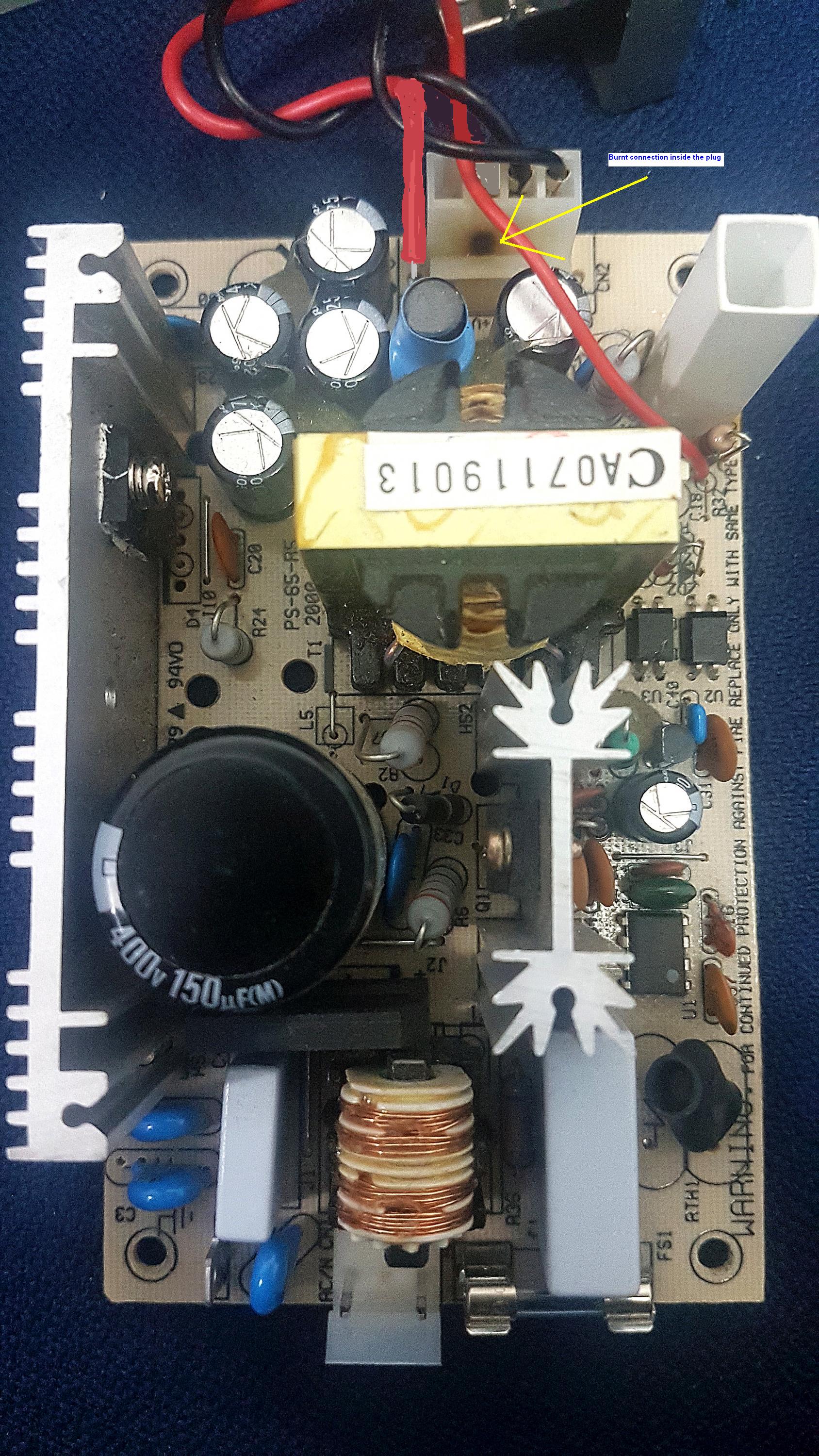

    The DC output connect has a cracked GND pin, and another is burning the plastic - resolder all those 4 pins and check the connector.
    Pins by R54, bridge rectifier etc. all look in need of resoldering.

      Your problem is with a burnt contact in the plug, Red wire. Fix that and I bet it works fine.
      I would just remove the wire from the plug and solder it direct to the +V hole next to the plug
      That connection is getting hot and blackened the plug. It will also be corroded so would be cutting out

        redwire and R_J thank you for taking the time to look at the pics and your replies. I will take a look at everything you guys have suggested and will update when done.

          This would be one way to fix the bad red wire connection, you could remove the plug completely and solder the two black grounds and the red positive directly to the board
          Once the plug gets hot like that, it takes the spring tension out of the metal contact and the connection gets worse.

            If possible, replace both the harness connector (including contacts), and the PWA's connector, Chances are that the contacts on both connectors have been damaged. Or hard-wire the harness.
            One of two things probably happened. 1. The crimp in the harness red wire contact was poor and gradually broke down due to increasing heat. 2. The service loop of the harness in so tight that it mechanically stressed the contact between the socket and pin, resulting in a gradual break down due to heat.
            The latter, mechanical stress, can also deform low current signal contacts and result in intermittent contact (e.g. the PSON* or PG wires in a 20- or 24-pin ATX connector).

              I have removed the connector and soldered directly to the board. Will monitor the power supply over the next few days and report back.

                I have tested the power supply for a couple of days now and am happy to report that it is running perfectly
