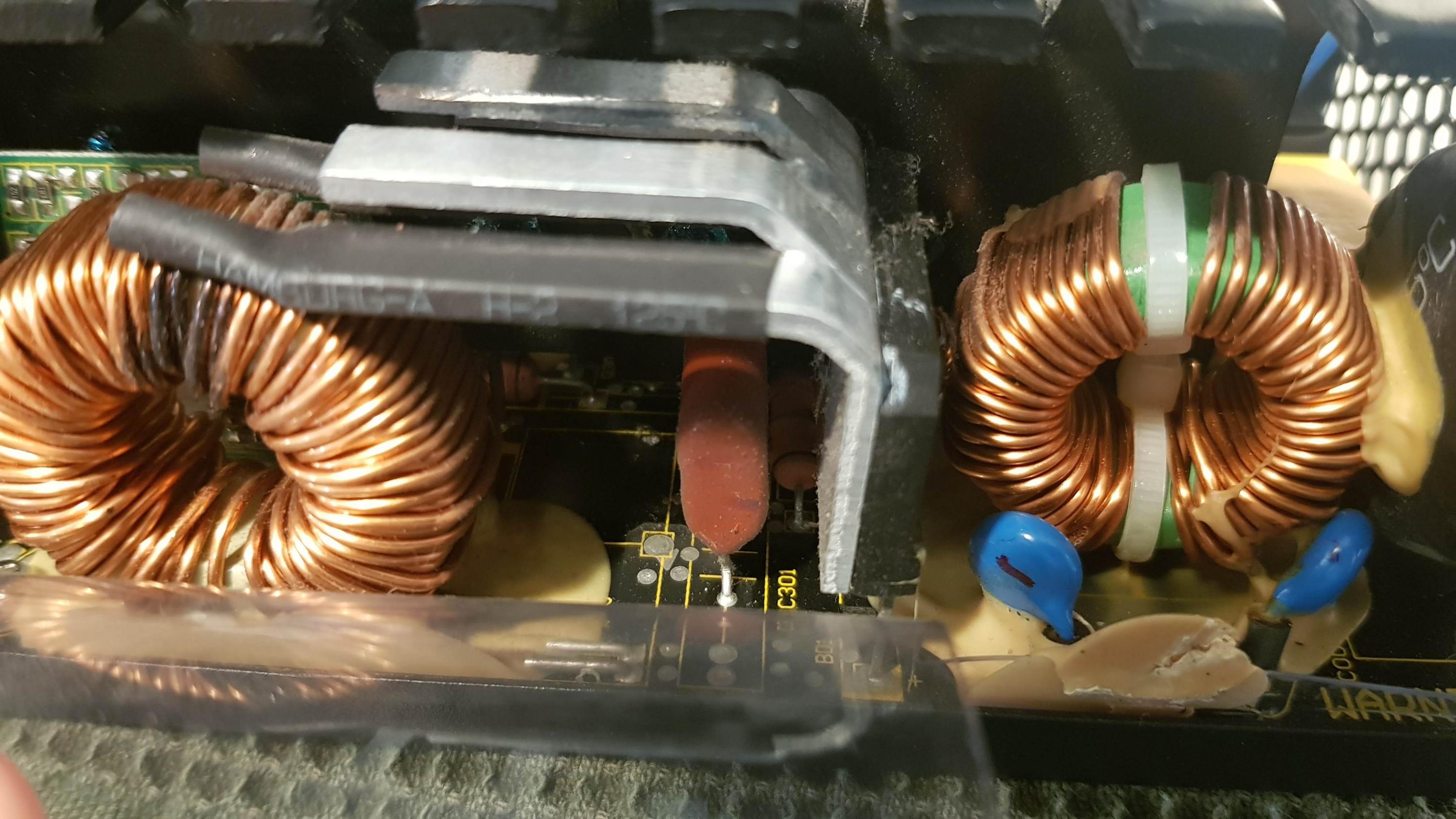

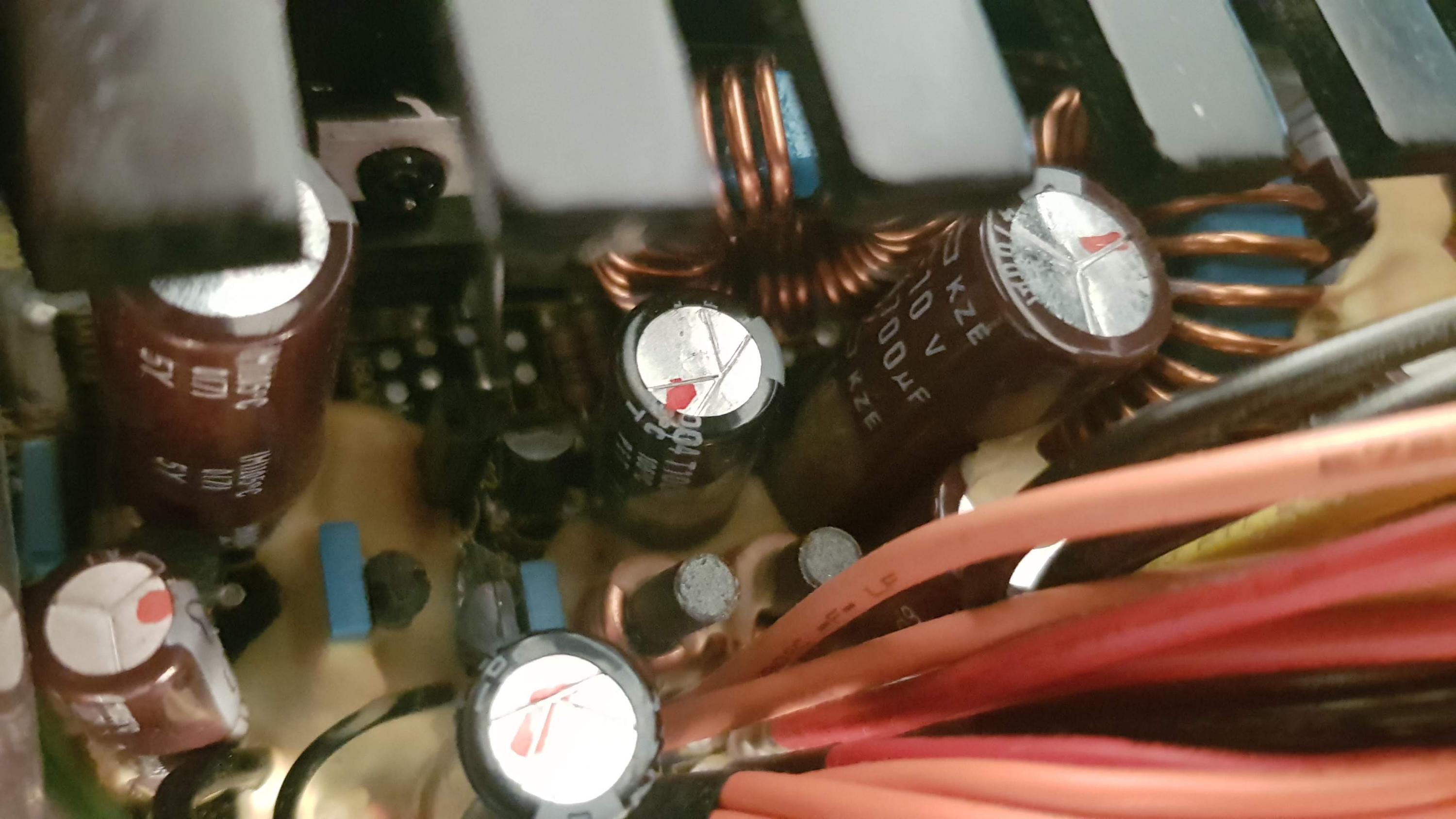

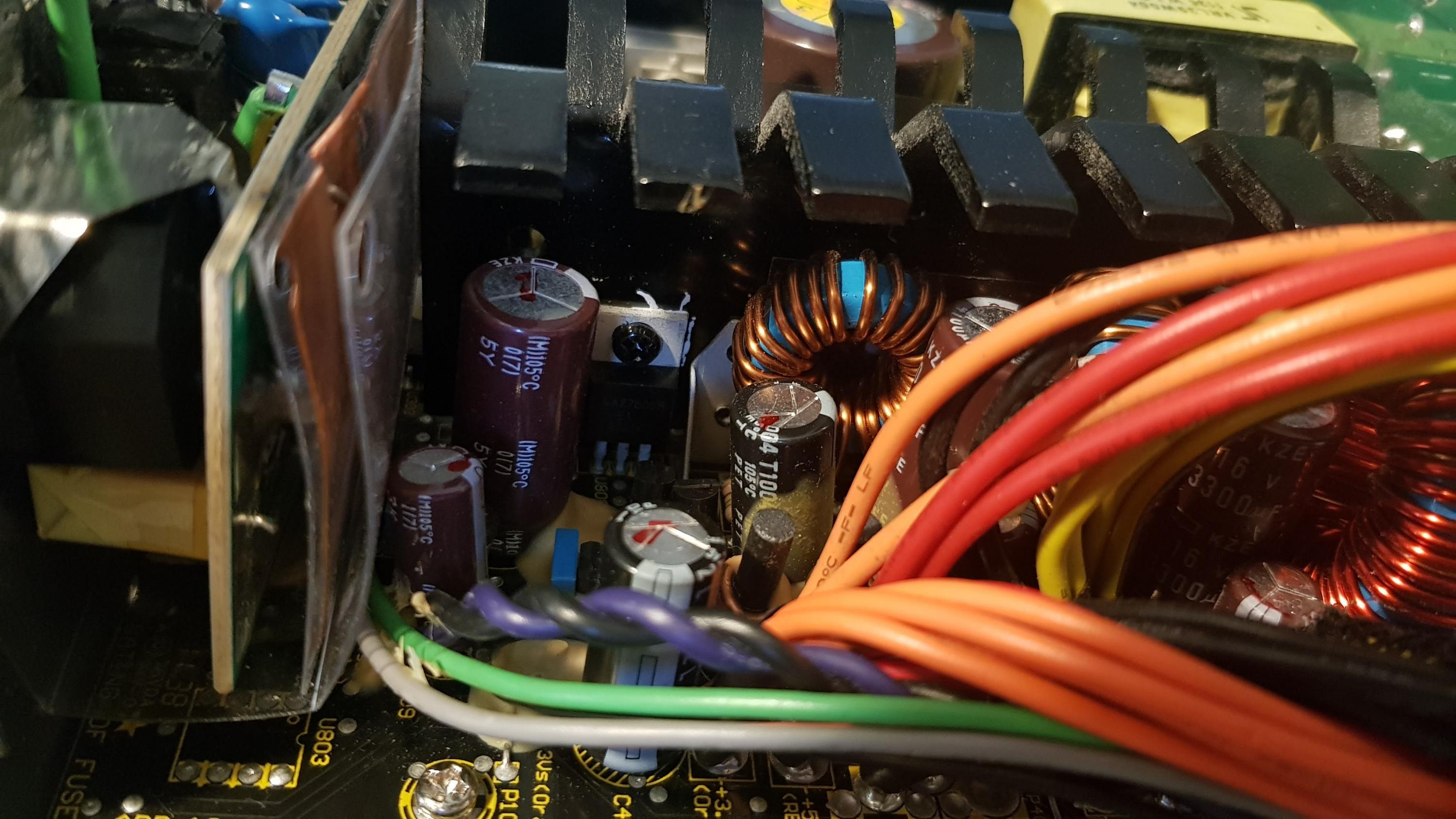

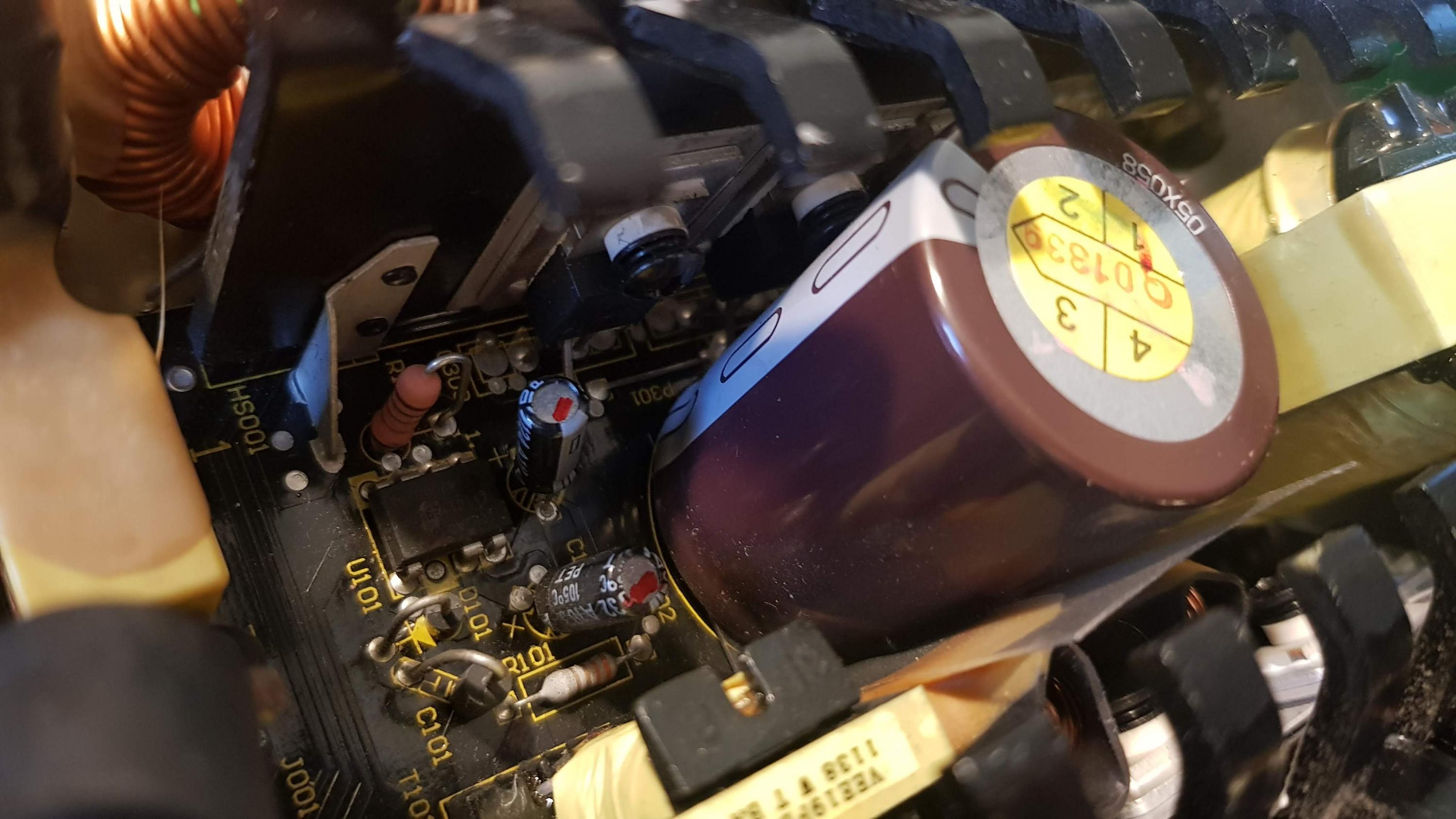

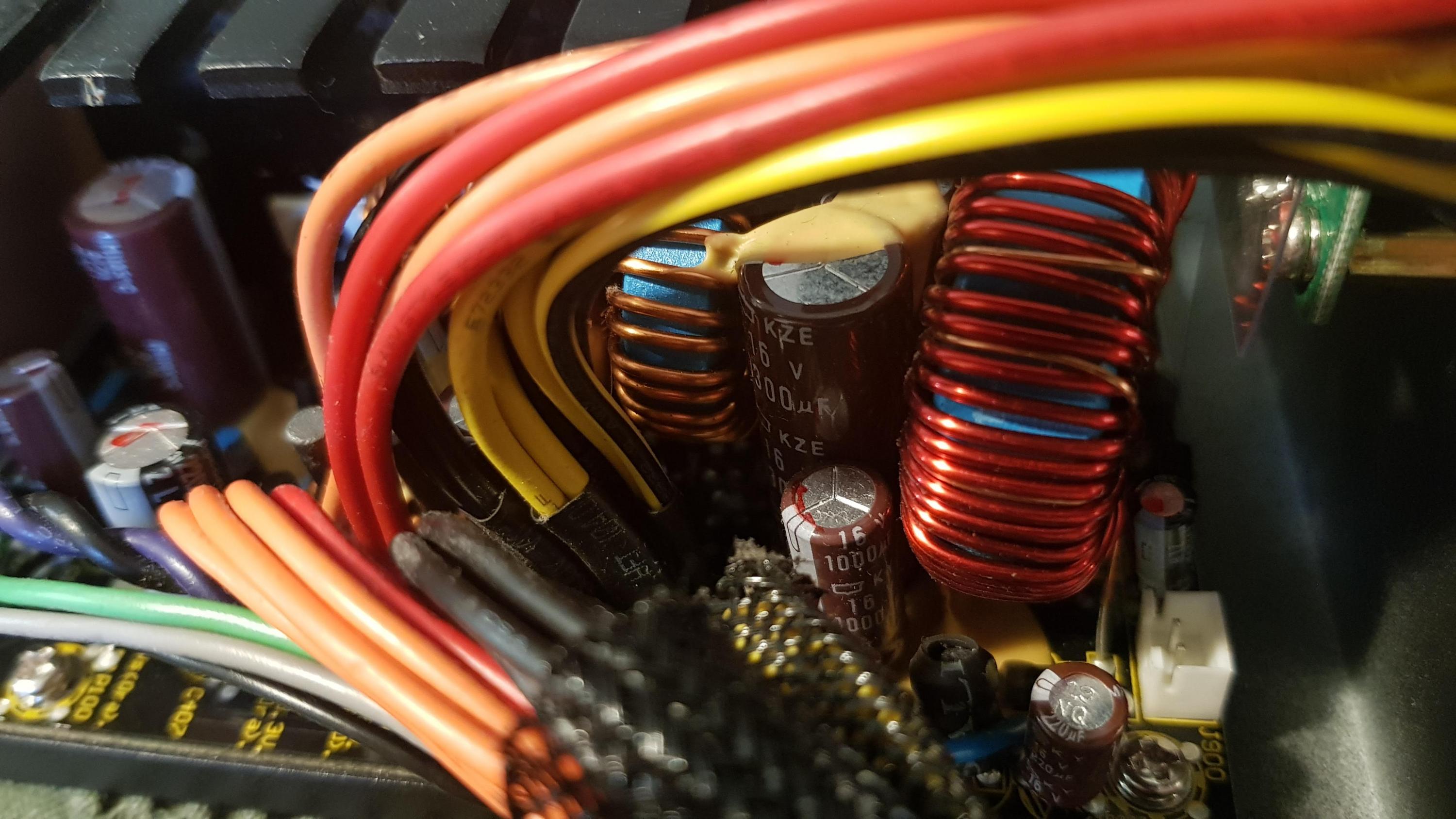

    Hello.
    I hope maybe someone can help me.
    My PSU seems to be faulty but I don't know how to repair.
    I only connect it to my motherboard. When I leave the RAM out all the LEDs become green and everything stays on power. When I put a ram in the computer it comes into an on/off loop. sometimes it stays on for up to 15 seconds but I am sure the LEDs are flickering a bit. So I guess the voltage is not stable. Sounds like a broken capacitor, or can this be some kind of power management what is broken?
    Would be cool if someone know that issue and can help me with this
    (I already opened the PSU but unfortently I can't see a broken cap)
    Thanks to everybody-

    Re: Corsair HX650W
    Post a picture of both sides of the mother board in question
    Post a picture of both sides of the switching power supply in question

              • 31000
              Re: Corsair HX650W
              well that coil with the burn mark needs investigating.
              did you buy this new?
              i'm not sure it's just coincidence that the heatsink above the burn has sleeving on it!!
              • storexxm
                • Oct 2012
                • 107
                • Vienna
                Re: Corsair HX650W
                no, its a used one...
                got it from a friend
                  • 31000
                  Re: Corsair HX650W
                  better ask the friend if it was opened or anything.
