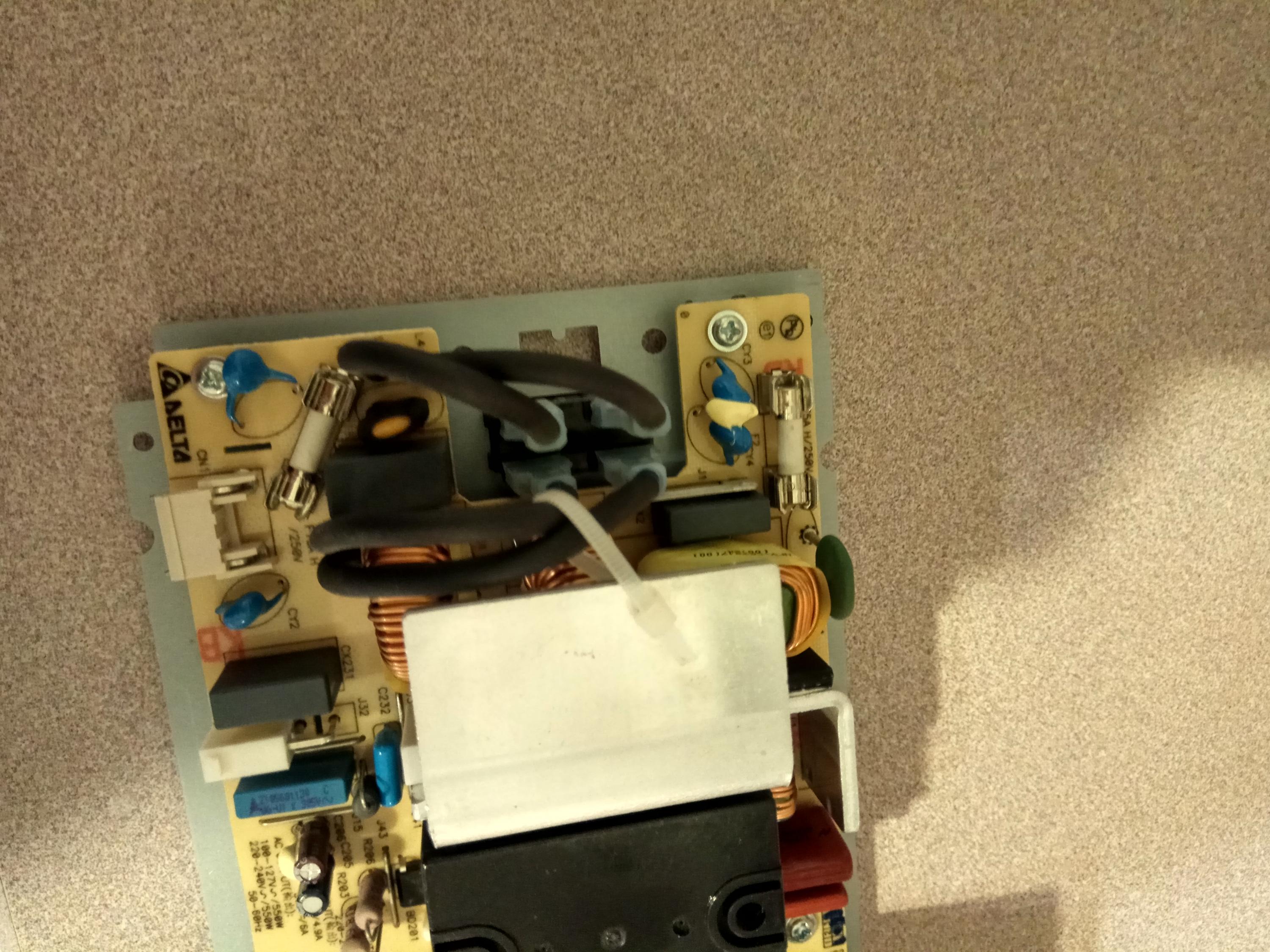

    Lexmark 544dn power supply clicking sound model 40x5409

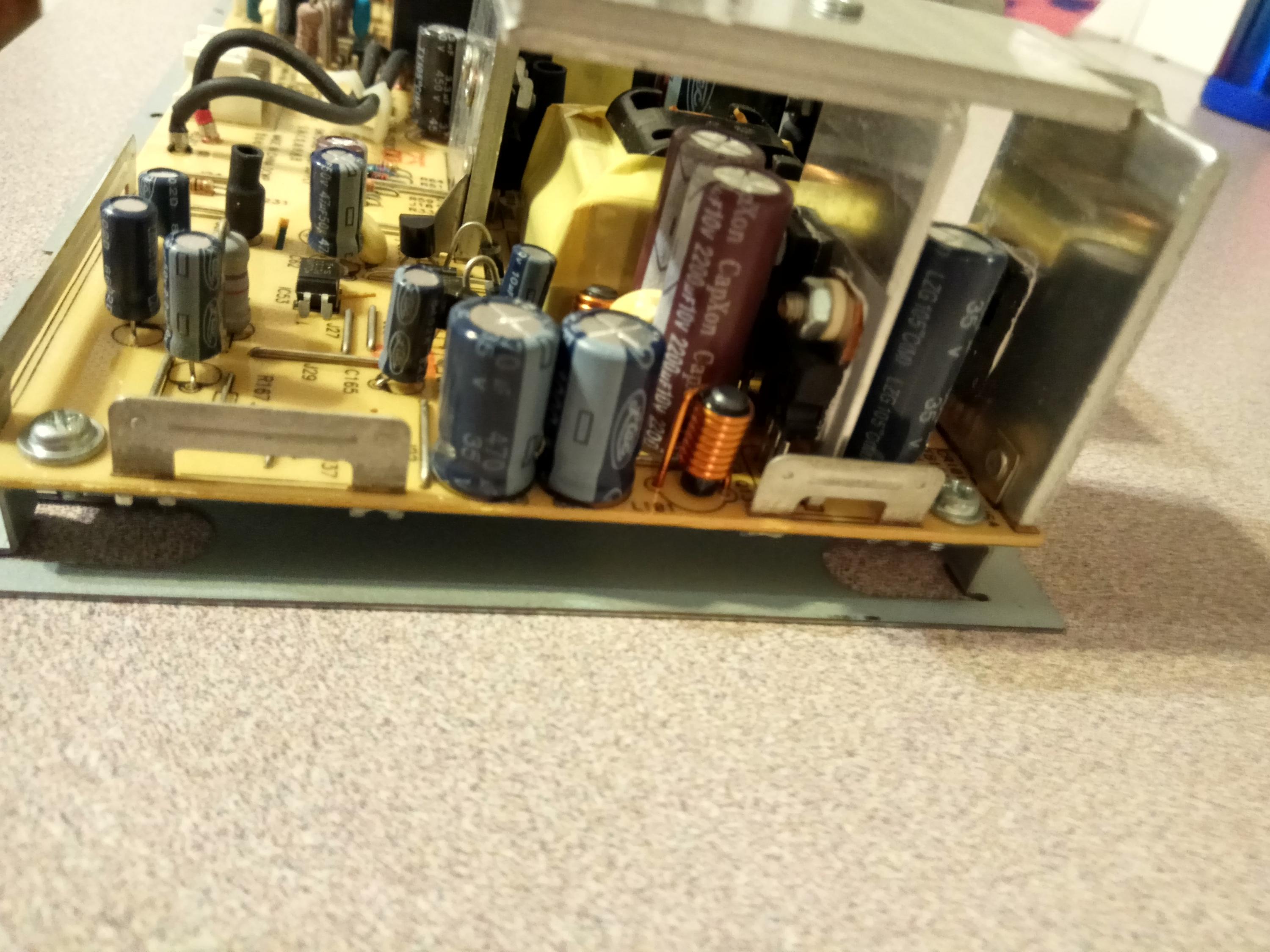

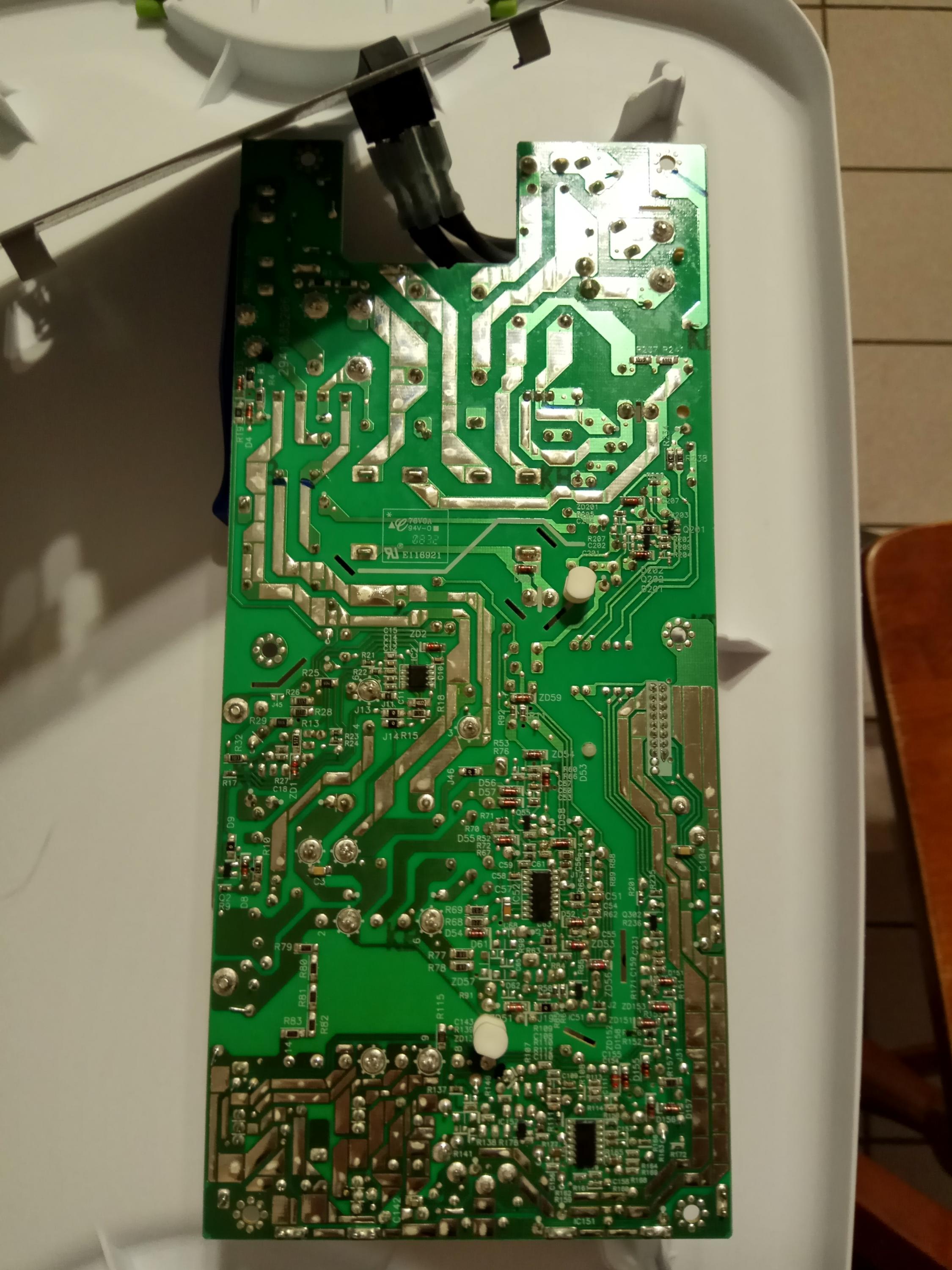

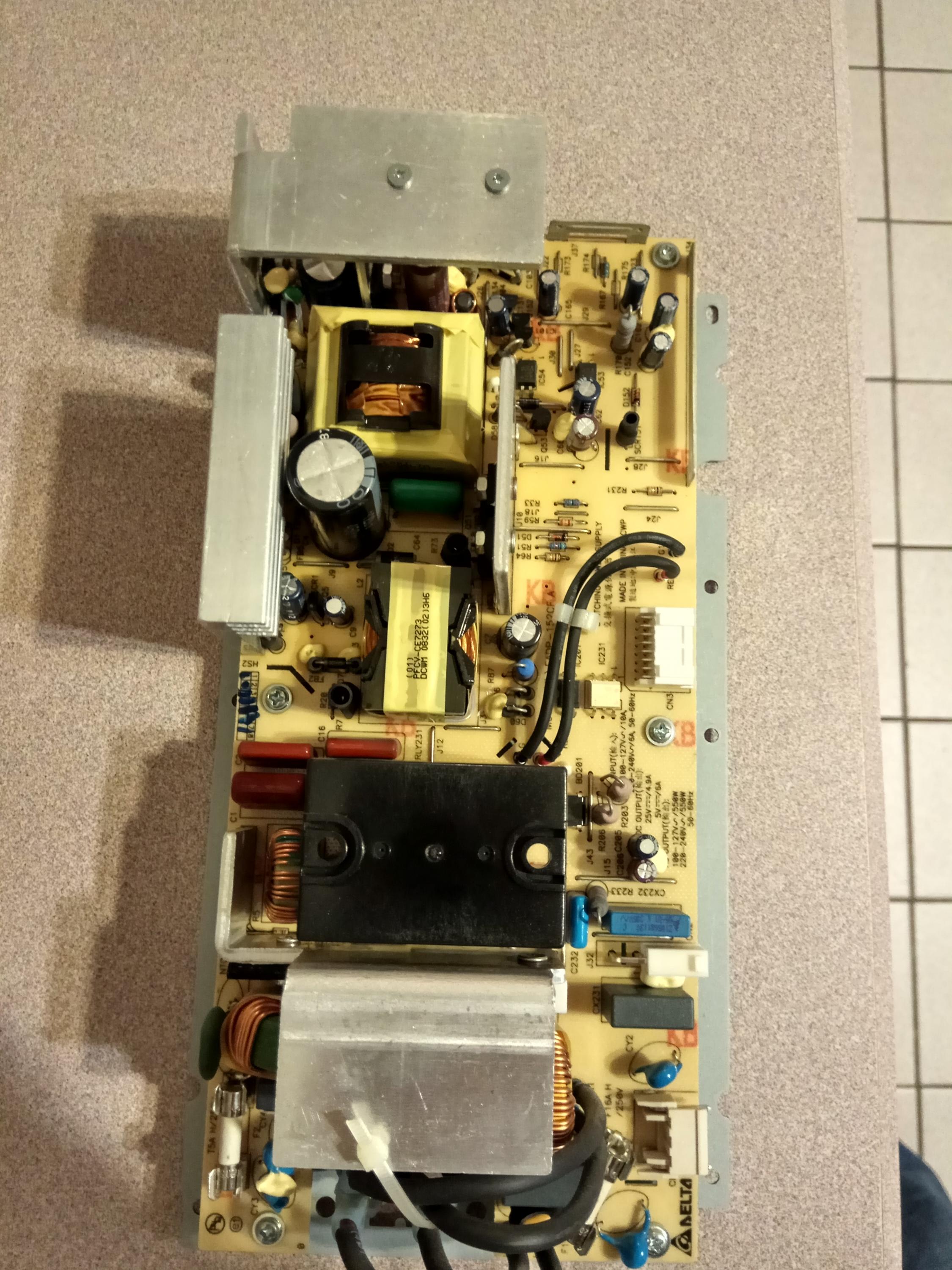

    Lexmark Laser printer 544dn , loud fast clicking sound from the power supply, no power, but the 24V fan on the case was twitching and chirping, no power shown on LED indicators.
    I have replaced the large 450V capacitor, as it appeared to be the source of the clicking. Old capacitor was visually fine, no bulging that I could see.TaDa!
    Good news: now the unit powers on and works properly.
    Bad News: the power supply now makes an ominous cyclic buzz about every second or so.... Which makes me think that I didn't really solve the problem after all. Which is why I'm posting. If it wasn't the big CAP what was it? Am I just going to have to do this again in a month?
    On a more philosophical note: what is the name for that feeling which makes me want to spend 2 hours repairing this old laser printer.

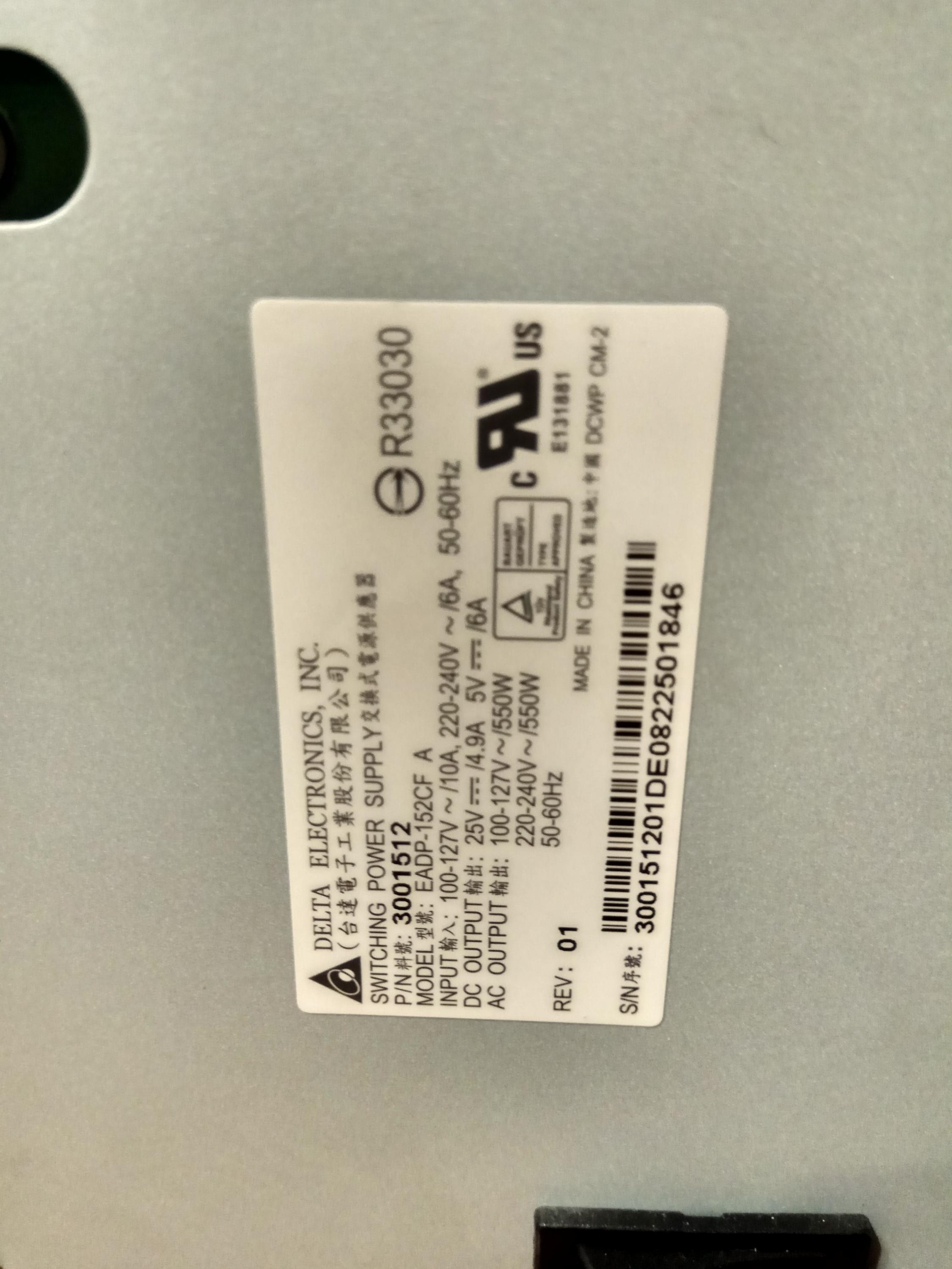

    Photos of both sides of the board and the serial no of the power supply.

    It sounds like the power supply is in startup/shutdown cycle. Are the 5V and 25V steady if there is no loads connected?
    What are the resistance between GND and 5V, GND and 25V when the loads are connected and not connected?

        I have repaired a few similar power supplies that had the main cap bad, basically open, and little to no bulging. I suspect the sound you here "ominous cyclic buzz " is because it is in standby, the power supply is in burst mode. it gives a small burst of drive just to keep the low current demand standby voltage working.
        I doubt you will have +5 and +24v untill the power supply sees the power on command from the main printer board,

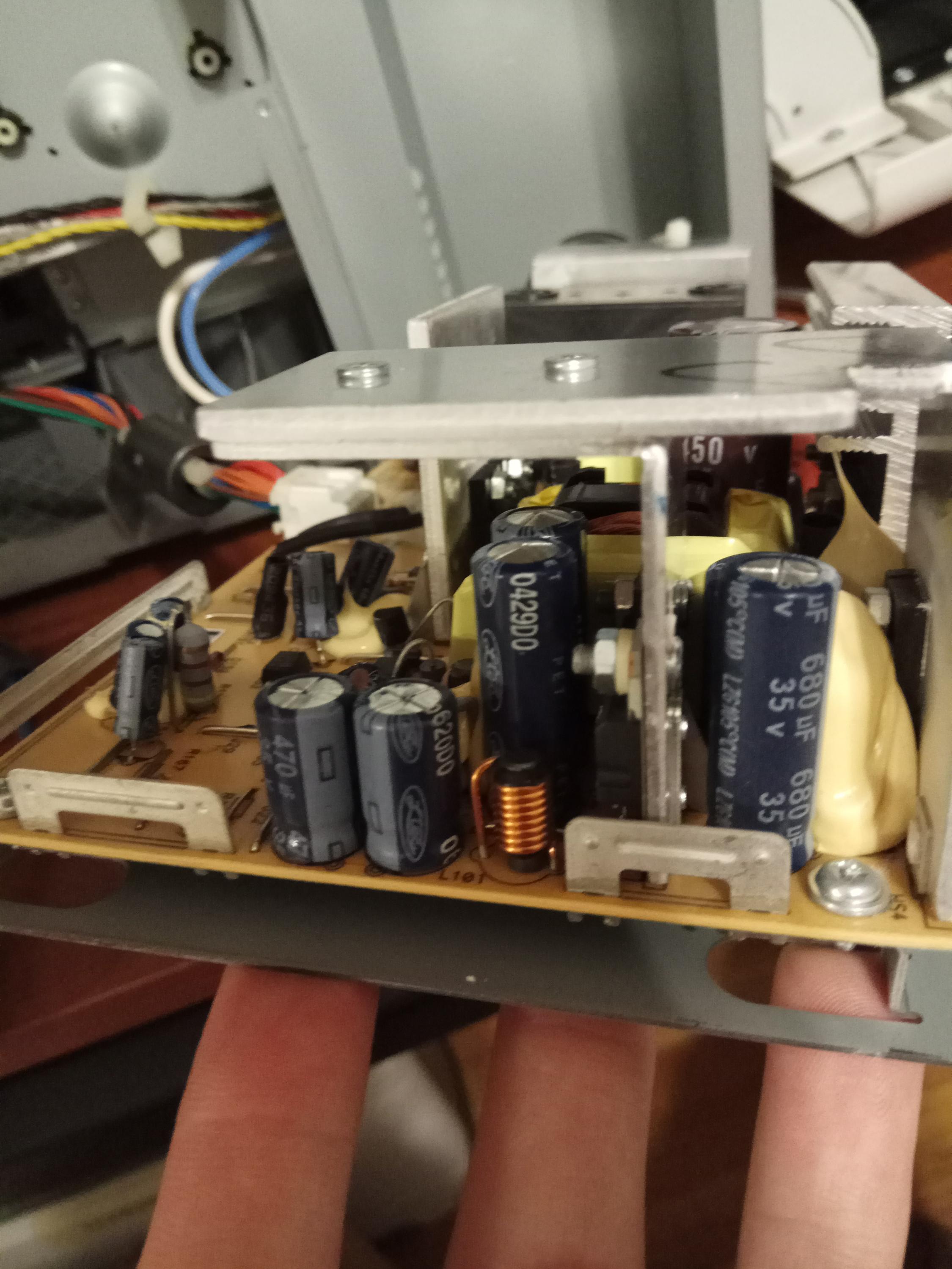

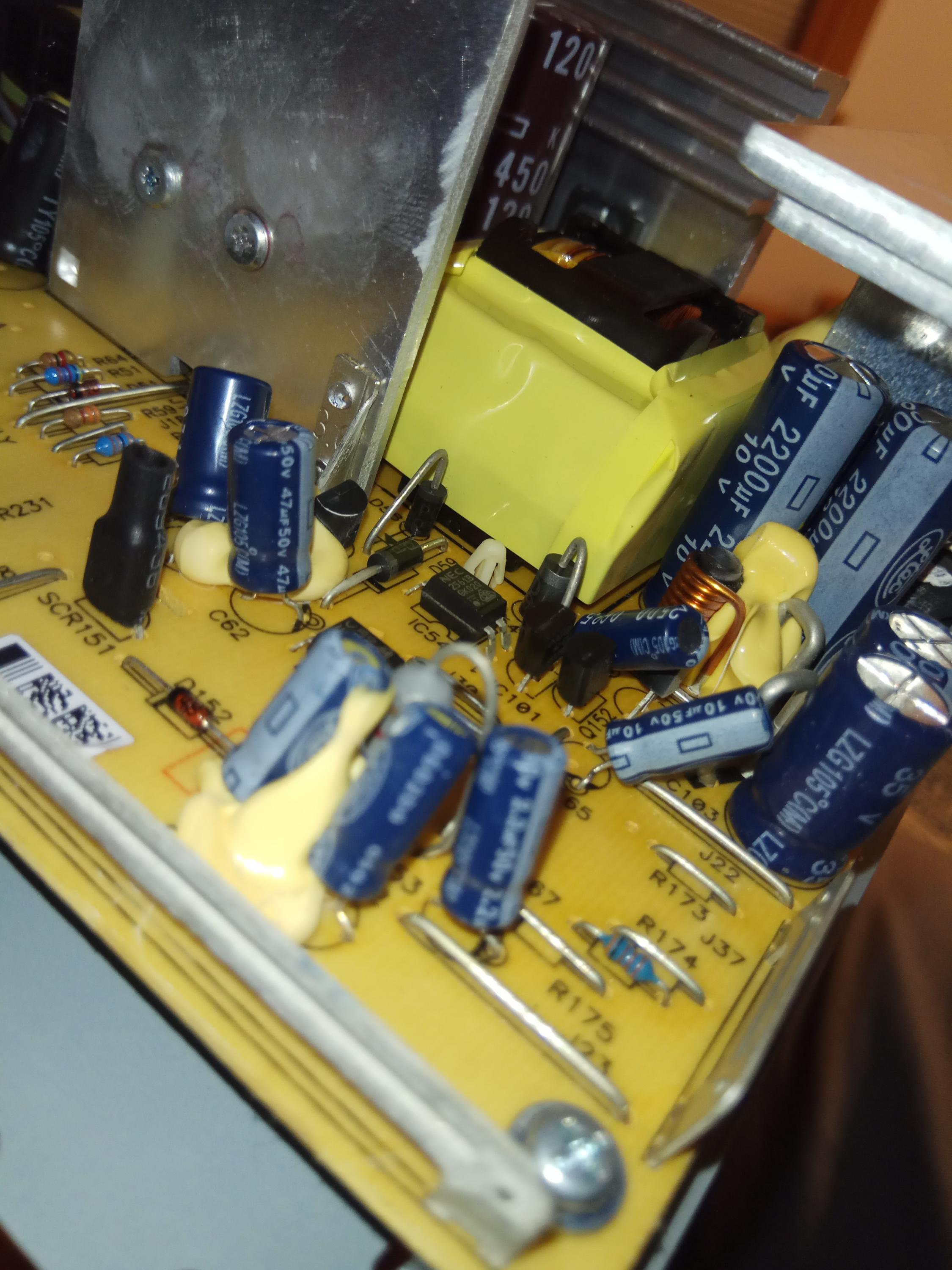

                    OK, tonight I opened the second power supply on the second unit which I will name Wanda to keep it from getting confused with the other identical power supply from the first post. Wanda is the, same model. Symptoms: dead no power on no lights, fan twitching and making a faint chirping sound.
                    Finding the voltages:
                    I went to find the line voltage for 5V out and accidentally picked the 120V in instead, and somehow shorted it to ground. Oh well, glad it was only $5 since now the leads are both melted on my multi-meter which I am obviously better off not using!
                    Anyway, this power supply does have bulging capacitors, but not the large one. Two smaller 2200uF 10V are both bulging on a nearby part of the board.
                    I said why not and replaced the big 450V cap anyway thinking it might allow the unit to power on. No dice. Unit is still dead while I order a set of these busted capacitors.

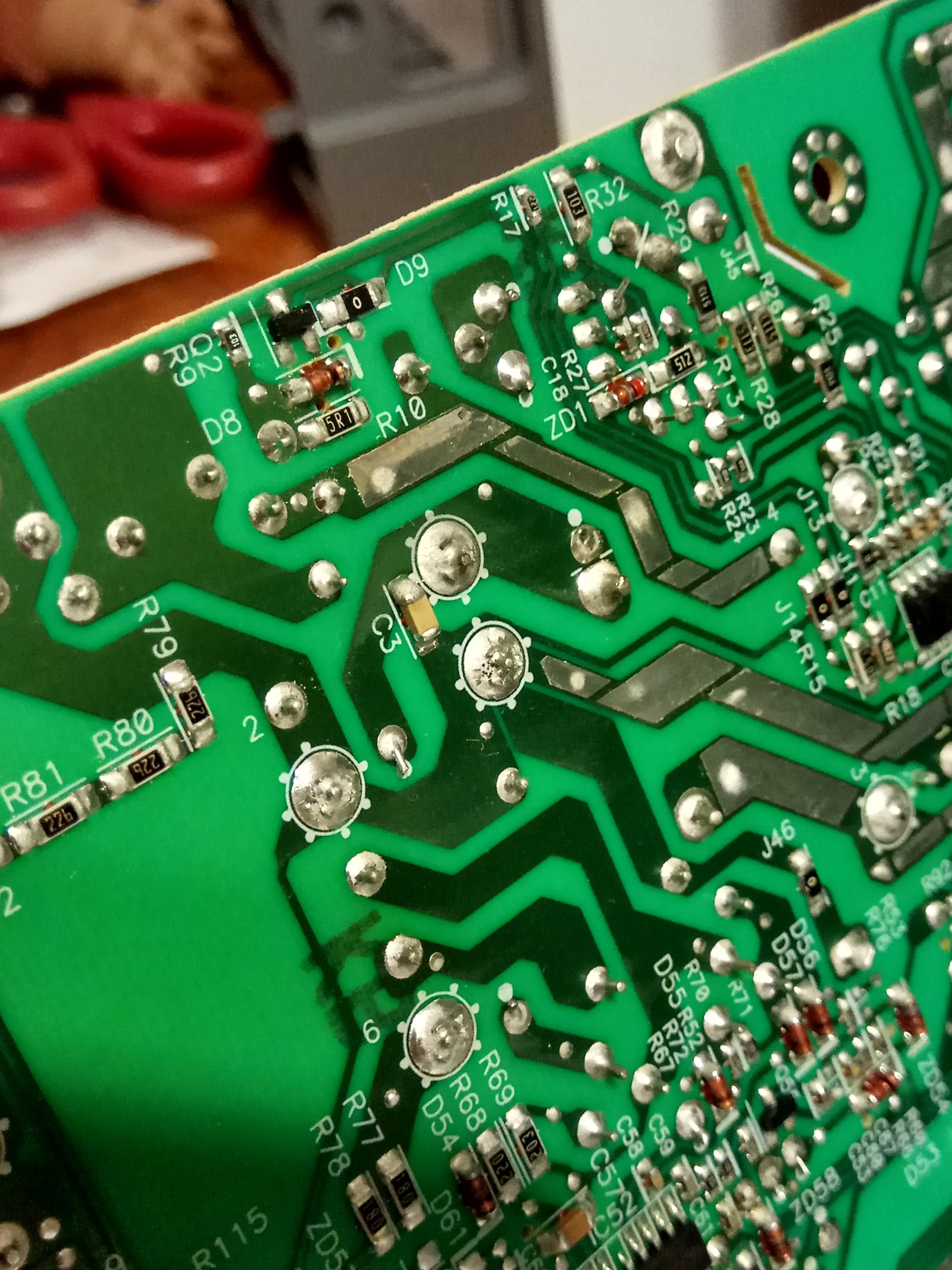

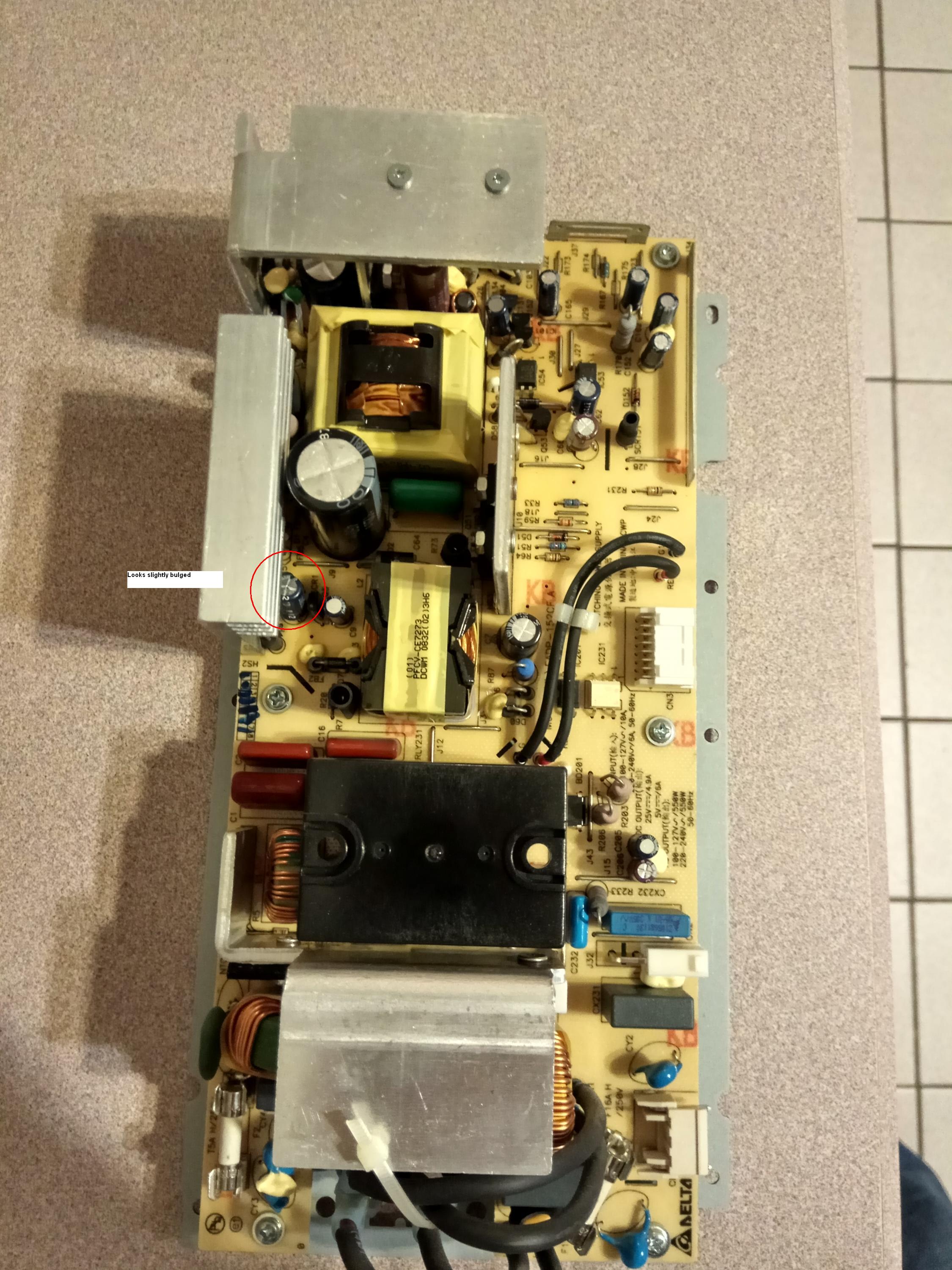

                      I rechecked the picture of the first power supply and there is a small cap that looks like it could be bad, hard to tell by the picture, but I circled it. It might be causing the odd sound.
                      As for the second power supply, are you getting any voltage across the large primary capacitor?
