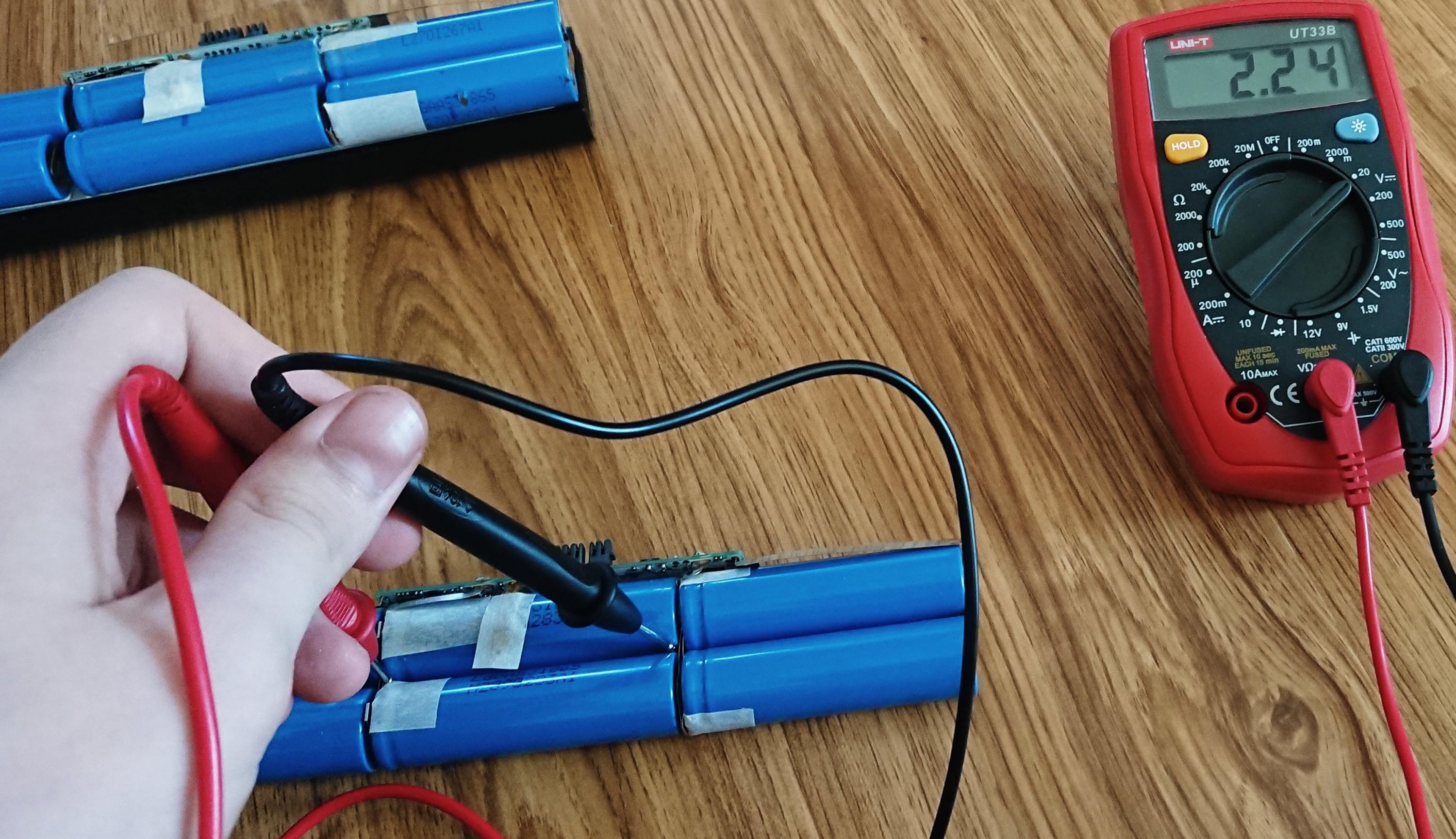

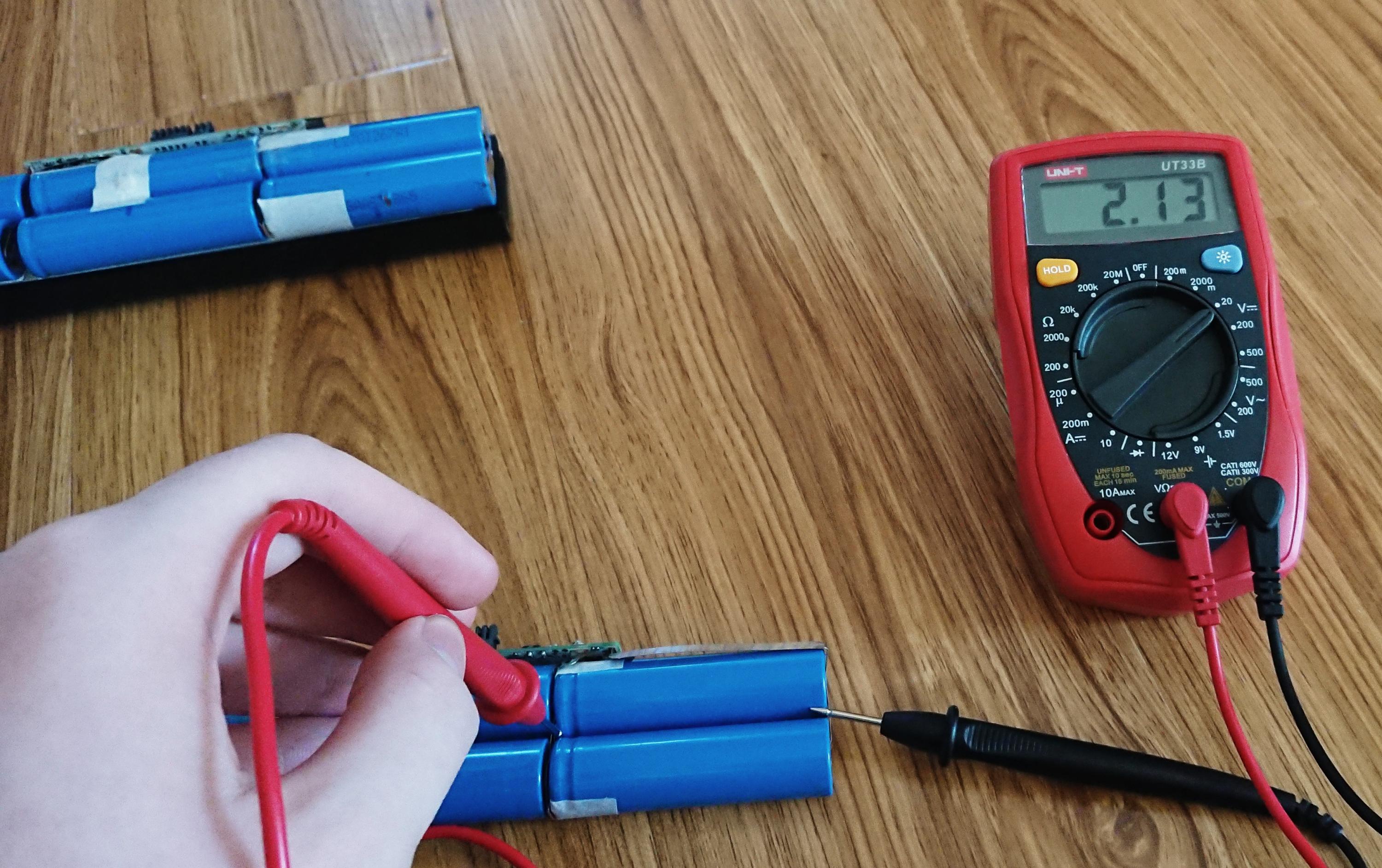

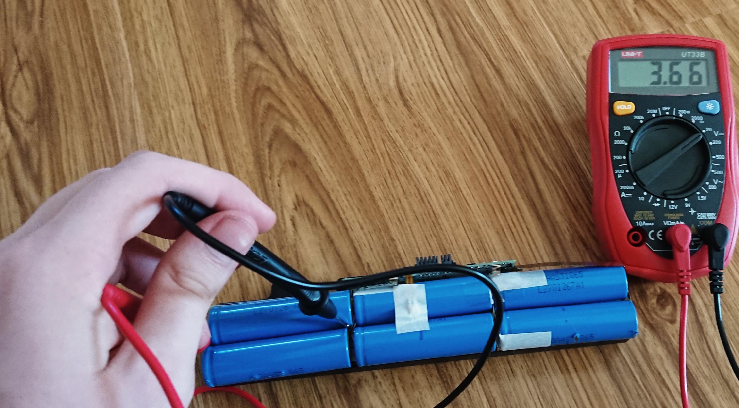

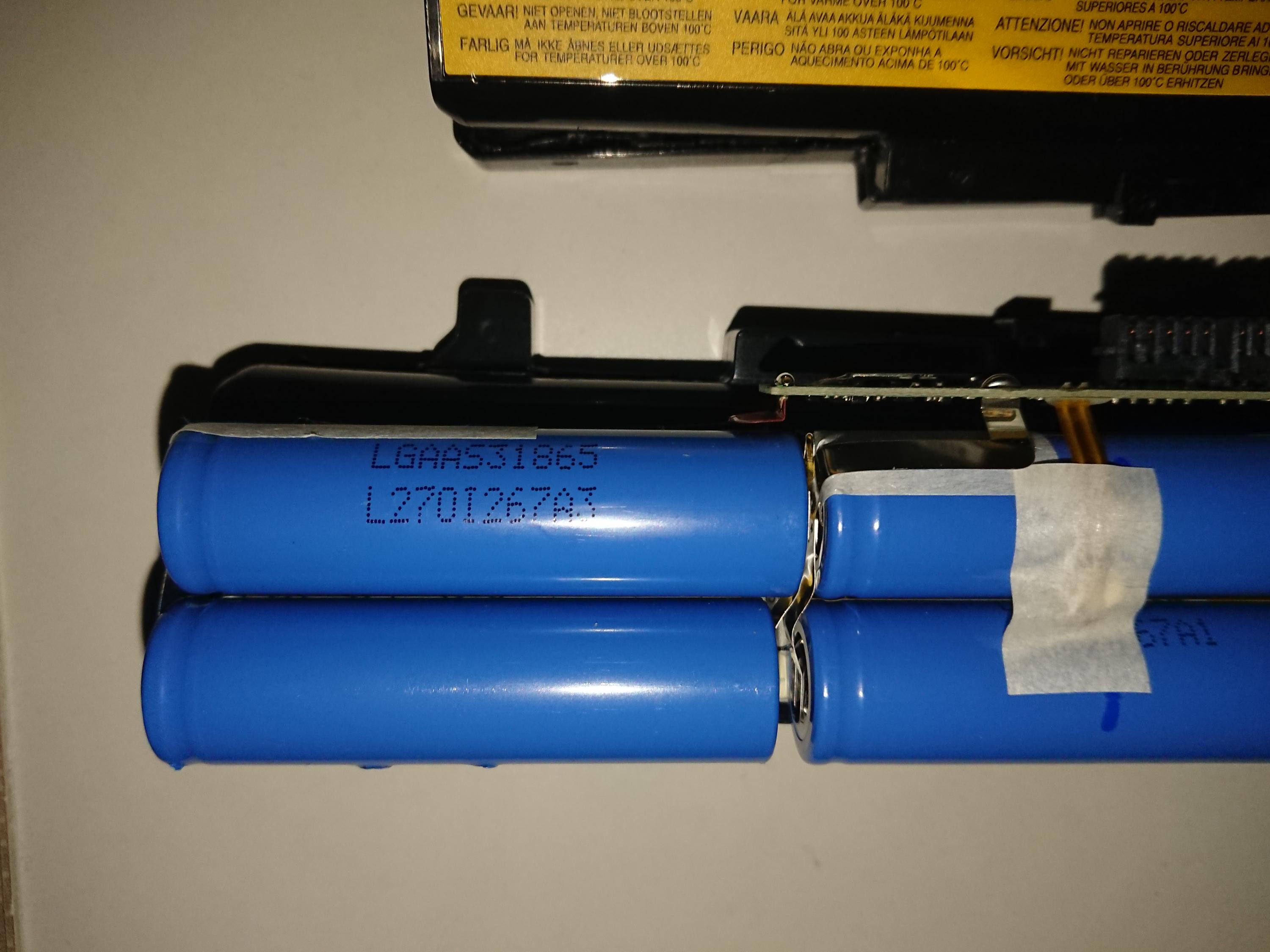

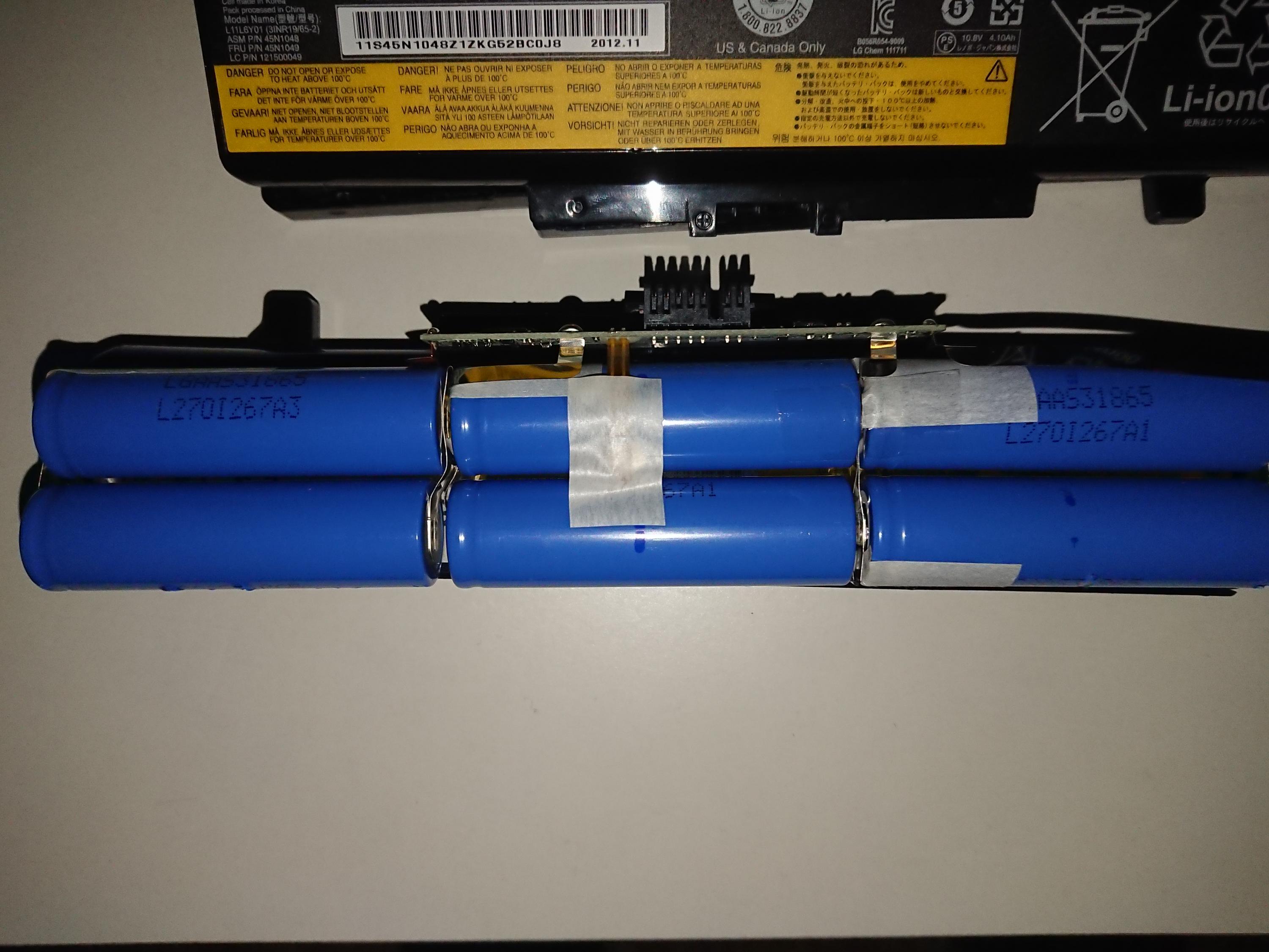

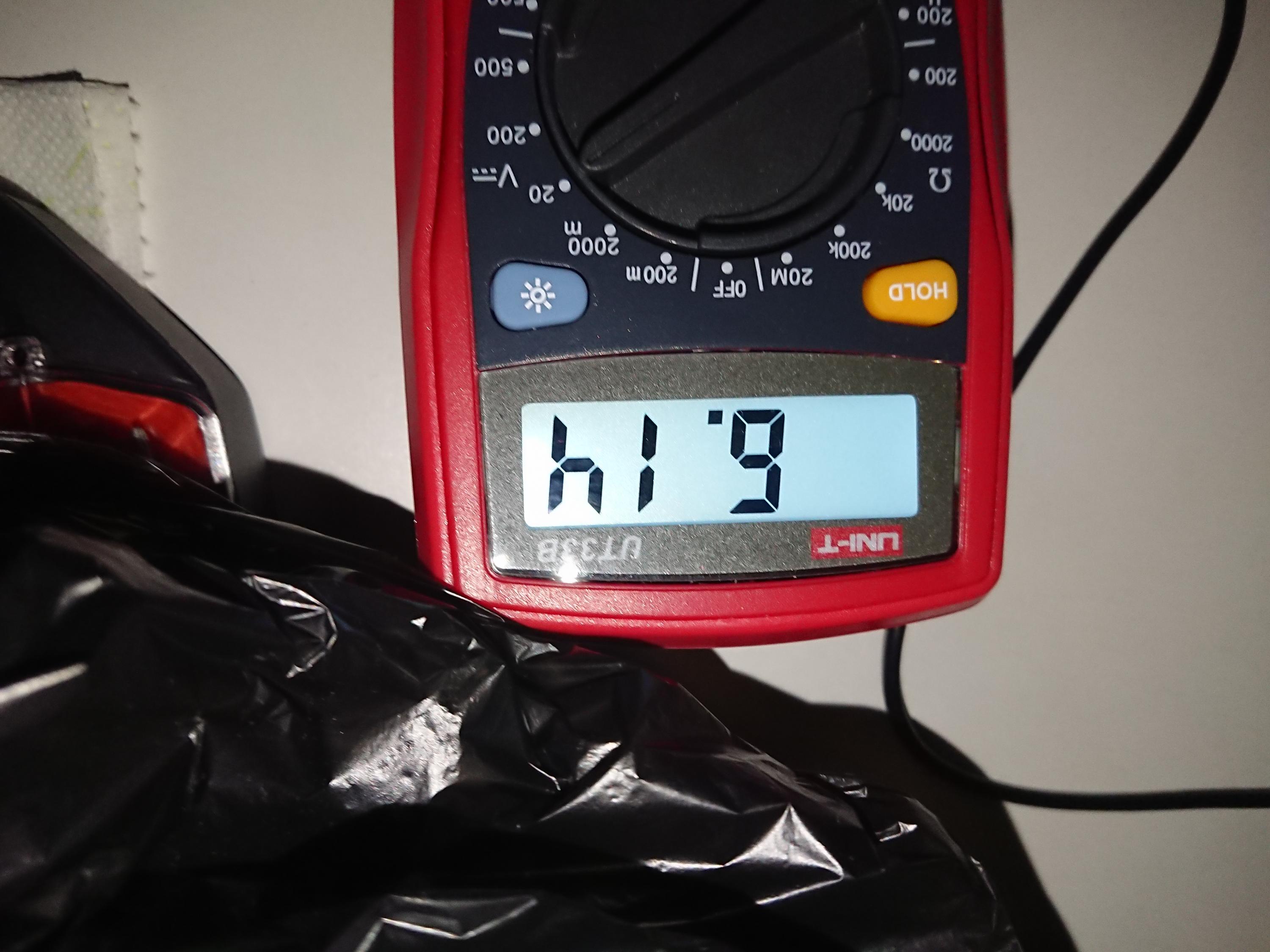

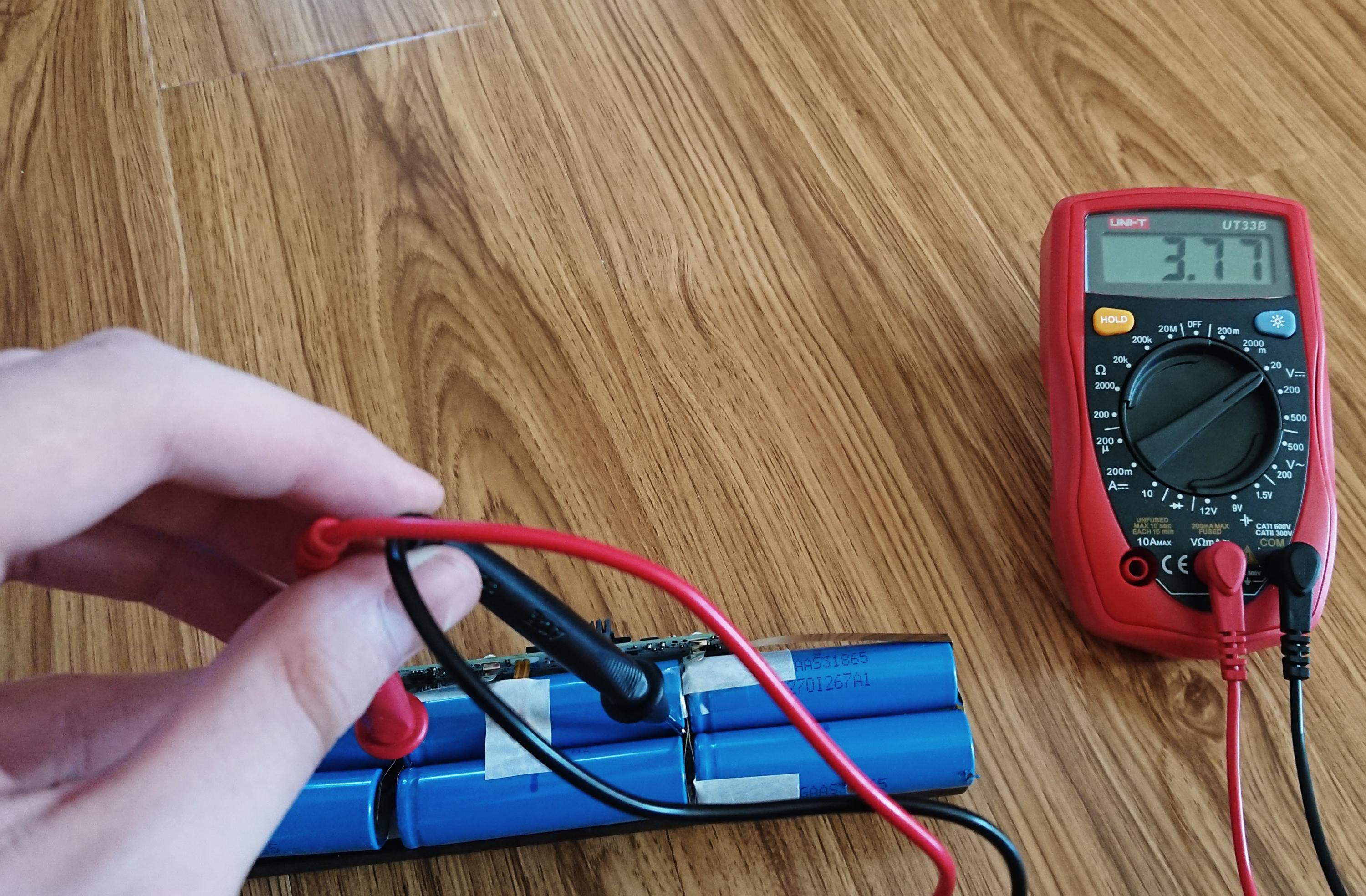

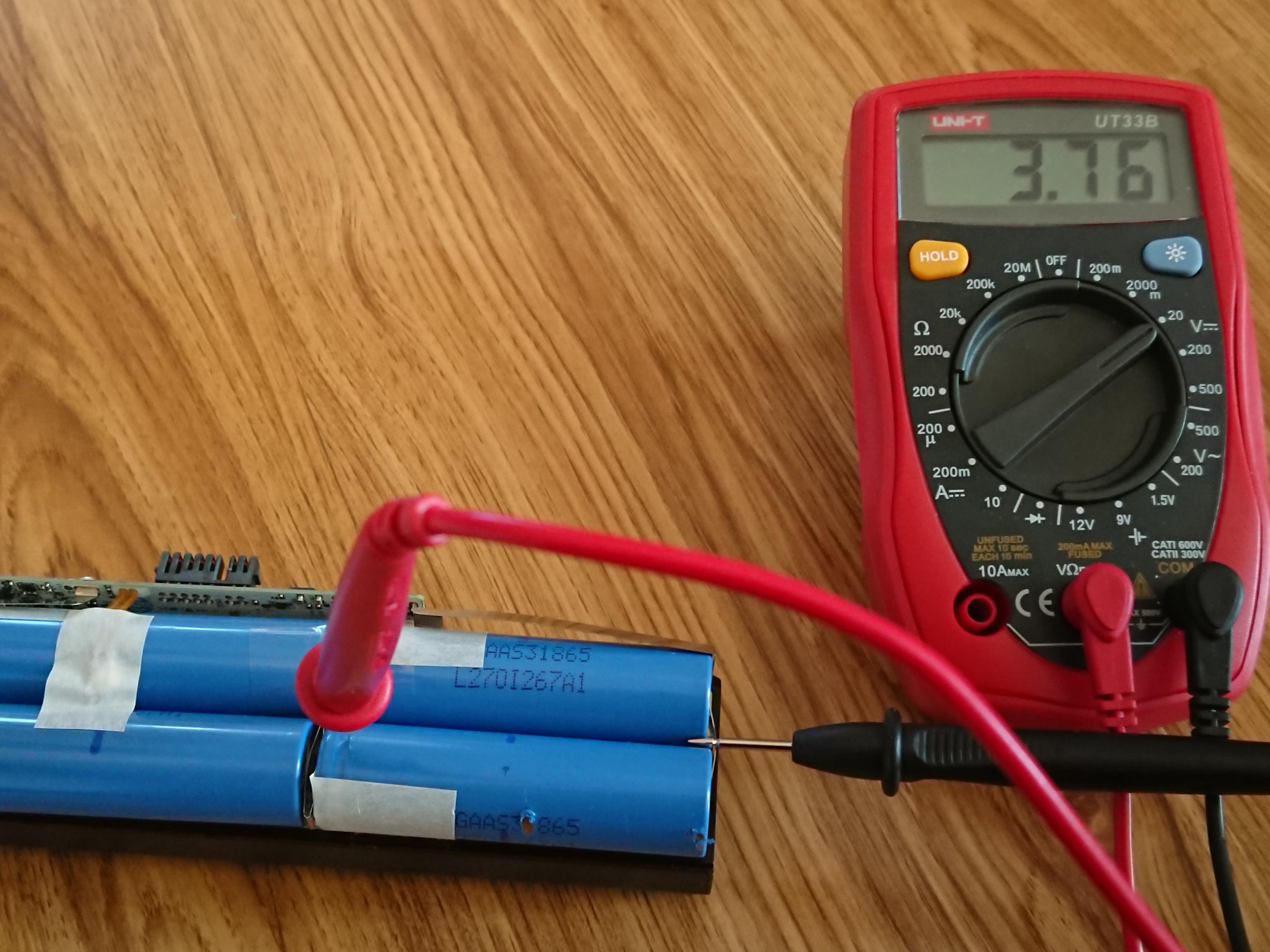

    Hi! So, today I took apart 2 laptop battery banks: both have the same specs on paper (10.8V & 4400 mAh), however one reads 5.8V and the other one 11.4V. The new one is the one reading 5.8V and the 11.4V one can't hold a charge for more than 10 minutes when used in the laptop it was designed to work in.
    What could be my issue here? I don't want to be swapping battery banks with a chance of blowing something up. The new battery bank has never been charged from what I know about it.
    Also, the new battery bank uses LGDAS31865 cells and the old one uses LGAAS31865 cells. They have the same specs, so..?

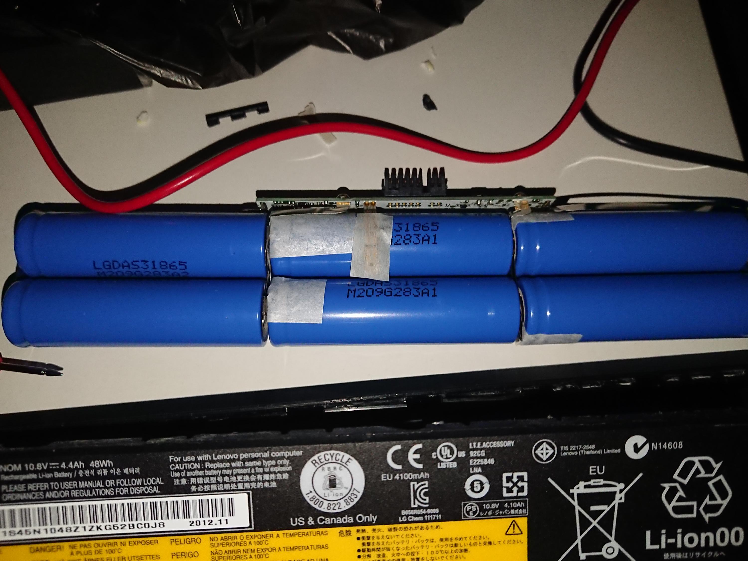

      Re: Battery bank made from 3 series of 2 parallel LGDAS31865 cells
      These are some images, the first three represent the first (old, 11.2V) power bank.
      The last two images represent the last (new, 6.1V) power bank.
        meter the individual cell-pairs.
        a common issue is one battery fails and effects the one in parallel with it.

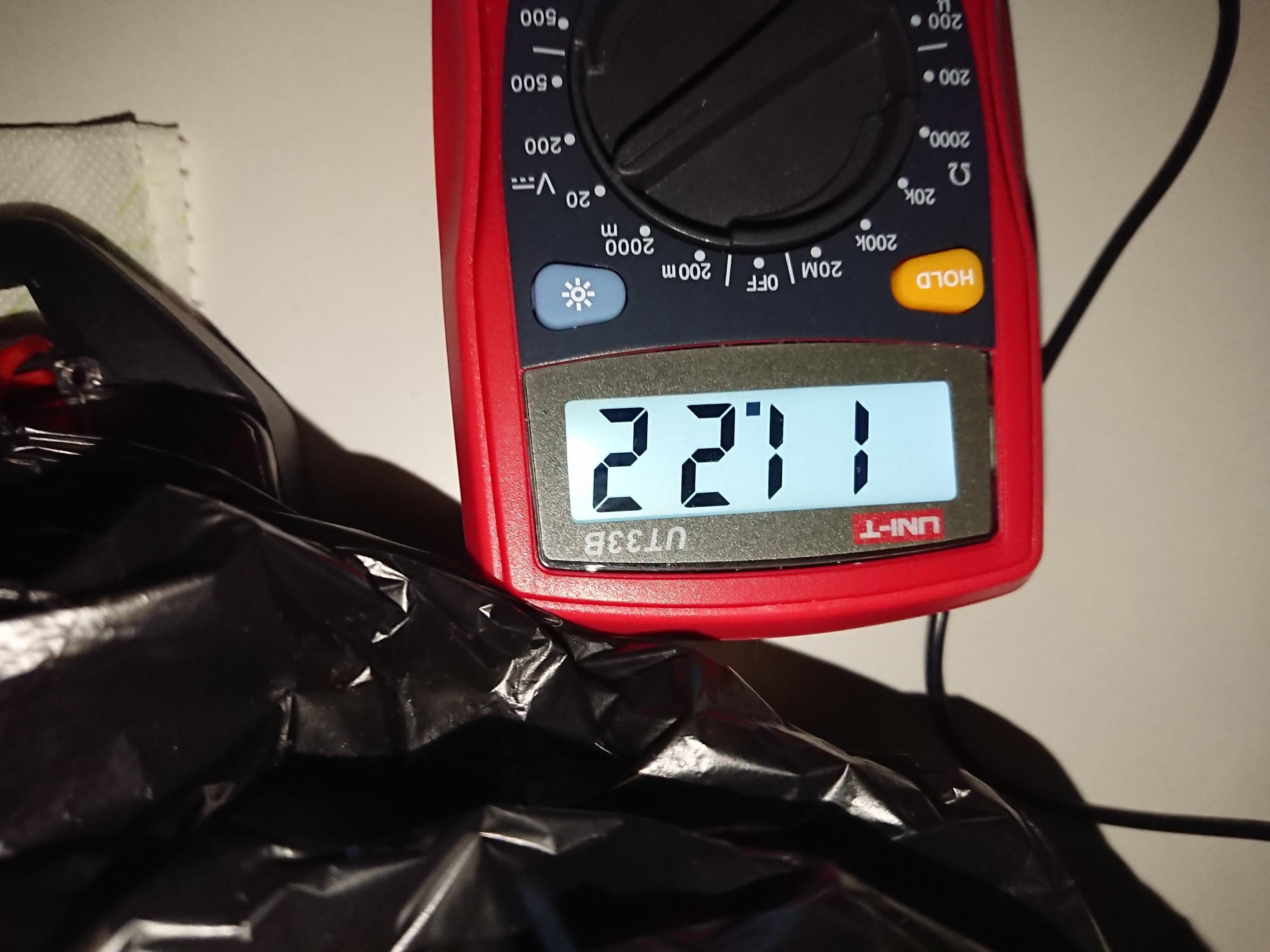

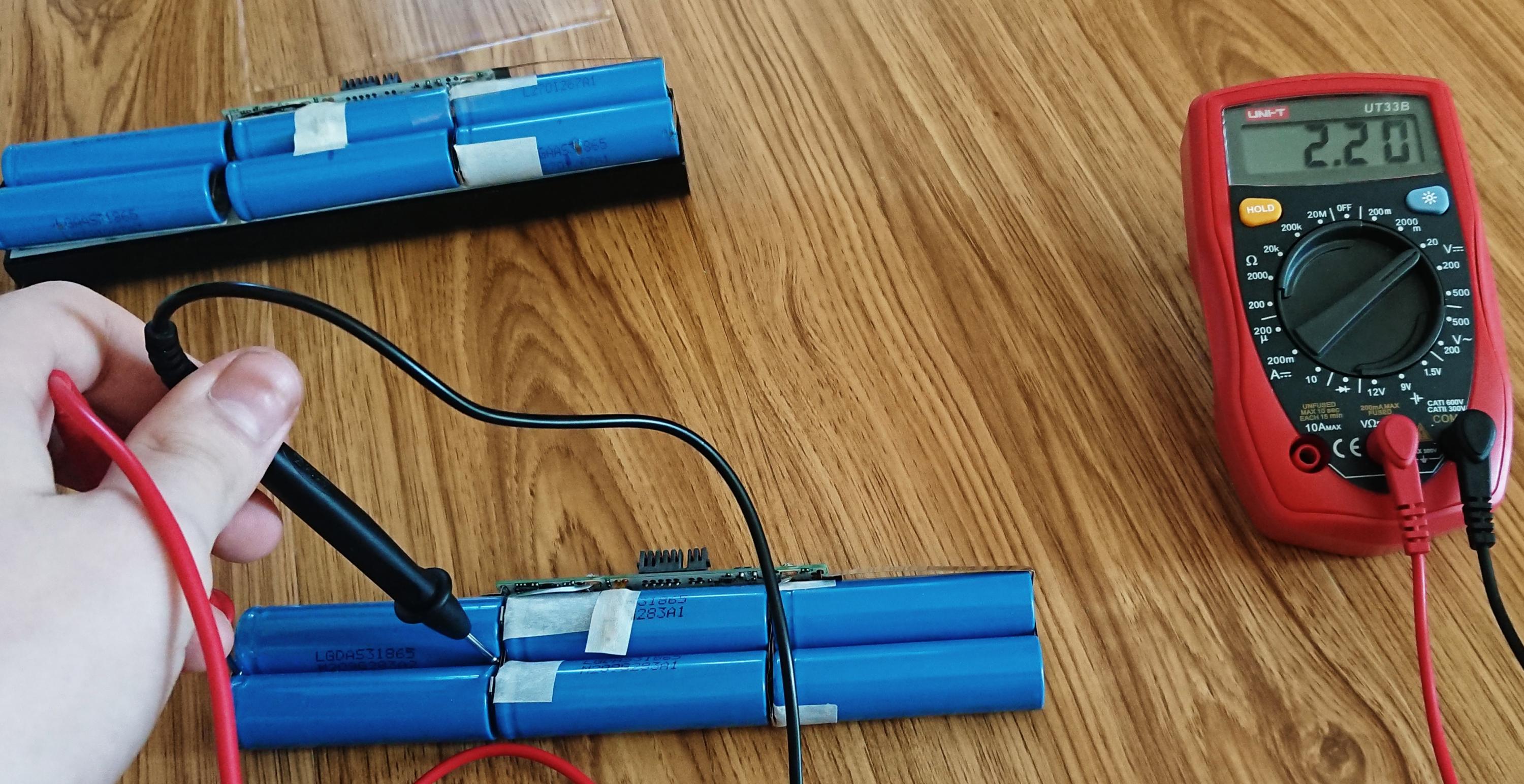

          I measured the pairs the first three images are with the old battery bank, the last three, with the new one.
            • 31161
            good,
            the fact that all the pairs match indicates they are o.k.
            just give them a good charge.
            if one pair had been under 2v it would have been a problem.
              And this should get them to their nominal 3.6V?
                • Jul 2011
                • 6059
                That depends on protection board it has some of them will not charge the batteries if the voltage is below a certain point
                Here is how you can check if this is the case or not put the battery pack on charge —> IF YOU CAN leave the back part case off —>only do this if you can get the battery pack back out the computer
                With the battery on charge does the voltage go up in value if does then you are good to go —>
                After the batteries finally finished charging then check each set of batteries for there battery voltage are they all the same which means are they all 4.something and the something the same if not then either batteries have issues or the battery protection board has some kind of issue
                It more than likely that the battery set has some type of issue meaning that the batteries might become heater cells if the voltage can not get to 4.2 volts if you kept trying to charge them until they reach 4.2 volts if this is the case you need let us know there is a difference set of instructions on how to deal with this —>this would explain why your running time is real short
                Charging voltage does not go up
                If it does not then you will have do the following but be careful with what I going to tell you next
                You need to make SURE that you have the positive terminal and negative terminal are marked on each battery before you start —> make sure that the battery positive terminal goes to the positive terminal on your power supply and the battery negative terminal goes to negative terminal on the power supply
                If you have a adjustable power supply go to the next step
                If you do not have a adjustable power supply do not do the following until you have one
                You can do the following
                Set your power supply at 4.2 volts @ 500 milliamperes and change the battery until the battery voltage reaches 3.2 volts do this on each set of batteries
