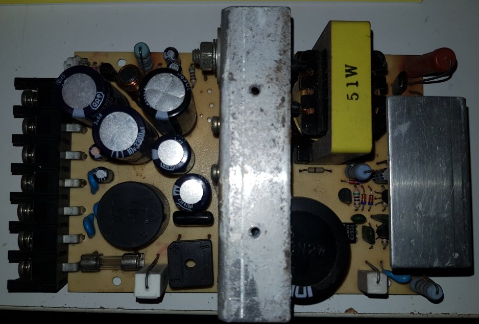

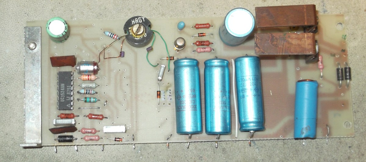

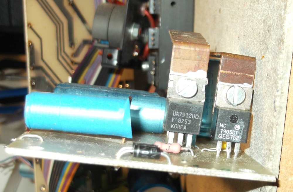

          VSN-011 Arcade Power Supply (+5V/7A, -5V/1A, -12V/1A)
          All capacitors are QRT brand unless otherwise noted.
          100uF 400V Chemi-Con primary side filter.
          3300uF 10V x2 before +5V inductor with 3300uF 10V after it.
          470uF 25V before -5V regulator (7905) with 10uF 16V after this regulator.
          470uF 25V before -12V regulator (7912) with 10uF 25V after this regulator.
          2SC3153 primary side switcher and BR36 input bridge rectifier.
          FR304 rectifiers for negative rails with 15FWJ11 rectifier for +5V rail.
          Creepage between primary and secondary sides seems a bit too close even though the secondary is meant to be grounded (ignore the crack on the board in the corner).

            That Sharp PC613 seems to be an optocoupler. The 2SC3153 is a BJT designed for use in switching power supplies, and rather beefy (6A) for just 51W or 52W (as are the heatsinks). The BR36 is rated for 3A, overkill again. The lack of an output inductor suggests this is a self-oscillating flyback design. The BJT switch places the switch frequency in the 20KHz-30KHz range.
            I couldn't see any date codes, but that layout looks like it was done with tape on vellum rather than CAD. So I'll guess it's early-mid 1980s vintage. It has no safety marks and minimal EMI filtering (there may have been filter components elsewhere in the system), which is consistent with the close primary-secondary spacing.

              Looks pretty well built for its power rating. Classic flyback design, as PeteS noted.
              The vent-less radial caps also give that away, I think. Most early 70's gear, at least from my limited experience, seems to be done with axial caps and very few radials. In the 80's, radial electrolytics became more popular. But they were still vent-less for the most part. On that note, I got some old AT/XT PSUs off of Craigslist (looks like mid-80's stuff, too) and they appear to be built in a similar way. Going to post them when I sort through the pictures.

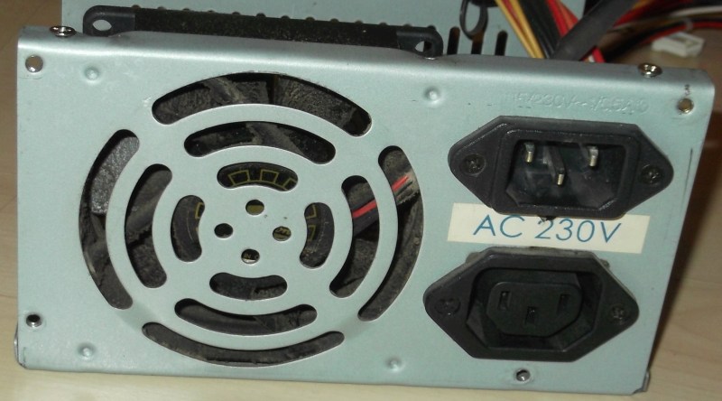

                  Sector IBP-200-N AT power supply from '97-'98. Young Year OEM model IBP-42c REV 3.
                  Maybe it should go to the guttles topic due to all the corner cuttings and missing parts in construction.
                  Fan is using some clamp cutouts to be held in place.
                  No EMI filter, just two unrated ceramic caps.
                  Bifilar coil traces are bridged.
                  No inrush current limiter. Traces bridged.
                  No bridge rectifier just some diodes tangled together.
                  Genuine 105C NCC primary caps!
                  13007 primary swithers in To-220F capsulation bolted to the housing.
                  No dedicated heatsinks for the primary switchers nor the secondary diodes.
                  Transformer is EI type 28 size.
                  494 PWM controller.
                  D83-004 rectifies 5V bolted to housing.
                  5GG2C rectifies 12V bolted to housing.
                  Missing PI coil on -5 and -12V rail.
                  Some transistors for secondary protections and power good generation.
                  Lot of smd passives.
                  18AWG wires.
                  There is space for bigger main trafo and output components... even the EMI parts can be built in.
                  I'm going to keep this unit since the distributor was one of the infamous firms in the country offering super low end and high end parts both during the 90's.

                    Yes, 100%.
                    I know it's an old *AT* PSU that probably would never see such high loads on its rails... but it's still a turd. If they at least mounted the primary and secondary-side silicon onto some minimal heatsinks, I'd say it's a passable AT PSU.
                    Proves that old stuff doesn't always mean well-made, I suppose.
                    Also proves that crap manufacturers will always be crap.
                    LOL.
                    My guess would be that cheap crap caps weren't just as widespread back then, so PSU manufacturers often had to use Japanese ones. I have an old Leadman (the manufacturer of PowMax) with genuine NCC/United Chemicon caps too. Of course it's still a crap PSU otherwise.
                    In that case, I hope you have some time to rebuilt it (i.e. add all the missing parts and definitely attach those rectifiers and BJTs onto some heatsinks - I just can't bear to look at them "naked" like that.)

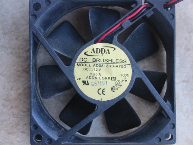

                          Last but not least, a fan label shot:
                          https://www.badcaps.net/forum/attach...1&d=1541734913
                          It's an ADDA model AD0812HS-A70GL, rated for 0.25 Amps at 12V. It spins well. Then again, I don't think it has seen much stress. Reason I say this is because the PSU has a temperature-dependent fan controller that runs the fan at only about 4 to 4.5V @ 20°C room temperature. I tried playing with a potentiometer hooked across the NTC thermistor on the heatsink, and I couldn't get the fan to budge past 6V. I think this PSU may require a fan controller mod too, but more on that in another thread. Here is the fan controller circuit, by the way:

                                    IMB PC compatible power supply from the late 80s Hungary.
                                    75W total power. Currently not functional. I dissasambled it and several parts proved to be faulty.
                                    The construction and parts used is very reminiscnet of the era.
                                    There are some "western" parts since analogs were too difficult for cccp to produce so it had to be licensed or bought if possible...
                                    Some 220V line emi filter parts:
                                    Siemens 2x47nF capacitor in some sealed and rounded barrel type enclosure.
                                    Bifilar choke of unknown parameters.
                                    5Ohm NTC for current limiting.
                                    Primary:
                                    Discrete 2Amp diodes forming a graetz bridge.
                                    2x350V 100uF input buffer capacitors.
                                    BU326A primary transistors in To-3 package.
                                    UC3524AN pwm controller.
                                    Aux:
                                    On a seperate board a small transformer and some diodes, resistors, capacitors.
                                    Also on another board the feedback circuit consists of a small transformer and some passives set up around the main pwm. On the other side some of the secondary output capacitors and the negative voltage rail regulators are located.
                                    Main transformer as an EE core 35mm type.
                                    Secondary:
                                    5V: Rectified by BYS28-45 in To-247 package.
                                    12V: Rectified by BYS254-45 in to-220 package and fed to two 7812 regulators.
                                    The positive voltage outputs have seperate current stabilising coils.
                                    -5V: From a separte transformer tap a diode rectifies then feeds an 7905 regulator.
                                    -12V: Same tap connected to another diode that feeds an 7912 regulator.
                                    KT206/400 thyristor is used as an overcurrent/short circuit protection/crowbar.
                                    There is a full aluminium Sunon fan running on 230V AC.
                                    Electrolitic capacitors are MM/Videoton brand of various types. Most of them are still holding up. Some of the small polimer ones are shorted. Ceramics are ok. The 5V and 12V snubber circuit resistors are a bit cooked.
                                    I'm planning to fix this unit and and see how it performs

                                      Wow, we've come a long way with switching power supplies since then.
                                      Be careful before applying full voltage to any of the original electrolytic caps. They all likely need to be removed and reformed separately. Otherwise, I'm pretty sure they are still okay, as old caps have thicker aluminum foil plates, and thus tend to hold up okay even after a long time. Electrolyte probably isn't in the best condition, though, so they might be a little "leaky".
                                      I'm also surprised only "350V" caps were used for the input. That's obviously cutting it a bit close, as a 230V AC line comes out to about 325V DC.
                                      Anyways, really cool PSU. Keep us posted how it goes with the repair.
                                      • PeteS in CA
                                        • Aug 2005
                                        • 3581
                                        • USA, Unsure of Planet
                                        #2979
                                        Wow! That almost looks like it was hand built by a hobbyist! I started working with switching power supplies in 1980, and I'll just say that what was produced by Boschert and Astec around that time looked much nicer. Boschert's XL75 (75W) was a discontinuous flyback design. The 3524 type PWM was usually used for half bridge or full bridge designs.
                                        Silicon General's SG3524 and TI's TL494 were probably the first PWM ICs on the market, starting in the mid 1970s. The panel displays in the first generation F/A-18 Hornet used military versions of the 3524.
                                        PeteS in CA
