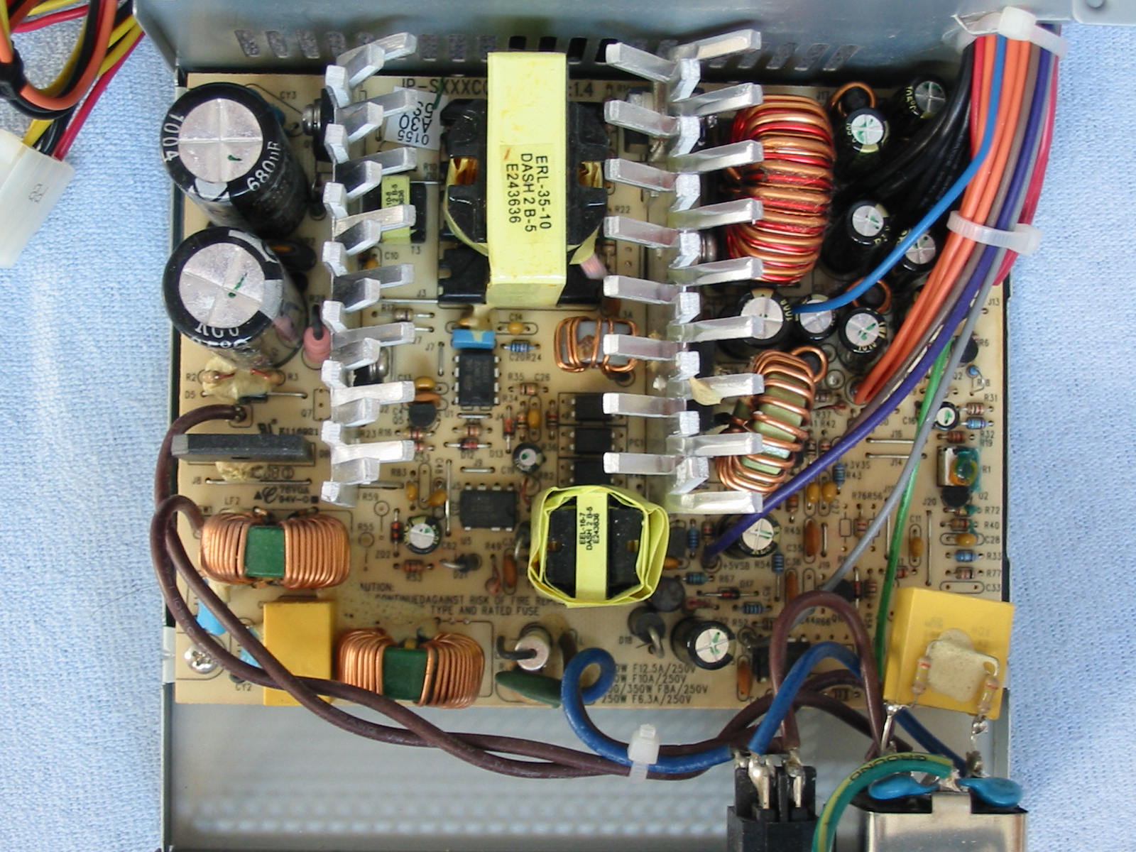

    ^ Cool Antec DC-DC converter board. Looks like it takes something along the lines of a 90W+ laptop power adapter (19-20V) and outputs some standard ATX 2.0 voltages. I like the cap choices too. Only thing I don't like is the black PCB! *sigh*
      Well, I don't because its the older, higher ESR KY (for a low ESR) series, not a low impedance one IIRC.
      So I'd like to see more modern cap choice with lower ESR like KZH or even KZE
      And a modern approach would be to use polys all the way on that PSU...
      But this PSU Design is rather old as well. Its already 6 years and should have been modernized a year or two ago...

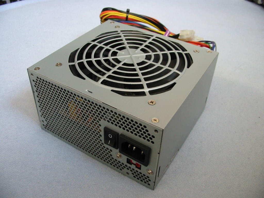

              Here’s another plain gray box: a Power Man IP-S400CQ2-0 [v1.4] 400 Watt ATX power supply.
              https://www.badcaps.net/forum/attach...1&d=1537354702
              It was only lightly used and discarded due to an upgrade at the shop I used to work at last year. Seemed like a waste to let it go like that, even though it is only a 400 Watt unit (for most of my PC builds, this is more than enough, considering I still get by with 300-350W units, or less on rigs that don’t have high-power GPUs).
              Label shot:
              It states two 12V rails (one at 18A and one at 16A) with a combined total power of 300 Watts (25 Amps) – not bad. 5V rail is quite weak, but that’s normal for a more modern unit. Speaking of which let’s move on to the innards.

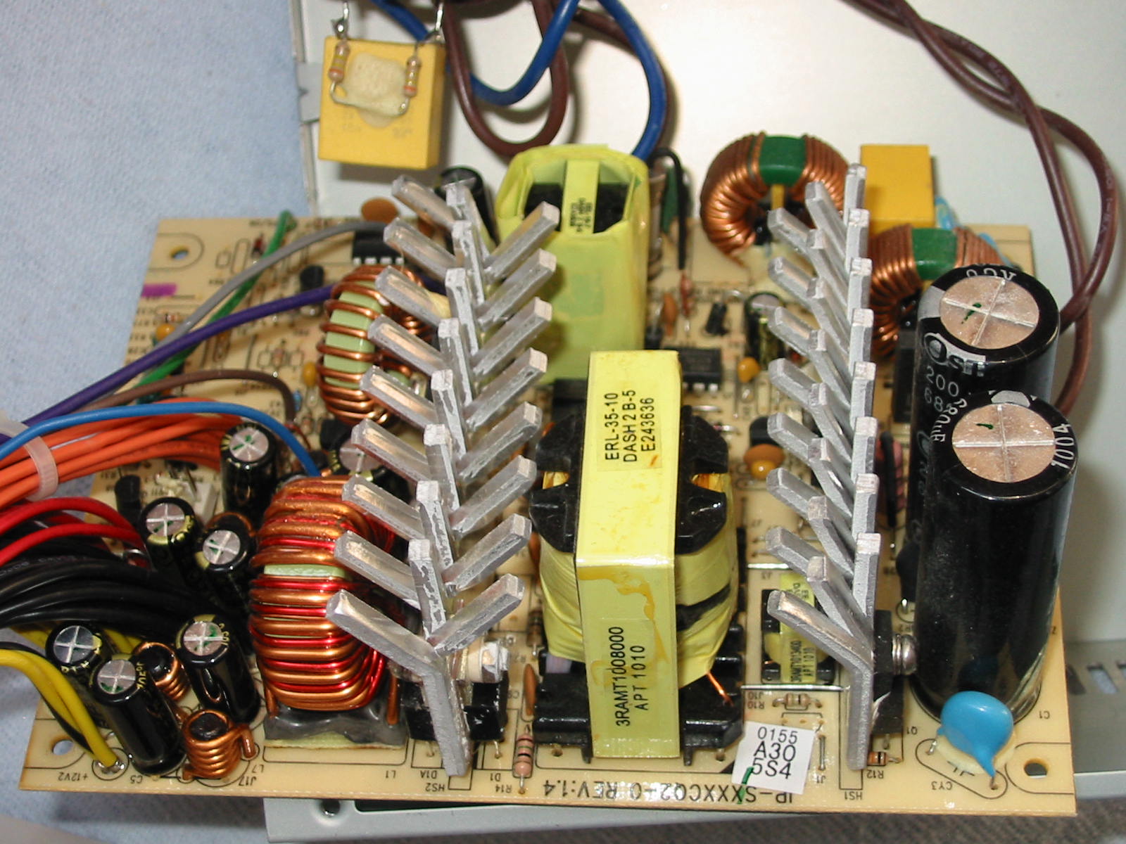

              It looks a bit skimpy at first sight for a 400 Watt unit: 680 uF primary caps, 35 mm -wide main transformer, and the heatsinks are a bit on the small side. I’d say it looks more like a 350W unit. But Power Man / In Win generally make decent quality PSUs, so it probably can do its labeled ratings. A more detailed look reveals this:
              Right there, you can see the PCB is labeled for several units: 250W, 300W, 400W, and even 450W. So the PCB is probably perfectly capable of delivering 400W. These two pictures also show the controllers / ICs used in this PSU: UC3845b (by ST Micro) for the main PS section with a Weltrend WT751002 supervisor and an A6259H off-line PWM-FET combo for the 5VSB generation. This means the two TO-220 parts (a pair of 2SK3568 MOSFETs) are for the main PS, making it a double-forward design.
              Here’s another last shot of the primary side:
              Input EMI/RFI filtering is all there as it should be, but input wires are only 20 AWG (rated for 600V, though). 5VSB transformer has a 16 mm –wide core. Start-up cap for the 5VSB IC and also what provides power to the UC3845b IC is an OST RLG, 35V, 100 uF, 6.3x11 mm. The UC3845b controller also has another e-cap associated with it: an OST RLG, 50V, 4.7 uF. There’s also a bit of the organic tan glue that likes to turn brown/black and conductive over time. But there’s very little of it and it doesn’t appear to affect any major components’ leads on the primary side.

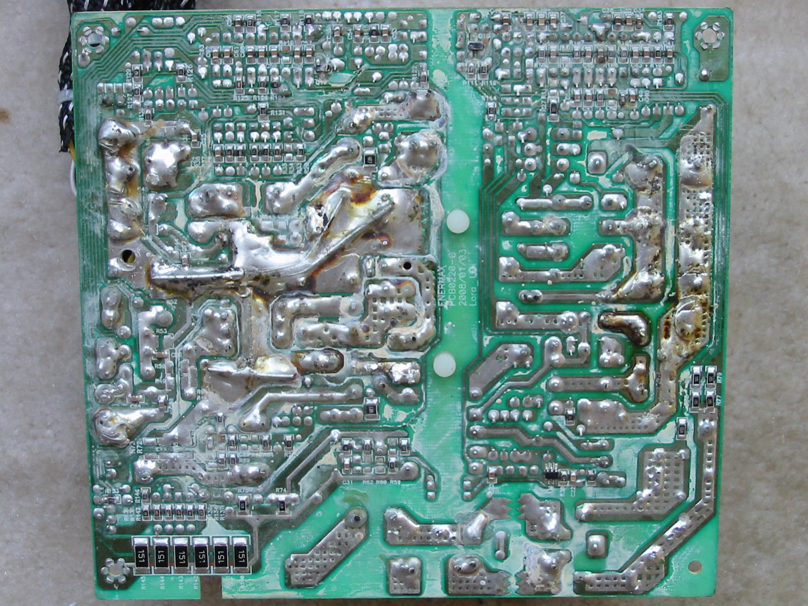

              Solder side:
              Nice and clean soldering with no SMD components (just the way I like it .)

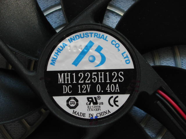

              And last but not least, for those who are fans of the fan shots:
              Just a regular (Muhua Industrial) 120 mm fan rated for 400 mA @ 12V. There is also no clear plastic cover on the rear-bottom side of the fan to redirect airflow, so airflow inside the PSU may not be that optimal.

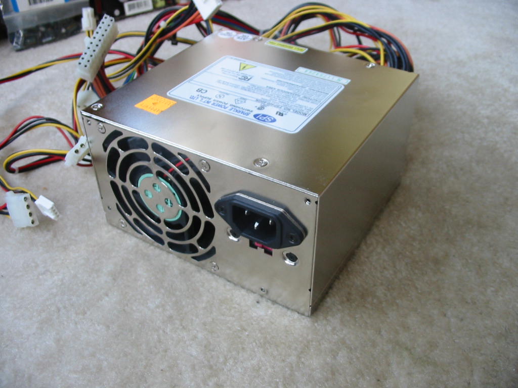

                                Sparkle Power Int. LTD. FPS400-60GN (rev 1)
                                Today I have something very shiny for you: a Sparkle Power Int’l LTD., model FPS400-60GN 400 Watt PSU.
                                This one came to me for recapping from a fellow forum member here, as he said he needed an old 3.3V/5V-heavy PSU for a classic socket 462 rig. Rated for 400 Watts with 235 Watts combined limit on the 3.3V/5V rails, I personally don’t think this PSU will ever break a sweat, even with the most 5V-deamnding rigs. Here is a shot of the label:
                                40 Amps on the 5V rail alone – not too shabby, yes? Meanwhile, the 12V rail gets only 15 Amps – which should be plenty for 6-8 HDDs on a classic rig, or perhaps a modern AGP video card, like Radeon HD3850. On that note, I don’t remember exactly how many Molex peripheral connectors this PSU has, but I think it was at least 7 or 8. The PSU has an older-style Auxiliary 3.3V/5V connector too, a 4-pin 12V CPU power connector, and two floppy power connectors – nothing extraordinary, I suppose. However, what’s neat is that the main 20-pin ATX connector has mostly 16 AWG wires (only exception is the 12V rail, 5VSB, and other minor rails/signal wires). The Molex peripheral wires are just standard 18 AWG, though. Only the 4-pin 12V CPU connector is a bit disappointing with 20 AWG-rated wires (so clearly this PSU wasn’t meant for a heavy 12V system, though it could be used with one).

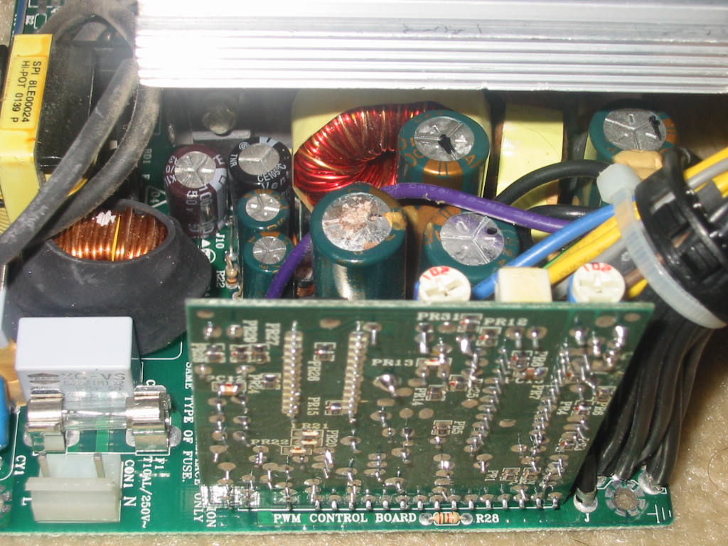

                                Moving on… I took the cover off to see what caps I would need for the recap job.
                                https://www.badcaps.net/forum/attach...1&d=1538492993
                                And there we have it: a bulged Teapo cap starring at me. With those big heatsinks and what appears to be also a double-sided PCB, I wasn’t so thrilled about recapping this PSU anymore. . Perhaps we should pause for a moment here and maybe give credit to cheapo low-end PSUs in this area – at least they’re easy to work on.

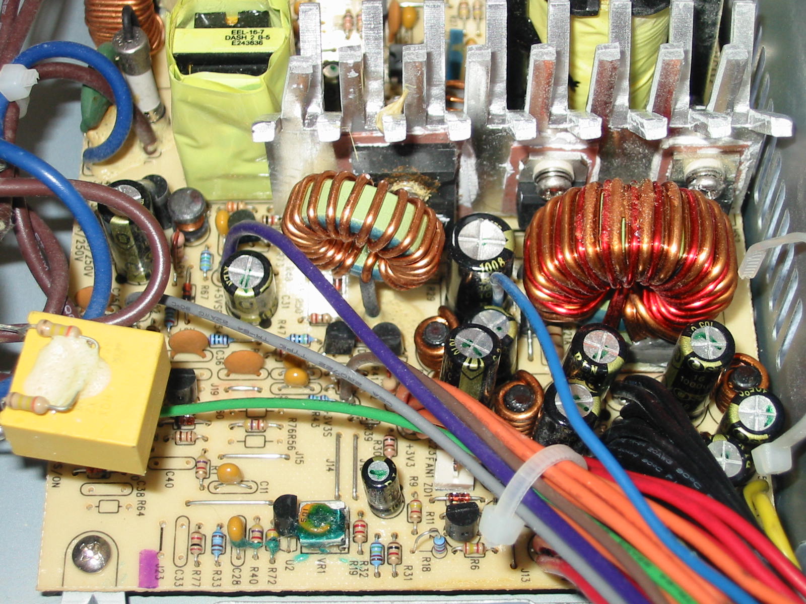

                                The output toroid inductor may not seem that big, but that’s only because it dwarfs in comparison to the output caps and because the 3.3V toroid inductor next to it is quite big as well.
                                On this picture, you can also see that the fuse is placed in a fuse holder and that there is a connector for the mains wires, making it somewhat easier for the PSU board to be taken out of the case.

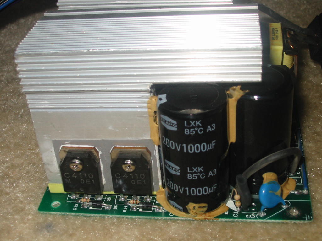

                                As for the primary side… not much to see there because of the large heatsinks:
                                … just two 2SC4110 NPN BJTs and two big Teapo LXK 200V, 1000 uF input filter caps. There is also a bit of that nasty organic tan glue that goes conductive over time. Fortunately, it wasn’t much. More importantly, it’s not splurged on component leads, so there’s no chance it will cause problems – which is a relief, because if I had to pull any parts out to remove it, this would have been A LOT more work. After all, the double-sided PCB in this PSU sinks heat really well. Even with my 75 Watt station, pulling the secondary caps out and cleaning the holes took a bit of heating.
                                Speaking of half-bridge topology earlier, here is what controls everything:
                                We have a KA3511 voltage-mode PWM controller chip and a TSM111 triple voltage and current supervisor. –Yes, this PSU has over-current protections. You can even see one of the current shunts on the second picture above, mounted (more like hacked) on the bottom side of the PCB.
                                On that note, next comes a shot of the PCB solder side:
                                This is perhaps the only place where Sparkle / Fortron didn’t do a great job (IMO). Not only are the current shunts terribly soldered, but also look at that wire hack-job. Aside from these two items, I have no other grudges against the soldering. You can see from the solder side that there are some unpopulated components near the input filter on the primary side. I believe some of these units come with an APFC circuit, as suggested by the “PFC Control Board” label on the other (top) side of the PCB in that area.
                                Last but not least, a fan label shot:
                                Despite the fan being a high-quality Nidec Beta SL D08T-12PU (2 ball bearing), running on 12V all the time (this PSU has no fan controller) made one of its bearings go bad. I tried opening and packing the offending bearing with grease, but that only made it quiet for about 5 minutes. After that, the bearing became really loud again. So besides a recap, this PSU needed a new fan too. I’ll save the details (replacement caps and such) for another thread, though. Meanwhile, here is a basic component breakdown of the PSU.
                                Primary Side
                                Primary RF/EMI filter: IEC filter, 1x 2.2 nF + 2x 0.22 uF Teapo XG-VS X2-class caps, 4x 4.7 nF Y2-class caps, 3x CM chokes
                                T10AL glass fuse, 15SP 2R5 inrush NTC thermistor
                                KBU1005G bridge rectifier, 2x MOVs (1x across each primary cap)
                                2x Teapo LXK, 200 V, 1000 uF, 25 x 45 mm (ø x h), 85°C
                                2x 2SC4110 NPN BJTs (TO-3P) for main PS (half-bridge)
                                Main BJT driver circuit caps: C7 & C8 (see info above)
                                Snubber network, main PS: RC-type with 47-Ohm 3-Watt resistor and 2.2 nF 1 kV ceramic cap
                                Transformers: 39 mm core (main); 19 mm core (5VSB); 19 mm core (BJT driver)

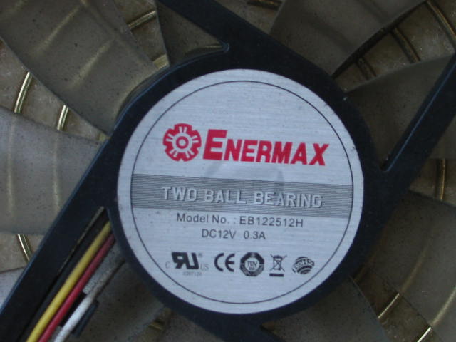

                                          https://www.badcaps.net/forum/attach...1&d=1539551985
                                          It's a custom Enermax fan, model EB122512H, rated for 0.3 Amps @ 12V, and is a 4-wire type (PWM-controlled.) Also, it's a two ball bearing fan. But for some reason, both of its ball bearings had failed. The fan could still be turned by hand, but it stopped rather quickly. This is the first time I see ball bearings fail like this on a fan. Normally, they just go very noisy. These were noisy too, but not much. They just didn't spin well.
                                          Luckily, I got some spare bearings that fit. They are probably very low-quality, as I got a pack of 10 of them on eBay for $1 (with free S&H) to try and revive another very noisy fan. But they do work for the time being and the fan spins much easier and much quieter than with the original bearings. I'm not too worried about it, anyways, as I still haven't fully fixed the APFC circuit. And even if/when I do, I'll probably put the PSU on a trial period on a test PC. So if something happens, no problems.
