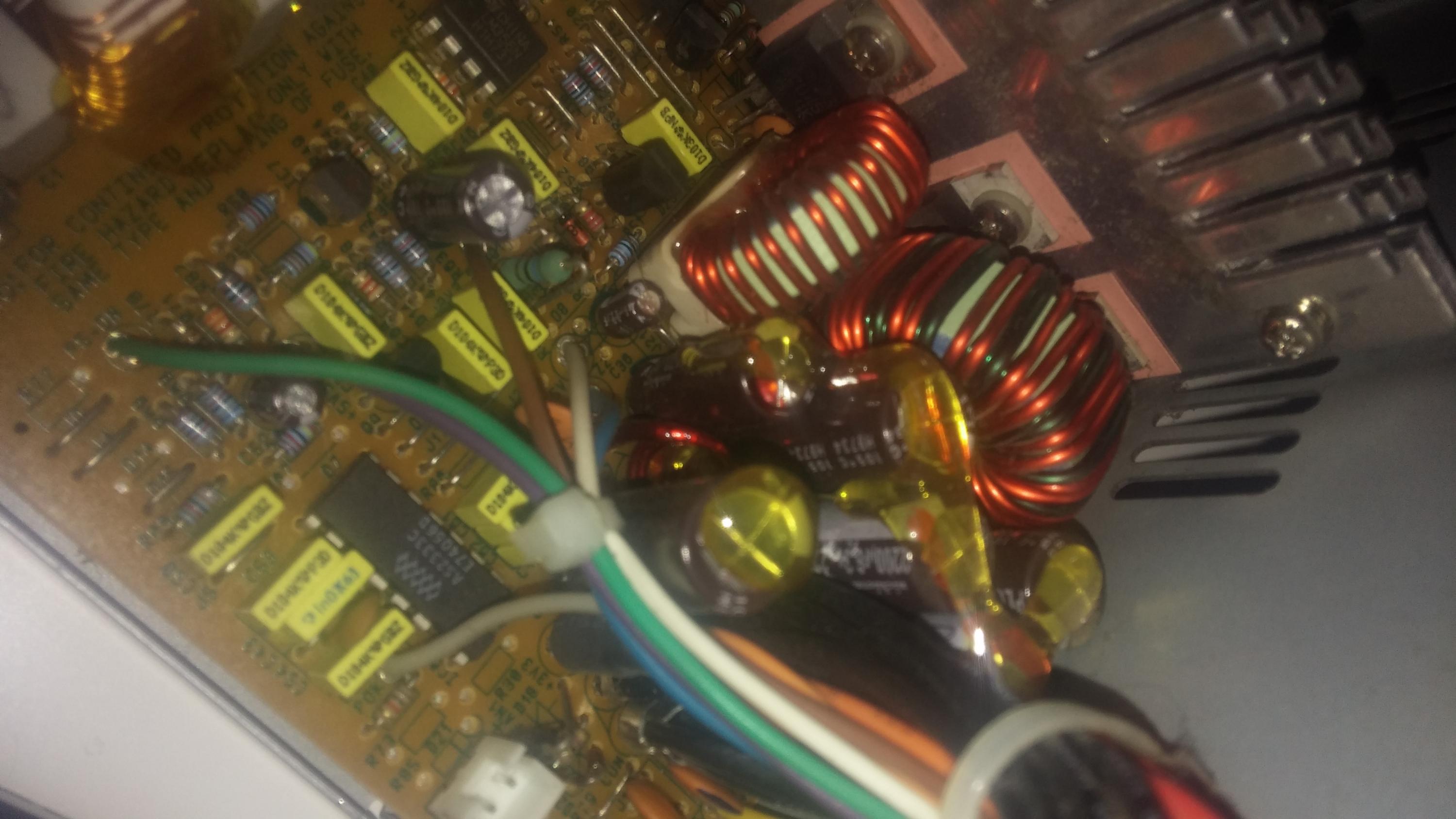

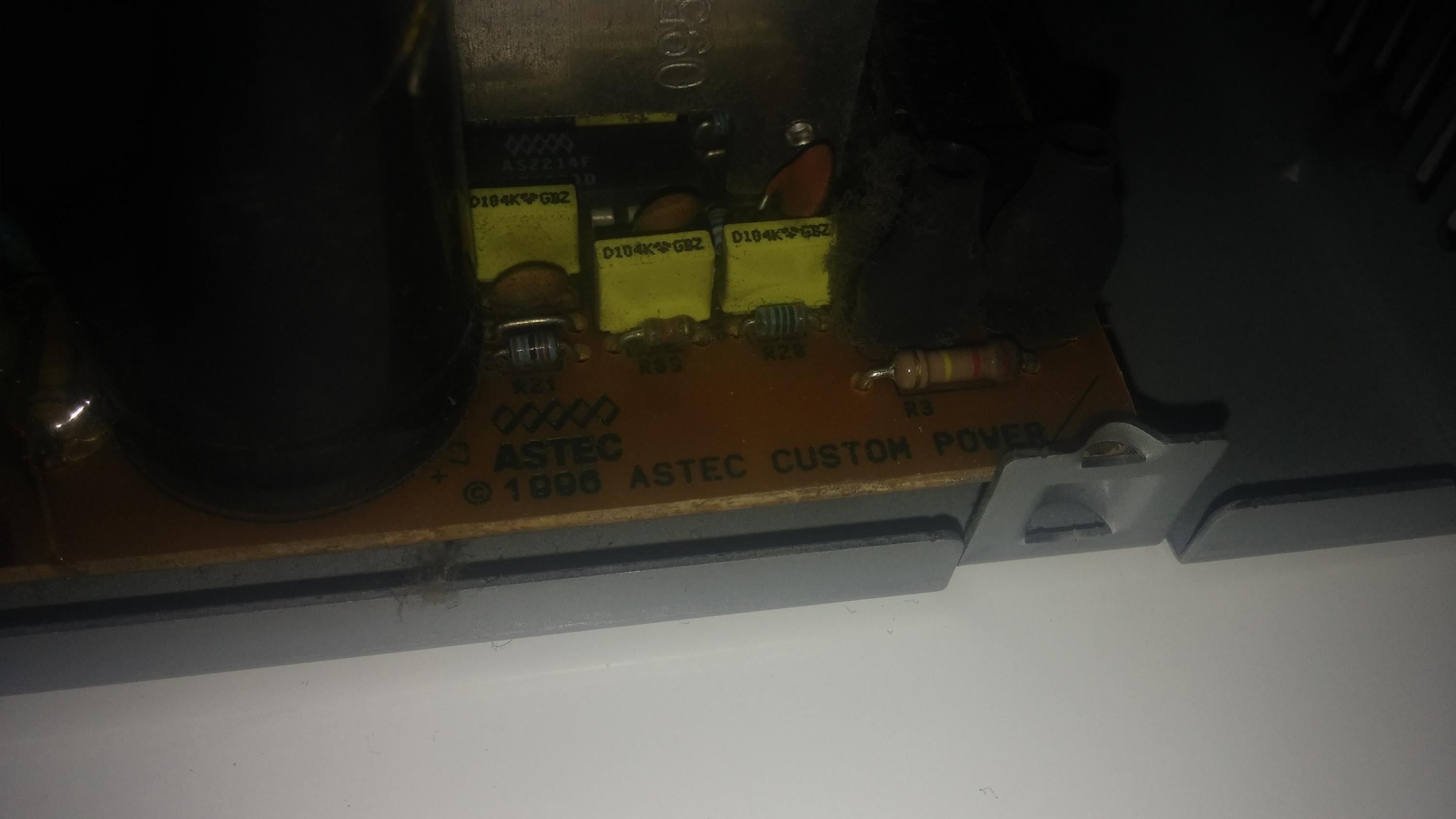

          Astec ATX200-3516 from old packardbell Pentium MMX 200MHz.
          Primary
          2X Nichicon LK series 470 Microfarads 200wV
          Secondary:
          4x Nichicon PL series 2200 Microfarads 6,3V
          1x Nichicon PL series 2200 Microfarads 16V
          1x Nichixon PL Series 220 Microfarads 10V A9724 (probably circuit 5VBS)
          Transistors:
          Primary ST 9714 HV82
          Secondary:
          X1 ST L7905V W994B9727
          X1 9735 B2045 (?)
          X1 MBR2545CT (Diode rectifier)
          X1 G1 FEP16DT 9722 (Diode rectifier)
          It seems to me a lie, that a 20 year old fountain is better finished than many PSU that are sold at a price range of $ 20. I'll buy an ATX extender, 1 SATA adapter and an ATX12, the PSU deserve a second chance.

            You won't power much with 72 W @12 V, and with that stand-by rail, most motherboards won't even start.

              Well, I'll put it on some computer that does not require much amperage. The truth is that I had not thought xD.

                Yeah, that .1A +5VSB current rating really limits that PSU's usefulness. It's almost 20 years old. The PL series was pretty top end back then, not sure if the PW series was around yet. OTOH, I think there was at least one newer series than the LK series, which is rated for +85C. Love all those gorgeous Thomson CSF 5 mm lead spacing metallized polyester caps! And the -52 material output inductor cores are good, too. Astec made some good stuff! I'm sure that 200W rating was absolutely realistic. But as Behemot pointed out, the +12V O/P is pretty weak.
                Hypothetically, you could replace those +85C I/P caps, and even replace the PLs with parts of the RoHS-compliant version PM series. You might even be able to fiddle the rectifiers and feedback circuit to get an extra amp or two from the +12V. But that .1A rated +5VSB pretty much makes that PSU a museum piece, sadly.
                      Already, it is a pity, because the PSU is a marvel for your time. Although no problem, I'll mount it with a motherboard with an intel pentium 2/3 (I think you can), even for a classic gaming computer.
                      With the polyester metalized you left me amazed, I had not realized that they were thomson.
                      Well, if it is a relic, I will save it for my Pentium, so far I have not thought about modifying it, because if it works with my 2/3 pentium I prefer not to modify it.
                      The inductors surprised me by the large size, the truth is that to be 20 years is very well finished, and as you say, is a PSU that actually delivers the 200W.
                      I could say that it has an 80 gold efficiency xD.
                      Thanks for the info .

                        Just don't enable any Wake by… devices, the stand-by rail is weak for that. And if the motherboard has such option, set USB power to +5 V rail.

                          When it was mounted on the original computer (it had 2 USB ports), when I connected a USB the computer froze, now I understand why.
                          The board was ATX with an intel pentium MMX.
                          What I have thought, is to put a supplementary power of 5V (exemple using iphone charger plug) or make a bridge from the 5V line (22A) to the 5VSB (0.1A), disconnecting the original 5v 0.1A, I think it will be enough to be able to start without problems.

                            Just be careful with that, strange currents running where they should not can kill controllers. Especially this old HW which did not have so many protections built in. Maybe insulated regulator from 12 V would be safer.

                                I've worked in P/Ss most of my career. I recognized the Thomson caps right away, and from the text of your post remembered that the Nichicon LK series is 85C (the 105C series was GK). I used those and the then new PL series in a new design back in the late 80s, IIRC. Astec was one of the two largest P/S manufacturers in the world around that time, and Delta Products was the other. I worked for Delta in the late 90s, but Astec was a competitor for whom I had significant respect.
                                What I really liked about those 5mm lead space polyester box caps was that they were good quality, and there were several sources - Thomson, Roederstein, Wima, Evox, and Rifa come to mind. Roederstein and Wima also made 2.5mm lead space polyester box caps.
