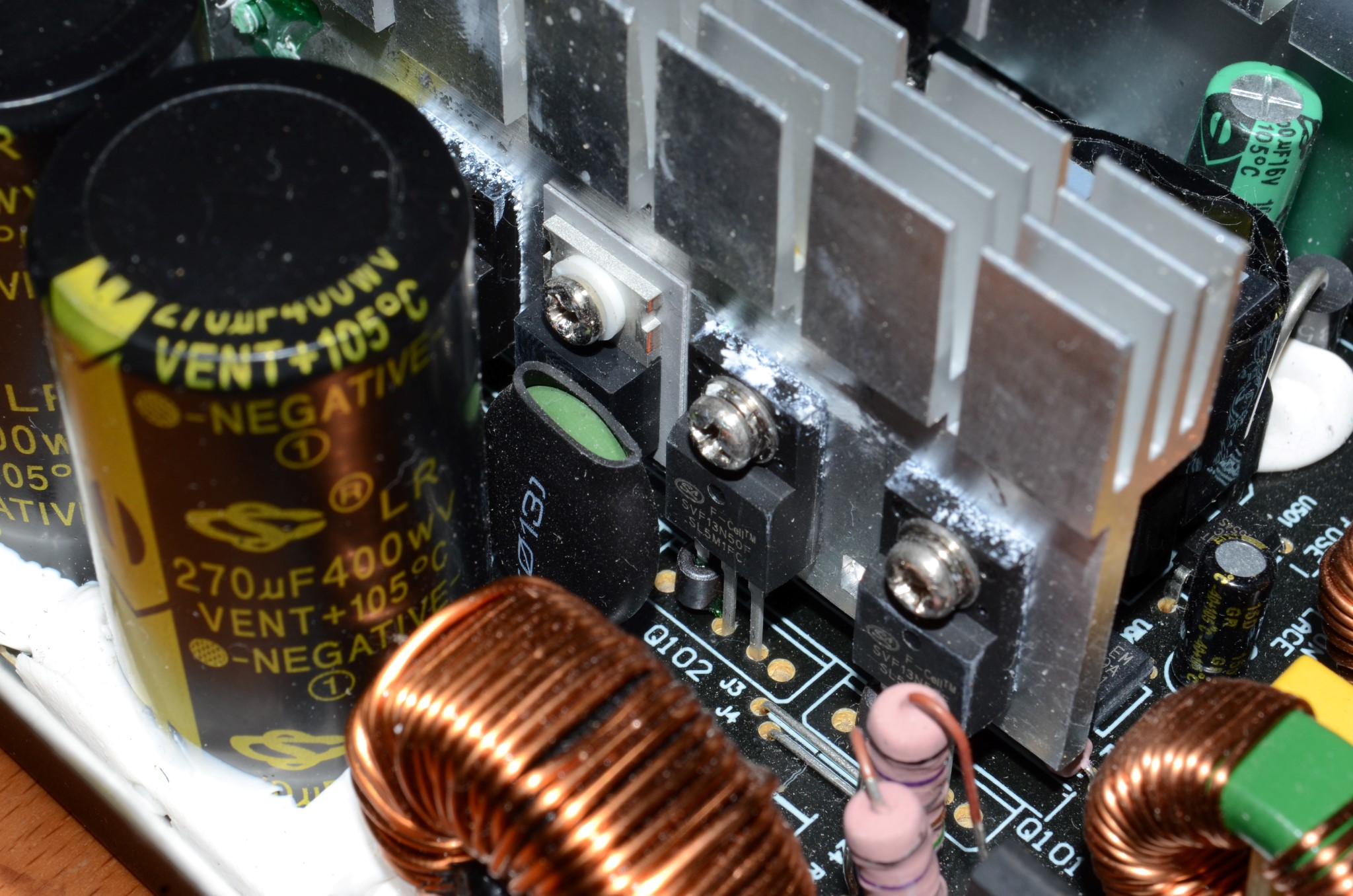

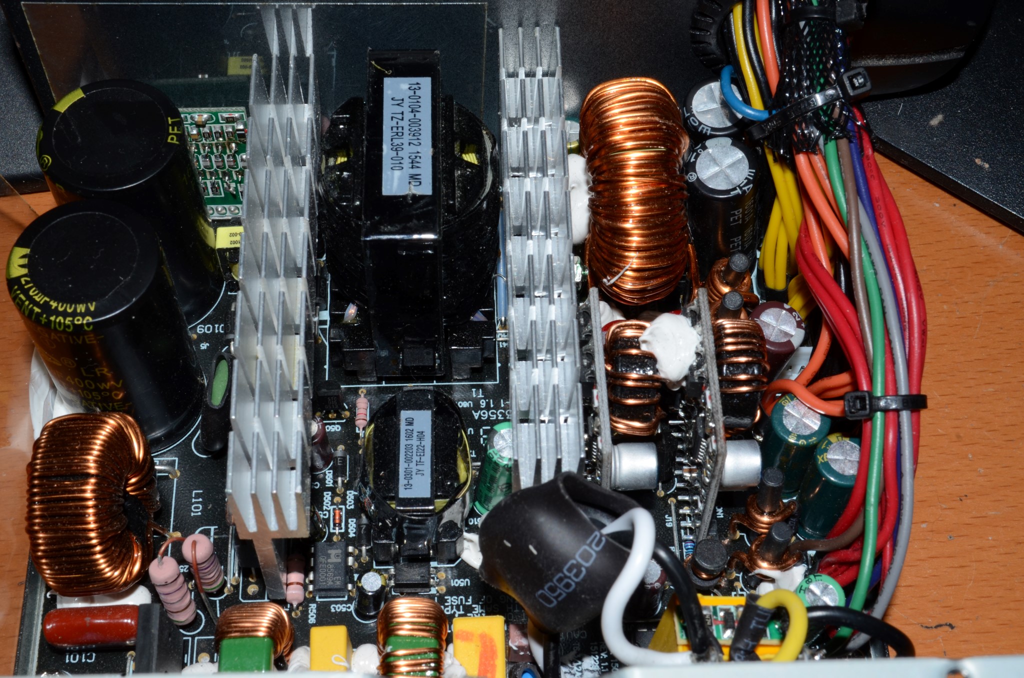

        730W, doesn't seem that bad for 60 bucks...

        +12V filtered by 1 2200uF, 2 x 4700uF and also has 2x 820uF in it.
        minor rails have 2x560uF Polymer + 2200uF wet lytic.
        Primary: 2x 400V/270uF

                  What PSU is that?

                    Xilence Performance A+, made by Huizhou Xin Hui Yuan Tech.

                                  730W Xilence Performance A+ for under 60€...
