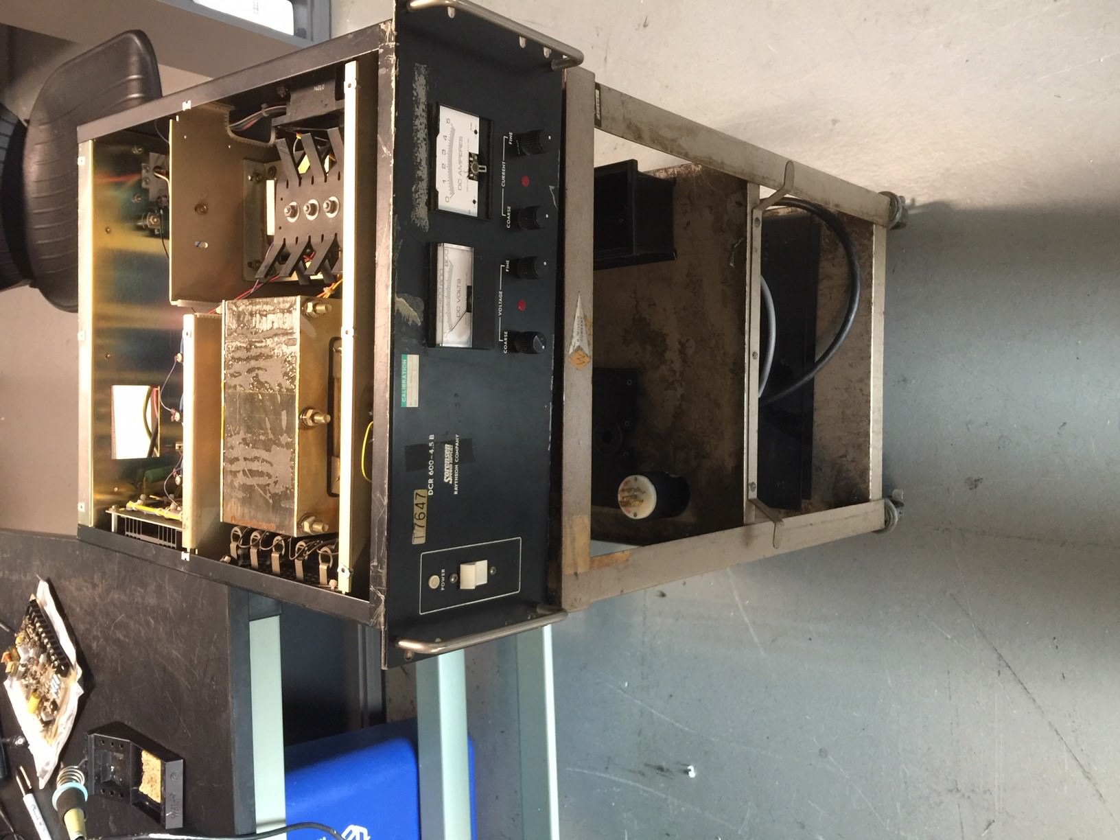

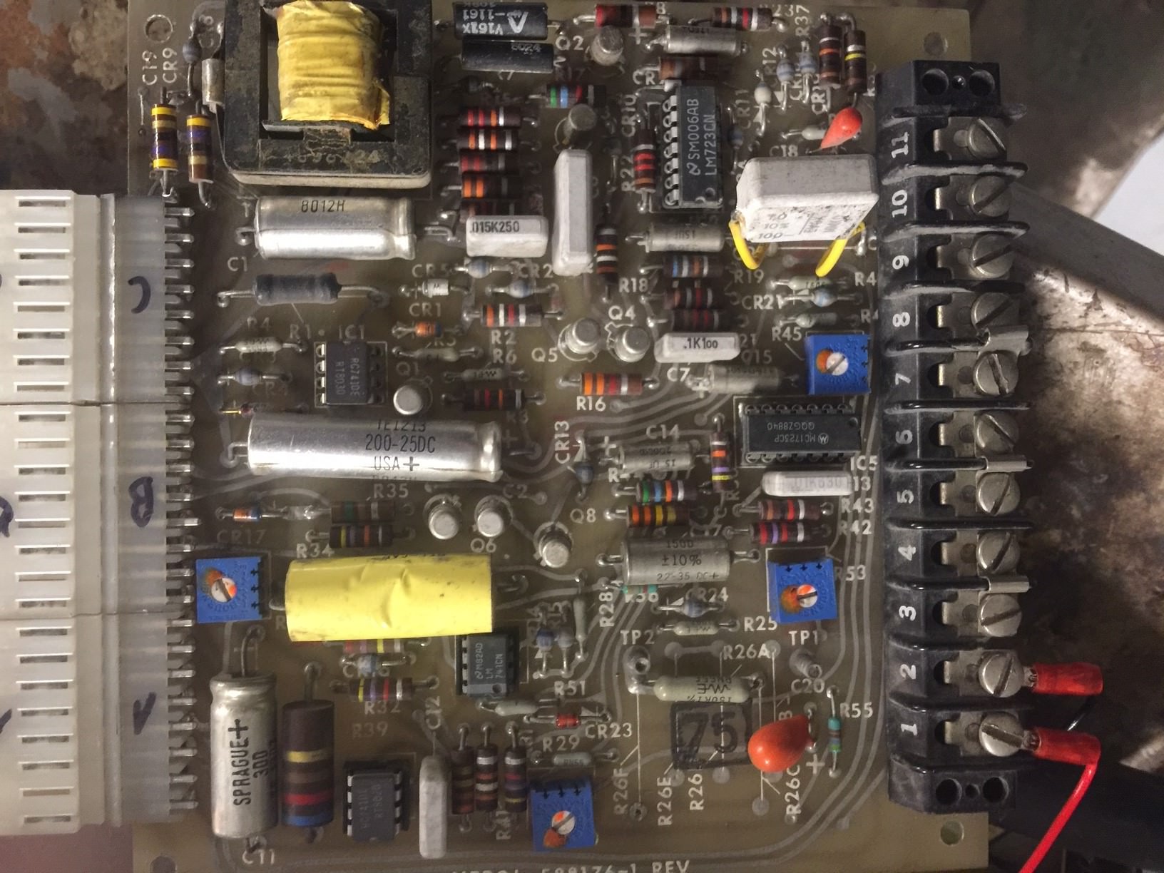

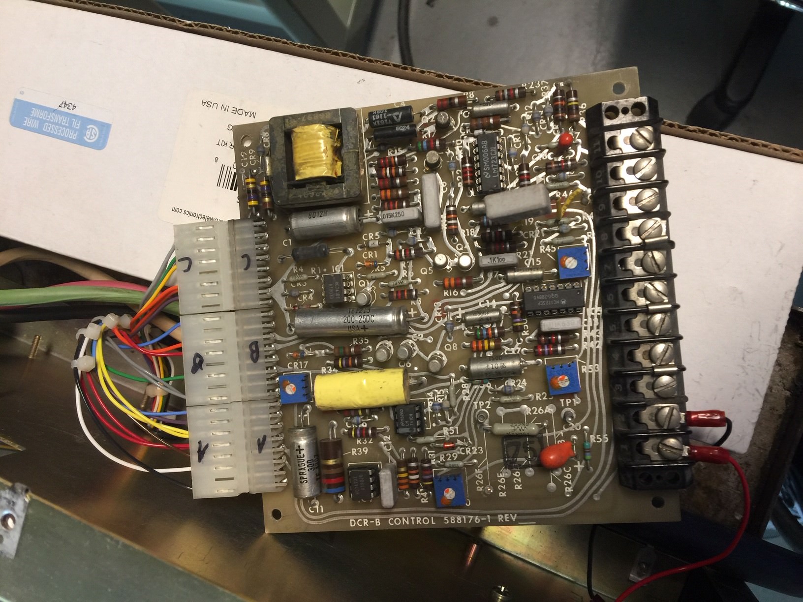

    When initially getting the device, the system's chassis fan activated with a flip of the main breaker, however little else occurred in the 7" high chassis. Troubleshooting at the component-level initialized by tracing the supply line voltages. The schematic reflects line voltage to a large transformer, so I verified voltage at those nodes. However, at this point I seek advice and directions. The service manual states, “DCR-B series supplies are phase controlled type with SCR's (Silicon Controlled Rectifiers) or Triacs at the input to the transformer, followed by a passive LC filter … Low dissipation transistors and diodes are located on a single printed circuit board while high dissipation devices are heat sinked to aluminum brackets and heatsinks.”
    Replacement of the single printed circuit board (DCR control board P/N 586955-1) returned some progress. Now, the system generates variable voltage output when the main breaker activates, however I cannot reach the required 600V specified by the manual. What are your thoughts and advice?

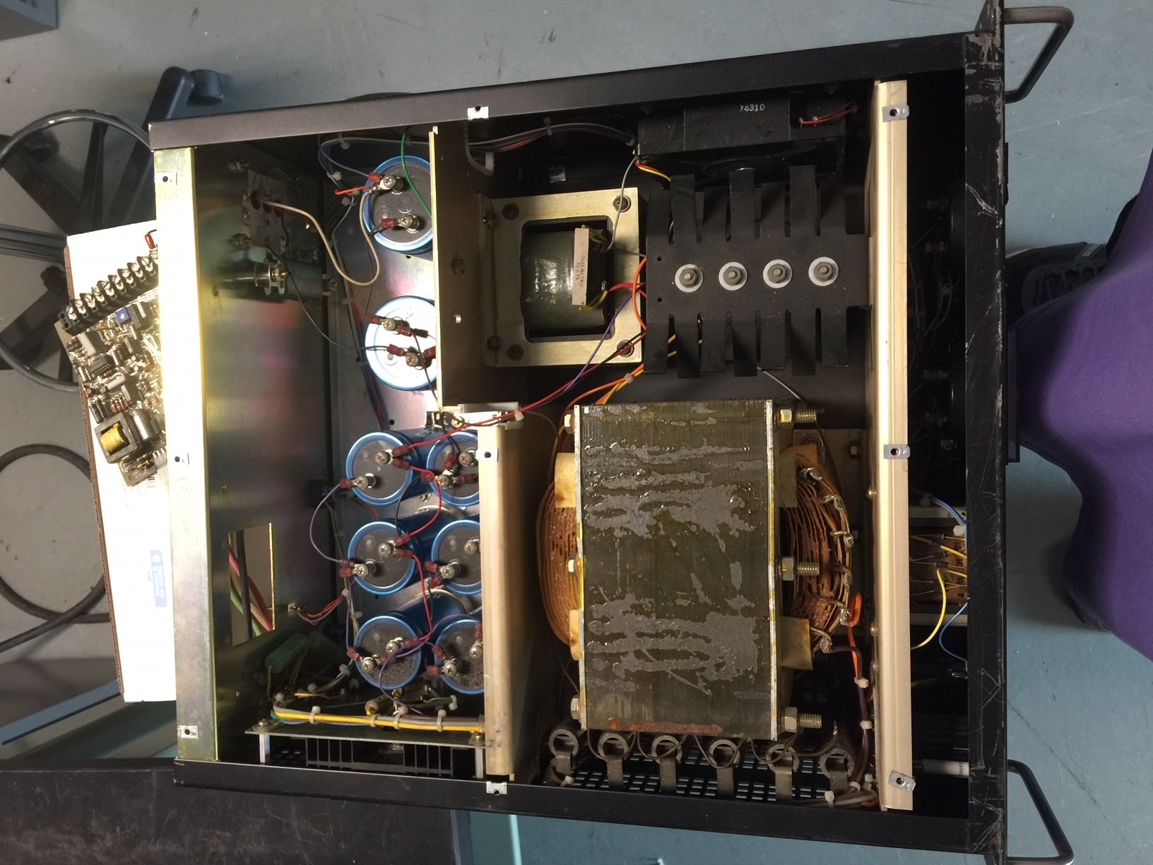

        Im actually having a hard time visualizing how in the world this thing works.... Can you post pictures?

          At this time I am traveling and haven't taken any pictures yet. When I get back home in a few weeks I will post plenty of photos. Am I allowed to post the external link to the repair manual with the factory drawings and schematics on these forums?

              You should be able to post links or at least you should be able to trick the interpreter to post links - this was added to prevent bots and possibly people from spamming the forums with advertisement links. Seeing the actual service guide would be helpful, if not the actual pictures of the innards would be nice.

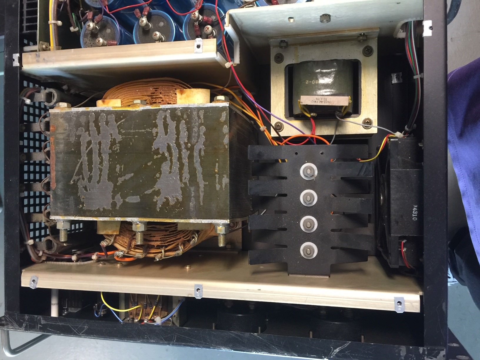

              As this is an thyristor controlled, the thyristors not completely turning on or shorted would be a bad thing. I suspect the short case can be ruled out if the power supply isn't heating up and self-immolating or its fuse. You probably will need to remove or have access to the thyristors to test them. I'm not sure whether your device is a TRIAC or SCR based, suspecting the former due to the voltage range, which means there should be normal diodes on the secondary as well.
              Also this is a line-frequency based power supply, so the supply probably has fairly large HV capacitors (>=8mF at >=600WVDC ?) If they at least sort of still work like a capacitor, they may be good enough to at least get it to 600V output. But the small ones on the control board, all bets are off.

                The chassis holds some huge capacitors, aluminum heat sinks with some components and large transformer. Any thoughts on how to proceed?

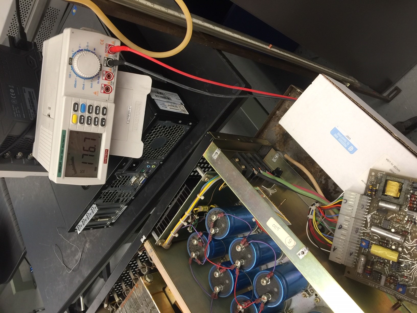

                  Are you getting the full 600V across the primary filter capacitors, schematic accurate, it would be C5's + to C4's - would be the full voltage (half will show up on each capacitor). This should be the setpoint voltage as well.

                    I see the voltage will adjust down to zero and up to about 190V over the full range of the knob. It does not suddenly drop to zero. This was verified using an external multi-meter. I do not have a load resistor that can support this wattage, for now I would like to defer the load testing.
                    I will test voltage across the primary filter capacitors and report the voltage.

                      For now without additional information, you should check that both SCR control circuits are intact. Make sure CR8, CR9, R9, R10 aren't burned out on the PCB. Ensure that at least the gate to cathode connections on the two SCRs behave like diodes and aren't open; at least if you can't fully test them.

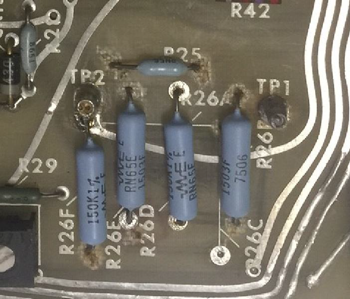

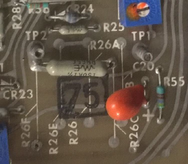

                        Thank you very much for the pointers and direction. Reconfiguration of the resistors on the control PCB enabled an output voltage of 600V. This required removing the (4) 150k resistors from the old board and populating them on the "new" board.

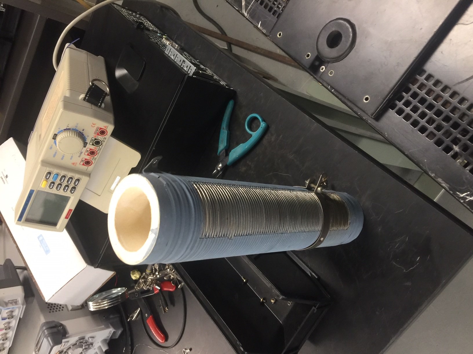

                        Now I would like to perform a load test. Below are pictures of a very large 5.5 OHM resistor. What is the recommended procedure for load testing this PSU. What size wires are required from the terminal block to the resistor?
