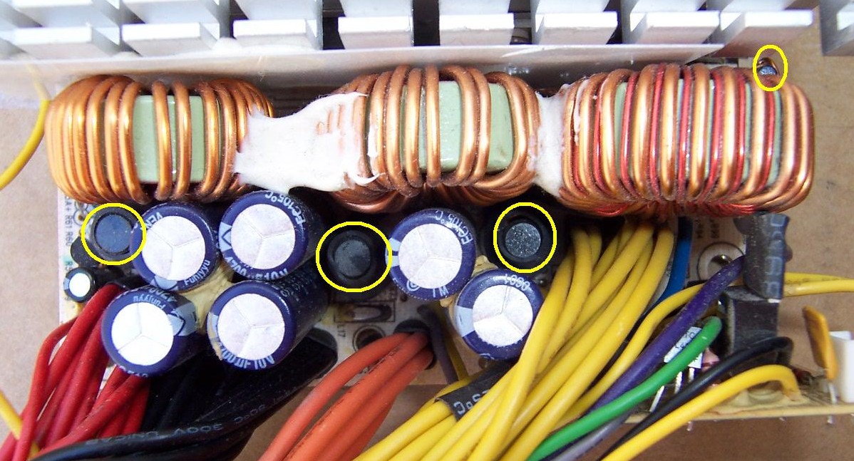

    Originally posted by i4004
    bonez, that's a coil that's part of output pi filter...
    HOG WASH
    The toroidal coils are NOT the PI filter inductors.
    i4004, you need to stick to something you know about, like antique TV's.
    The output PI filter inductors are circled in yellow.

      Re: Well, I just joined the club. And the forum! Antec TP 550 EPS died.
      you know about element markings on the pcb, right?
      what letter is used to mark those things u call "torroidal transformers"?
      and what letter is used to mark 2 "other"(hehe) transformers?
      anybody home, bonez?
      put more of that medicine on your moustache, it's making you silly beyond belief!

        A Torroid with 2+ windings is a Transformer whether you like it or not i4004.
          I mentioned the Toroidal Transformer as point of reference to assist corbin in locating on the PCB where I was talking about.
          Your useless erroneous argumentative BULLSHIT is helping NO ONE.
