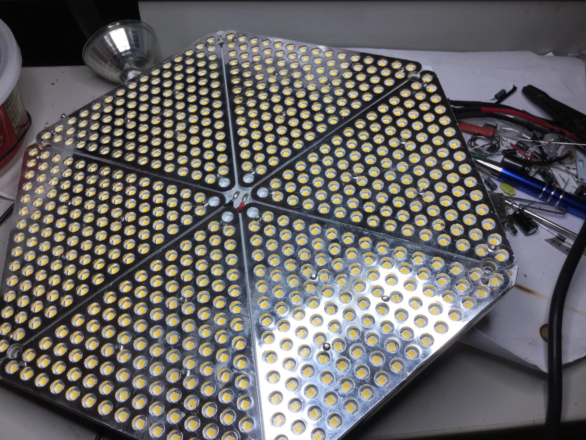

    I bought one of these and tried out
    https://www.ebay.com/itm/400W-DC-DC-...53.m2749.l2649
    400W DC-DC Step-up Boost Converter Constant Current Power Supply LED Driver GD
    I bought three more of them for some other project that I have in mind
    It seems to work very well the heat sinks do get a little warm but you do expect this
    I will recap the board it has Taicon brand caps on it
    Input 12 volts @ 600 milliamperes output 42 volts @ 70 milliamperes I will probably up the current a little bit more for more brightness as long as the LED module does not get very warm
    This is going to work for the battery operated LED Yard Light that I am building
    This is a test LED module that I was using I have not decided what I am going to with this LED module yet because the fixture is not water tight I might make battery operated one for inside the house

    Where did you get that LED module from?
      • Jul 2011
      • 6070
      Re: Step-up Boost CV CC Power Supply LED Driver
      It was given to me I have two of them with the same problem
      The switching power supply has issues which I have not figured out what wrong with it
      Also the power board is potted and kind a damaged it trying to remove the potting
