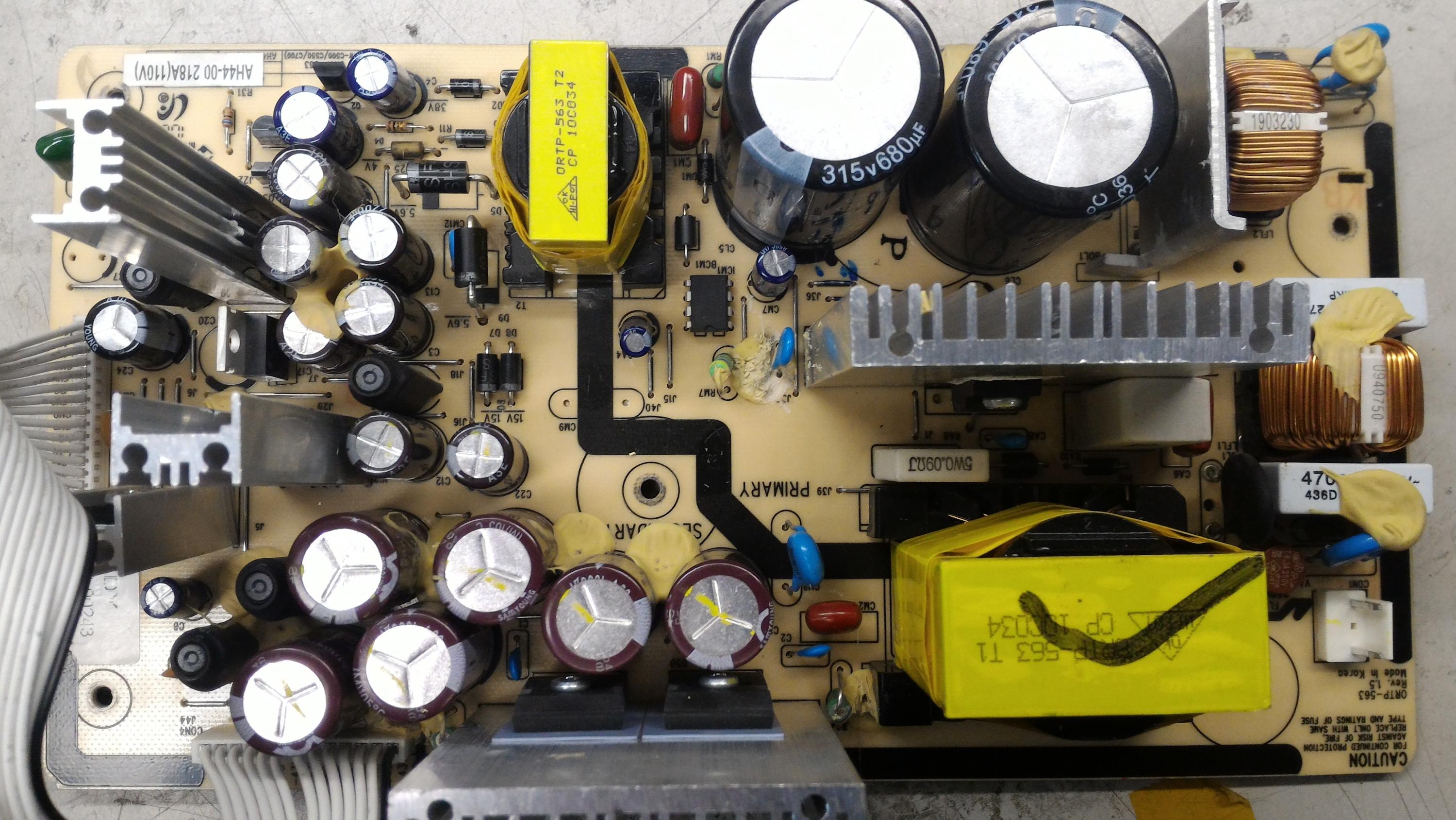

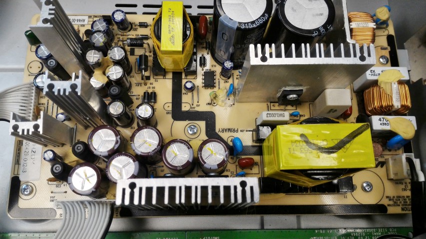

    I have a SMPS from a Samsung AV receiver. It had a blown fuse, high voltage capacitor and power FET. I have since replaced those and it now turns on, but goes into protection mode and shuts down.
    I noticed that I am missing the 43v output and the 4v rail is putting out 30 volts. All the other voltages check fine.
    Can someone point me in the right direction on what to test?

    Model number of the Receiver?
    What is the P/N of the power supply board.
    Are you 100% sure that you are getting 30 at the 4V rail? I would expect parts to blow up badly when such high Voltage being applied to the circuit that expecting only 4V.
    Please up load the straight shot hi-res pictures of the top and bottom side of this power supply board.

      Re: Samsung SMPS
      SMPS P/N AH44-00 218A(110V)
      I am not sure of the model number, its not on the unit. I think its on labelled on the DVD player, which is not with me.
      The output on the board has it marked as +4V and -4V. They are both testing around -30 volts when on. I noticed the capacitors in that circuit are 25v.

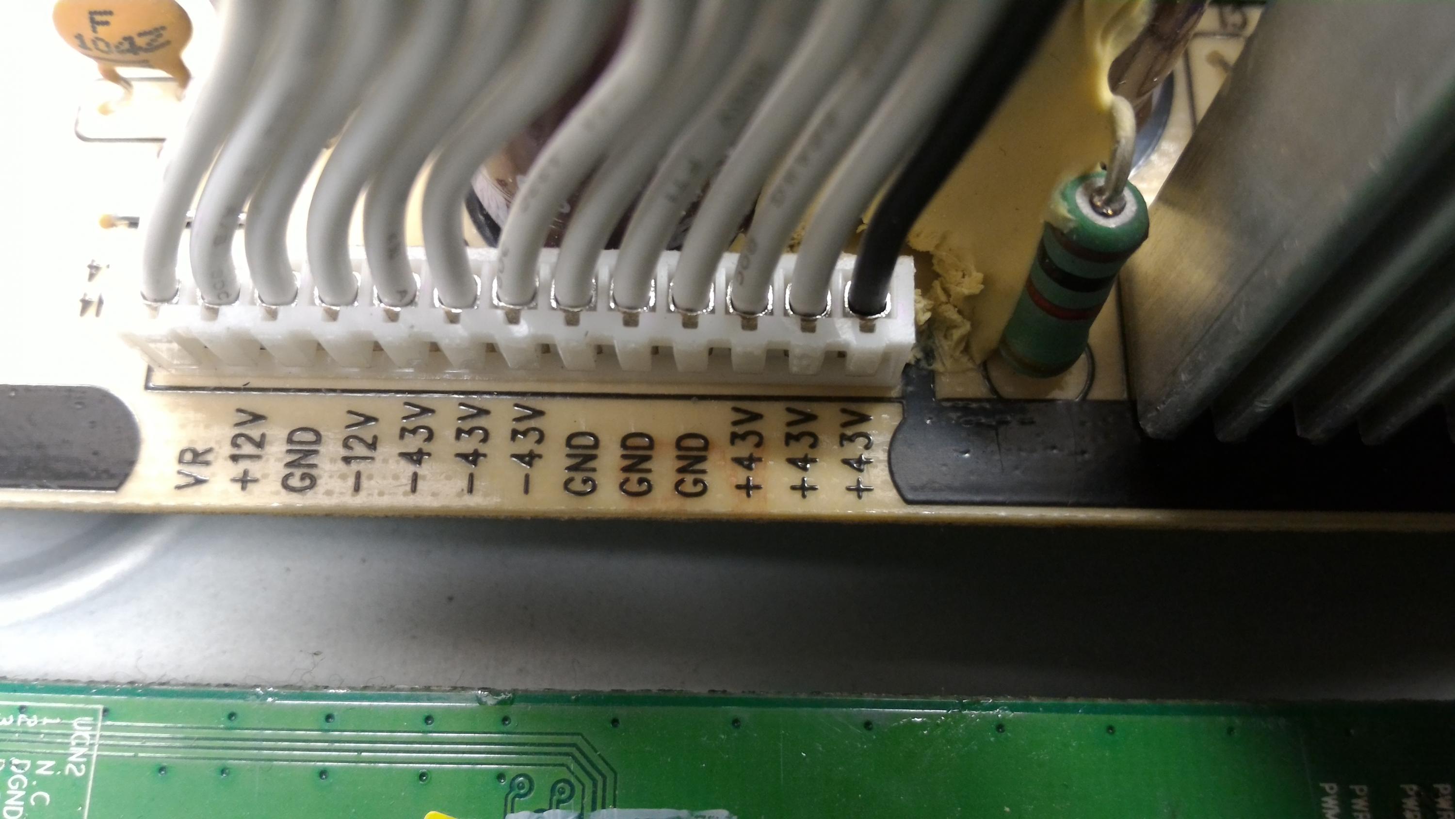

                The -36 volt output is reading what it should be. All of the outputs on that connector are good except for the 4 volt circuit. The 4 volt circuit is reading -32 volts on both +/-. When I read across the two (+/- 4 v) I get 3.2 volts.
                The other output connector is missing +/-43 volts. Do those transformers have a thermal fuse? I dont think I am getting anything from that large transformer that should be supplying 43 volts.
                  Re: Samsung SMPS
                  To me it looks like this DVD player has Vacuum Fluorescent Displays - VFD, so the the +/-4V is for the filament and it is not reference to GND, and the -36V is also for the VFD.
                  You have two connectors on the cold side but you only show picture of just one of them, we need to see the other connector and its pin labels too.
                  The +/- 43V power supply probably needs PS-ON from controller board for it to come on so check the DC V on that 'PS' pin when you toggle the power switch to see if it changes state or not.
                  We also need the pictures showing all the boards and how they are connected, but we do need the model number of this product we are trying to help. The more details information we have the easier for us to troubleshoot from long distant due to not having the unit in front of us to look at.

                    Re: Samsung SMPS
                    If the -36 volts is ok then that part of the supply is working fine, To measure the 4 volts DO NOT USE GROUND. measure across the (-) 4 volt and (+) 4 volt pins.
                    What are the pin designations on that other plug? I suspect the pin I marked could be the pin that turns on that part of the supply. That supply would power the audio outputs and is only turned on when the unit is tirned on. I suspect if you put the power supply in the unit it will work.

                      When I plug the other output (43v) into the board it goes into protection mode then shutdowns shortly after turning it on.

                        Re: Samsung SMPS
                        It is likely you have a shorted audio mosfet in the output that is loading the +/- 43 volts
