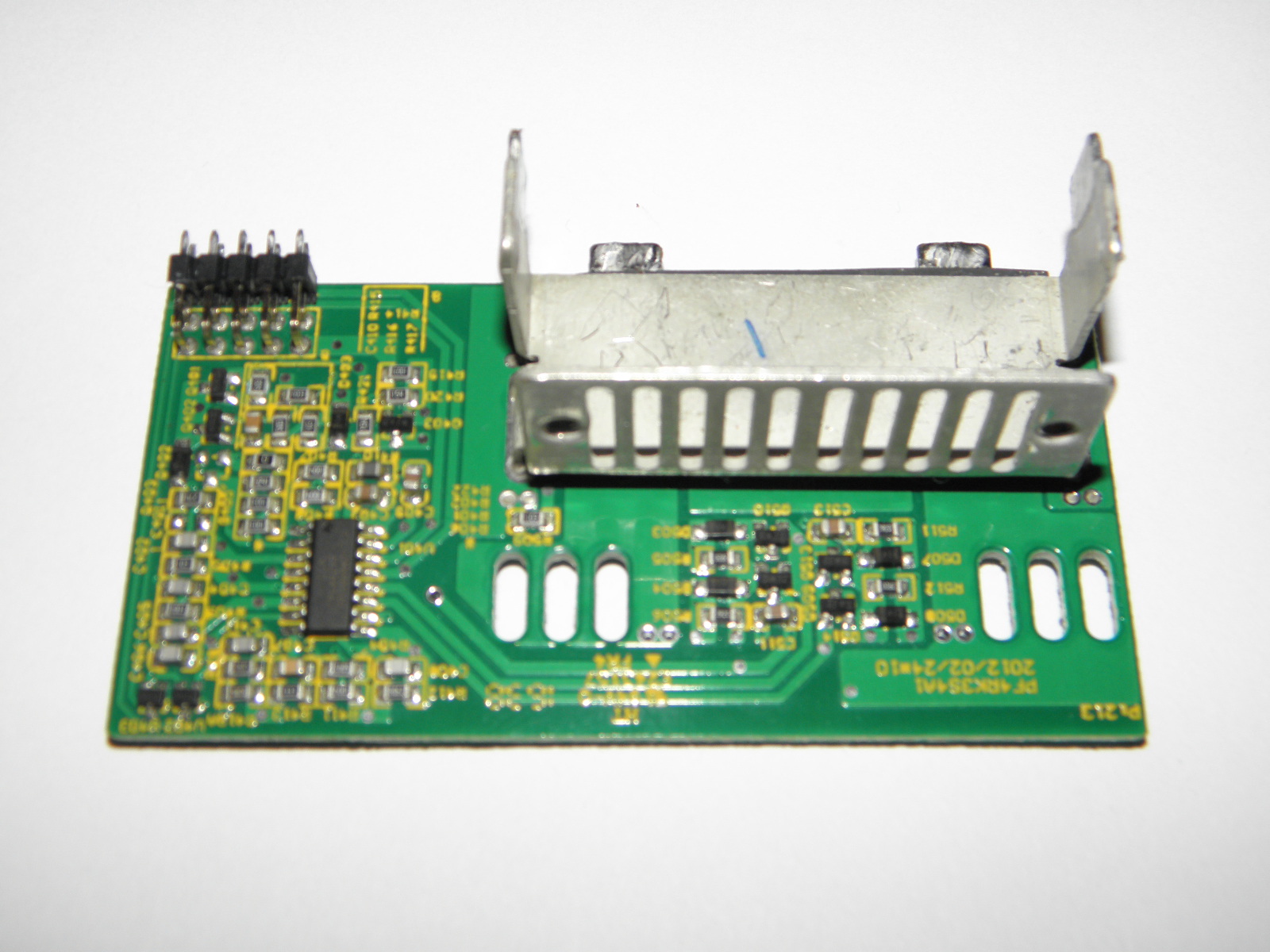

    Hello everyone

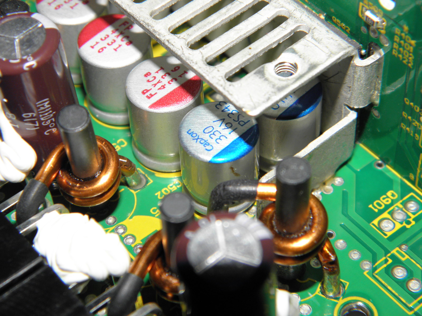

    I've got a Seasonic X power supply which does not turn on.
    Here you can find pictures and info about it (it's a 750W unit, but PCB is basically the same).
    So the symptoms are:
    - with nothing connected:
    • on PS_ON I get about 2.4V (it should be ok since WT7527's high-level input voltage is 1.8V)
    • on +5VSB I measure 5.141V (ok)
    - with PS_ON shorted to ground, +5VSB line falls from 5V to 0V just like if a capacitor is discharging, but it goes back to 5V instantaneously. PGON is always 0V; all the other lines (+12V, +3.3V, ...) are at 0V.
    To me it looks like something is shorting +5VSB line, but I'm not totally sure.
    I've checked all the components sorrounding the +5VSB line on the secondary side and primary side and found no shorts. I could not test the ESR of the caps on both transformer sides, but they look good (no bulges, correct capacity).
    A little thing I noticed is this SMD ceramic capacitor (between +5VSB and GND) has fallen off from the PCB, but I don't think this is the issue here:
    Thank you all in advance

    I think there is a short between +12V and GND.
    When I measure resistance with positive on +12V and negative on GND I always get 0 ohms; then when I flip multimeter clips it still measures 0 ohms, but after some seconds it slowly goes back to infinity.
    Therefore I think it must be a polarized component, such as a diode on a MOS transistor. A careful inspection on the secondary revealed no diodes or MOS transistors (except those on the vertical PCB, which, however, are not directly connected to +12V).
    So I decided to disconnect the front panel, but +12V keeps shorting.
    At last, I must conclude that this problem is related to the +12V filter caps. However, I could not even remove one of them because of the large thermal pads sorrounding them. Also, the heatsink blocks every access to the capacitors.
    So before going on with removing these caps, I would like to know if someone else had an issue like that.

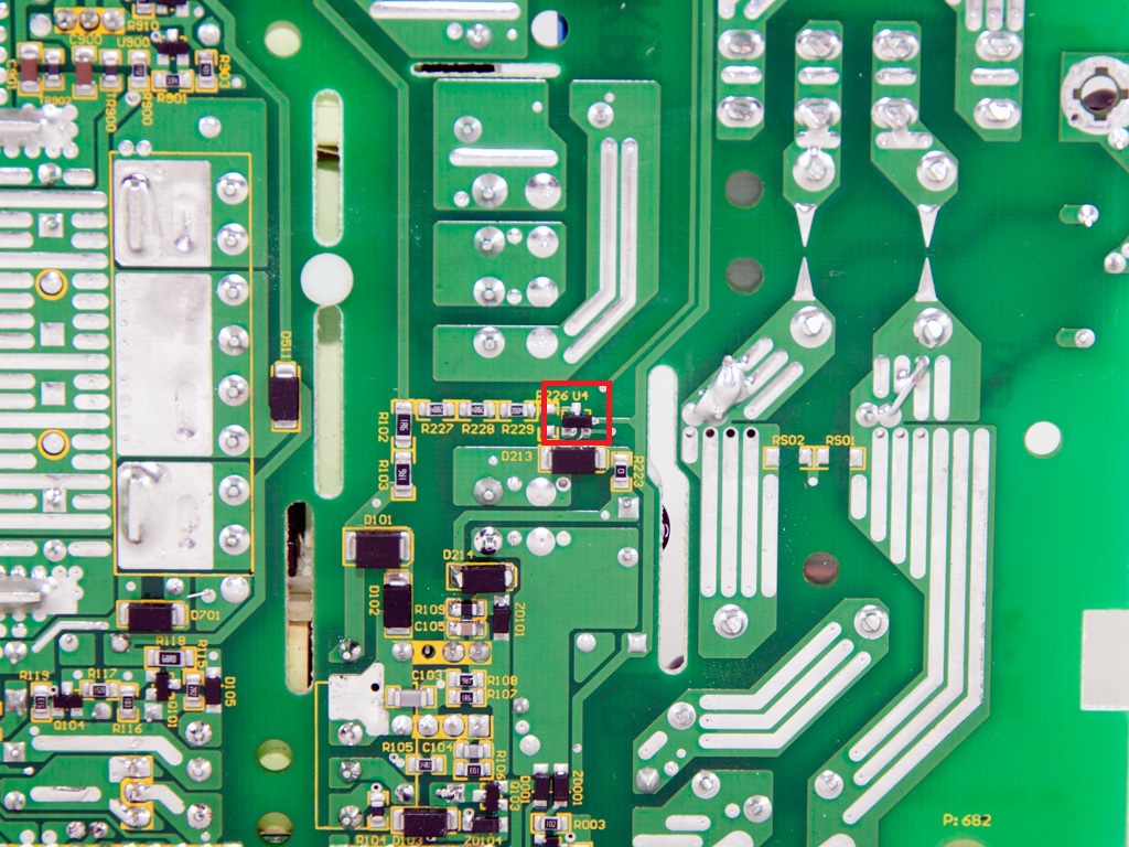

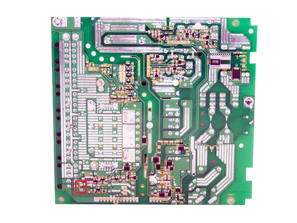

        Some folks over eevblog helped me out identifying a bad MOSFET I found on my power supply. For anyone's interested, here's the picture of it:
        its reference designator is "U4" and its marking is "5014T". Apparently it's a SPN5001 (a 600V VDS N-channel MOSFET). More info here.
        I replaced the two on my board with an equivalent BSS127.
        Now +5VSB is super stable, but it doesn't end here. When shorting PS_ON to ground, fan starts but it stops after some seconds. Voltages on +3.3V, +5V and +12V all go to their nominal voltage but in less than a second they approach 0V. I can hear the thermistor relay switches for a fraction of second, it seems to turn on but then it turns back to the off state.
        Apparently there's still a problem around the relay controller circuit and perhaps it is what caused the old MOSFET to turn bad.

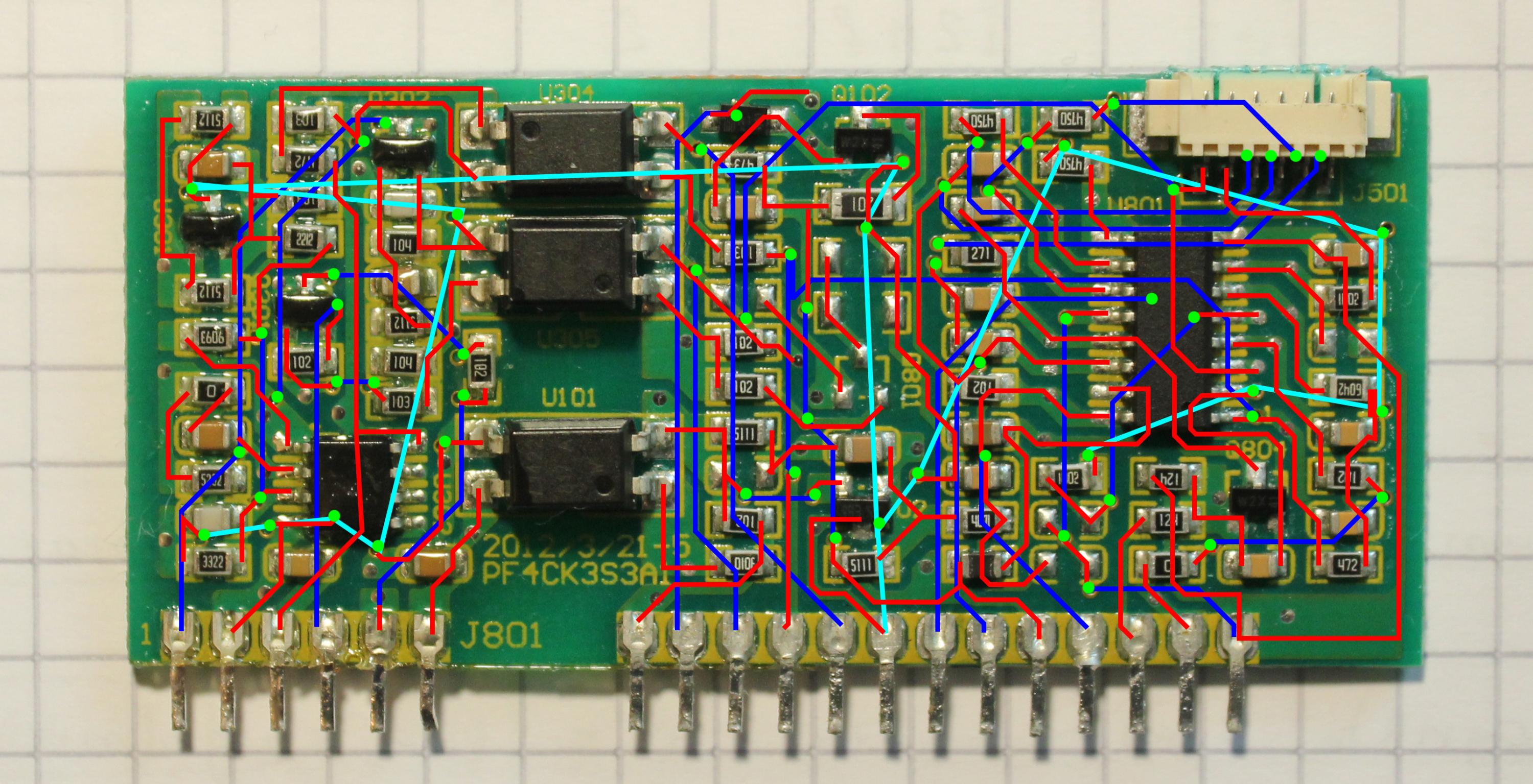

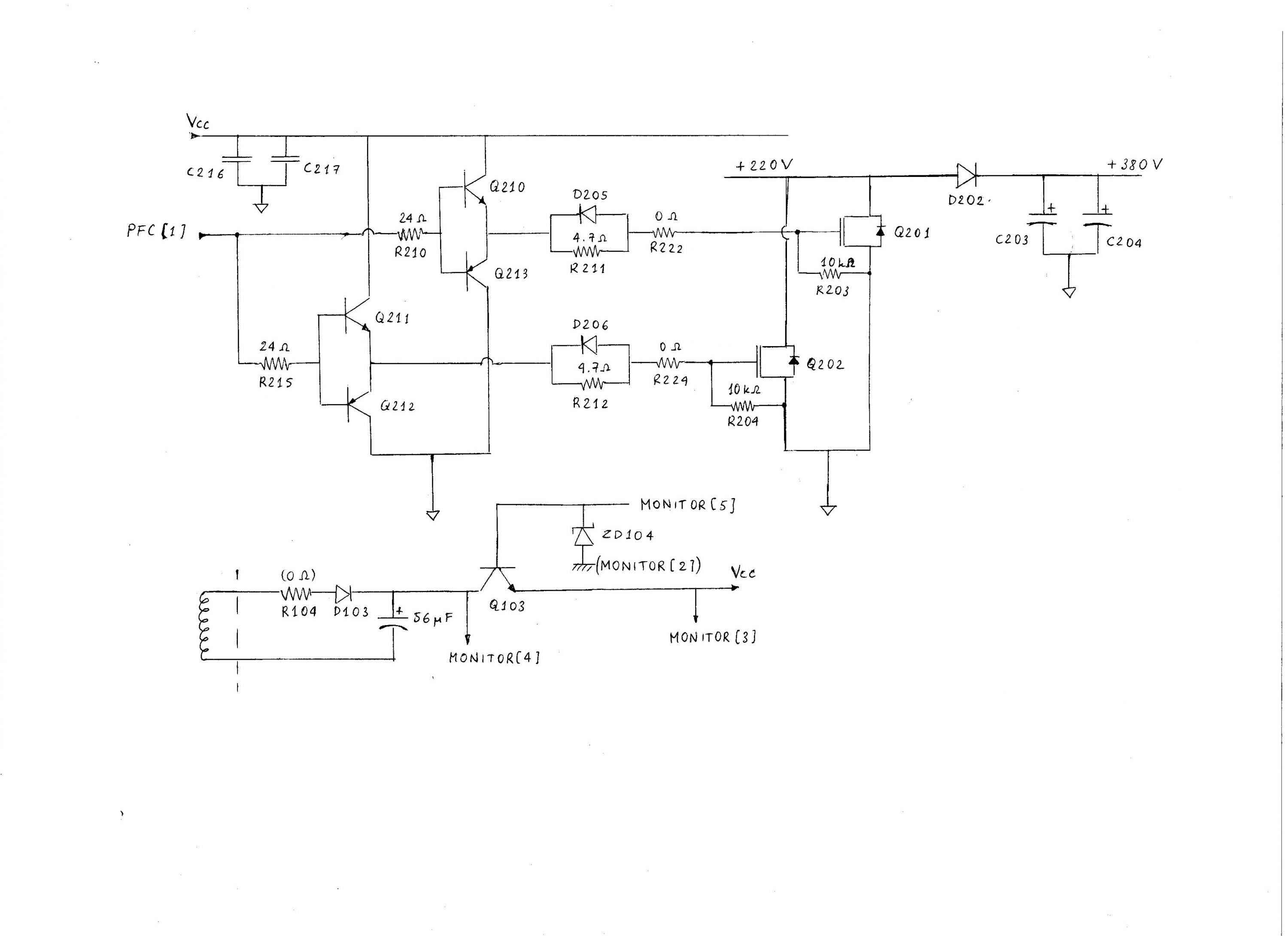

              As previously said, here you can find my partial schematics of the unit:
              https://mega.nz/#!JJoyFK5L!LkH33C09s...ZBuAUOThSOIMxs
              JPEGs are also attached here. If you download the entire archive you will find a .PSD (photoshop) file with the monitor board diagram whose routes can be hidden at will. First layer can be deleted (it's only there to reduce file size of about 10MB).
              Note: in the PFC partial schematic, labels like MONITOR[X] mean that the branch is connected to the number X pin of the monitor board (with the same numbering as in the picture of the monitor bord). PFC[1] instead indicates the first pin of the PFC board, which is the nearest to resistor R205.
              Also, note that I haven't double checked the schematics (it's probable I made some mistakes) nor I have measured the voltages, which I just assumed to be the nominal ones.

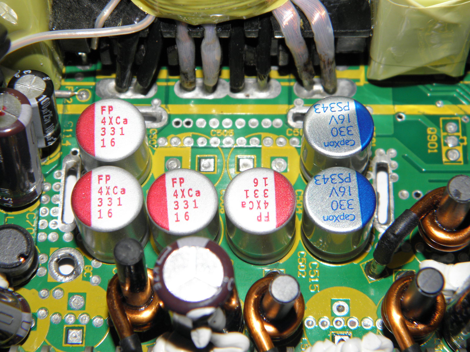

                      One of the problems encountered is a short circuit on the 12 volt line. I assumed that one of the 4 field-effect transistors on the rectifier board was to blame. We take soldering irons and in four hands we solder the module. But the short was not there. It was to blame - polymer electrolytic capacitor. Which when defective - flew out of the room. But polymer - very durable capacitors.

                        So which one of these capacitors was shorted - the blue "CapXon" branded ones or the "FP" (Nichicon) ones? Just curious, as this might be very useful information there regarding cheap polymer capacitor brands.

                          • 31214
                          Re: Seasonic X 850W not turning on
                          one of the capxons has a dent in the top,
                          i'v seen this type of damage before and always wondered if it could be a problem.
                            Can you point it out? I don't see it at all. I've seen caps (both solid and wet electrolytic) get their cases trashed a lot more and still work fine.
                              • 31214
                              upper right blue cap in 1st(left) picture
                              • webber77777
                                • Jan 2019
                                • 3
                                • Ukraine
                                The blue marked CapXon was shorted in the upper right corner. He gave a short circuit on the line of 12 volts. In the most inconvenient place in the entire power supply. When burned, it scattered completely. If the photos are preserved - lay out. As for the capacitors - I had a similar failure with the Xilence power supply, but there, at least from the factory, the polarity was reversed during installation. I was looking for schemes, but I did not find anything for this company. All intuitive repairs
